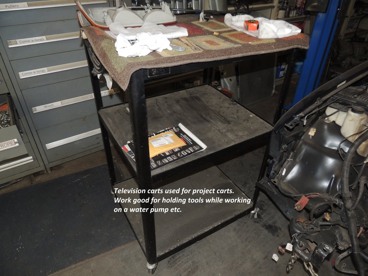

    The local school system has auctions and they sell a lot of these video carts. They are fairly sturdy and make great project carts. Usually sell for about $10. I have several that I use for projects. When working on something like a water pump or A/C it gives a place for tools and removed parts. If you have to order something (Rock Auto) and wait for its arrival, all your tools and components stay together till the part arrives. Same thing with those projects where you don't get back to them for a few weeks....or months.

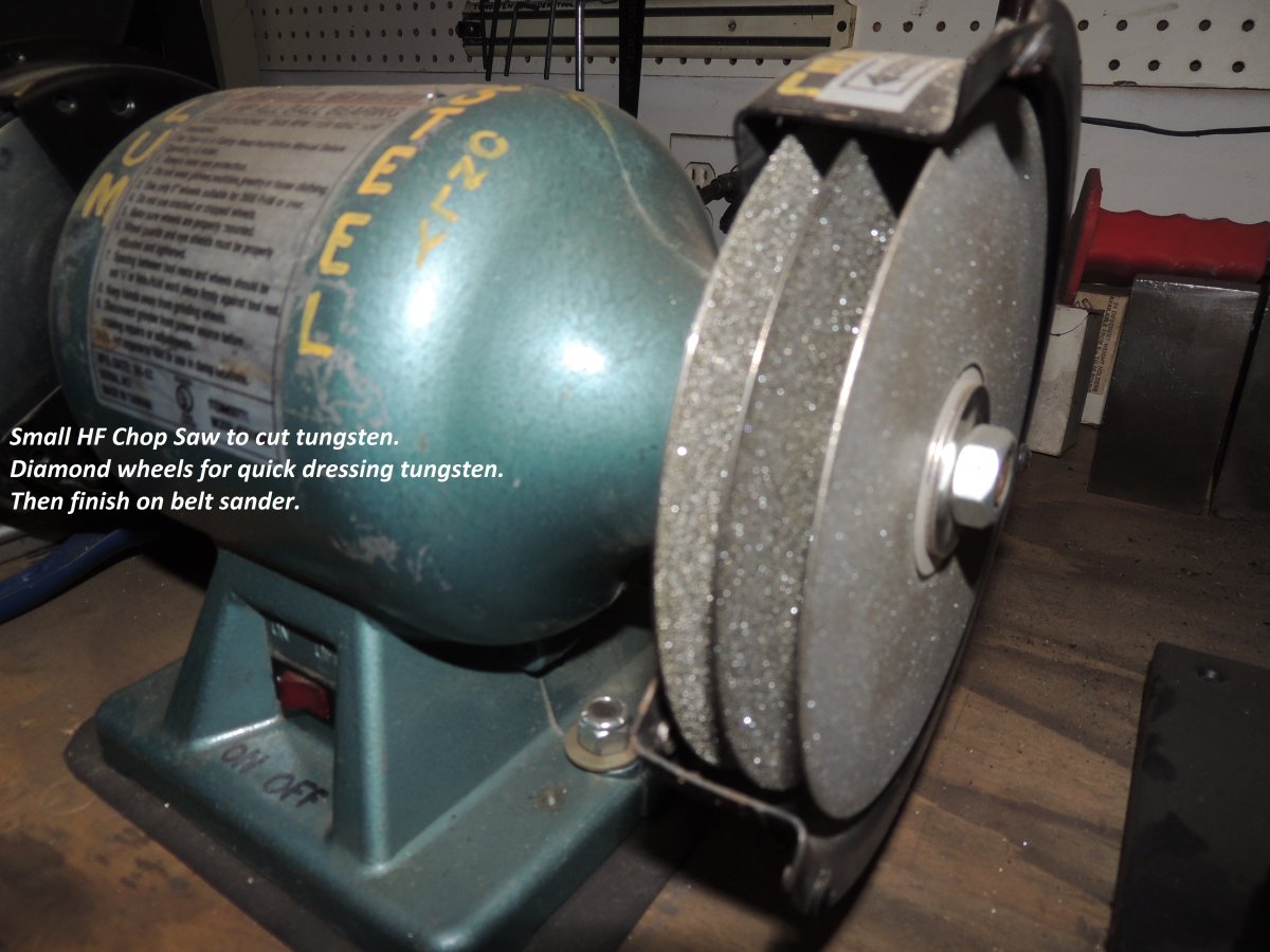

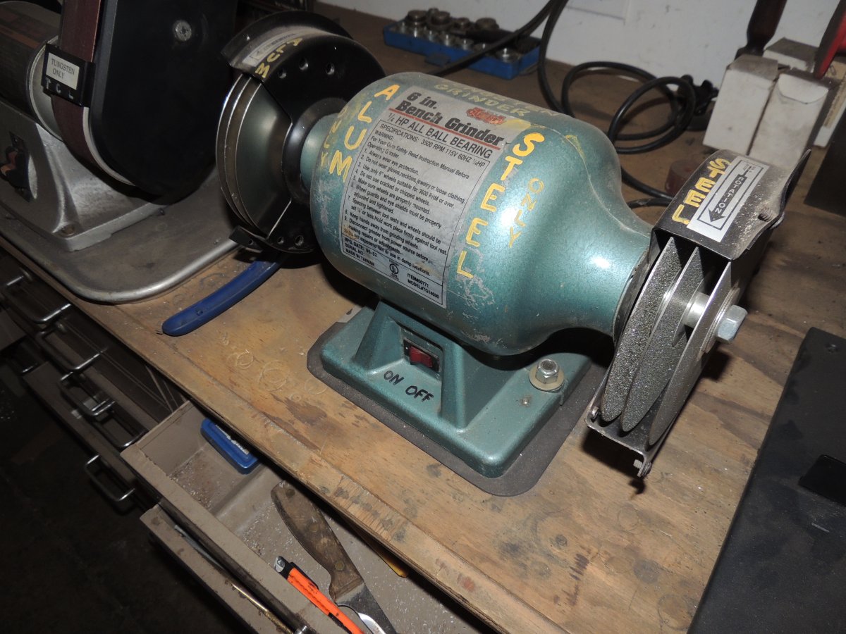

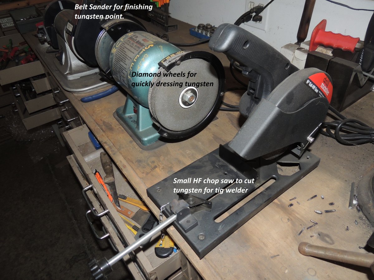

    For Tig welding, I found that getting some diamond wheels will get the tungstens to a sharp point quickly. I have three grits on each side but found that a simple co**** one is usually all that needed. I use one of those minature HF chop saws to cut the tungsten, quickly put a point on the tungsten with the diamond wheels (one for steel one for aluminum). Then I use a small belt sander to finish the points longways.

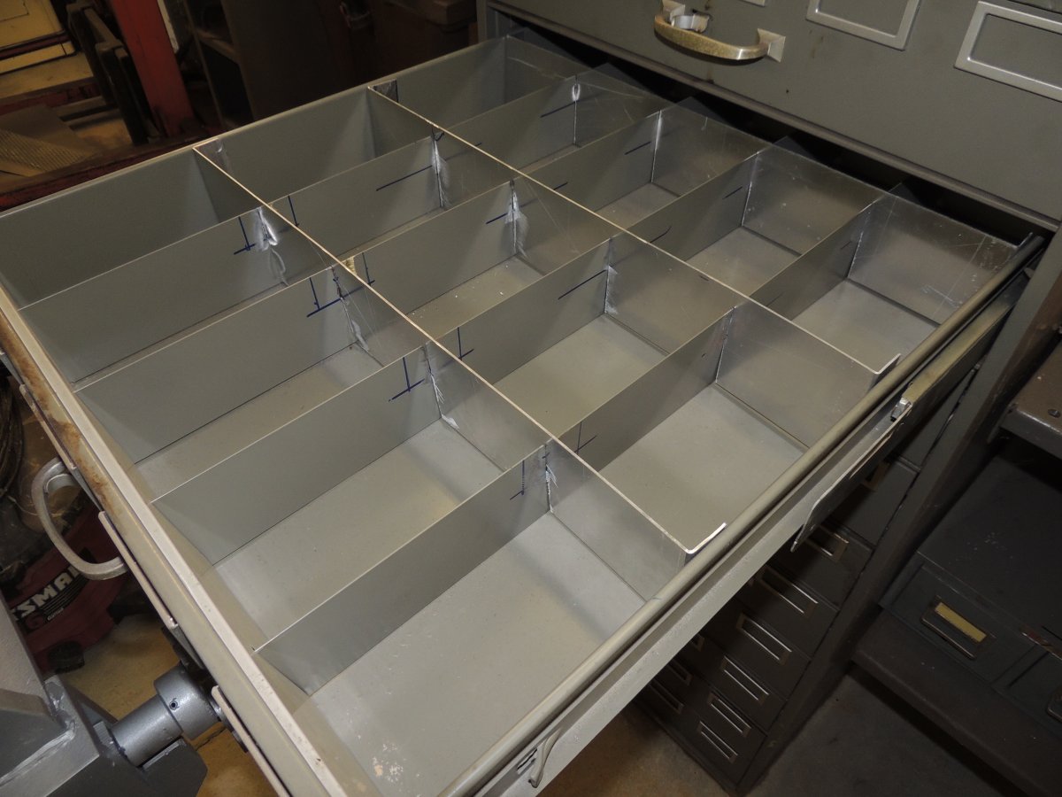

    I buy these cabinets off Craigs list for usually about $50 ea. They fit right in with all my old junk in the shop. They have quality slide drawers. Sometimes you have to make dividers or remove existing dividers, but they are great for organizing and storage. Then get a cheap laminator and laminate all those directions and reference charts and throw them in the drawer with whatever they relate to. One thing I found is that you can make quanity buys of JIC (and AN) fittings on Ebay much cheaper than trying to buy each individual AN fitting for fuel systems. I bought a bunch of different sizes and thats why I keep the chart in the drawer. Buying copper and br*** fittings are a lot cheaper too. I hate going to the local builders supply and paying the prices they want for copper fittings. So I try to order common sizes and throw them in a drawer. Saves time too when you don't have to run to the store to get one thing.
