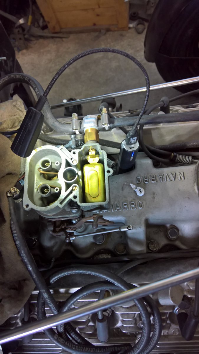

    WP_20191027_10_53_26_Pro.jpg as you can never have enuff light: I guess every body has an old power bank worthless today because it's too small to charge a modern smart phone. Buy the cheapest usb led swan lamp for laptops you can get (if you pay more than $5 you've been ripped off :D) and connect it to your power bank. Great spot light for precision jobs and consumes nearly nothing so I'm charging once a month or two. i use it all the time.

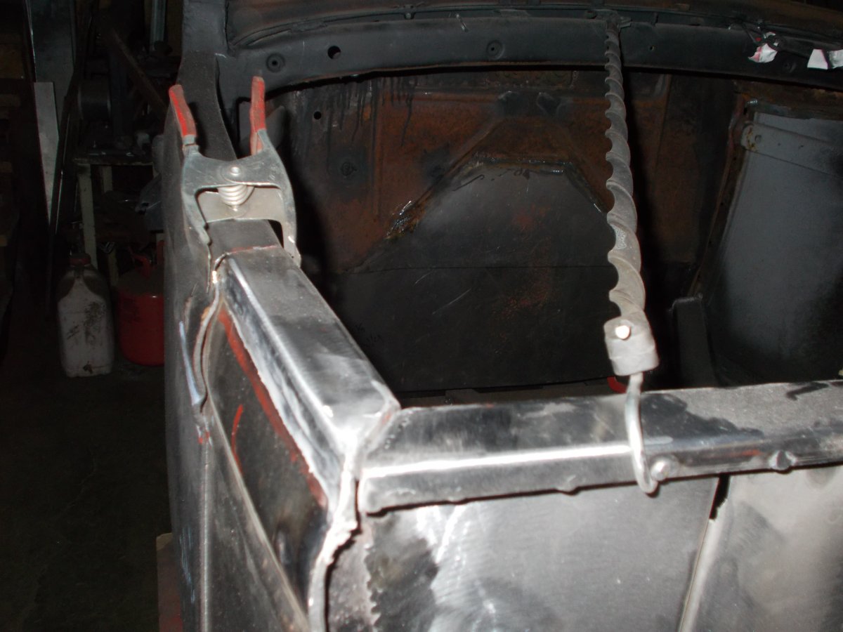

    1. When my grand dad had to weld around a hole that he needed to maintain he would pull the core out of an old D-cell battery and slide it in the hole then weld...
    I guess the weld dosent stick to whatever the core is made of.

  6. Saw a couple for using old cutting boards- but here’s a different way. Go to a used restaurant supply house and ask for old cutting boards off prep fridge (aka sandwich or pizza prep). They’re about 3/4 thick, 10-14 wide and 3 or 4 feet long and made from high density polypropylene. Cut into long strips and use as slides for moving heavy objects. Ever see a guy move a big safe by himself? This’ll get it done

    I was chopping a '28 tudor as entertainment at our club event...
    guy came by and asked if there was anything I could do to bail him out...
    he had snapped off the big alt. bolt on his aluminum head…
    I taped a same size flat washer to the area around the broken bolt...
    then welded into the hole a couple tacks at a time... eventually built up a 3/8" weld that stuck out the same... the washer kept me from welding the head, the heat from welding let the bolt come out with plyers.
    made a new friend !

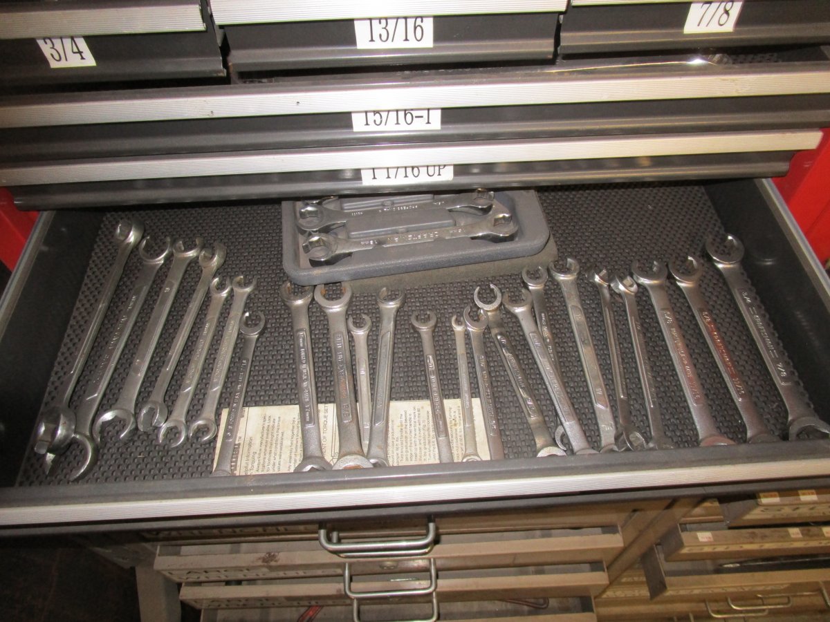

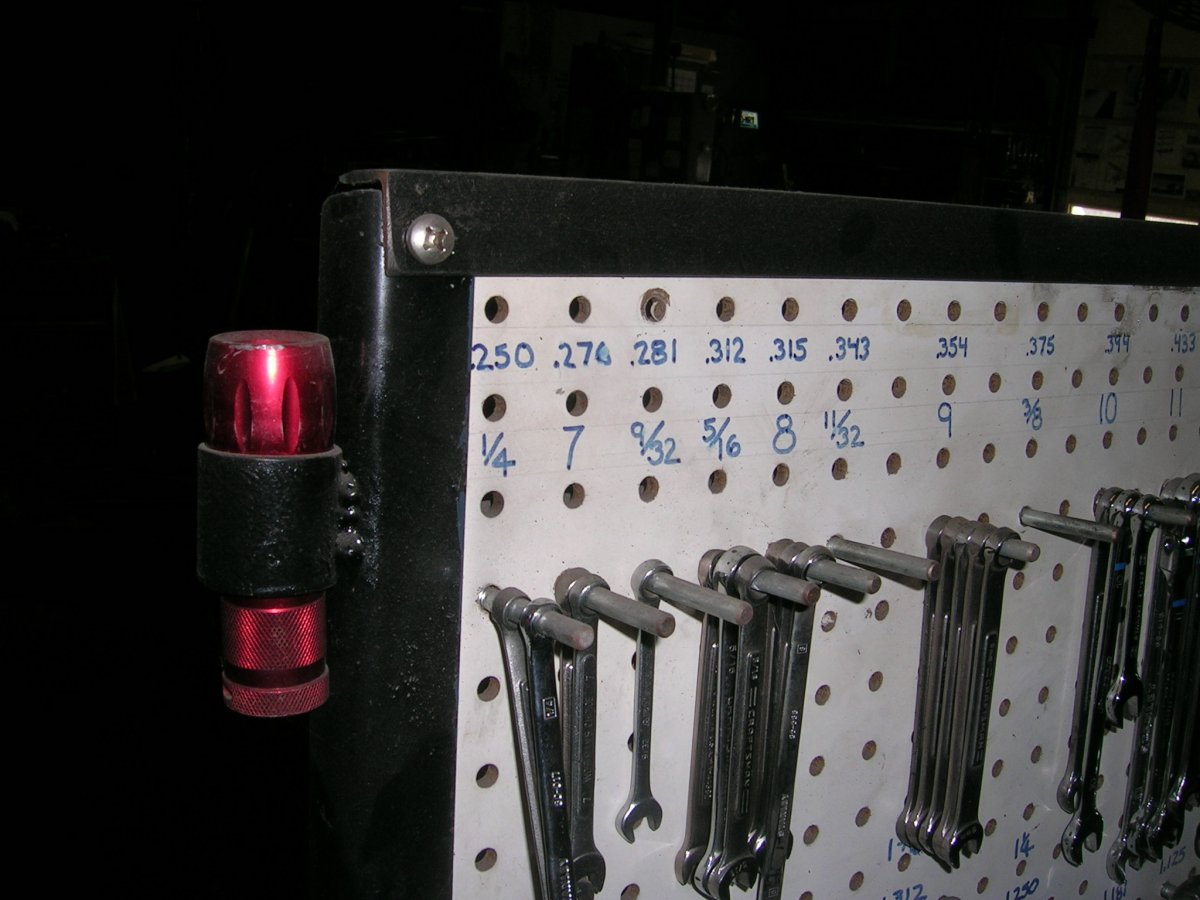

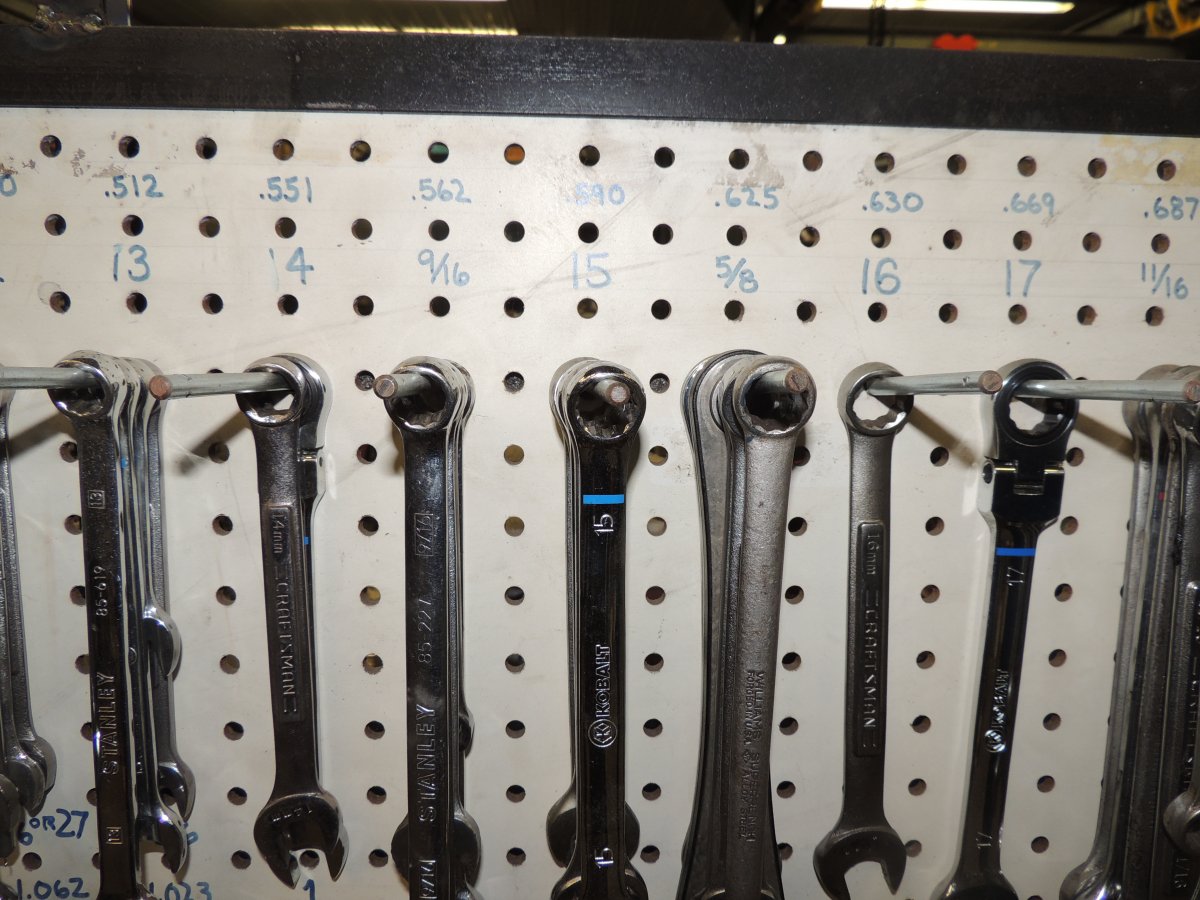

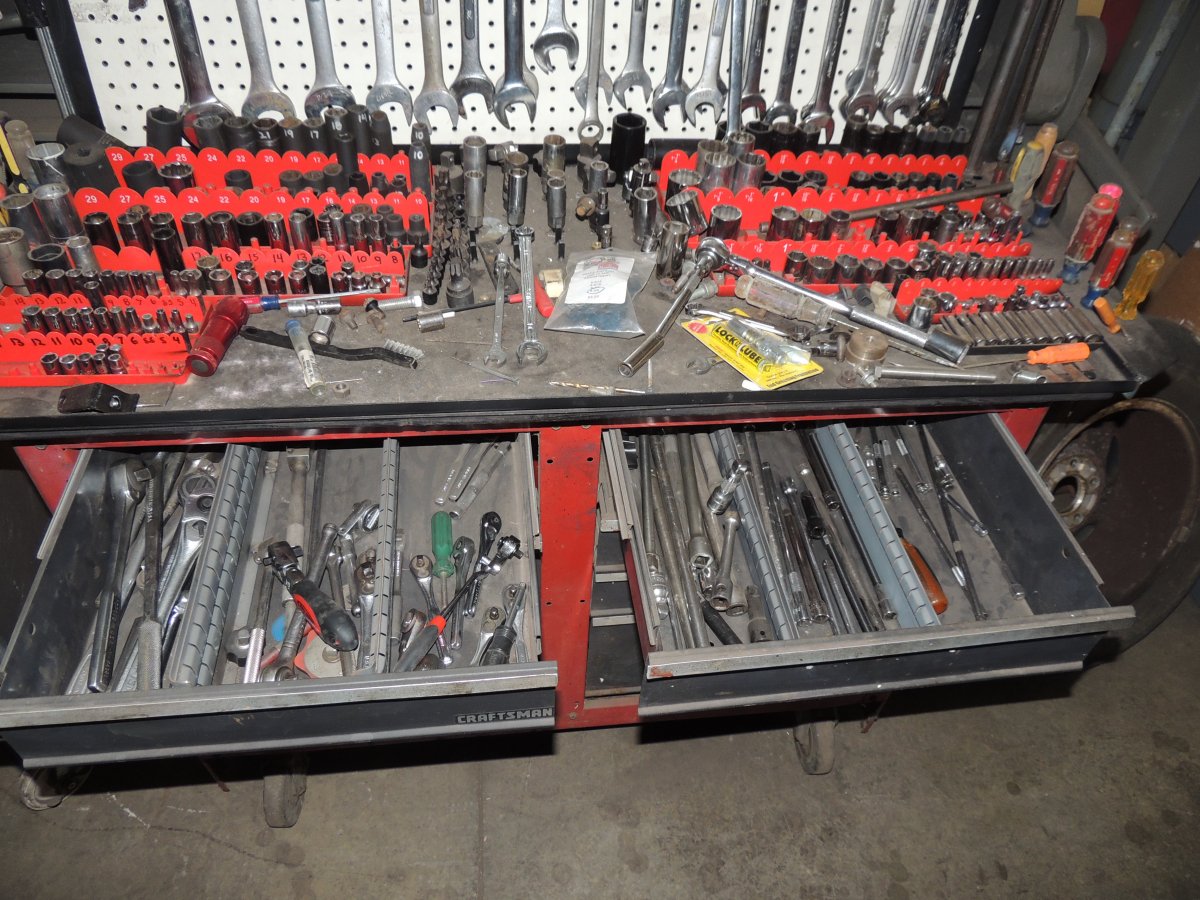

    View attachment 4469727 IMG_1690.JPG IMG_1691.JPG IMG_1683.JPG IMG_1685.JPG IMG_1686.JPG I have some tool boxes that have wrenches in them. I have one for standard wrenches and one for metric. Then I use a separate drawer for each size and the larger wrenches 15/16 and up go in a single drawer. That way all the 9/16s are in one drawer and I can pick the one I want for the situation. If you neatly store them in separate sets, you have to grab different sets to see what works. Its not all neat and perfect but when the drawers are closed it looks perfect.
    Then over by the lift I put a pegboard and just stepped the wrenches by size. Don't care whether they are standard or metric.....just the next larger size. Then when I've got a wrench that doesn't fit I take two steps and hang it on the pegboard and grab the size next to it. Thats for all those times when you are working on a car that has both metric and standard and I always have the wrong wrench. It's really handy.......Its on an old Craftsman workbench and I can roll it wherever I need it, but mostly its parked next to the lift.
    Oh, the sockets are on top of the bench and then ratchets and extensions in the drawers. Got the wrong socket in your hand......just look at the wrenches and see what the next larger one is. DSCN0696.JPG Peg.JPG View attachment 4469727 View attachment 4469728 View attachment 4469729 View attachment 4469730
    Not for everyone but it works great for me............

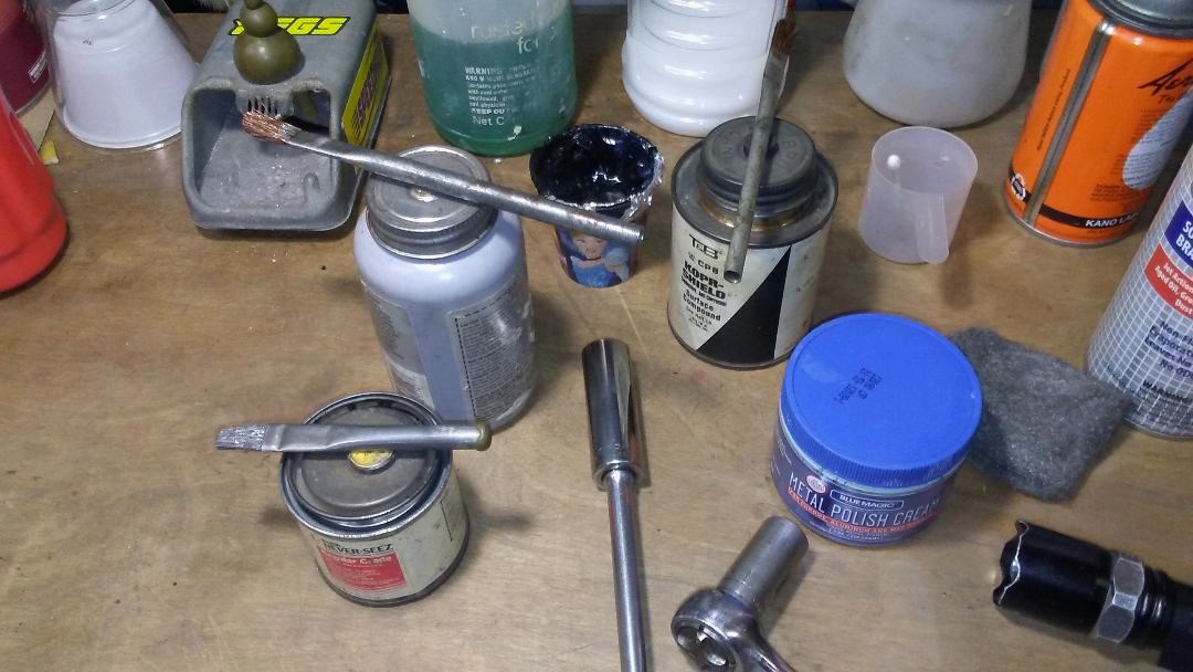

    For most of my projects, the under lid brushes used in cans of sealant, anti sieze and the like, are generally too big or splayed out to use without sloping the stuff where it's not intended to be. I epoxy a ****on magnet to the lids and stick on a glue brush. No more slop and the brush stays with it's own can of goodness.
