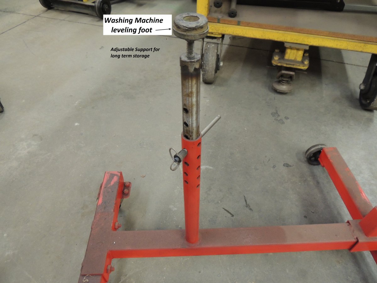

  1. Good idea! Is that support bolted through the base ? As someone else has said, I have had a few Chevy 6's on my stand, and have been leaving it overnight with a bunch of wooden blocks under it. If you listen closely you can hear those stands screaming when the weight goes on!

  2. Dang, guys, I must have found a heavier lift. I hung a straight eight, fully ***embled on it. Maybe just lucky?

    No, it's welded. It is just a pipe within a pipe and some holes drilled thru for rough height adjustment. Then a plug or large nut welded on top for the screw adjustment. It might be better if a "C" shaped bracket was welded/ bolted to the lower part and then the vertical made so it could pivot and lay down when not needed. That would provide extra room for engines with front sump to be rotated. Either way it gives a lot of support and peace of mind......

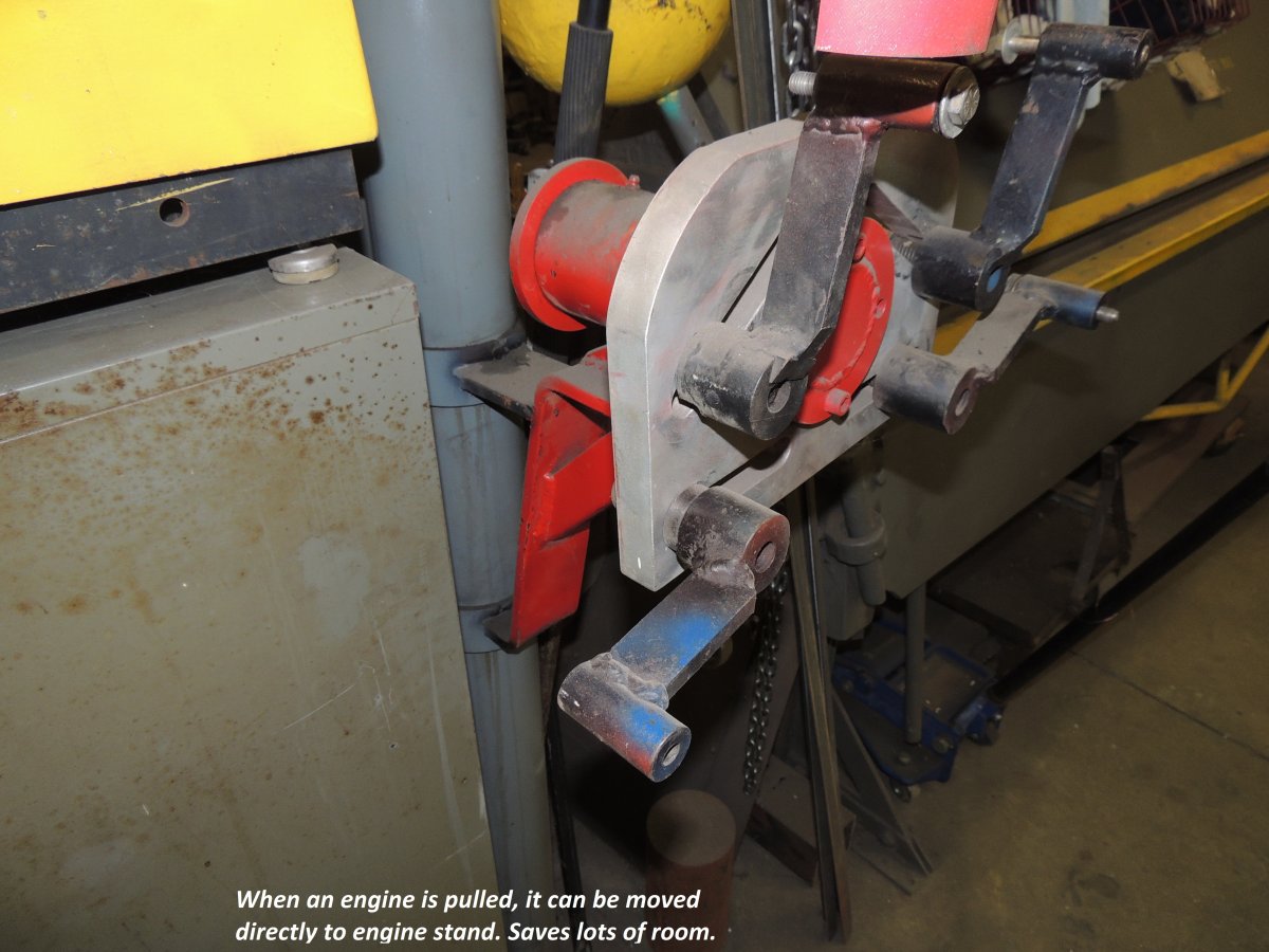

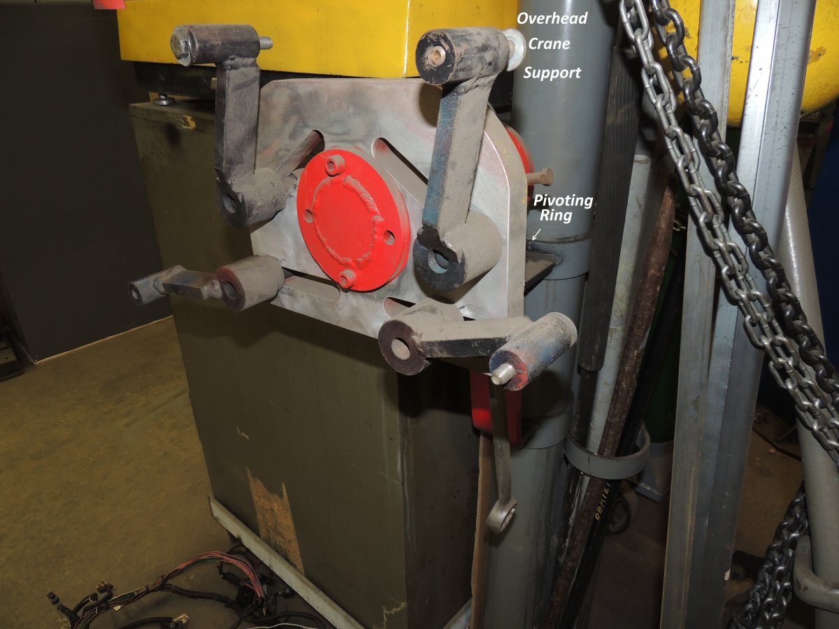

    That looks like a pretty sturdy engine stand even before it was modified, and they did a nice job modifying it. That also looks like a pretty hefty engine in the background. The issues I would have are that it takes up a lot of room for a small garage, and the attachment points/bolts are still no stronger than original. I don't mean to criticize but am trying to be objective. I think the larger wheels are definitely an improvement and would benefit 99% of the engine stands most builders have. I think adding one of the supports like I posted above would allow the engine to reside on the stand rather than a separate pallet and help preserve garage space.
    Its no secret that I think building some type of overhead crane is highly desirable. If round support posts are used, larger sections of pipe can be placed around (slid on) the upright supports, and an engine stand type of adapter welded to them. With a little additional forethought the engine stand adapter can also be made to work as a rotissere for frames and even bodies. I have some things in the way now but the stuff on the left is easily rolled out of the way making mounting an engine very easy. Again, if its an extended stay situation, I put a support under the engines oil pan.
    Eng Stand on crane 2x.JPG View attachment 4501172

    I did a similar thing on my roll a round hoist as Ekimneirbo, mine isn’t quite as fancy, and my hoist has square tubing as up rights. I just pulled the part from a regular engine stand and then welded a piece of heavy pipe to a flat piece of steel and drilled holes in it and a corresponding plate on the other side of the up right and bolted it on. Then I just remove it when not building an engine. Takes about 5 minutes. And I can use the hoist for support, just like , Ekimnierbo, does. Works great. And there is nothing around or under the engine to trip over.
    Those engine stands that have the two legs out front are stable, but I end up tripping over them while working on the engine. While that one that was modified is very stable, it appears to me to be hard to work around. I just imagine it was modified for that engine in the picture. Just hope the pivot pipe and weld is heavy enough.
    As I get older, avoiding falls becomes more important, to me. I don’t bounce as good as I once did!

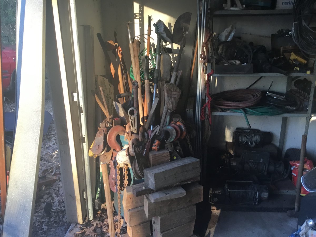

    Thought I share this idea my Dad showed me sixty years ago. While it’s not the neatest looking storage, it’s real effective. It’s just a barrel sitting in the corner. Stores a lot of stuff in a small area and everything is accessible.

    That's cool Bones.
