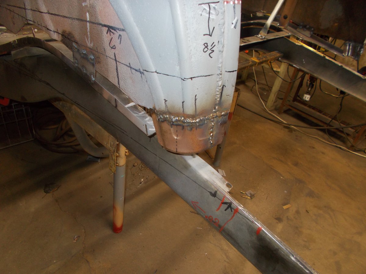

    If you are welding on quarter corners, don't weld within 1/4" either side of the gap, weld in the "crease" is almost impossible to grind... that 1/2" left un-welded will not let the panel fall off... gonna get bondo.
    just did this job... wish I had thought of it earlier...

  9. Not exactly sure what you mean, but I'm pretty sure I could grind anything in this pic with a 2" angle grinder, thin cutoff wheel , and a Dremel . Bondo is porous ,and you wouldn't want water getting at it from the backside.

    I think what he means is the vertical crease (kinda inverted bead). Make your cut and your weld away from that area because it very hard to get weld out of the crease and make it look right when done with the grinding. I was confused at first but I think that's what he meant to say.
