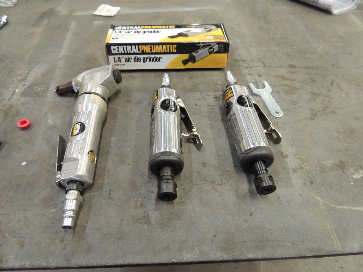

    For the lazy guys like me........
    I went over to Harbor Freight the other day and bought me some more of the cheap air tools. I hate working on a project and having to change back and forth with little burrs,grinding wheels, wire brushes, whatever. PTA ! So I keep buying the little cheap rotary tools (appx $10) and putting whatever I need to use in them. Then I can just grab one of them with the right attachment and switch the whole tool. Works for me.

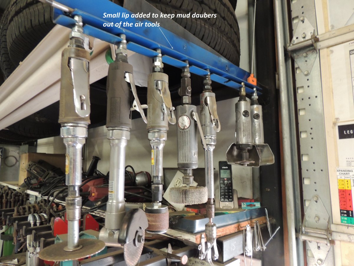

    I also have a problem with mud daubers that want to build a nest in anything with a round opening. They have built nests in several of my air tool fittings, so I built me a couple of tool racks and put a small metal strip over the tip end of the fittings. Seems to work well at keeping the little pests out of them, as well as dust and dirt.

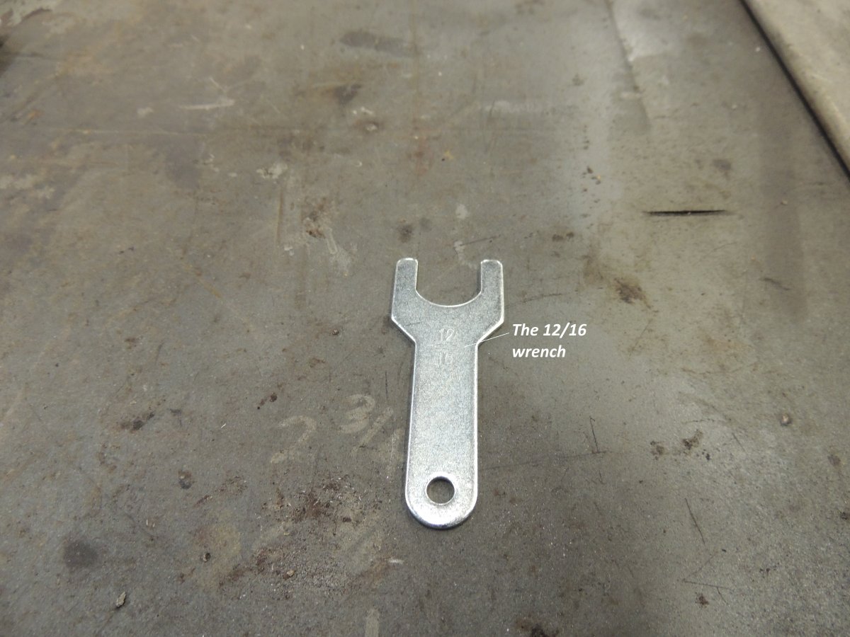

    The "precision" 12/16 wrench that came with the HF air tool. :eek: I also made a little rack that holds the different size wrenches for the air tools. Hate trying to find something that fits so I put them all on a little rack where they hang by a hole drilled in them. Don't use the flat wrenches like the one in the picture very often. I took some old combination wrenches and cut the box end off. Then drilled a hole to hang em up. Made some of them "thinner" so they fit the slots on the air tools. Its really handy when I do have to change something. Forgot to take a picture of it though. So if you hate trying to find a wrench to fit your air tools............

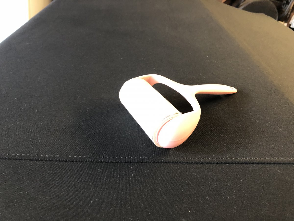

    For you guys with cars that have convertible tops made of canvas or cloth, you know how hard it is keeping it clean...use your wifes lint roller...works great. B87B768A-2AC5-4124-8FA3-FE48288D1671.jpeg

    Thanks. My OT DD Vette is horrible for lint on the black convertible top, I’ll try that.
