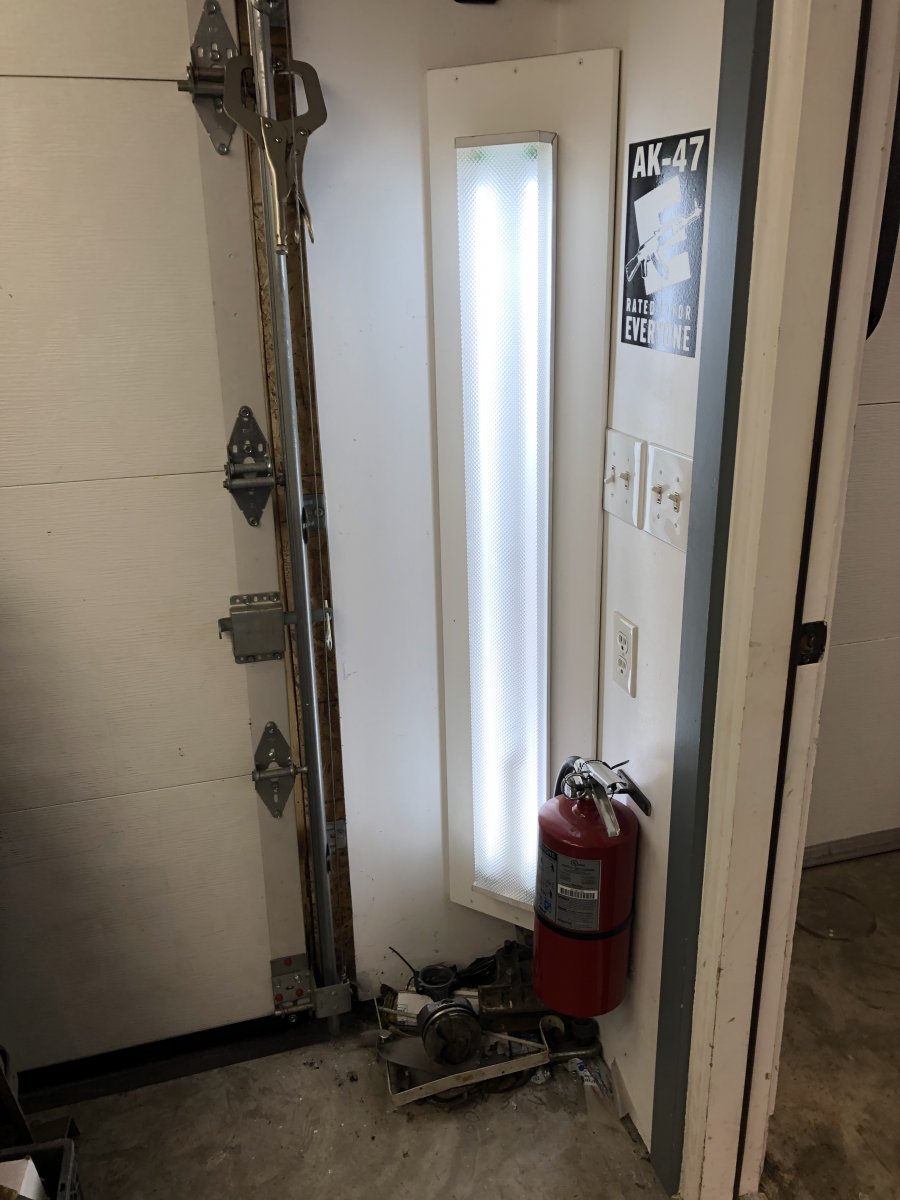

    Good tip on the vise grips on the overhead door track!

    The other very important thing in this picture is the good sized fire extinguisher located by the door.

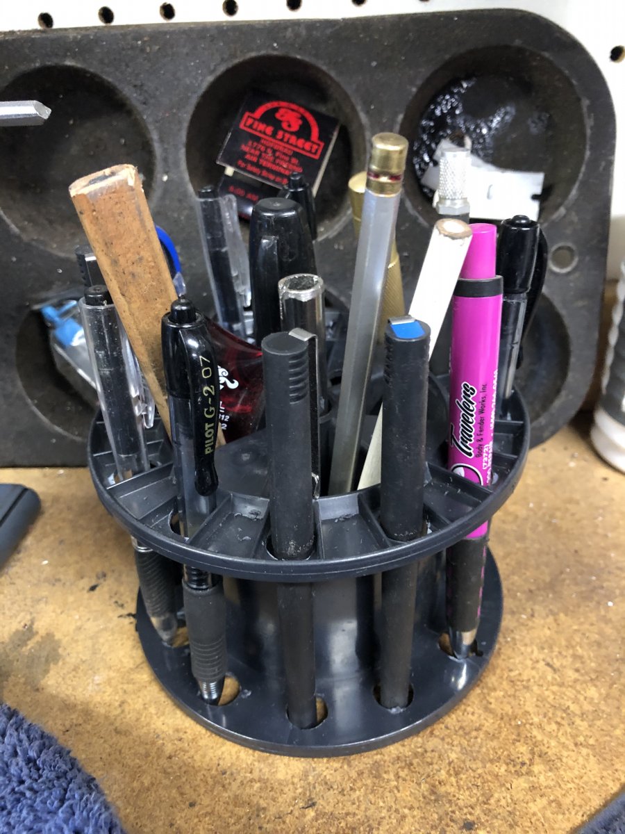

    A pretty simple one for you fishing aficionados out there....save one of your empty line spools....drill a few holes in the rim.....makes a great pen pencil and small tool holder.....never have to scrounge for something to write with again and its just a throw away otherwise. FAF1B8F5-07A0-437E-9AA7-9A524F11445A.jpeg

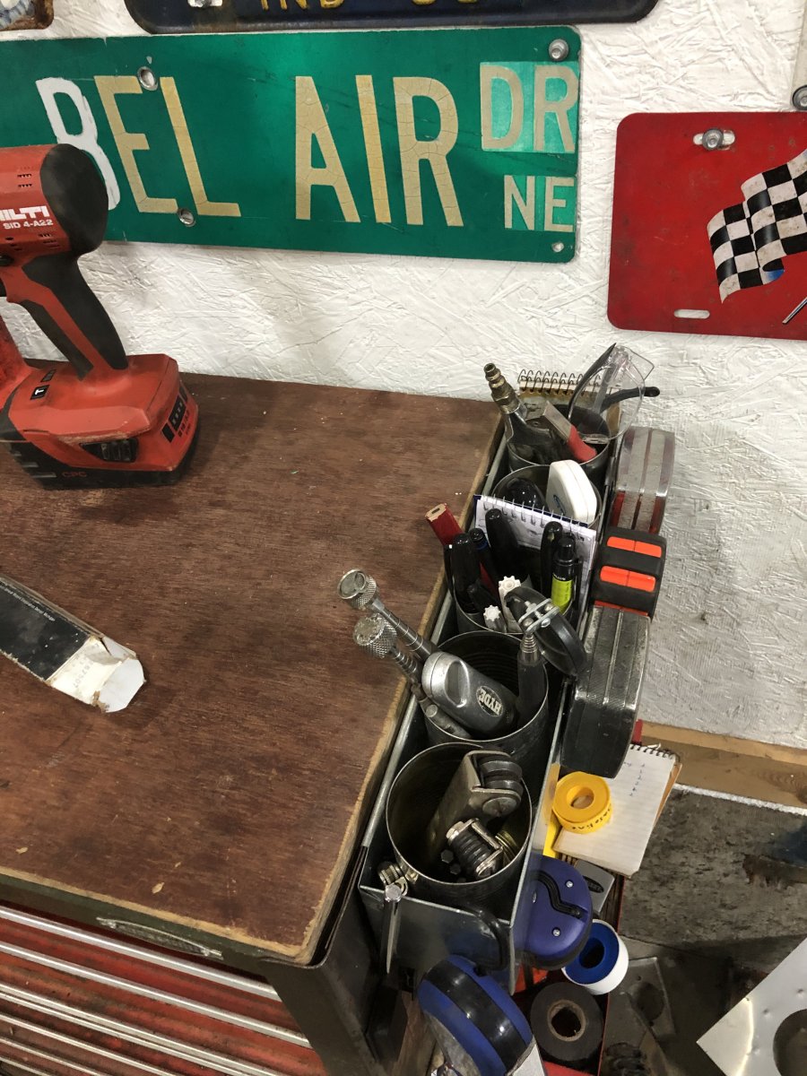

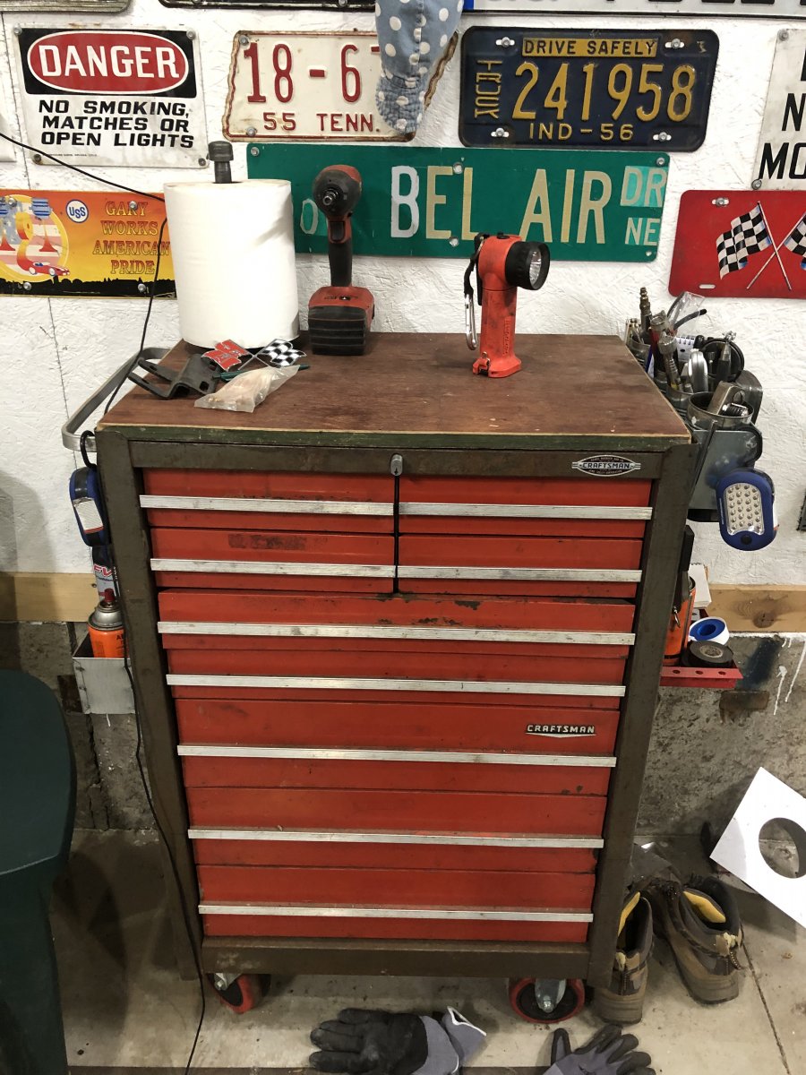

  23. I’m fortunate to have a third bay on my shop that houses parts, tools, work bench etc. So in the main shop I have a single rolling tool box that has about 90% of what I need as far as basics go. It has small side trays that I believe I found on epay you could easily make your own. I found it in the junk yard for $5 then added better casters, I’m constantly refining it. It saves room in the working side and cuts down on walking/time.

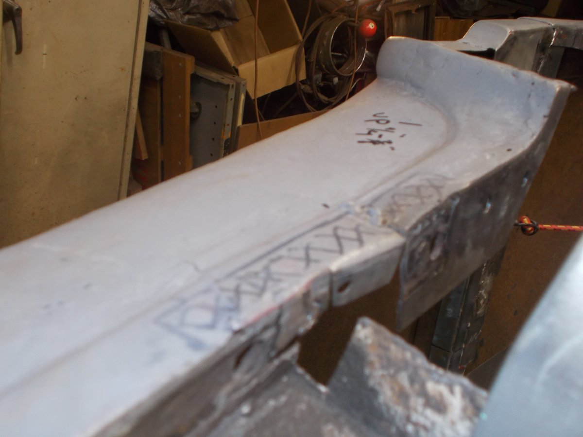

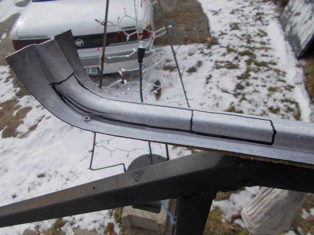

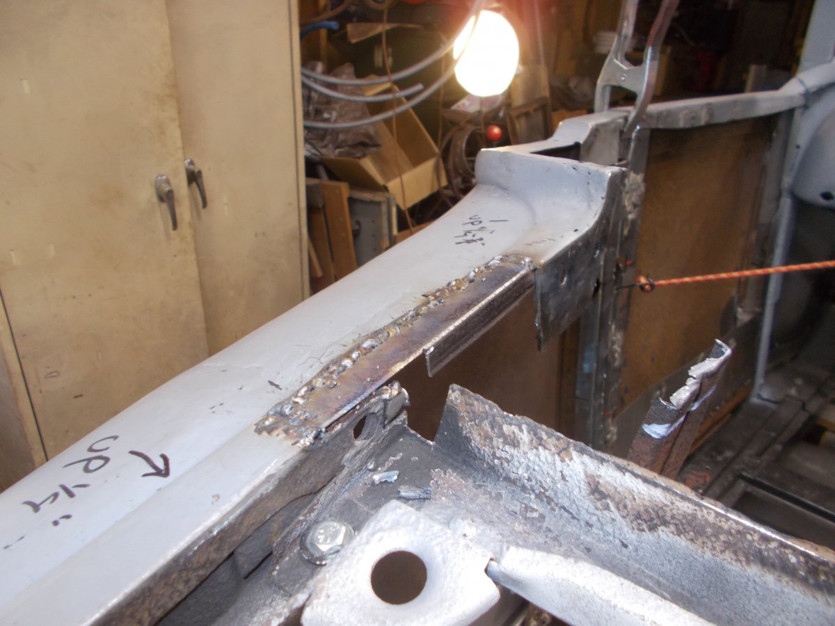

    Newly learned... the cross braces under the roof of a '36 truck cab flipped upside down and trimmed to fix a coupe and roadster tulip or quarter panel...
    .curved section patched the quarter to tulip edge... the smaller piece was split and run across the top.
    used a 6" flat section to fix the very tender bead on the left side...
    chunk of '36 roof support as a patch...
    Could help fix about any make coupe and roadster from about 1928 to 1932...

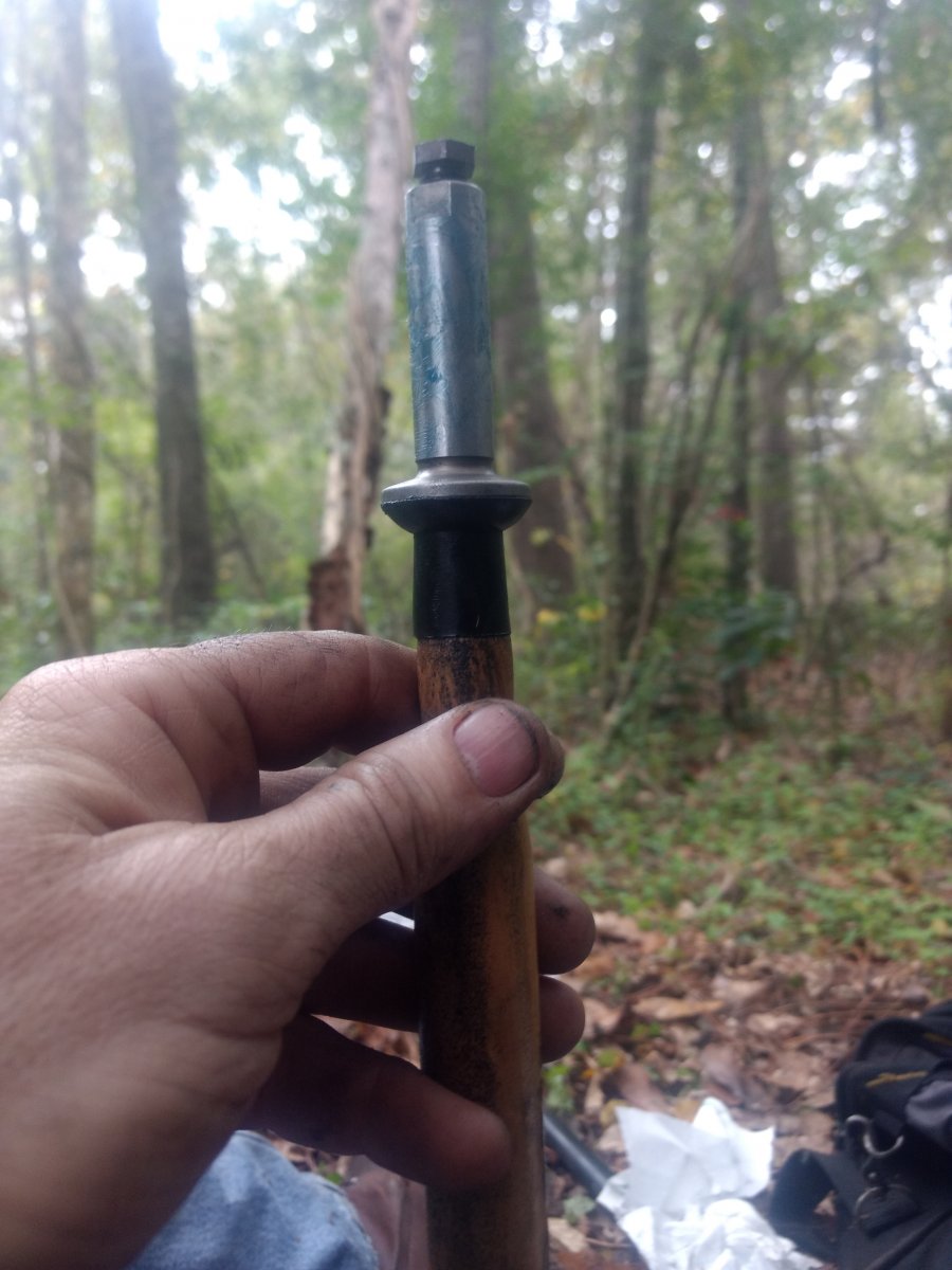

    IMG_20191226_092739232.jpg I don't have a garage, but I was lying on my back in the leaves this morning trying to figure out how to put my new lifters in my Model A motor while it was still in the car, came up with this idea. Worked better than I could have ever hoped.
