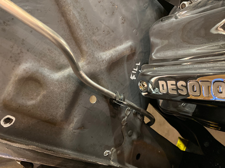

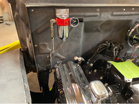

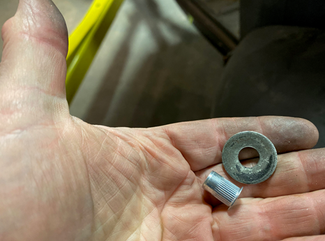

    I was working on installing a fuel line on my truck the other day and figured I would re-use a hole in the firewall (there are a few that need welding up). The hole was too large for a nut zert so I rummaged through the bin of death and found a heavy washer, drilled it out to fit the zert on the drill press, loaded up the zert on the gun, stuck it in the hole, slipped the tight fitting washer on the zert from behind and cinched it down. Worked great. Worth p***ing along.

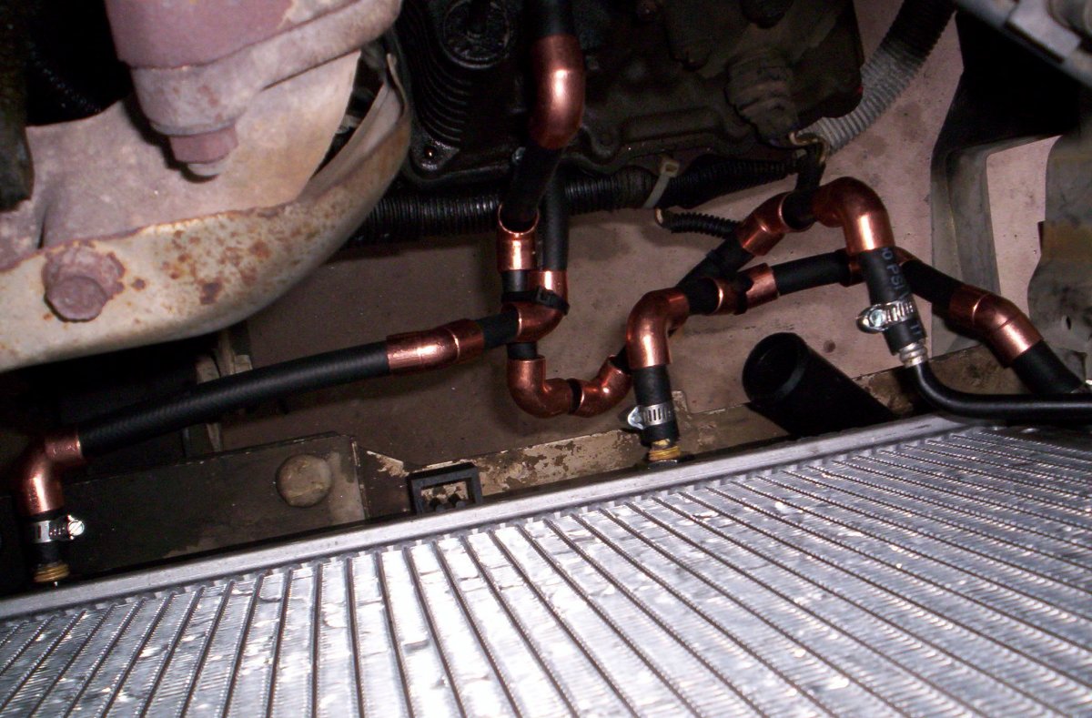

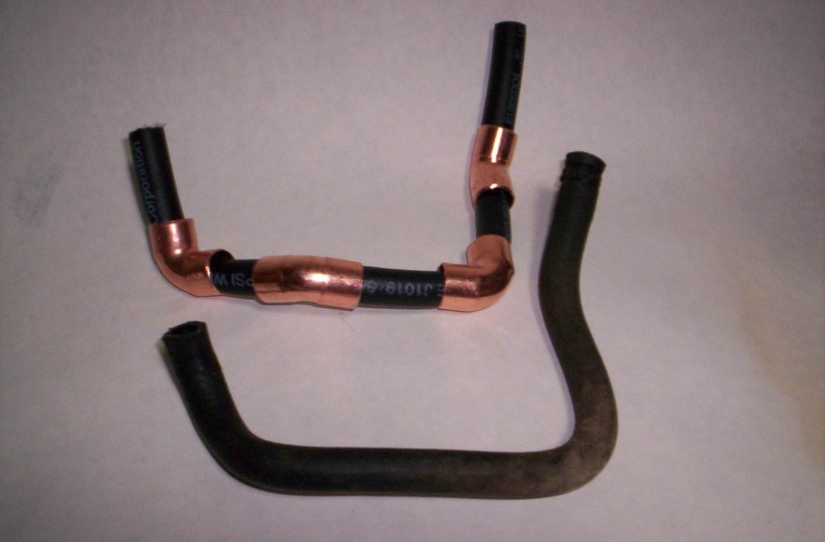

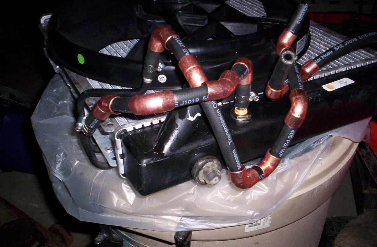

  12. Installing a new radiator in my van before a trip to Ham Drags 5 years ago I discovered that preformed transmission lines were no longer available for my vehicle. I went to Home Depot and bought a bag of these copper fittings with various angles for about $10, lubed and pushed transmission hose through them. Still works great! 100_2510.JPG 100_2510.JPG 100_2513.JPG 100_2513.JPG 100_2513.JPG 100_2510.JPG 100_2513.JPG 100_2513.JPG 100_2513.JPG 100_2517.JPG 100_2517.JPG

    Wow! The hose doesn't kink inside the bends?

    I know it works, but it looks like ***. Just saying.

    Maybe you have a black rattle can laying around to knock the copper off those fittings??

    Great idea but I have one question. Did your parents give you a set of tinker toys when you were a kid? [emoji23]

  18. No kinks at all.
  19. It's just daily driver van.
    Petejoe likes this.
  20. What would you have done?

    Well, I'll bet your way was easier than mine. I'd have been searching the junk yard and or bending them from metal/aluminum brake line. Is it beautiful to look at, hell no, but if it works and keeps your DD on the road, oh well. We cant all be Boyd Coddington

    Nice way to keep a DD on the road without spending a fortune in the process. While not show quality it looks like an economic fix to keep one running. I think most of us have had to do unconventional fixes before.

    I would have bent up steel tubing and used rubber hose to connect the ends.

    You made something that you can't buy and it's completely functional. You done good as far as I'm concerned.

    I agree it isn't pretty but if it works....
    I wonder if you there is a process to heat the hose or something so it learns the new shape and would keep that form after you take the copper off. No idea if it's possible or not just curious.

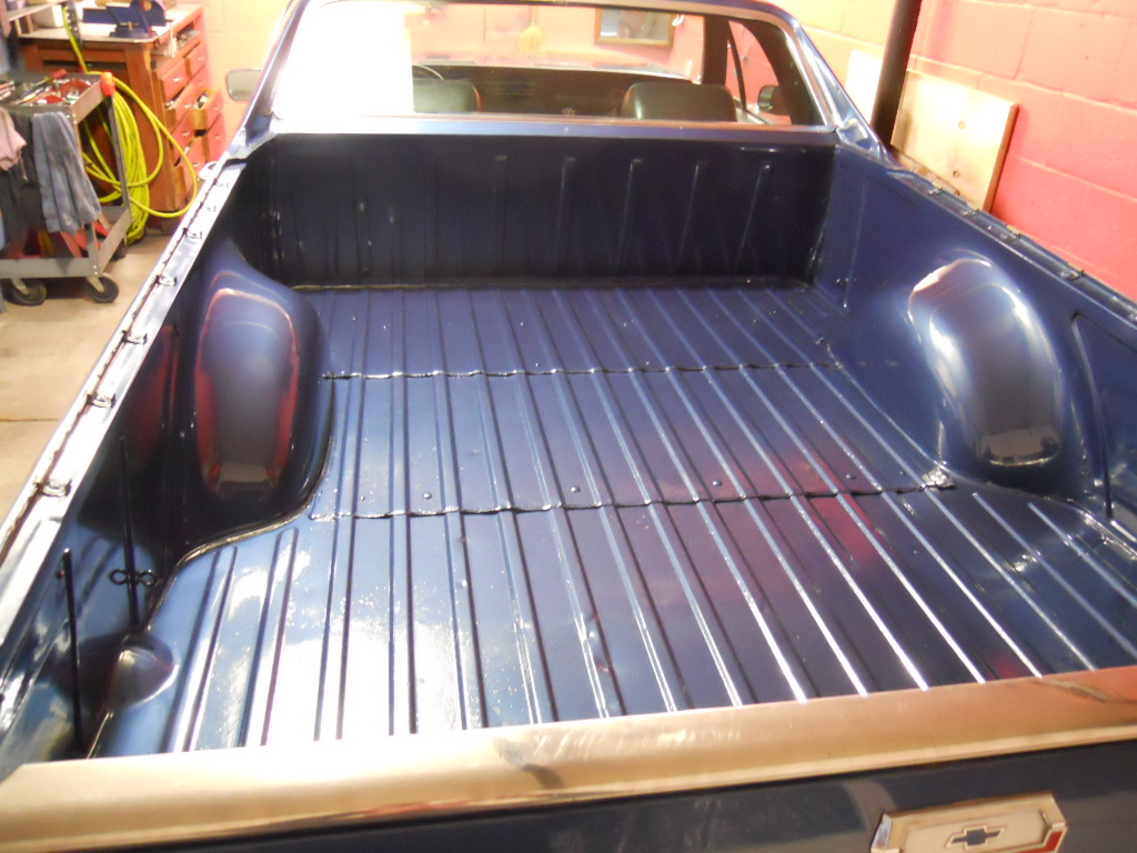

    I keep all of my hand tools on a cart with rollers. Instead of walking back and forth a hundred times I just roll the cart up to the work. You can see the cart in the top left hand corner..

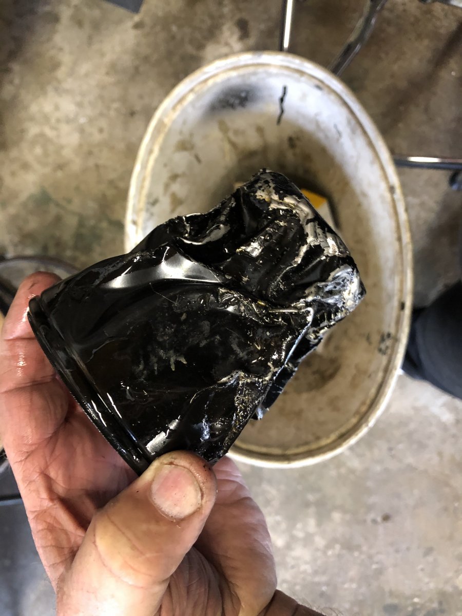

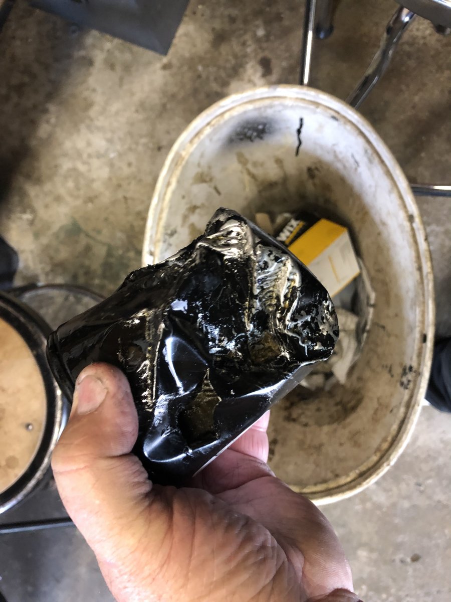

    a little grease on the seal and hand tightening of oil filters will eliminate this kinda nonsense. a result 944A8583-EDD6-44FE-8C0C-7E32F94084F5.jpeg 04D97588-C1BD-4D29-91CC-660B15CCADFE.jpeg of trying to change the filter on a car I just bought, I actually had to remove the oil pan to get this thing off.
