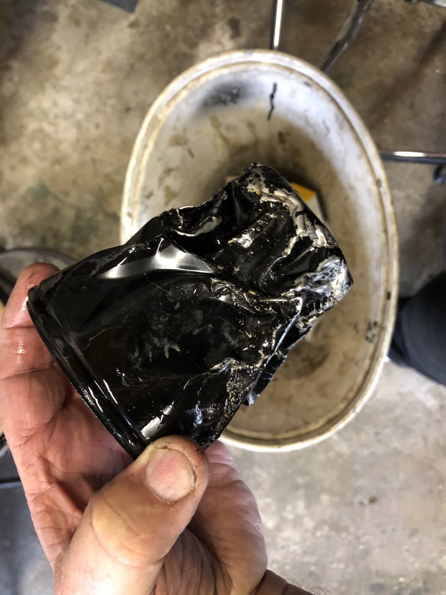

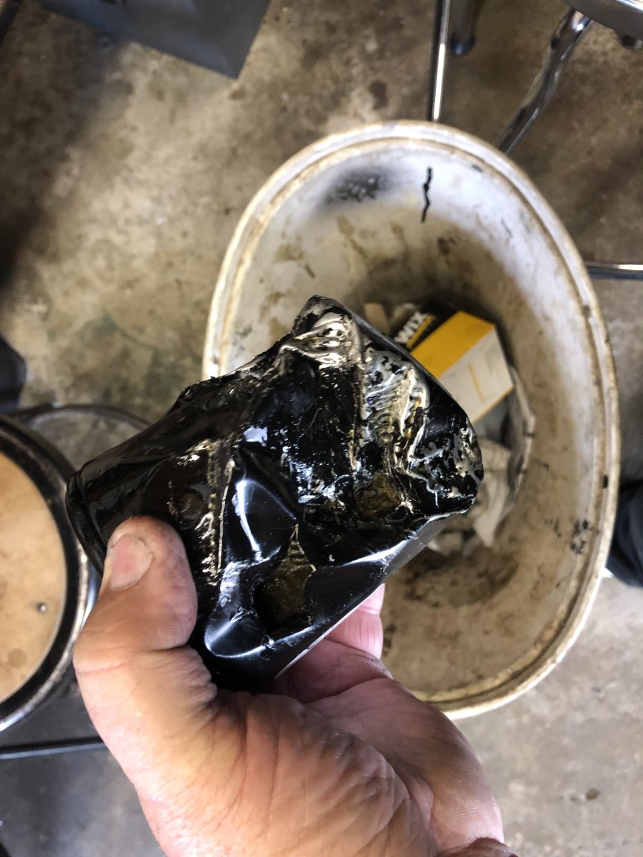

    yea i have several strap and band type wrenches as well...wouldn't even budge it.

    How did you get it off? It looks like there are a lot of channel lock marks on the end of the filter. How did removing the pan help? Able to get better access? What finally got it off?
