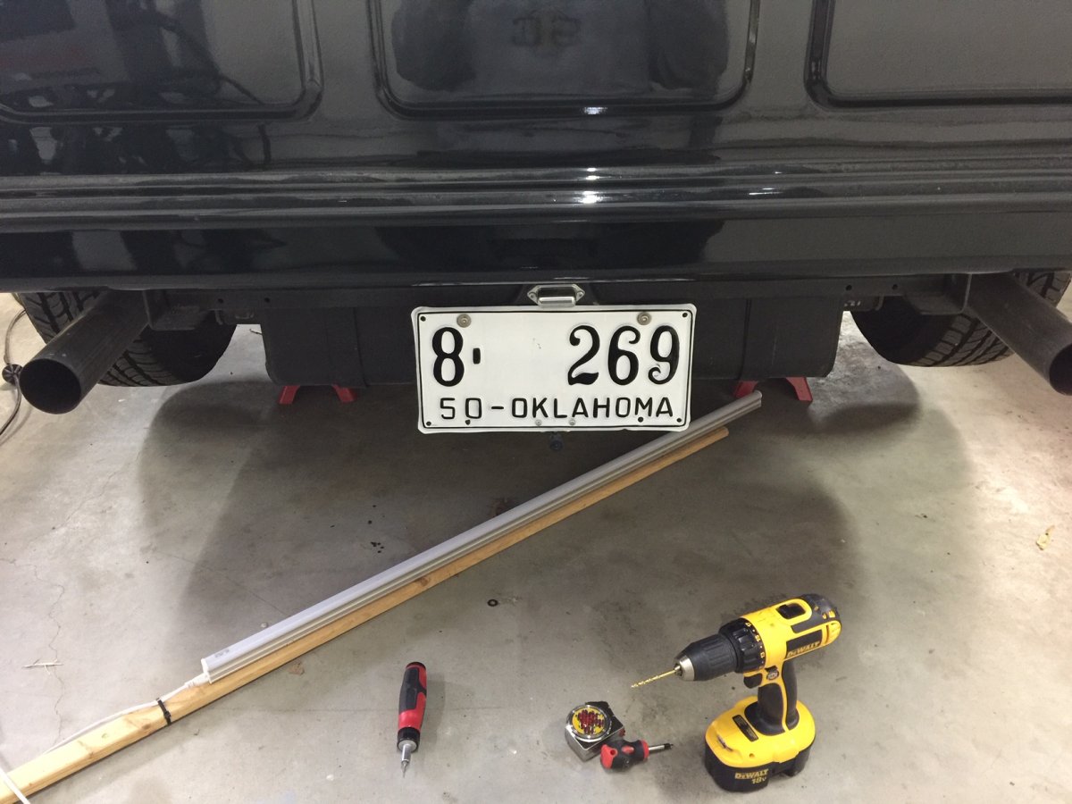

    Here's another use for my left over led lights. I zip tied one to a fairly long wood strip for an under vehicle work light. Works far better than it looks. I'm in the process of working on the interior and have one zip tied to the top as a work light also, works great. IMG_8293.JPG

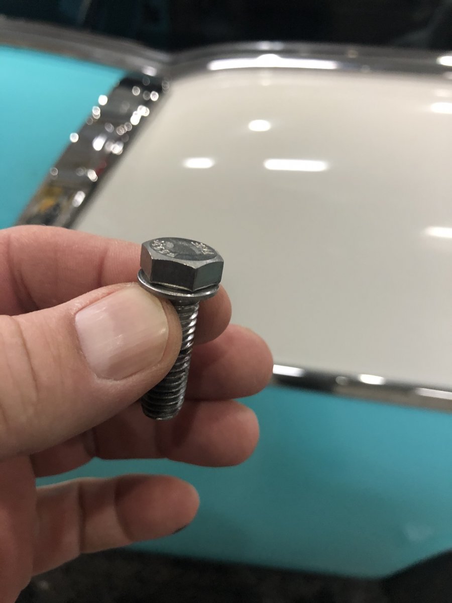

  15. A while back I discovered AN washers, they are easy to find on line, not so much at the local hardware store. They have a smaller ID than most standard washers and a much smaller OD. They are great for intakes because they fit the tight curves nicely. I use ‘em all over on engines now.

    I discovered AN washers many years ago for my race cars. I use them everywhere on my hot rods, unless it's in sheet metal. Then it's fender washers. I very seldom use a standard washer. The AN washers make a much neater job.

    Agree on the AN washers, way neater for many applications. I really like the LED light tie-wrapped to a chunk of wood idea, it's real good illumination under a vehicle right here you need it and if it gets busted it 's not gonna blow up like the old light bulb in a trouble light. I'd probably attach it to a bit wider piece of wood, just for more "slide around " stability. Good thread, great ideas throughout.

    Ditto on the AN washers. Same with these rubber bonded washers. Come galvanized, aluminum, stainless. Work great if your using flat washers do hold something from sliding. I used these on my windshield slides on my Mod A to help hold the adjustment. Works great[​IMG]

    I've done something similar but with the cheap 12v led tape lights. A long wire and alligator clips to hook up to the battery. Got one long one taped to a board similar as yours, but also got 1 that is only 3 leds long (minimum cut length) and glued to a small strip magnet. It's great for working under the dash - simply stick it a piece of metal and fish the wire so it's out of the way. A lot better that a bulky trouble light (and it's does burn ya if you touch it!!!!)

    Yeh, AN washers aren't found at most big box stores but that doesn't stop me from asking the new guy anyway, always get that "Bambi in the headlights" look.

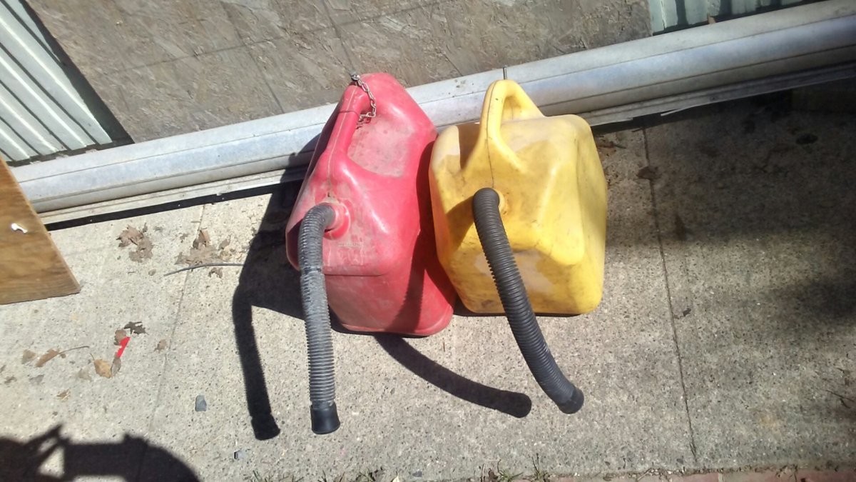

    So in California at least, we have these 'environmentally approved' gas jugs with little 4 inch long spouts. There is no vent hole, you have to either hold a lever or press the spout in to pour fuel, the replacement air goes back up the spout. Takes about 3 hours to pour in 5 gallons.
    I try to be as environmentally friendly as I can but these things are terrible, I spill much more fuel trying to get it in my old cars, tractors and other implements than before they came along.
    Last month, looking for something in my hose bin, I came across an old flex hose, probably from a vacuum cleaner. Perfect fit, JB welded to my gas and diesel jugs, drilled and tapped a vent hole, voila. Fill them up right through the hose. Won't fit in new cars with the small openings of course.

    I had one of those. The spring loaded, push down on it kind. It did, indeed,*****. Spilled more than it poured. Locally, Menards has the solution. CA Menards may not, but Amazon does.
    https://www.amazon.com/EZ-Pour-Gas-Can-Replacement-Spout/dp/B06WRRXG1X
    Mine has been retrofitted. As a bonus, I had another can with a broken spout, so that one got fixed and returned to service too.
