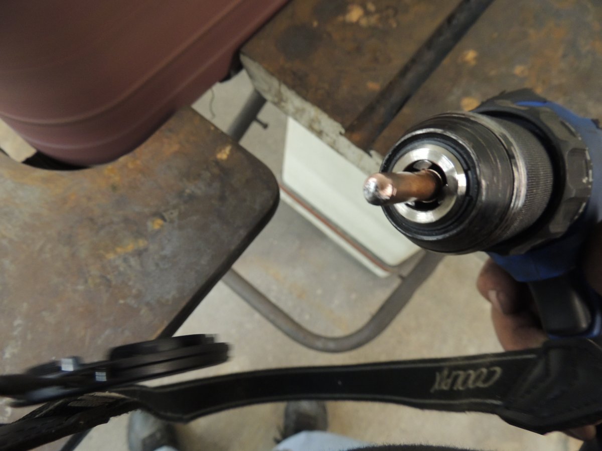

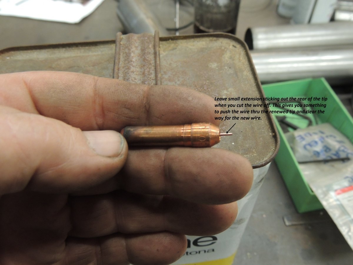

  12. ekimneirbo
    Joined: Apr 29, 2017
    Posts: 5,376
    ekimneirbo
    from Brooks Ky
    Just used your last Mig tip and have no more in the drawer..........
    Remove the tip and put it in your hand drill. Turn the belt sander on and pull the trigger on the drill so the tip is rotating while touched against the sanding belt. Move the whole thing in a semi-circle and renew the end of the tip. The wire is still in it so the hole looks plugged. Push the little wire at the opposite end or tap the wire on a table and as it pushes out the front of the tip it clears the hole. Now you can start welding anew.......

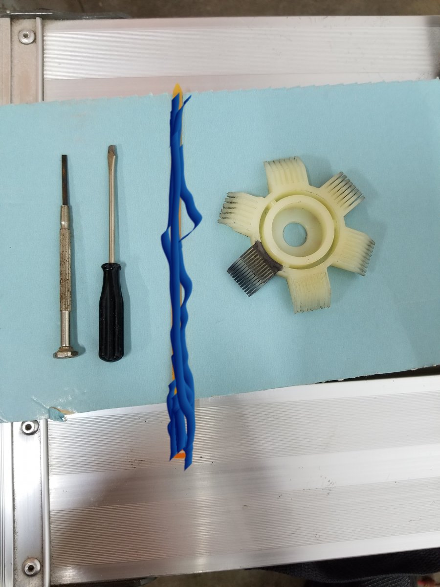

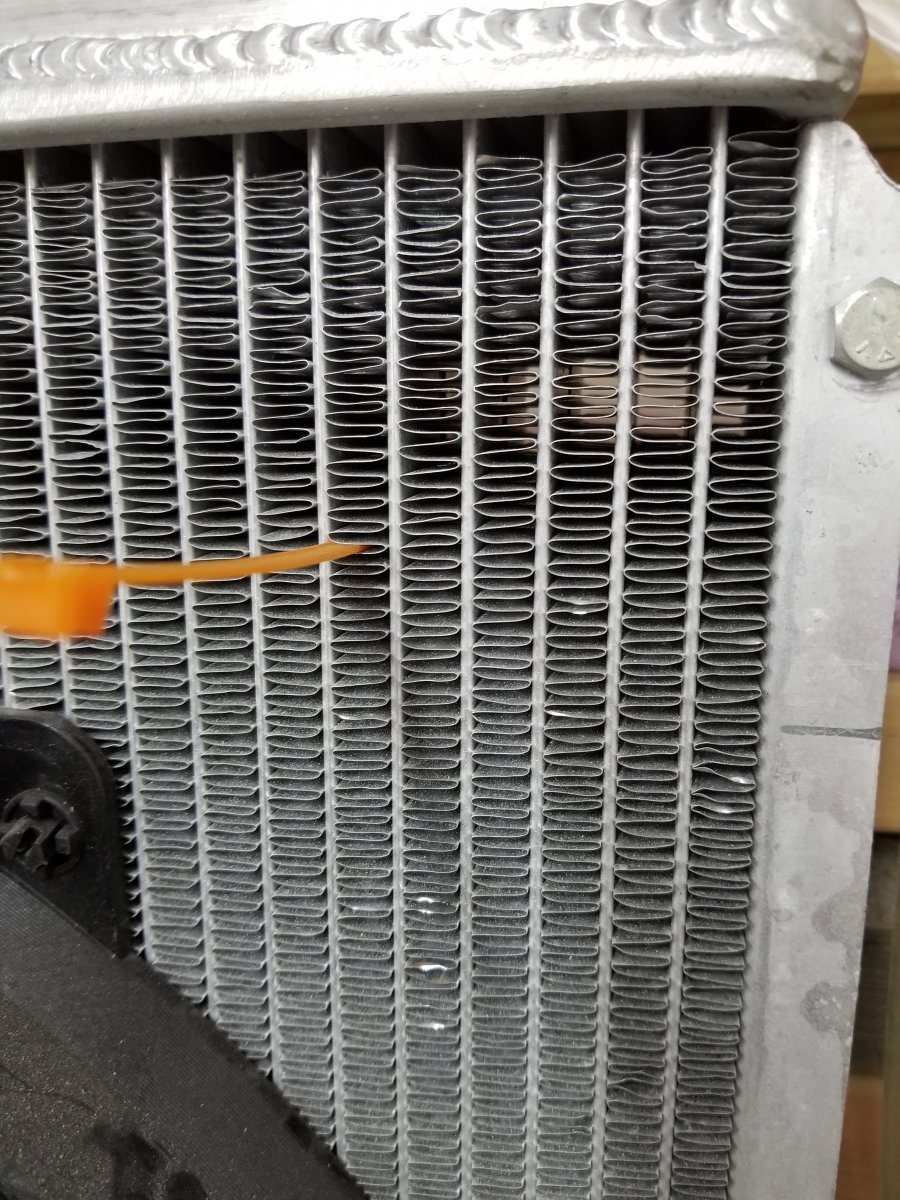

  24. swade41
    Joined: Apr 6, 2004
    Posts: 14,502
    swade41
    from Buffalo,NY
    When straightening those pesky bent fins on your radiator, forget the normal tiny flathead screwdrivers and that screwy radiator comb thingamajig.
    And get your secret weapon out, the plastic cable tie......insert it from the opposite side of the radiator and it'll push those pesky bent fins sttraight... but wait there's more...you can also work it like a sawing motion towards the tubes to get right in those places you can't reach !

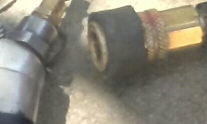

    Jack stand condoms, made from radiator hose. Portable air, made from an old propane tank. 11.jpg 22.jpg
    I attached an old Harley rotor to one of my floor jacks. Makes a nice platform.
