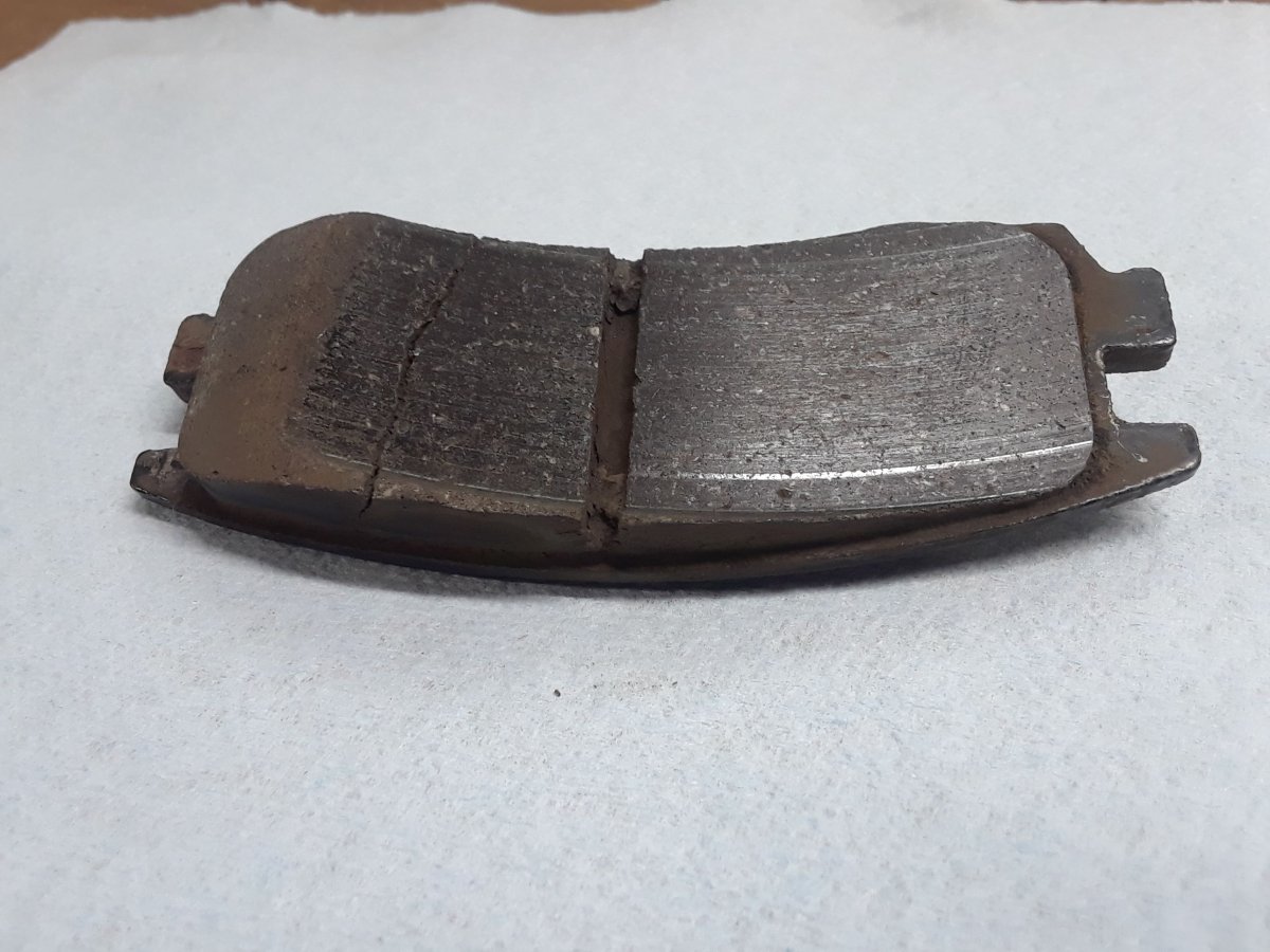

    Another thing I learned about a month ago. This happened to be on an OT car but many of you (me included) have disc brakes on our hot rods so this applies to lots of our old cars as well.
    When replacing brake pads on disc brakes be sure to get those little clips in correctly. Whoever did the brakes on this car previously didn't and here's a pic of the result: Buick brake pad installed wrong4.jpg Buick brake pad installed wrong2.jpg
    Note: that's just an old chisel propping up the pad to vertical in the 2nd pic.
    Also note: I guess that the weird stresses that this put on the pad by the piston caused the steel part of the pad to bend and the lining to crack.
    Note for the third time: it's only by dumb luck that I was changing this before it got into metal on metal contact. I was doing the fronts anyway so bought the rears at the same time. This was a rear, which I didn't think was needed, but decided to change while I was doing the front. I knew I would be hot/dirty anyway...

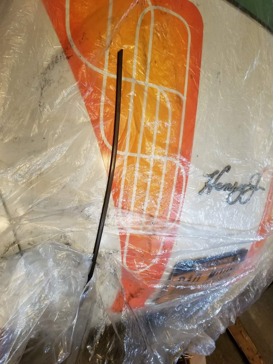

    For cheap flexible strip magnets to hold things like dust/paint covers on curved body panels go to your old fridge's seal and cut them out, they work great for lots of things....except pacemakers.

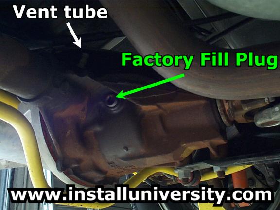

    Very Obvious But Sometimes Over Looked...Make Sure You Can Remove The Fill Plug Before You Remove The Drain Plug On A Transmission/Rear Diff.... factory_fill_plug_locator.jpg
