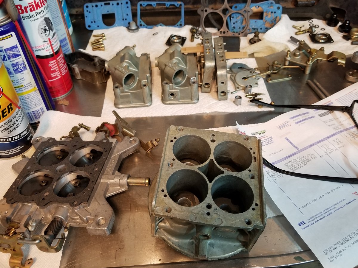

    When dismantling your Holley carb (or any carb) for a rebuild use your heat gun around the gasket areas to soften the hard stuck gaskets and they'll come apart much easier. It'll also make it easier to s****e the gaskets, in the same fashion dropping small parts with stuck gaskets in a gl*** of hot water will almost make the gaskets just fall off.

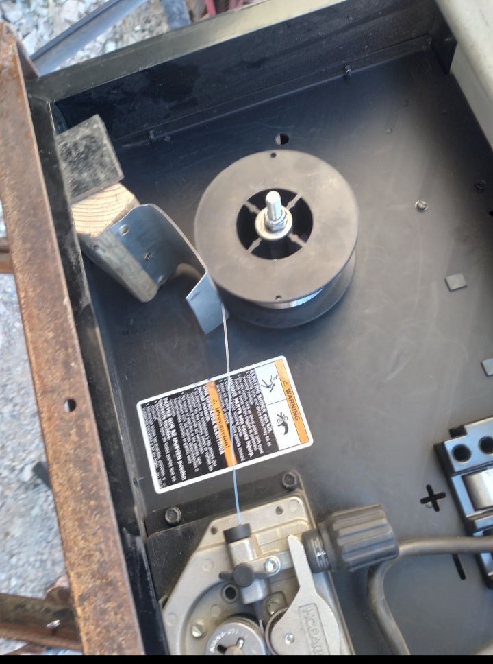

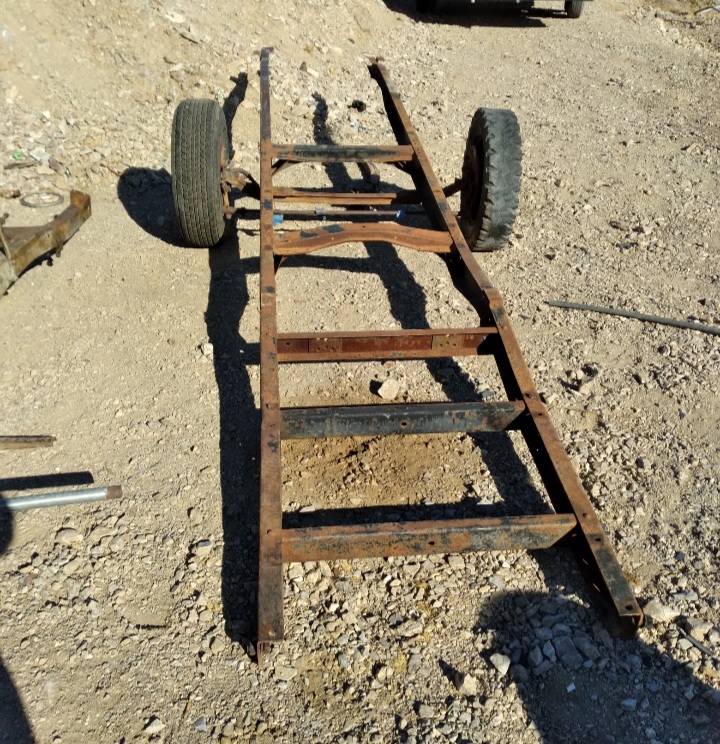

    If I have the space..I move frames like this
    If your wire in your welding machine likes to bird nest,build something like this and you wont have that problem

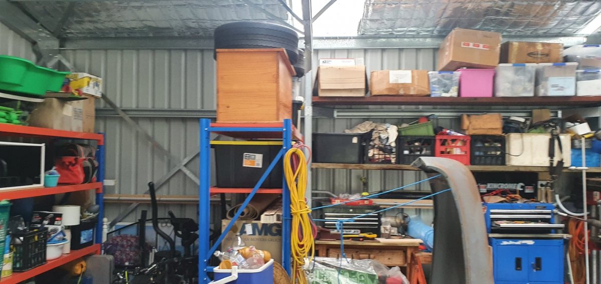

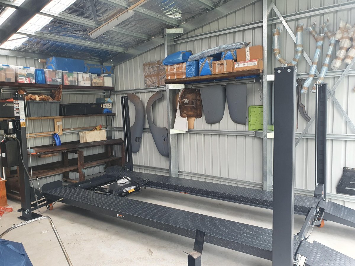

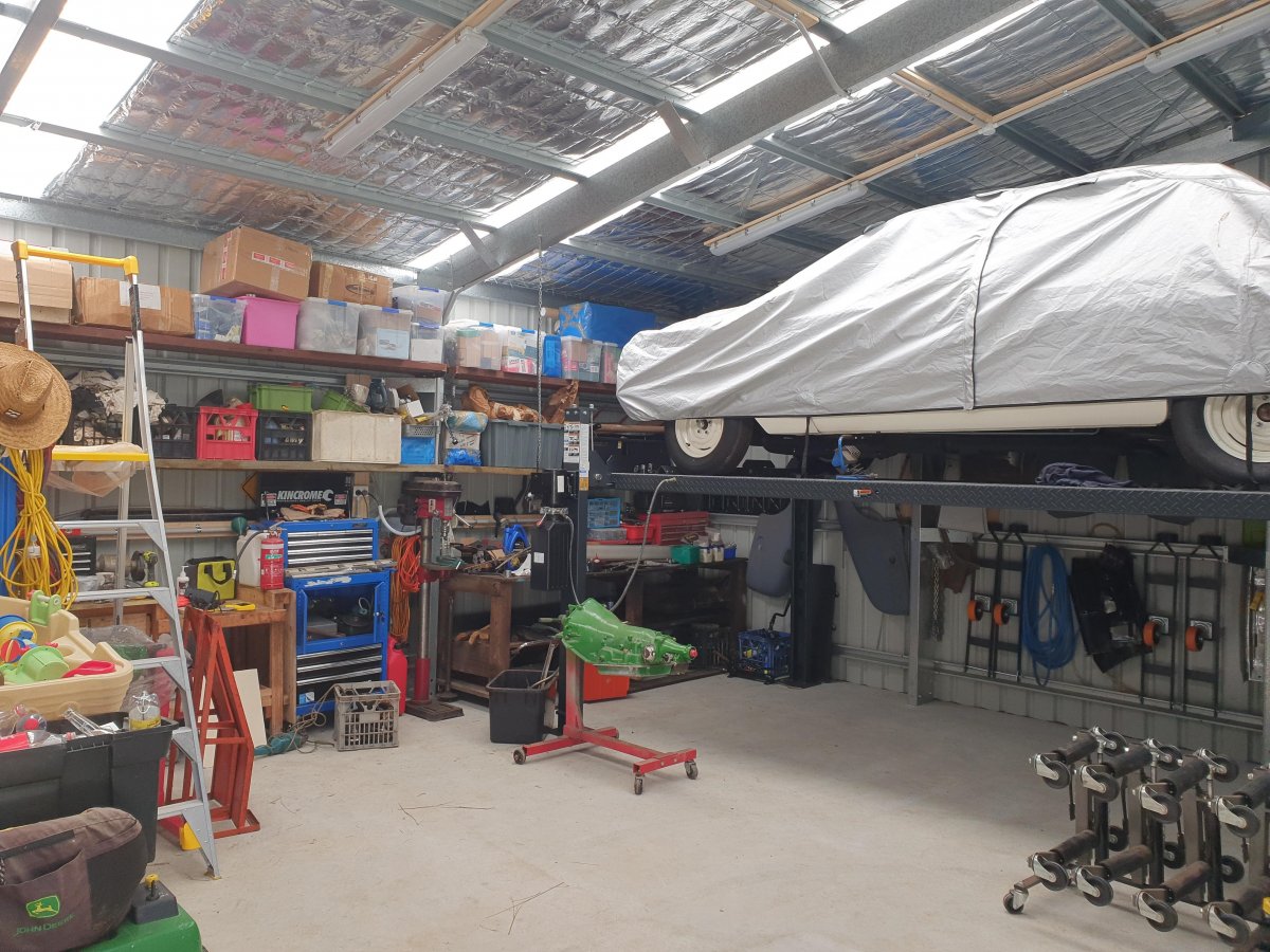

  28. mgtstumpy
    Joined: Jul 20, 2006
    Posts: 9,279
    mgtstumpy
    You never have enough off floor storage so shelves are a must. Use every available wall space (Above head and within safe reach), then there's less to trip over on the floor. Also power outlets and access to them as well! The only proviso is that you need to get organised!
    Old 2-bay shed
    - Shelves across rear wall and 1/2 way down each side. It's amazing how many boxes you can fit and what they can hold.
    New 3-bay shed - Shelves across back wall and down each side wall again in addition to 2 x panels of 4-shelf racking. I also use heavy garden hooks for hanging panels and components etc on the walls. That hoods now hanging on the wall as that was move-in time.
  29. Mart
    Posts: 5,005
    Mart
    Re the mig wire birds nest.. On mine there is a spring on the central hub that provides a drag to keep a tension on the wire. In the pic above a spring could be fitted between the nut and washer. That might help somewhat.
