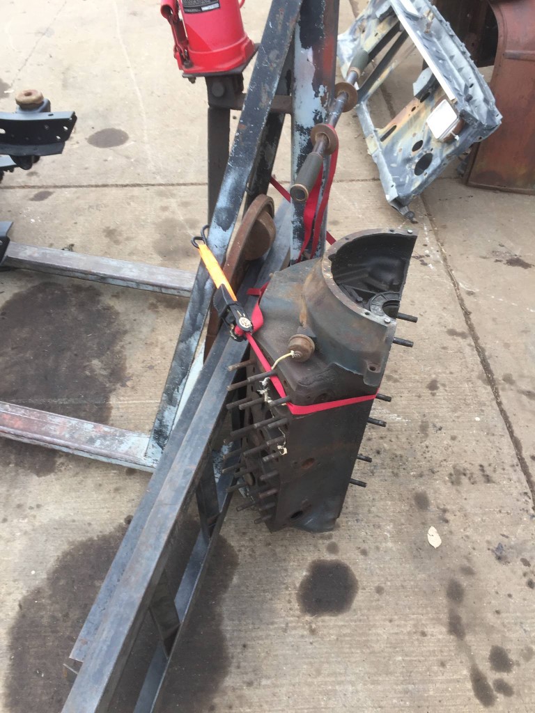

    If you find the load is a bit heavy for your cherry picker; it helps to add a little something for counterbalance.

    I added angle iron bracketry to the back of my cherry picker to hold concrete blocks 2 wide and of course if more than two are needed I can stack them. I'd be a bit leery of just a small strap holding that weight and my feet back there if the strap broke. Those main cap bolts would easily stab through a foot

    The ramps were between the main post and braces and the block was sitting flat on the section of truck frame (yellow arrow) that holds the caster; the strap really wasn't holding any weight. The OT thing my kid was lifting was heavier than the old coupe body we used the cherry picker on in this picture.
