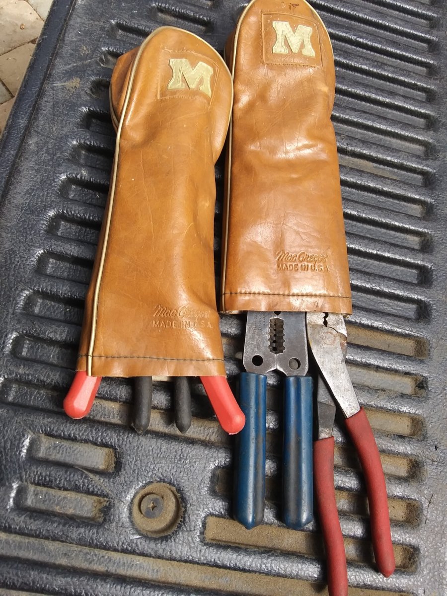

    A friend recently gave me a set of gold clubs he picked up somewhere. I've discovered the covers are perfect for storing the pliers, cutters, strippers and scissors I carry in my truck tool box, instead of having them loose, snagging and pulling half the tools out with them.
    If anyone has a good use for the golf clubs and bag let me know.

    My father-in-law, a golf fanatic and never a fan of my cars, just rolled over in his grave.

    I just thought of another use for the golf club covers. They are used to cover the heads of the "woods" and the 1 wood is called a driver. So put one on your floor shift handle when it's parked and take it off when you go to Drive!

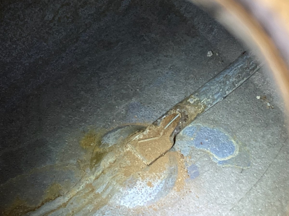

    So I had my shoebox gas tank hot tanked and flushed out at a local shop. Afterwards I decided
    to make sure the pickup tube was clear. I took some mechanics wire and put a little kink in the end, put it in my
    drill and proceeded to run it through the tube. I slowly worked it back and forth from one end of the tube to the other. I was surprised at all the grit that I cleared out. Initially I started with a thicker wire and it would not feed through the tube. This is something to keep in mind when when running a nice new 3/8 line for high HP setups from your old tank.

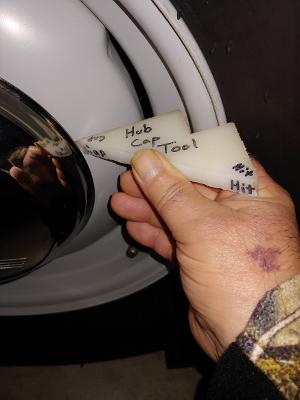

    Tired of scratching your wheels trying to remove the hub cap?
    I use this little goodie I made from a s**** piece of nylon. Works like a champ!
  25. Elcohaulic
    Joined: Dec 27, 2017
    Posts: 2,213
    Elcohaulic
    I made one today and it works like a charm!! The baby moons on my cousins car are a royal pain in the *** too.. Thanks brother..

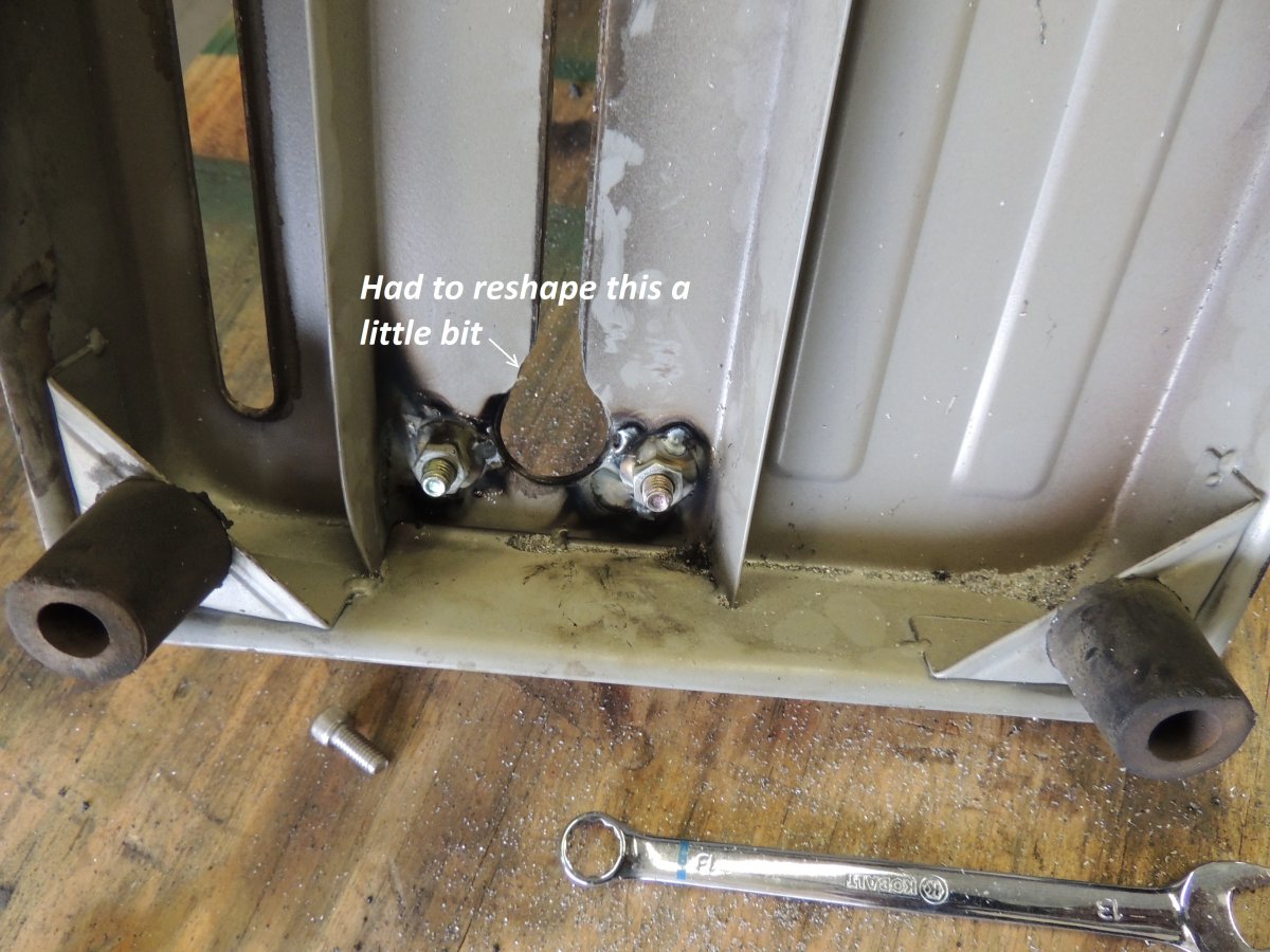

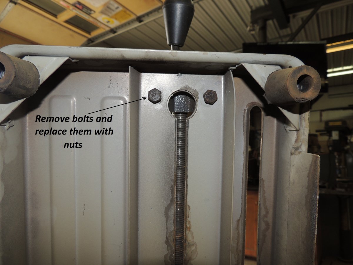

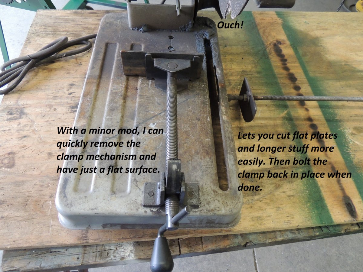

    I misuse and abuse my chop saw regularly. Often the clamping device is in the way of what ever I'm misusing it on. Notice the latest "nick" in the blade. Anyway I removed the clamp by unbolting it and then welding some nuts on the bottom. A little reconfiguretion of the hole so the slide comes out easier. That way its easy to take it off and reinstall it. Makes it easier to cut plate material and other non-conforming parts. Wear gloves and gl***es........

    Surely you've already replaced the damaged blade before it explodes and causes someone great bodily injury!
  29. Fortunateson
    Joined: Apr 30, 2012
    Posts: 5,729
    Fortunateson
    Yeah get rid of that potential rotating bomb!
