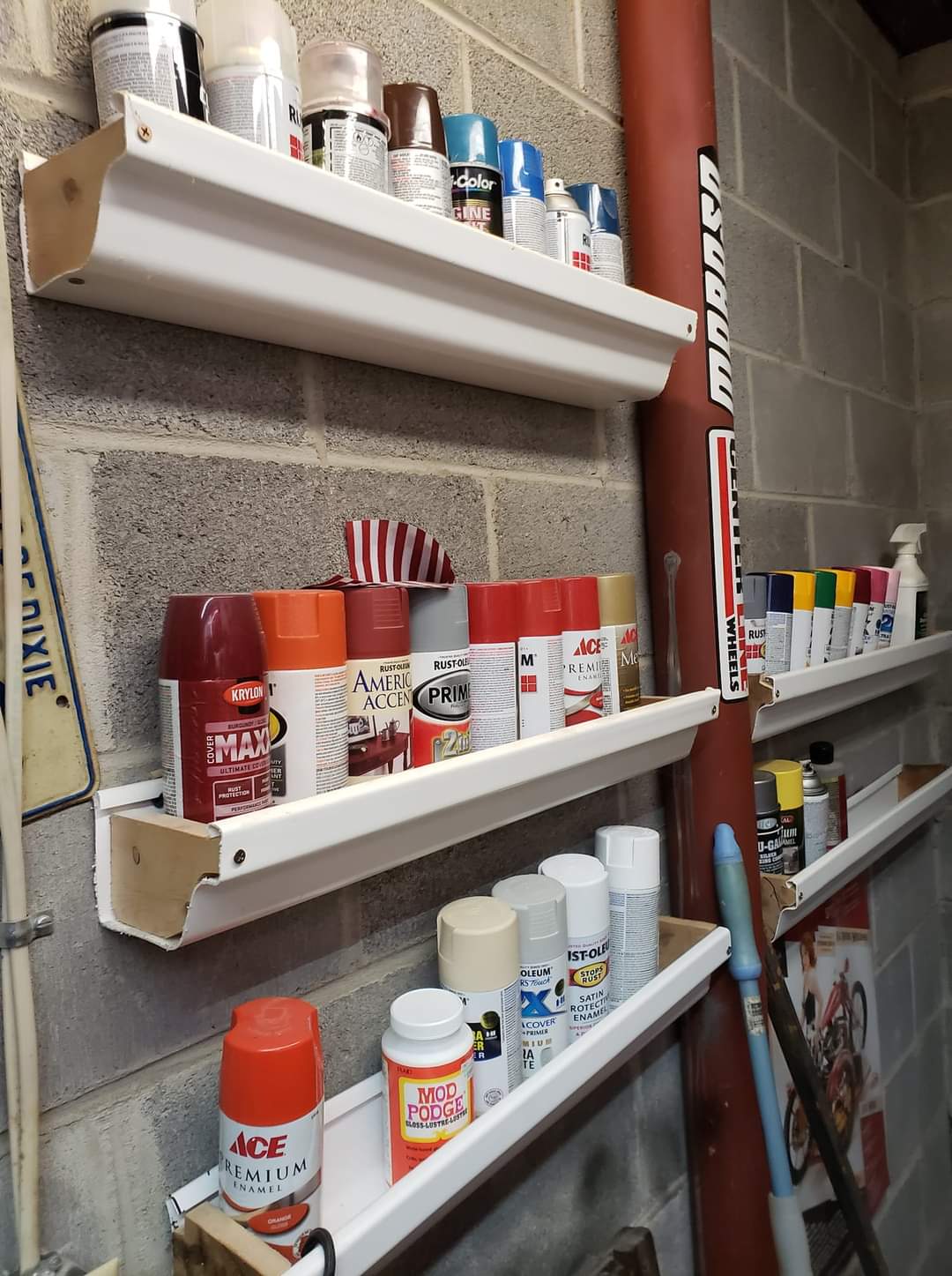

    I seen this posted elsewhere but thought it was a good idea

    Cool idea. With some "S" hooks you can hang stuff off the front of those too.

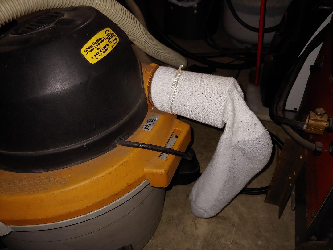

    I got tired of my shop vacuum exhaust blowing on everything and creating more dust.
    Found a plastic cup with a taper to the sides (old Tupperware), and cut the bottom out.
    Wedged it into the exhaust outlet port and tied an old sock to it.
    Works like a champ!
  12. Doublepumper

    :eek: You have old *******? o_O
    You're not wearing them in place of socks....are you?

    I use wife old hose. I think sock would be better.
  14. So....when your wife asks about the ******* in your glove box, she actually believes it when you tell her they are 'auxiliary shop vac filters' ? What a silver tongued devil you are!
