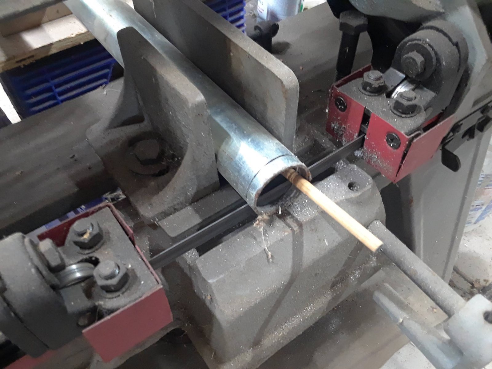

    Not much of a tip but useful to me. When cutting a pipe (or anything hollow) on the horizontal bandsaw after the blade has made its way downward far enough sticking a piece of wooden dowel or metal bar stock inside will catch the off fall and save you the trouble of picking it up off of the floor. b-t-w; the round stock just rolls on top of the blade. No harm is done to it other than the discoloration due to contact with the (by now filthy) smooth side of the blade. Many (most?) of you are in my age bracket and understand the inconvenience/discomfort of picking up things from the floor. 20210831_101316.jpg
