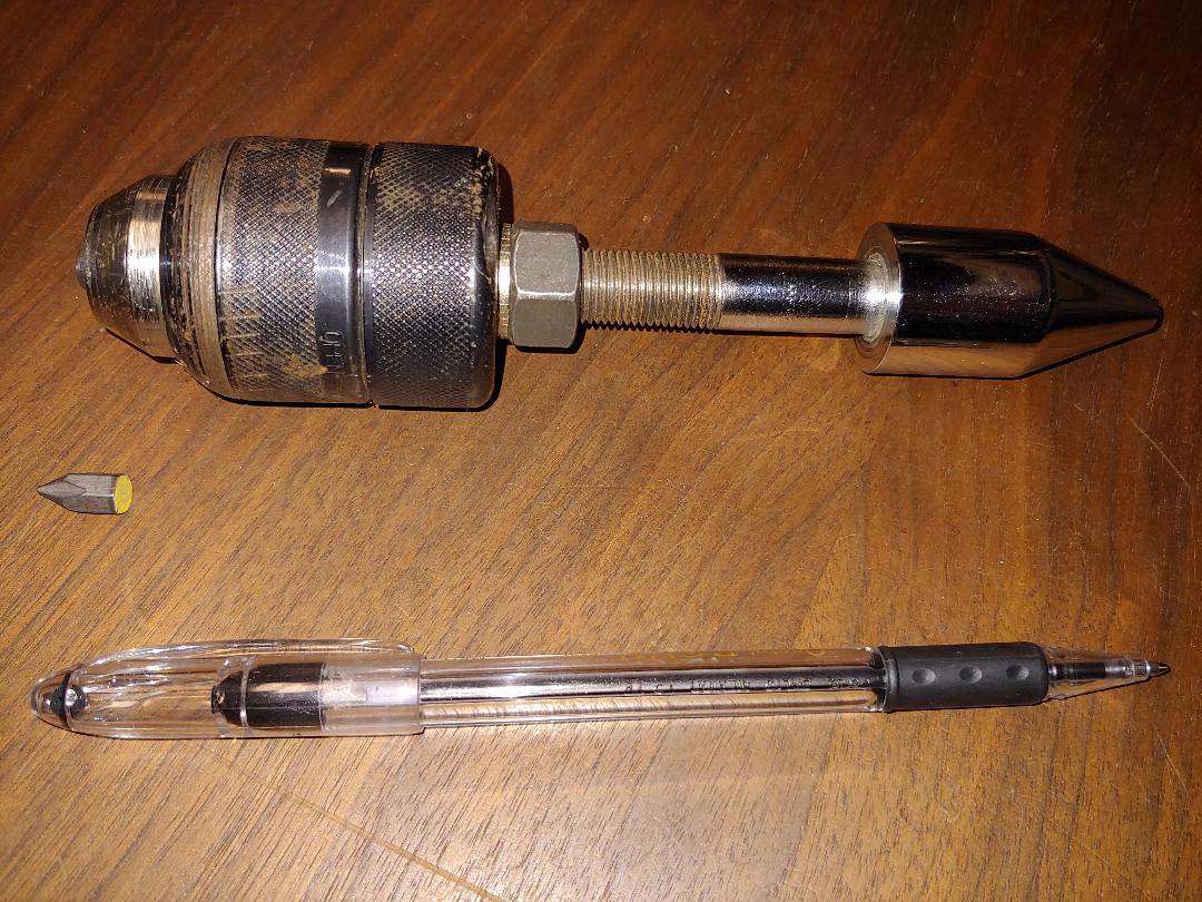

    The other day I needed to make a Phillip's screw driver (worlds shortest?) and thought you guys may be interested in a tool I use quite a lot. It's a keyless 1/2" chuck with a handle, used to hold short pieces for grinding on the bench grinder.
    After cutting the piece I need, I chuck it up in the tool and dress the end on the grinder. Works great for dressing up the cut ends of small screws, bolts and other smallish stuff. Threading on a nut will enable holding a screw or bolt straight while being clamped in the chuck.

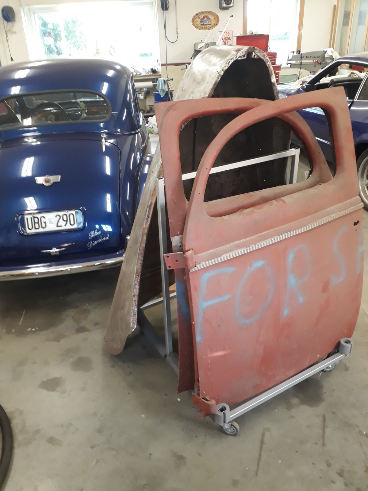

    Got tired of doors n hood for my 40 ford always standing in the wrong place. I welded a frame put some wheels on it. w****d Foam insulation around the tubes and place doors and hood on it, so now I can push it arou 003.jpg 004.jpg nd out of the way

    yeah, yeah, yeah '40 Ford doors, blah, blah, blah "40 Ford.........Do you know there is a bitichin' Morris Minor in your shop? :eek:
    brEad, scotty t, Daves40 and 2 others like this.
  7. Bjorn Wilsson
    Joined: Jul 20, 2020
    Posts: 46
    Bjorn Wilsson
    Thank you, that little Morris has taken me around Sweden for the last 17 years. The 40 ford is my next build, my dreamcar.

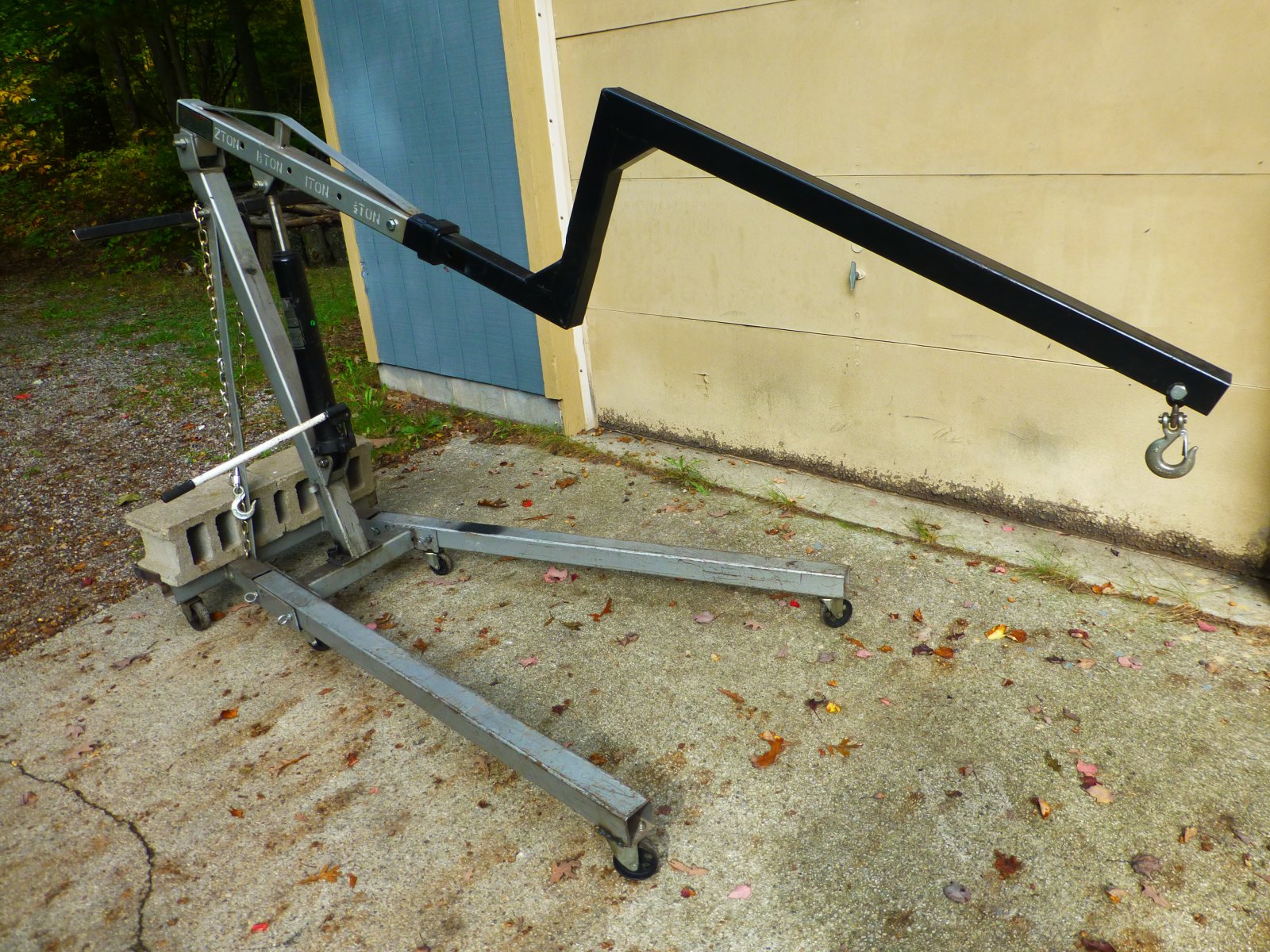

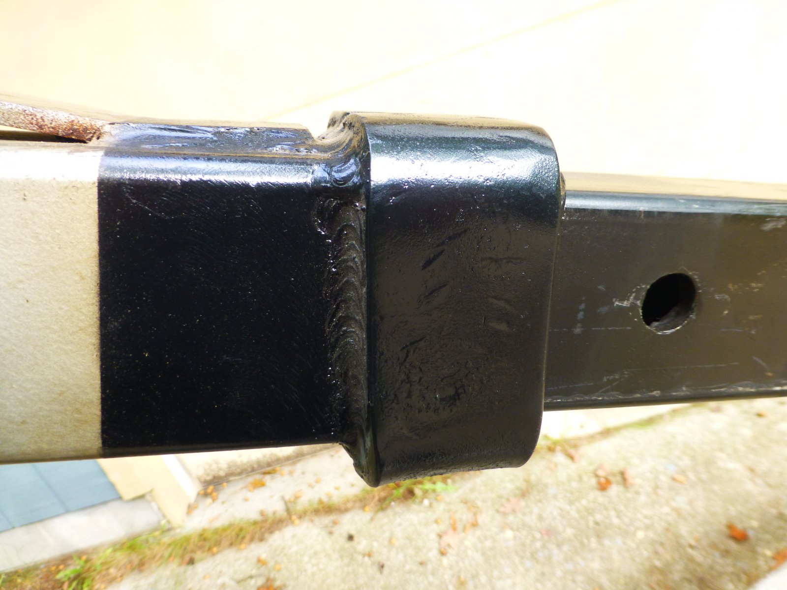

    P1050886.JPG P1050887.JPG P1050889.JPG P1050888.JPG P1050887.JPG P1050889.JPG P1050888.JPG Somewhere the other day someone was saying the arm on his cherry picker wasn't long enough. I made this arm for mine and I use it when I need to take a cab/body off my trailer and when I'm putting the 5th wheel hitch in my truck. I also put a long handle on it in order to control it better when moving any distance. The last picture shows the 1/4" strap I wrapped around the main piece so that it won't split. I also made a tray on the back for counter weights

    Okay, I can appreciate what you're trying to do but, and this is a big but, looking at your top weld, it's severely undercut creating a weak spot. Another thing I'd do it if were mine would be to stiffen the original arm, especially in the area of the top attachment point of the cylinder. Not trying to bust your balls, just trying to make you aware of the safety factor involved here. There is going to be way more leverage on that point with the extra length and it could buckle.

    Thanks but it's worked fine for years.

    I think the "undercut" is a optical illusion. The top brace doesn't quite **** up to the reinforcing band.
    Carry on!
