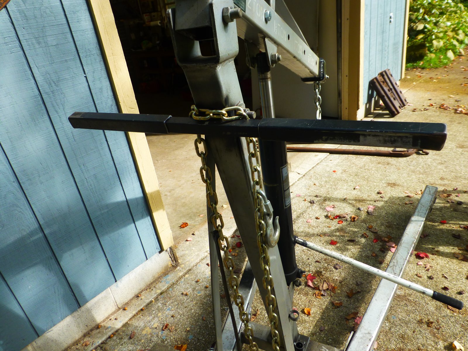

    I have the manufacturer supplied extension. It just didn't work good for lifting cabs and bodies off my trailer. The arm I made can easily lift a COE cab off

  16. Fortunateson
    Joined: Apr 30, 2012
    Posts: 5,722
    Fortunateson
    I presume your new arm goes all the way to the end of the receiving tube?

  18. phat rat
    Joined: Mar 18, 2001
    Posts: 5,080
    phat rat
    Your presumption is correct

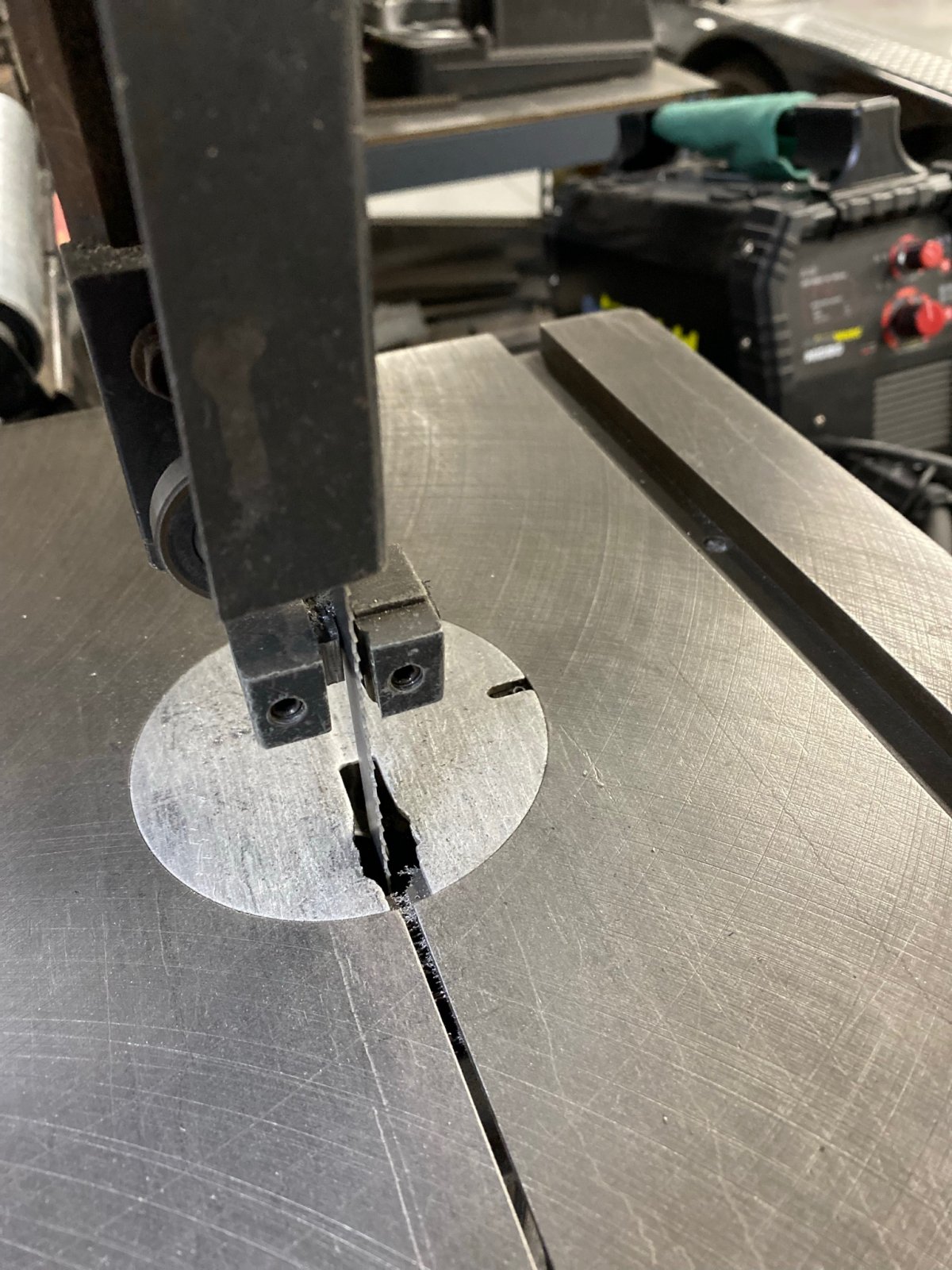

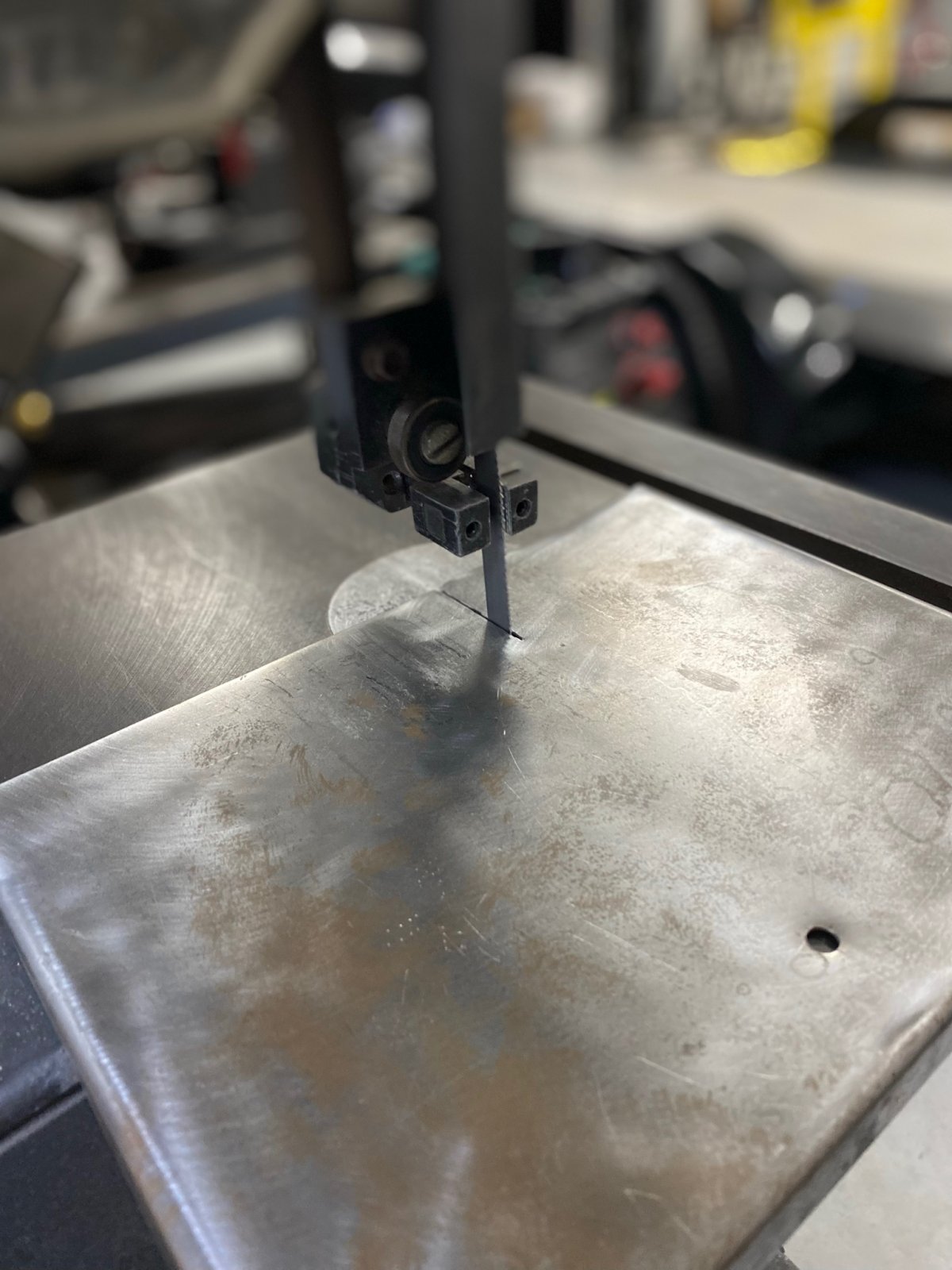

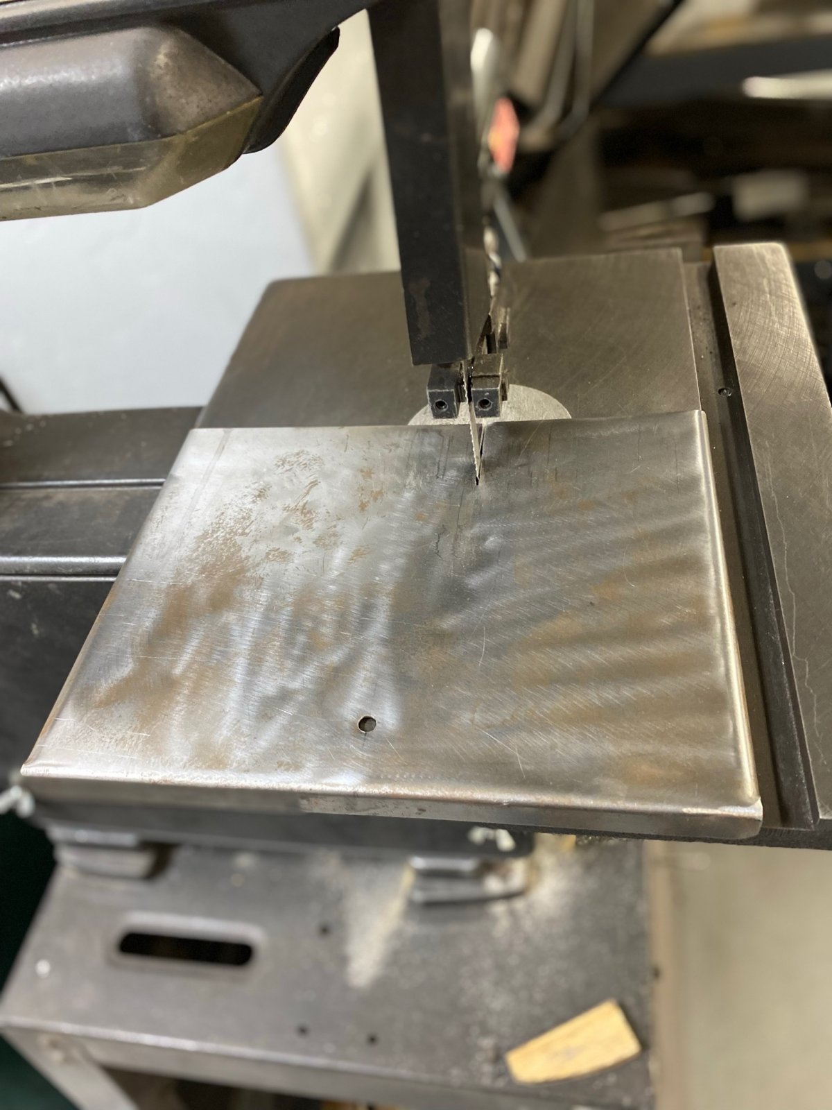

  19. Donut Dave
    Joined: Jul 9, 2007
    Posts: 500
    Donut Dave
    When cutting very small pieces on the bandsaw often it’s difficult to hold the part. I made a removable sheet metal plate with a single cut, bent the edges to keep it secure. Save your fingers!!!
    pivir123, LAROKE, Six Ball and 3 others like this.
  20. blowby
    Joined: Dec 27, 2012
    Posts: 8,664
    blowby
    from Nicasio Ca
    Nice. I've been using plywood but since it's anchored like yours.
