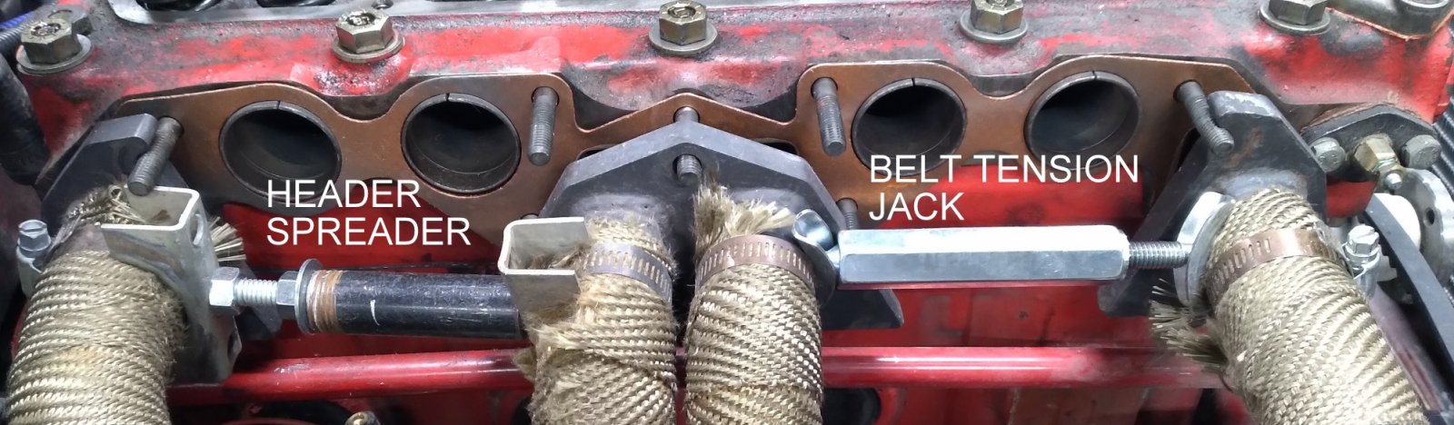

    HOME MADE HEADER SPREADER
    20211112 Header installation - Labeled.jpg The exhaust header had to to be stretched to fit over the studs. I had one belt tension jack - When I stretched one side - the other side got shorter <sigh>. I needed two...
    Googling "belt tensioner" did not find anything that worked. I checked the parts stores in town - no luck - one guy almost my age remembered them, had not seen one in years.
    Martinez at Merle's tried a lot harder - he found that it was a Supco "belt tension jack". Could not get it, but gave me an Amazon printout (Thanks again Martinez!). Once home, I found several sources, at various prices and "estimated" delivery dates. Since it was late Friday, the best options were still "next week".

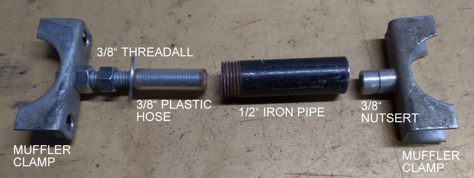

    20211112 Header stretcher - Labeled.jpg I decided to make my own from stuff in the shop and storage sheds. Took me less that 2 hours, mostly hunting for parts would do the job. From left to right:
    1-1/2" exhaust clamp (size to fit your header tubes)
    3/8"-16 Allthread s**** - magically was the right length
    3 each - 3/8"-16 nuts
    3/8" washer
    3/8" plastic hose - serves as a spacer in the 1/2" pipe
    1/2" iron pipe cut to length - 3/8" pipe would be better, did not have any
    3/8" nutsert
    short 3/8"-16 bolt

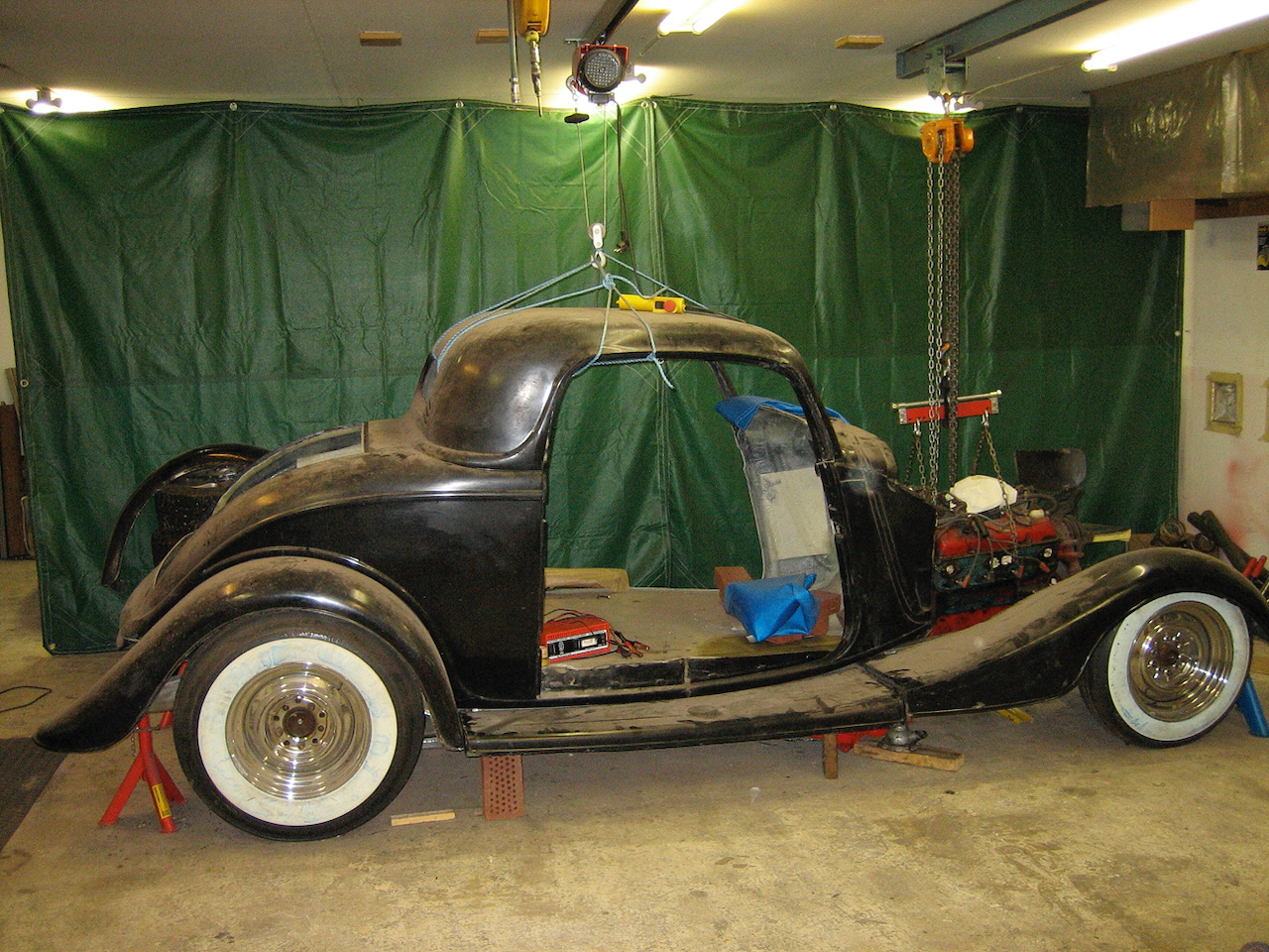

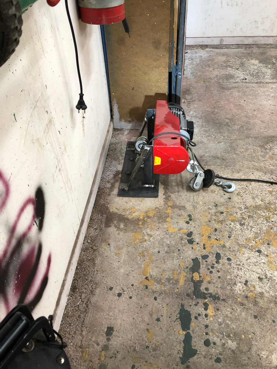

    My winch does double duty,in the lifting beam or bolted to the floor. IMG_6886.jpeg IMG_0931.jpeg Skärmavbild 2021-12-08 kl. 05.50.23.png

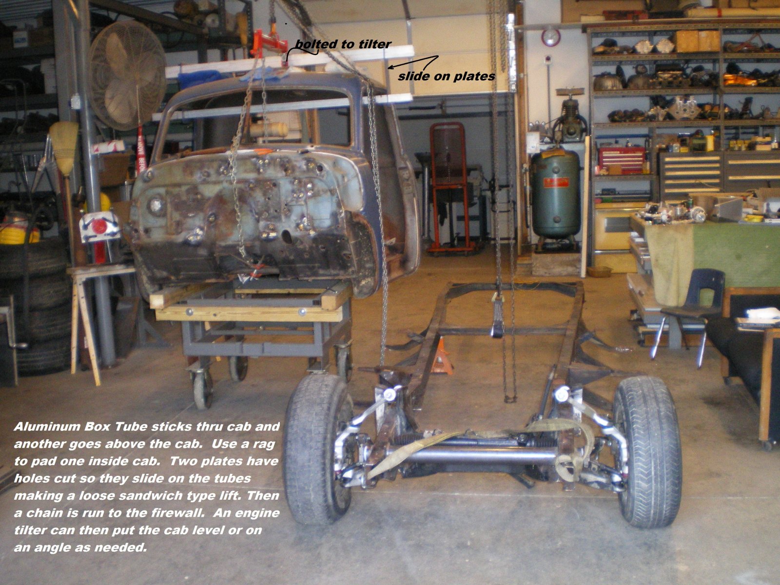

    Can I ask how those overhead beams are supported?
    One other comment: Where you have the cables/ropes/straps going thru under the roof of the car. I would suggest putting some rags or padding between them and the roof as they wrap around the metal. I did just like you are doing using a wide strap, and it bent the metal in a little. Later I made a fixture that spreads the load and used an engine tilter so I could keep the body level.

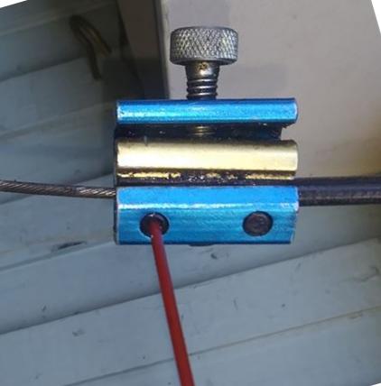

    Just lubed the heater control cables on my '56 Chev with this little gizmo. Clamp on and spray in your favorite aerosol lube, shoots it down the cable. Got it at a motorcycle shop years ago.

    They work very well, mine is black instead of blue and I've had it since the 70s when I worked as a motorcycle mechanic

    I have never seen one before and I've been riding motorized two wheelers since I got an old Cushman in '57. Cool tool!

    That's a handy little tool.
  22. Most motorcycle shops would sell them or off the net.

    Be aware though, if your cable has no plastic covering, like a choke cable, lube will squirt out at any tight bend, since it's basically a coil spring. Best if you can undo one end and straighten it out first, and have a rag handy.
    I see they have two knobs now. Maybe have to upgrade. ;)
    Motion Pro sells a lot of great tools. Their tire irons are terrific.

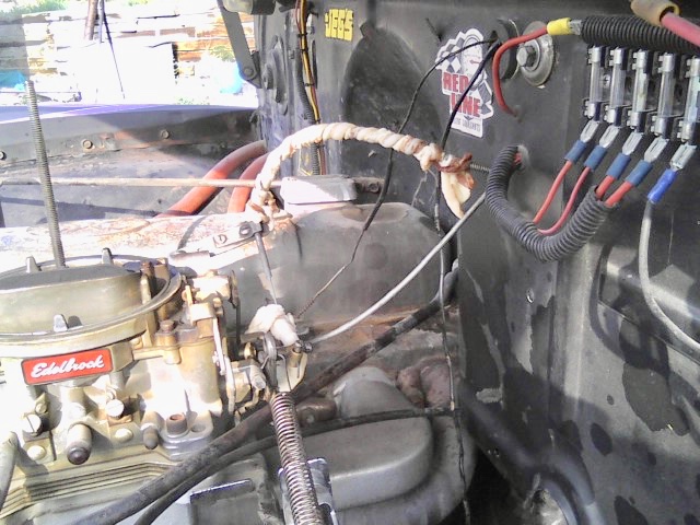

    Emergency cable lube: A few years ago my throttle cable broke at night during Hot August Nights. No replacement available. The pickup has a hand throttle but the cable was sticky and binding from lack of maintenance & salt from Bonneville trips. For the 30 mile drive home I wrapped the cable with raw bacon I got at a cafe. With the engine heat melted the fat & by the time we got to Virginia City it was working well. The down hill run to home was easy. The next morning the dogs got it with their breakfast.:)

    ^^^ Out of necessity comes some offbeat inventive ideas ^^^
