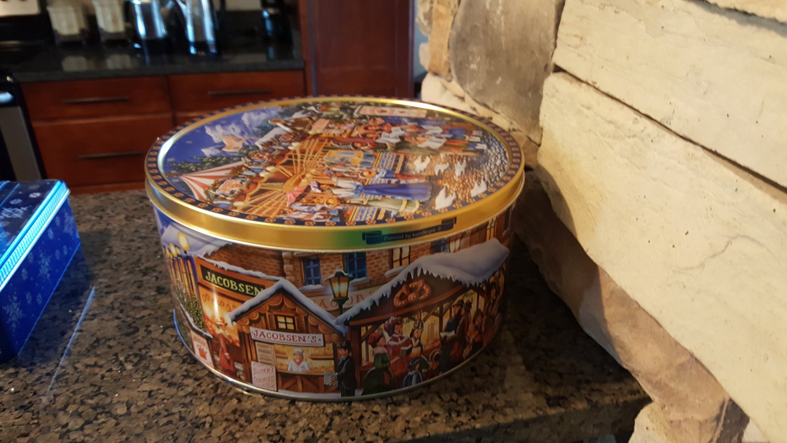

    And they make the shop look so festive! :) Those things in lots of sizes and shapes have many uses.

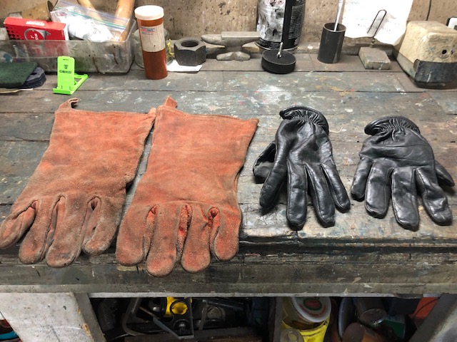

    This may seem vary basic but it took me years to figure this one out. Welding gloves are very bulky so I would use regular work gloves when welding and constantly get my hands burned. I finally started using a pair of men leather dress gloves and they work perfectly. The dress gloves are tight fitting so you can control the mig trigger very well and the splatter does not burn through. upload_2021-12-27_7-31-45.jpeg

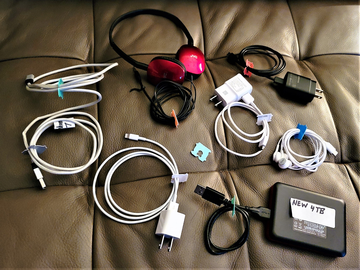

    We have all used small plastic coated wire to wrap our excess cords to get somewhat organized. Unless one buys a roll of this type of wire, and cuts them to size, we all just wait until we purchase something that has the sample twisted around a cord or two.
    Well, one day, I had used up my Ziplock bag full of those “free” plastic coated ties. So, in the garage, during one of my drawer clean out days, I was without something to organize small cords that look like they multiplied overnight in the drawer. I had some garden use, plastic coated green wire, but did not want to take anything away from outdoor garden usages.
    So, I had some of those odd looking plastic things that hold a commercial bag closed, with yummy bread inside.
    upload_2022-1-1_5-29-34.png bread package clip tie on a bag
    Why? I originally did not have a clue, except that they looked cool. I hated throwing them away and they aren’t recyclable. So, I put them in a Ziplock bag. Now, when the supply is low, I start collecting them again.
    Jnaki
    I found out one day that I did not have coated wires, so I grabbed a bread bag clip and it fit. There were some wires that were phone chargers, old wired phone earbuds, and small stereo speaker headphones.
    Then I had a thicker 7 foot long Tablet charger wire curled up spreading itself. Because of the thickness of the wire coating, I had to use two of the bread clips to make them organized. Then since I have several external hard drives for my laptop and home computers, I used the next clips to organize the curled wires.
    Now, when I put them back in their respective places, nothing sticks out like a wild hair style look, when we all get up in the morning. They fit in their respective places in the garage drawers, the kitchen key drawer and in a small basket for my laptop stuff. All, nice and curled under control. It is amazing at how much more stuff you can put in a drawer space when wires are under control. YRMV

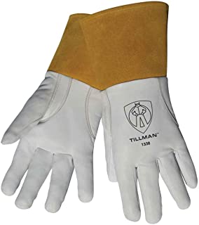

    Try buying welding gloves at your local welding supply store. For about $12 they sell some that are kinda gray looking with brown cuffs on them. There are a couple different types but they are made of stuff like goatskin which is great for welding. Once you get a pair you won't use anything else. When they get too dirty and ****py for welding, they are perfect for lifting dirty parts. Amazon has them, but I like to try them on to get the right size.
    Those HEAVY/THICK leather gloves are nice for using a cutting torch....but not for mig/tig.
    Try these, you will love them.

    In my area the Tillman tig welding gloves go for about $25, guess I’m getting hosed!

    Just bought a pair like that at Harbor Freight for about $13.

    The exact ones shown are on Amazon for about what bigdog paid at HF.

    Last time I bought some.....about a year ago they were less than $15 at the welding store. Previously at another welding store I paid about the same ($13) if memory serves me. With the rampant inflation, I don't know if they are still the same price. I usually buy a couple pair and stick one in a cabinet. I'm bad about using them for other stuff that makes them dirty. They should last a few years with no problem if you don't grab greasy parts with them. They have several versions, goatskin,kidskin, and even Elk skin. Slight variation in price. If they are too high locally, next time you are at the weld shop try a pair on to get the correct size and then order some from Amazon. This is the large size. https://www.amazon.com/Tillman-Grai...1139452&sprefix=tillman+gloves,aps,76&sr=8-23

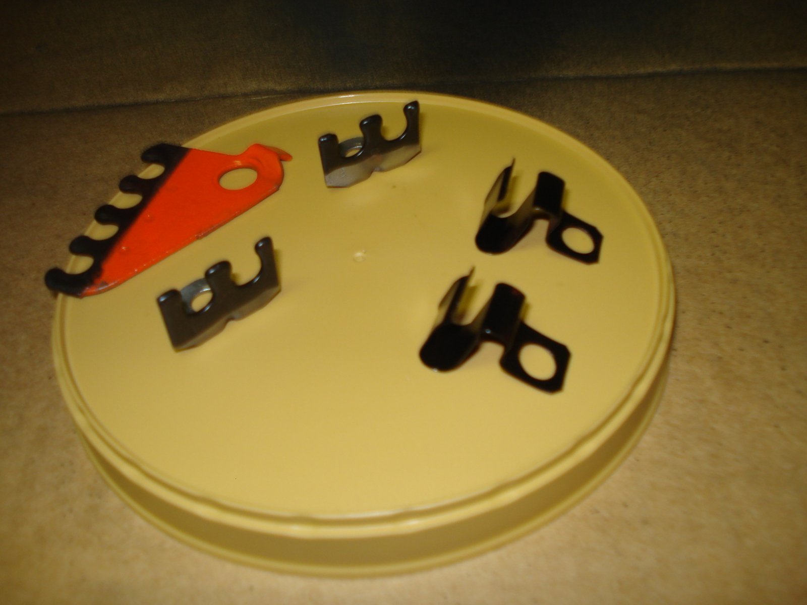

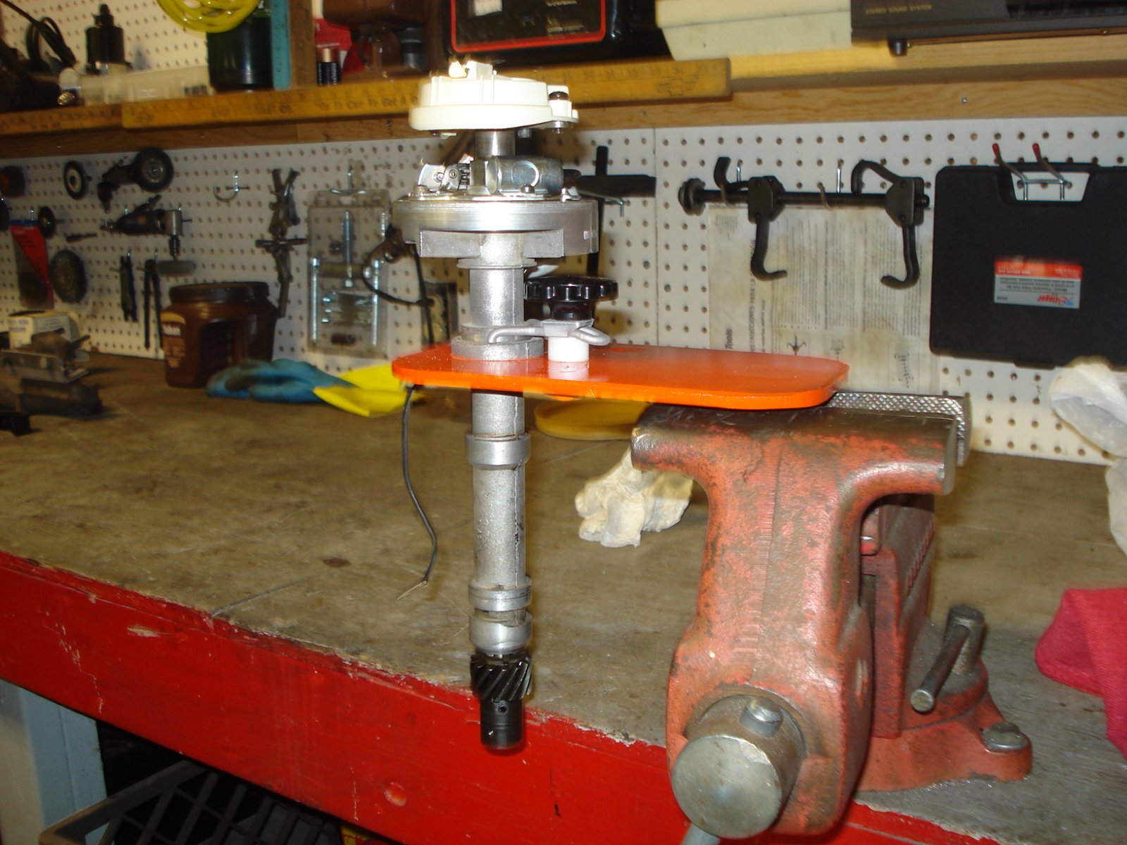

    60 year old wire guides, sandblasted, painted, dipped in Plasti Dip. The coating is more like rubber than plastic; the name of the product is deceiving.
    The plate for distributors does not require clamping the distributor housing in a vise.
    May have posted this stuff before but I can't see it anywhere on this thread.

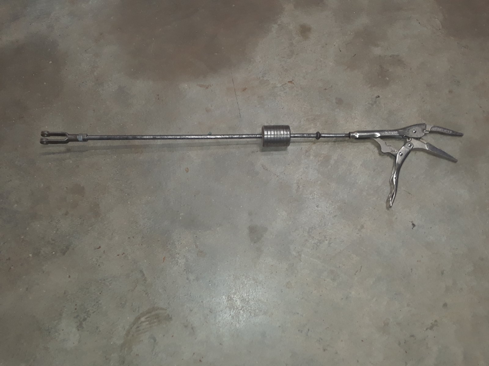

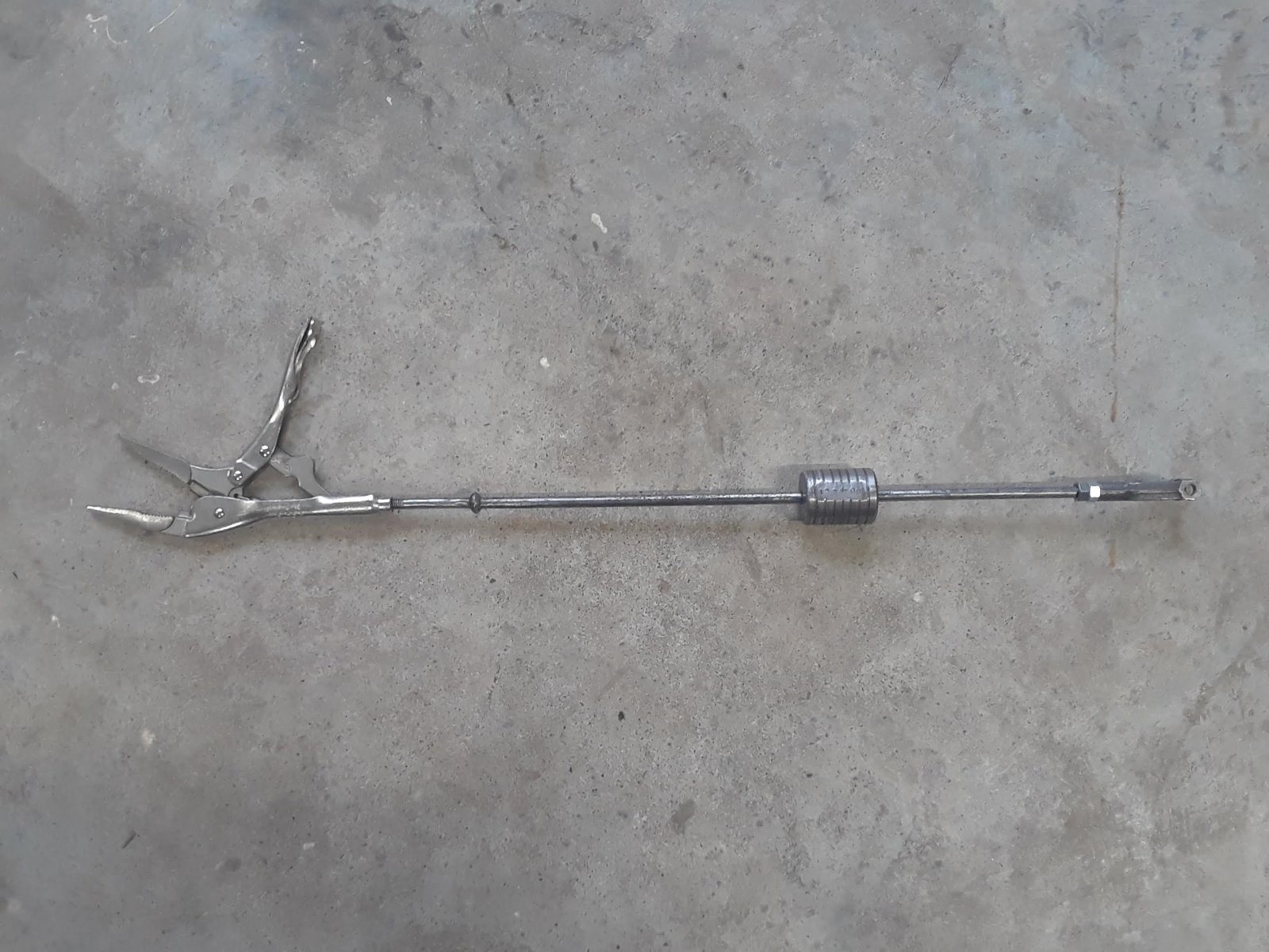

    I was searching for something else when I came across the reply above by fordor41 several pages back.

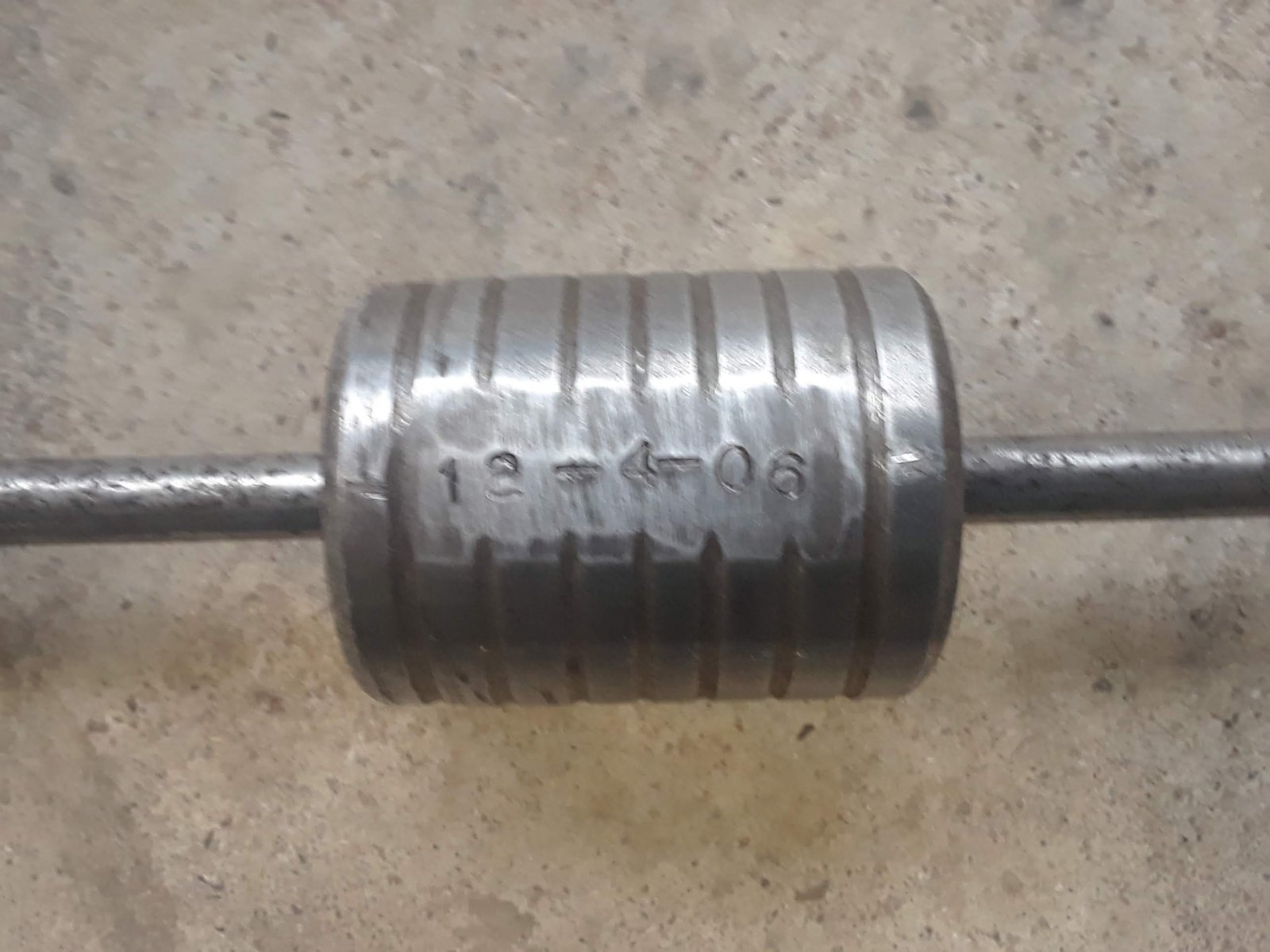

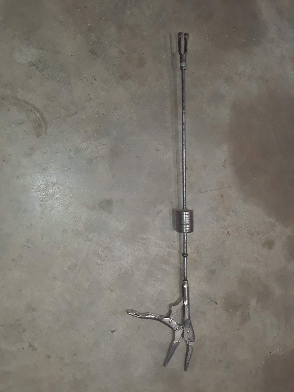

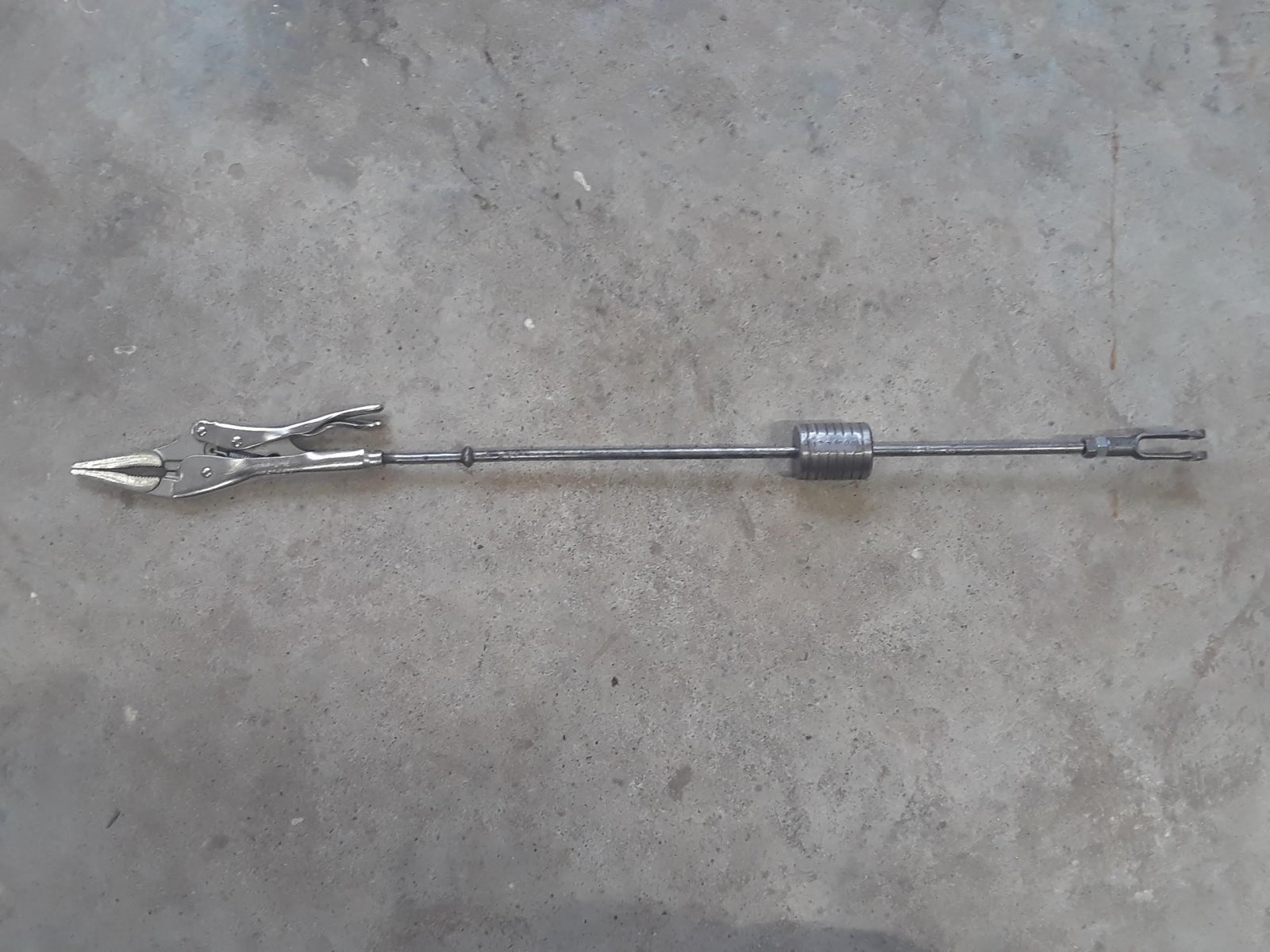

    Here's something similar. Not the finish nail part but what to pull the nail with. A friend made this slide hammer many years ago. The rod is a Model A brake rod and the weight is a stack of thick washers welded together. The stamped date is the day he made it. This thing hangs on the wall right over my primary bench. You'd be surprised how handy it is.

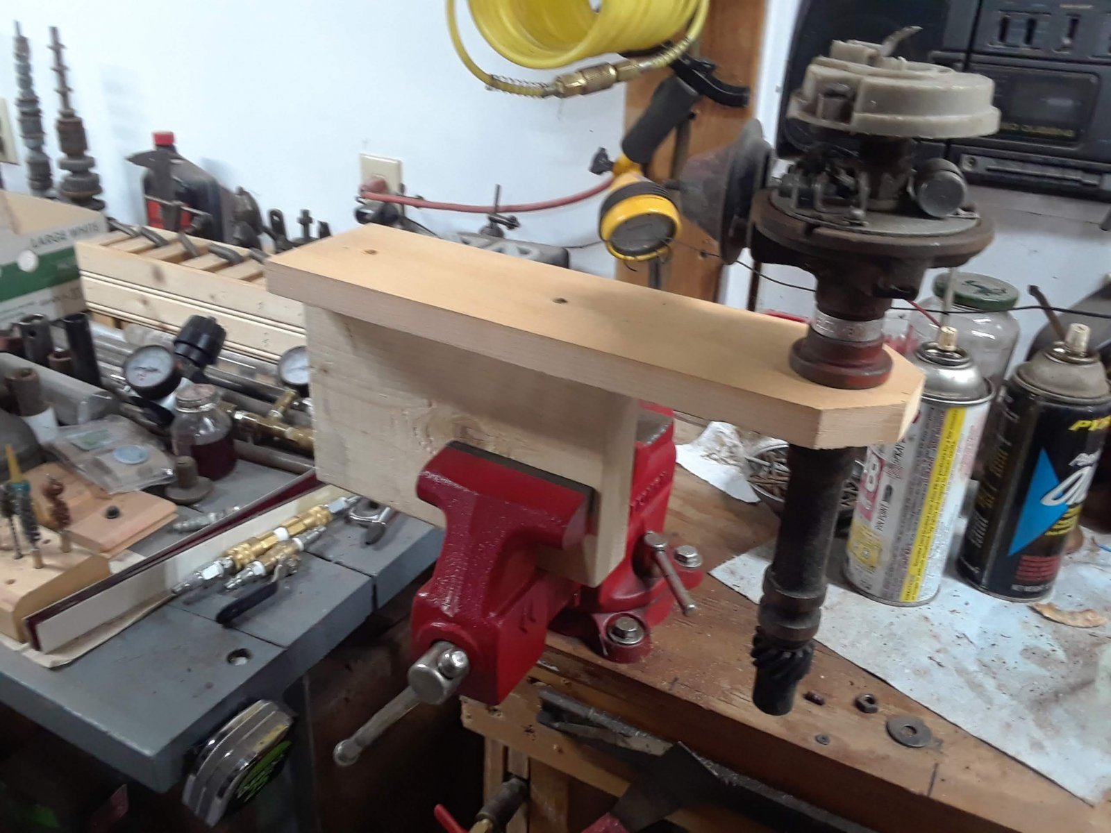

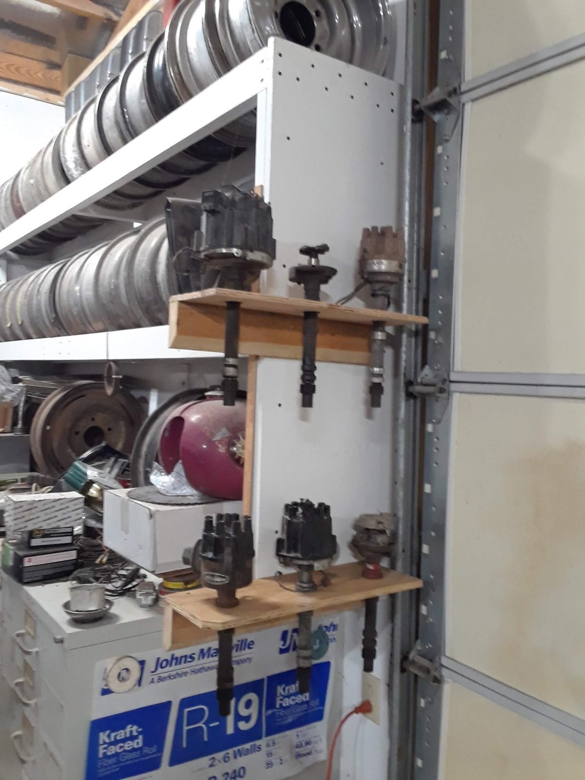

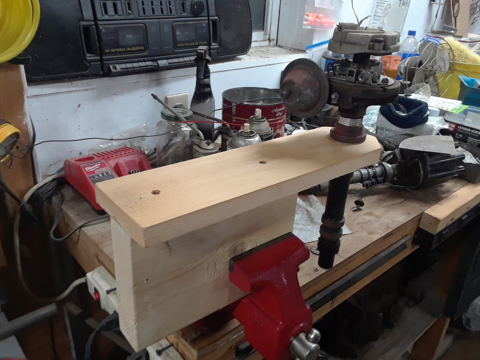

    My distributor holder isn't nearly as cool as Oilguy's but it works and was made from s**** wood that otherwise would have gone into a bonfire or used for woodstove kindling. 20220104_203418.jpg
    And speaking of distributors; while doing some cleanup recently I found several distributors that were taking up space on various benches and shelves. Here's how I got them out of the way:

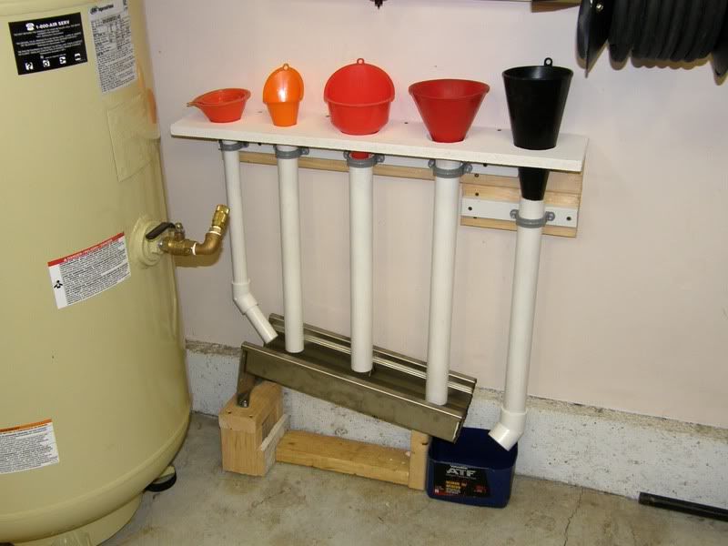

    To be clear, I don't do this, just grabbed the pic from the internet. funnel storage.jpg

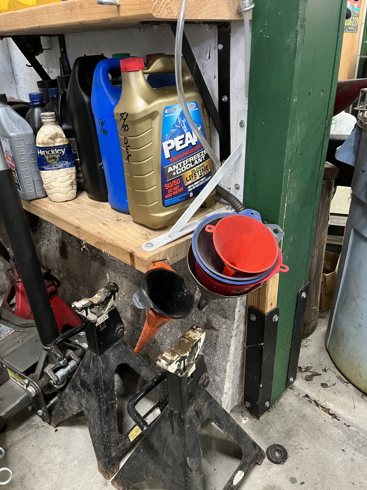

  28. I have a shelf with oil bottles on it it’s fairly low, maybe 2’ from the floor, i just drove some nails in the edge of it and drilled holes in the funnels that didn't already have one. I stick smaller ones in bigger ones and leave a rag on the floor to catch drippins. A simple picture would have meant a trudge across hundreds of feet of frozen tundra.:D
    EDIT! Now with picture:rolleyes:

    A cool thing about this is that you could use any visa grip jaw style that has the same adjuster screw size.

    b-t-w; I've seen quite a few pix on the web similar to the one rdscotty posted above. For me the drawback to doing something like that is that I live on a gravel road and everything inside of my shop has a perpetual film of dust on it. I'd rather not have dust in my funnels when I'm ready to use one.
