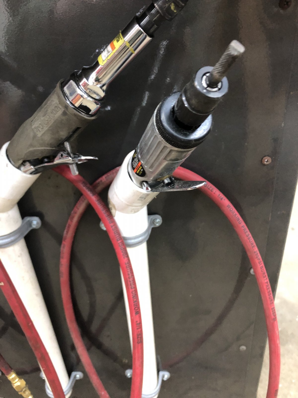

    I've searched and asked for a tip on how to deal with air tools with whip hoses attached, most recently post #1332 on this thread. Finally took the bull by the horns and came up with this:
    They fit under the top edge of my metal fab table. Orignally, I was going to put a trough at the bottom to collect the hoses. But, as I was putting it together, I found that the hoses would stay put by simply looping them behind their own tool.
    An added benefit is that they will swivel out for access or fold flat against the side of the table.
    This was all done with stuff I had around the shop, 1" PVC pipe, fittings and clamps. Only clued the 45* elbows to a short stub to the coupling at the end as I wasn't sure if this was the final design.
    The couplings were modified to fit the individual tools but this was very minor. I did shorten them, but I believe there are also shorter ones available from some suppliers.

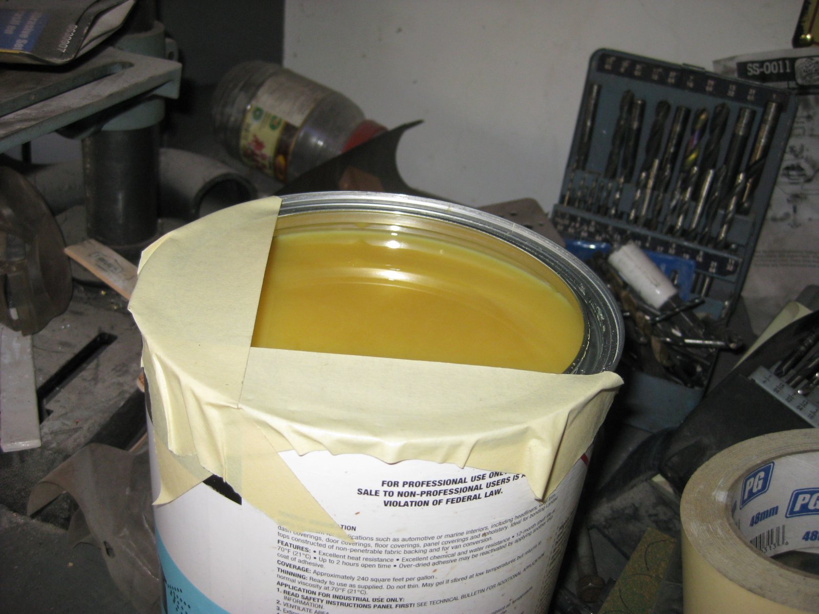

    I just discovered this trick for pouring paint out of the can. Works slick. IMG_1588.JPG

    GearheadsQCE........Nicely done. My original suggestion about putting large cans in a drawer to handle the tool and hose ***y was for the smaller coiled hoses. Air hose.jpg
    Never thought about someone having full size hoses on each tool. My suggestion with larger hose is for someone to make a bracket with holes in it that would attach to the rear of the work table or tool box. The hose would then just dangle down behind the box and out of sight. It could actually hang down inside the rear of a toolbox behind the drawers if there is sufficient room.

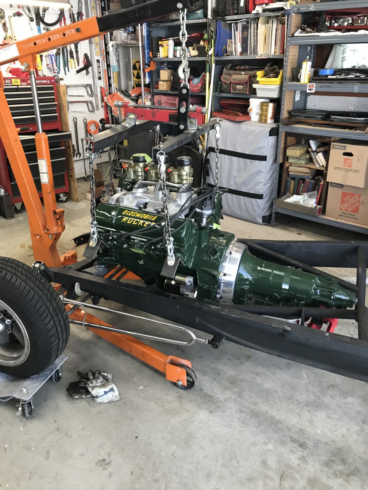

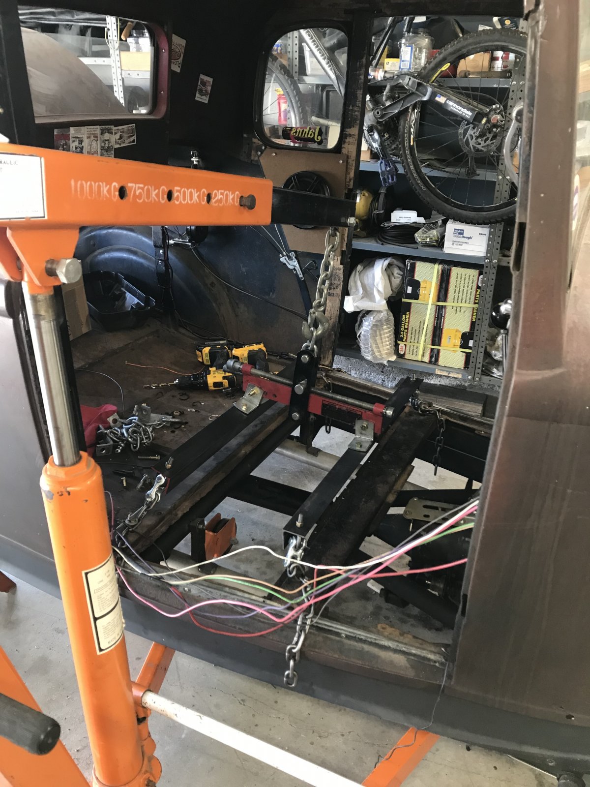

    I modified this to lift my motor without scratching the purdy valve covers, also works as a body picker 45D98010-2DC7-4324-A2C1-3A70275516FE.jpeg 570BF390-B87E-489C-96A7-38AE45177E03.jpeg

  23. That gives me an idea for an o/t chevelle body lift!

    @nochop Thanks for that idea, both body and engine lift. I am going to copy your engine lift, wish I would have thought of that:)

    I also am going to copy this.... Thank You....
