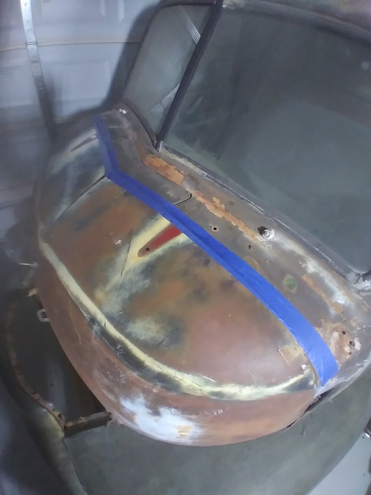

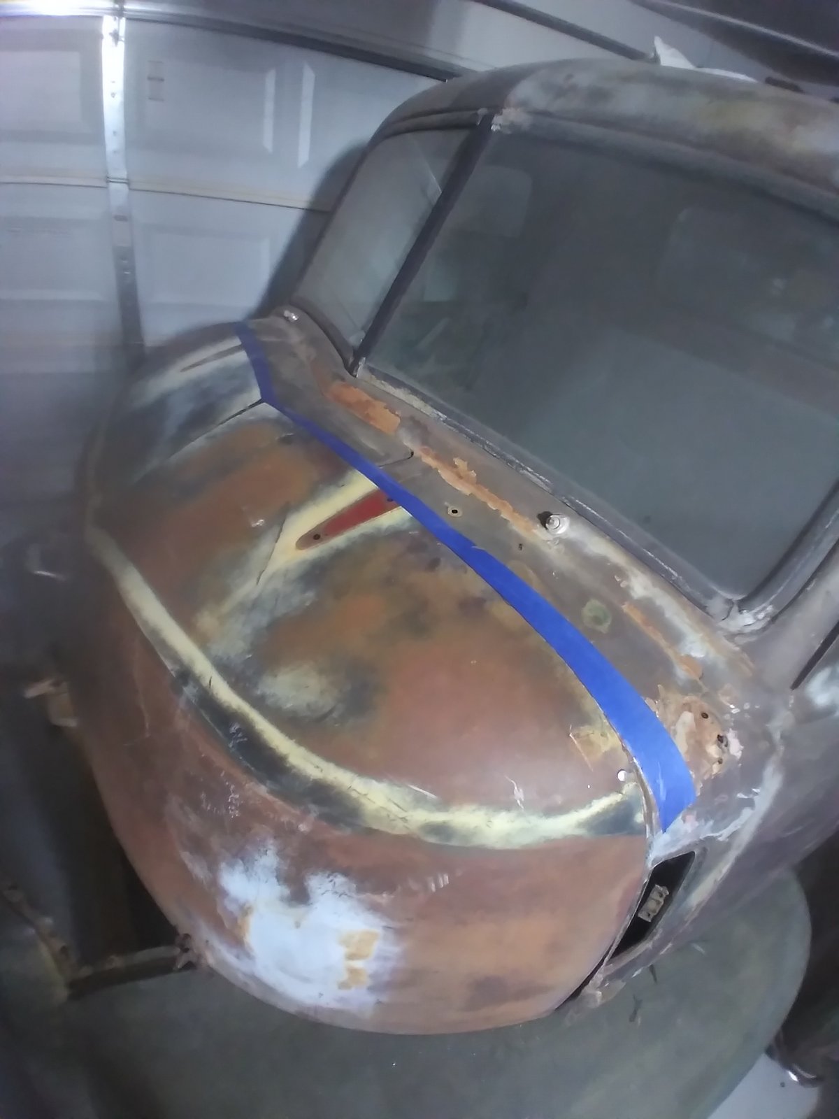

    This may or may not help someone.
    I needed to lay out a blind cut.
    So laid some 2" tape,then laid the piece over it,secured it,then laid another layer of tape over it.
    Self explanatory.

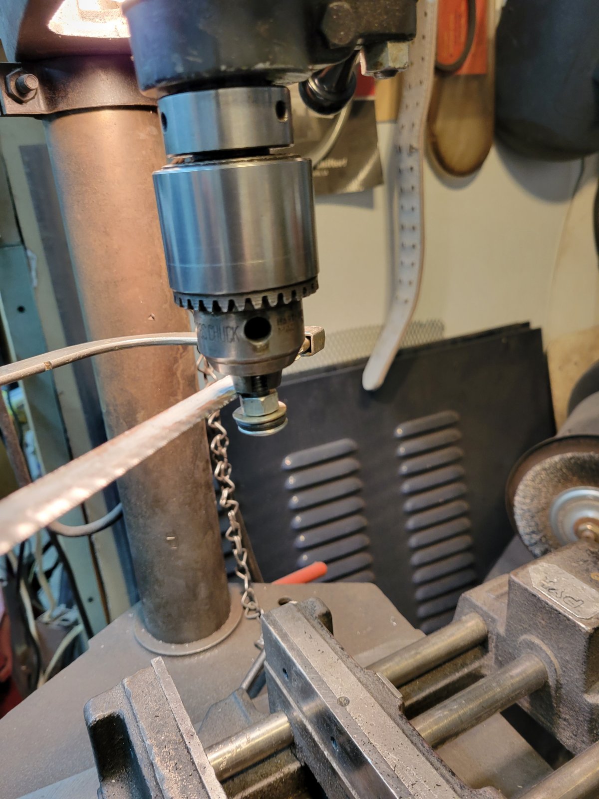

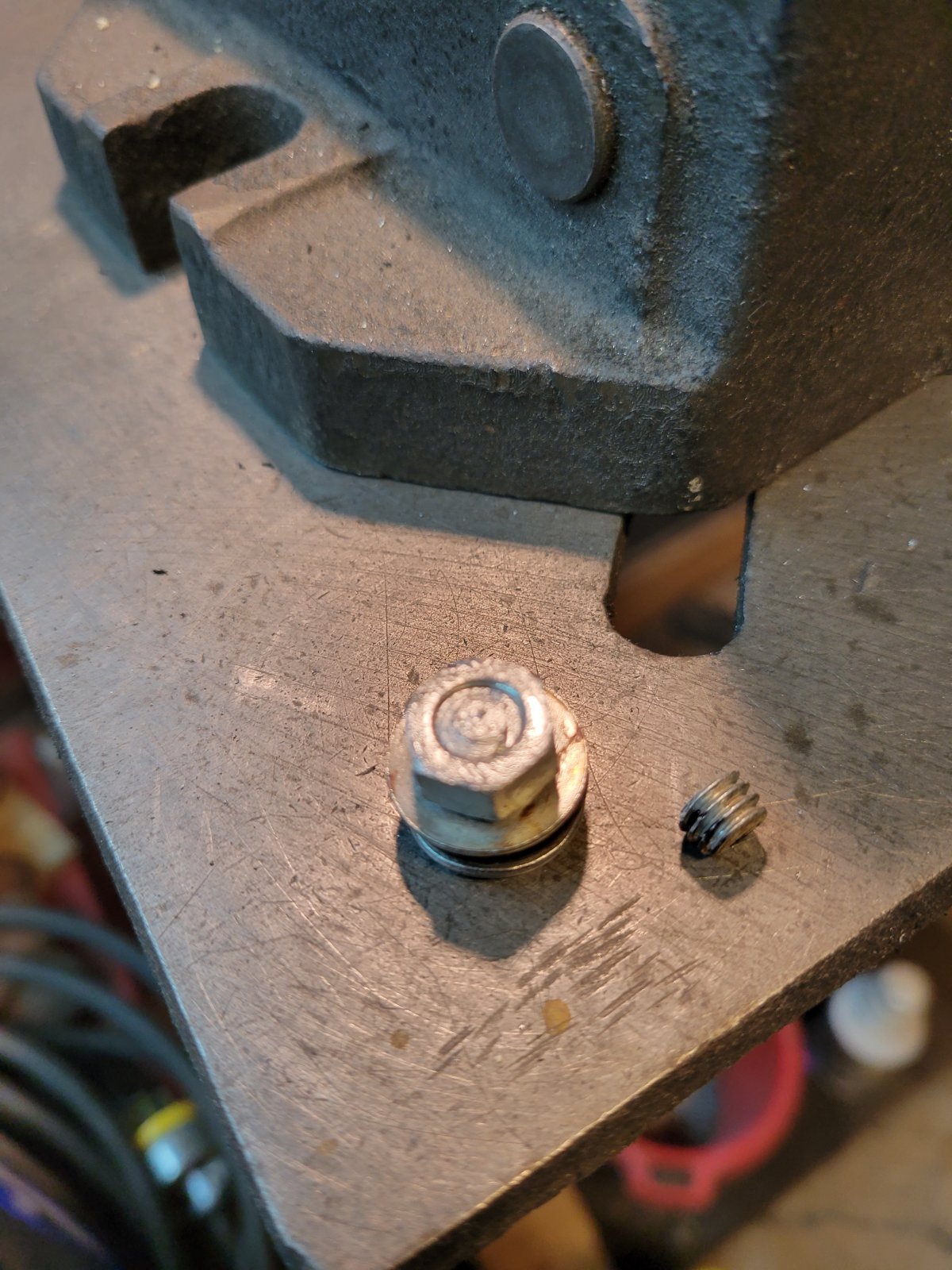

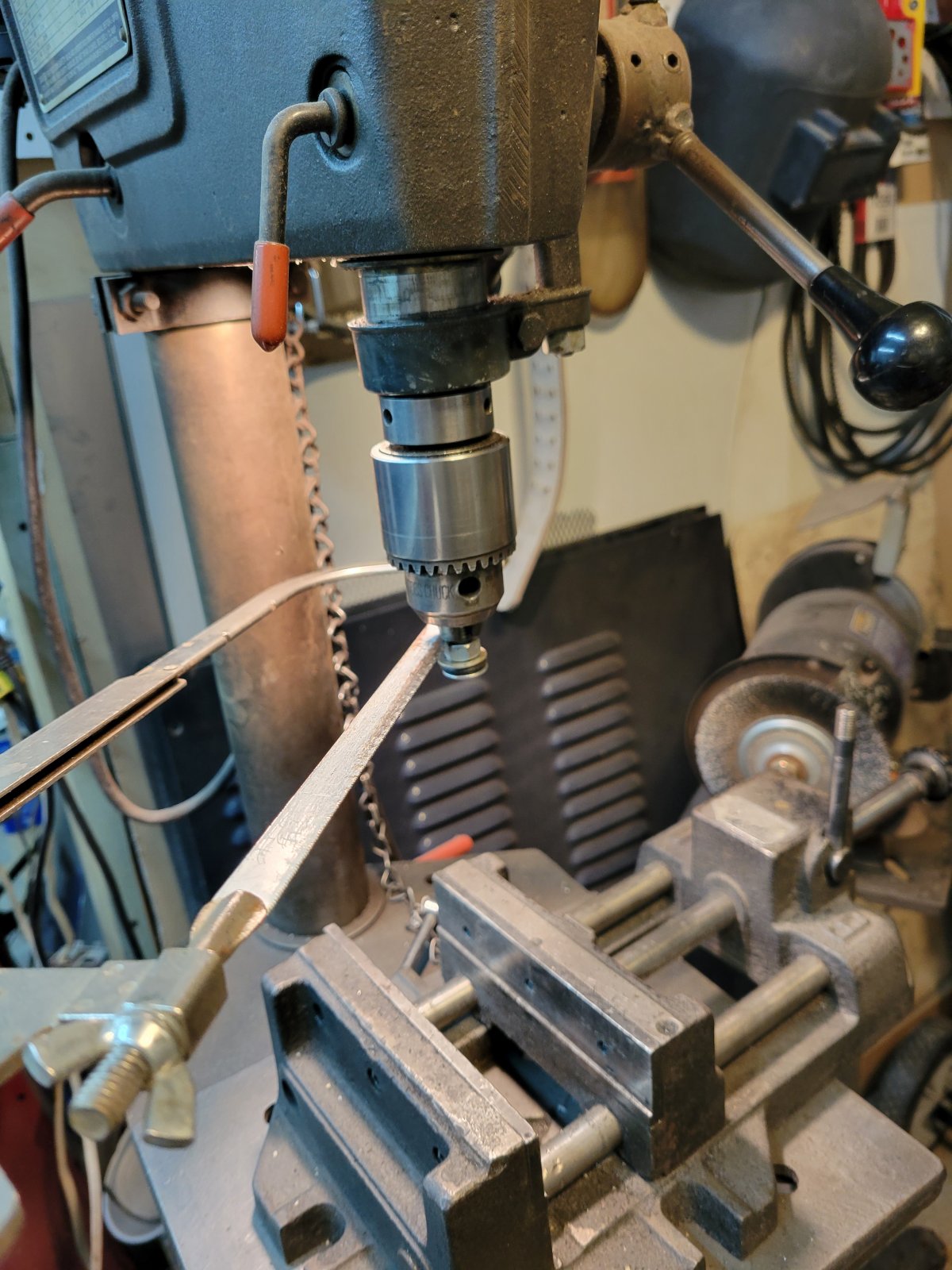

    If you have a polished bolt that is a little to long and you don't want to mar up the head by sticking it in a vise to cut the length down.
    Then step right over to your drill press, chuck the threaded end in, turn on the machine and put your hacksaw against it, works like a charm and doesn't hurt your polish job.

    Good idea.
    If you clamp a pipe/conduit/etc. vertically in that vise right up to the bolt (but not in the way of the saw) the piece you want to keep will just harmlessly fall down the tube when it comes off. Otherwise the part you want to keep might head to under the nearest bench/cabinet/car and require a half hour to retrieve. At least that would be my typical experience.

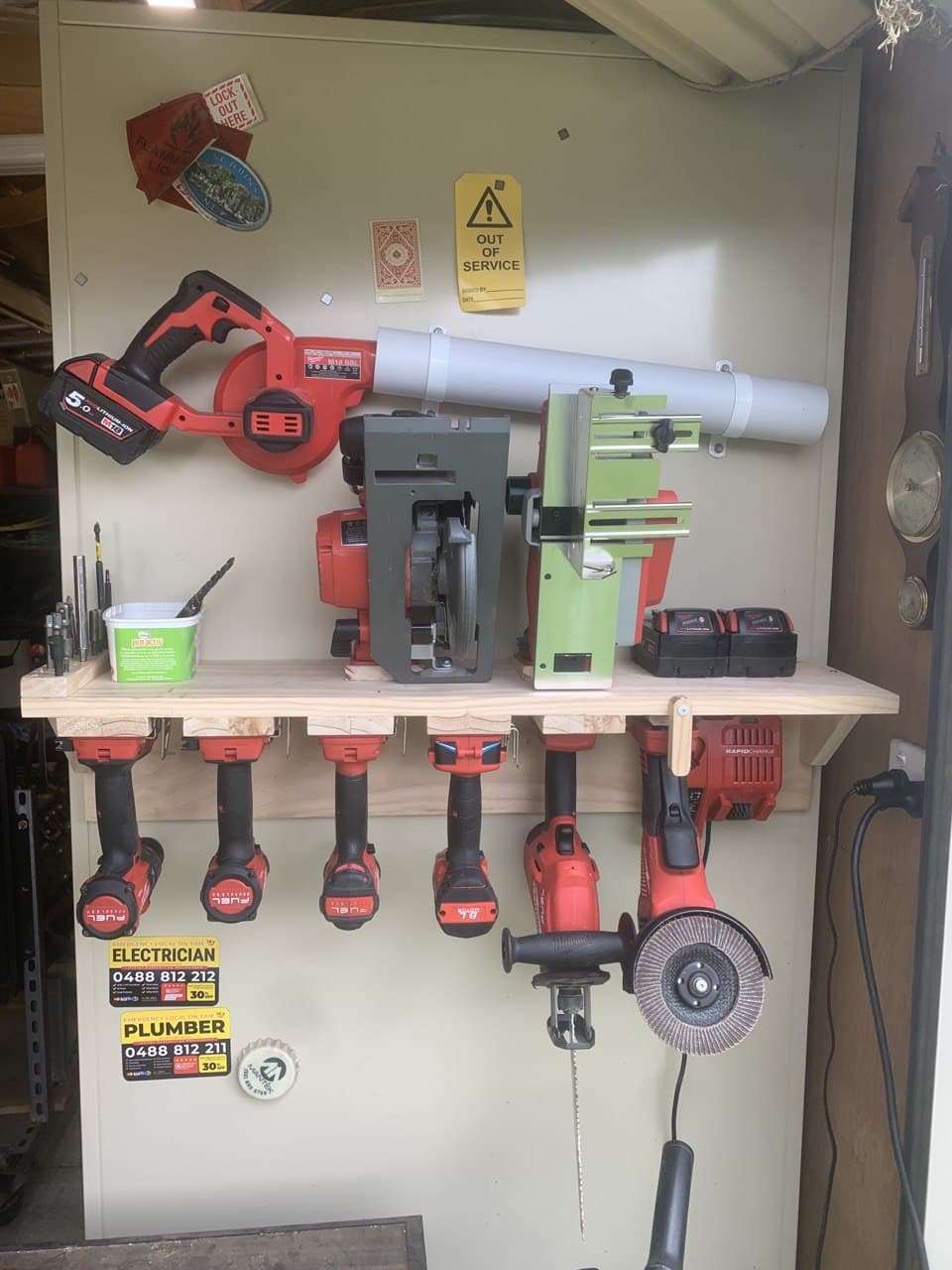

    I was sick of these things falling off the shelf, so a few clips from amazon and some pine photo_2022-04-05_10-44-38.jpg photo_2022-04-05_10-44-44.jpg

    That very thing has been a big part of my ongoing shop cleanup. No good pictures though.

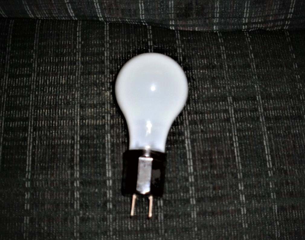

    Is that 60W light bulb in the lamp burned out or not? The cheapest tester you can have is the one where the bulb screws into it and you simply plug it into the wall. Just keep it handy in a drawer and use it when you suspect a full size bulb is bad. Also works great for testing if a circuit has power.

  15. Good tip. I do this.
    When I'm about halfway through the bolt diameter, I take a file and put a little chamfer on the new length, then finish the cut with the saw blade. (I don't have a bench grinder.) And I also like to run a nut onto the bolt before the cut so that the threads are "straightened" when the nut is removed later.
    For my shift knob, hobby/business I also do a bit of polishing on my drill press.

  17. I've used this trick in the past but didn't think to chamfer the thread end on the bolt - great tip!
    I used to use this same method to make small tapered pins.
