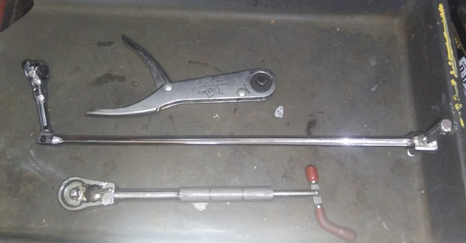

    So that's where my ratchet went, the bottom one. Somehow after years of having it I misplaced it. Hardly ever used it but when it was needed it worked like a charm

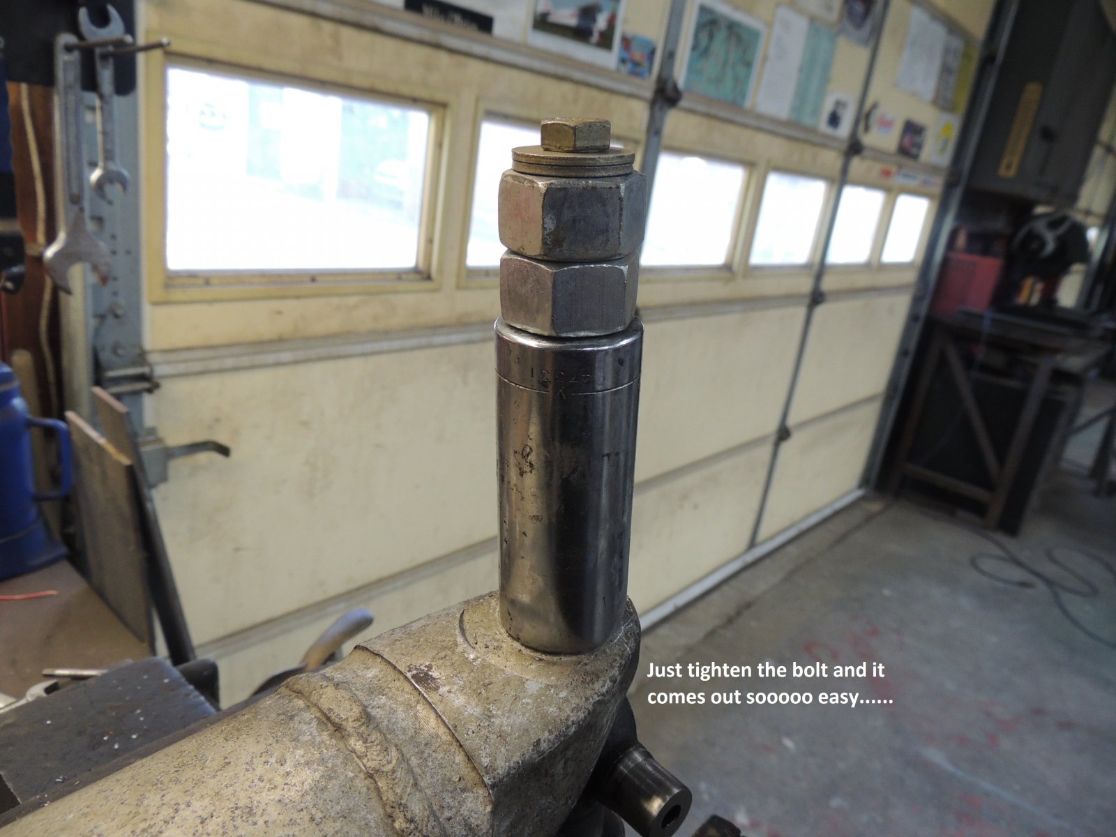

    Removing a stubborn U Joint from a driveshaft.
    Had a nice carbon fiber driveshaft with aluminum ends that turned out to be a good fit for a project I was doing. I did need to replace the U joints before installing just to be safe. Well, the caps would not come off on one end. Tried driving them back and forth a few times, but the steel cross was hitting the aluminum casting on the inside of the shaft end. Didn't want to ruin this nice driveshaft with one of my usual overzealous attempts at removal. Afraid if I continued beating on it I might break the aluminum end of the shaft.
    What to do ?
    Everyone has done something like this before, but I had never done it to remove a stubborn U joint cap. Anyway, it was simple to weld a long nut onto the cap and then use a socket and a bolt to make a puller. Came out so easy it was a non-event.
    U Joint Remover 2.JPG :p

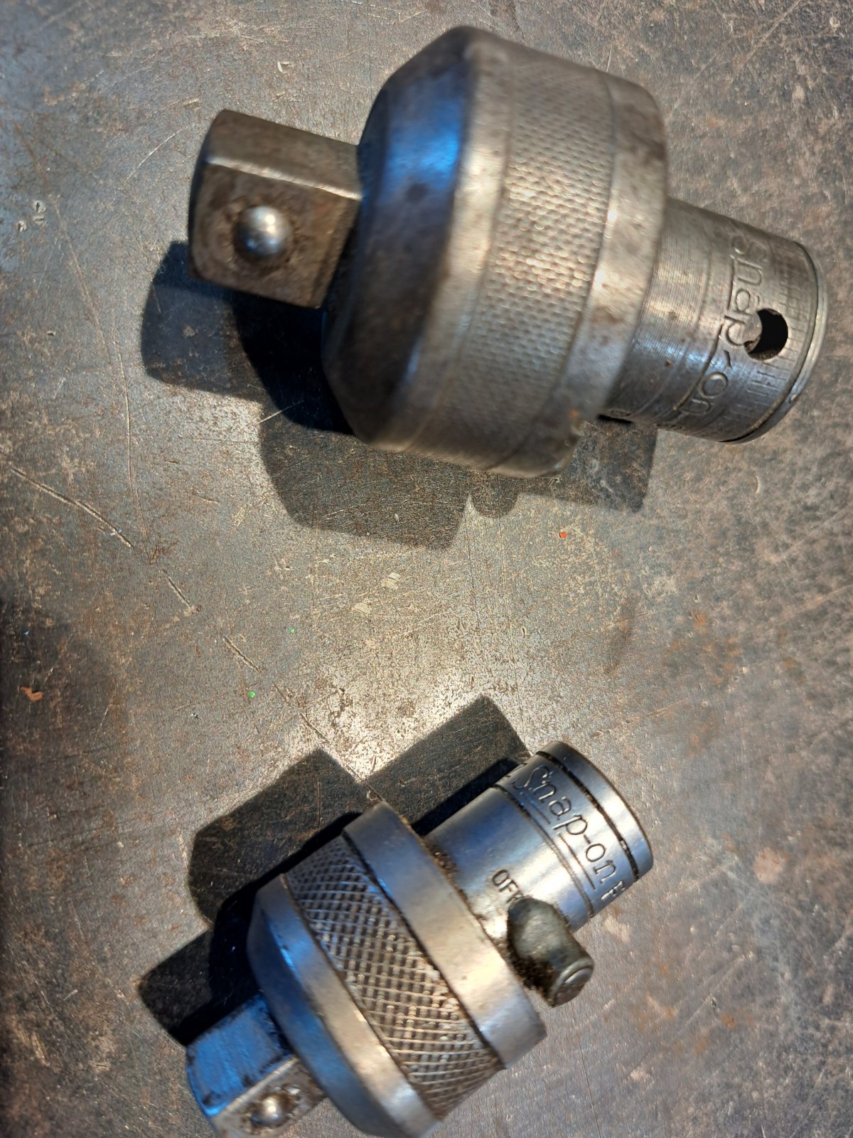

    Tools are always a good purchase! These ratcheting adaptors saved the day a couple of times. 20220605_145704.jpg

    I have one of those sidewinder ratchets. Gets used about once every five years. Kinda goofy, but it does make a few things easier than not having it.
    The top one is intriguing. I’d buy one if I saw it.

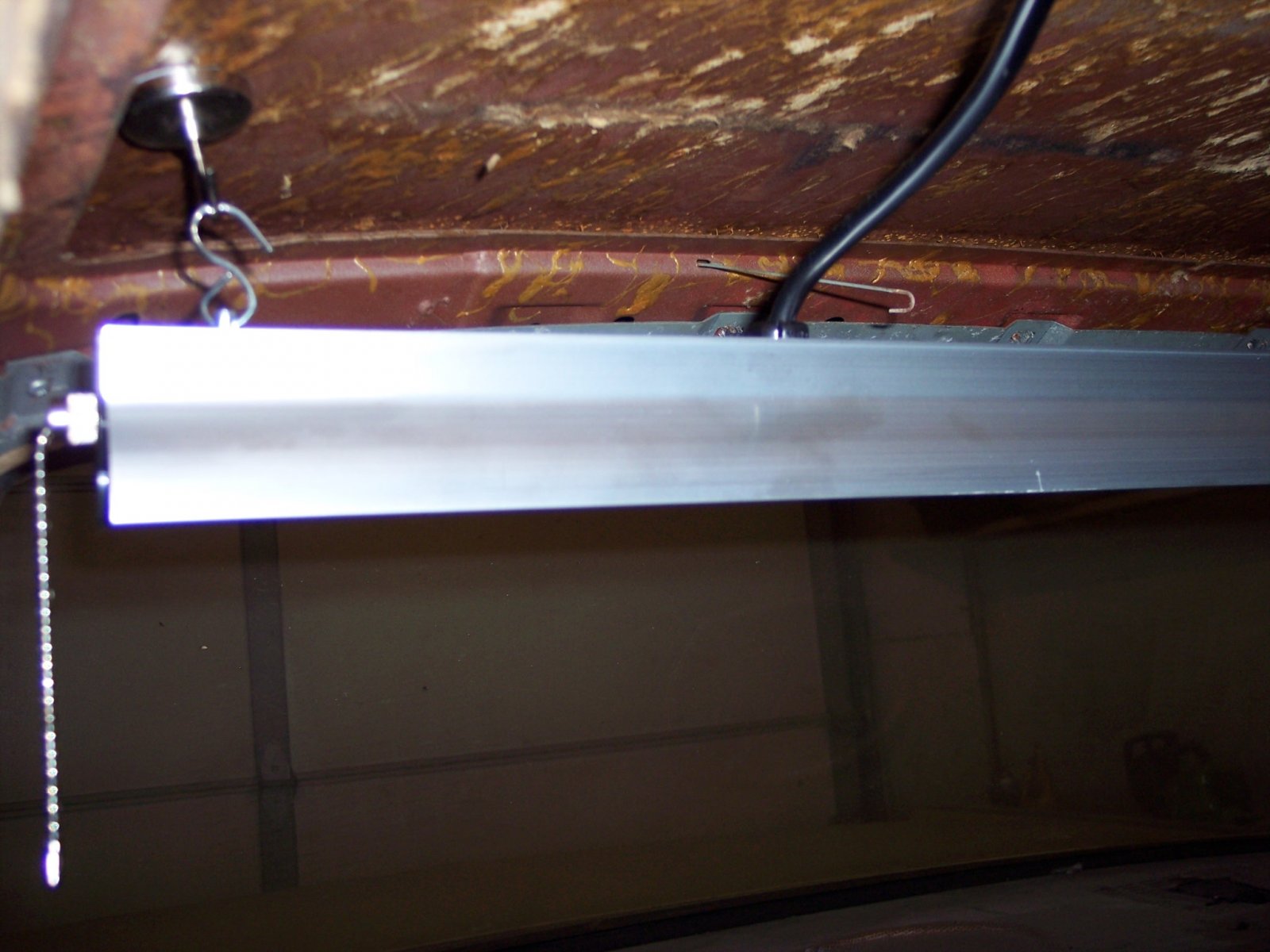

    Need some light inside the car or under the hood? I've been using a clip on light with a 150w floodlight bulb in it but I really don't want the heat it generates this time of year. So a visit to the store- one of these.
    Package of four of these-
    Stick the magnets to the roof, hang the light, use an extra hook to hold the wire up. this is the result--
    Definitely can see what I'm welding, I might have to turn the sensitivity down on my helmet. If the car had a headliner in it wouldn't be too hard to run a piece of conduit, or wood, or whatever across and secure with a strap over the roof and hang the light from that.

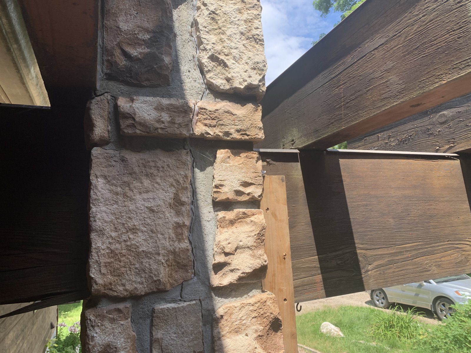

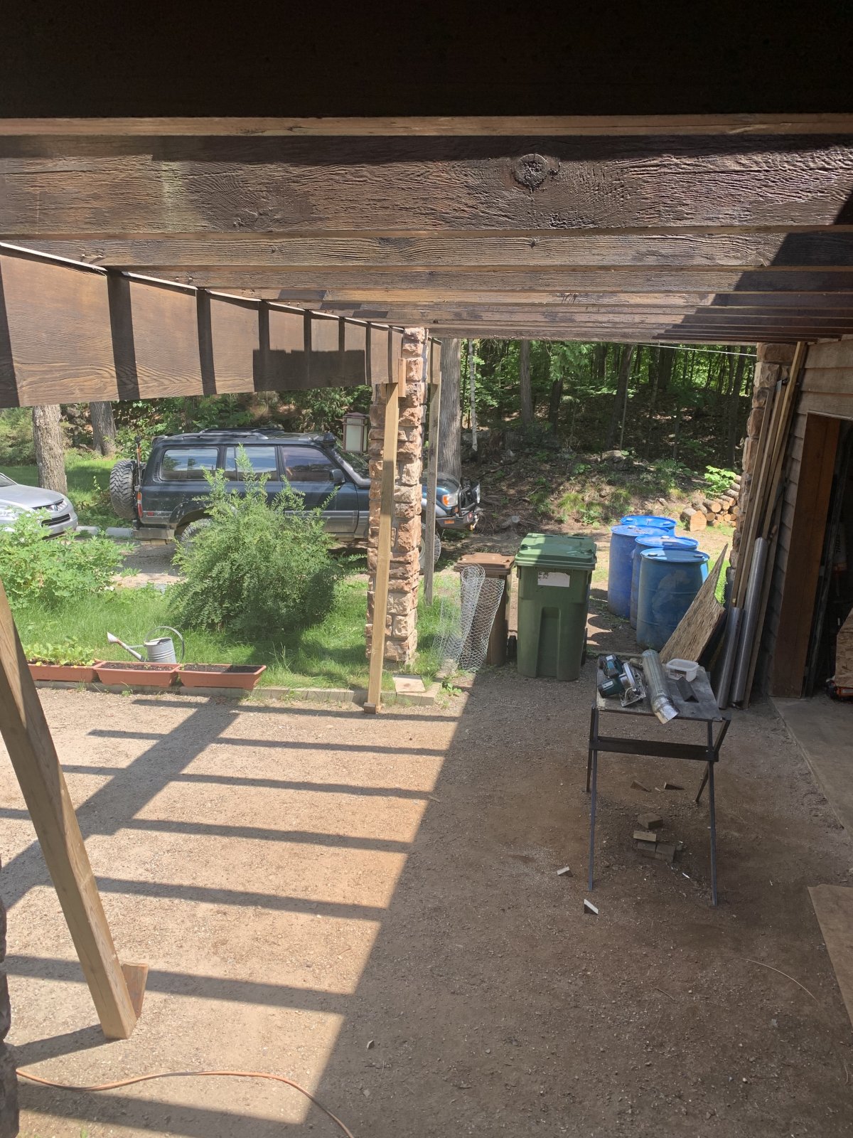

    I won’t hijack the thread any longer, but just noticed the 15”x3.5”x25’ beam has dropped about 3”where it exits the column closest to the house. Good thing I had a look while thinking about closing it in. Could have killed me while working under it. Shored it up for now. Damn.

    For years I had one like the bottom ratchet. Now it's somewhere in time. I have no idea where it went. I seldom used it in fact the last time I remember using it was on a car my wife got rid of over 20 yrs ago
