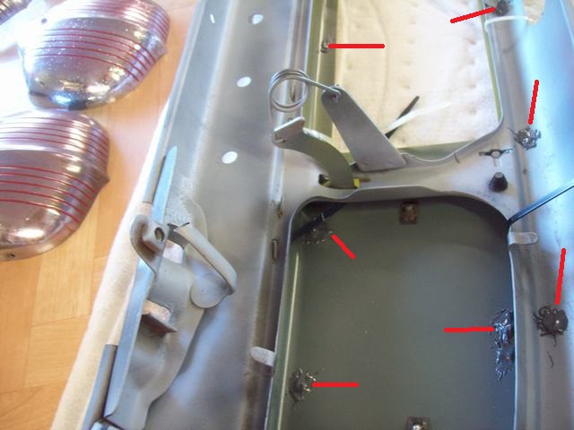

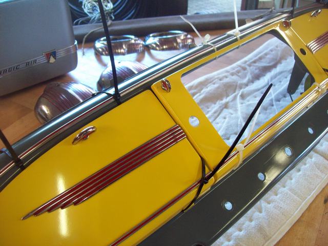

  14. This dashboard has really thin decorative aluminium strips and of the 16 tiny clips that slide into the strips to fasten them i only had 6 clips. A blob of solder from the inside would only melt the paint . So i spaced the 6 clips out and fastened everything down with tie strips . Then mixed up some JB Weld and forced it into the aluminium strips from behind with a small kitchen knife. A day later and solid as a rock.

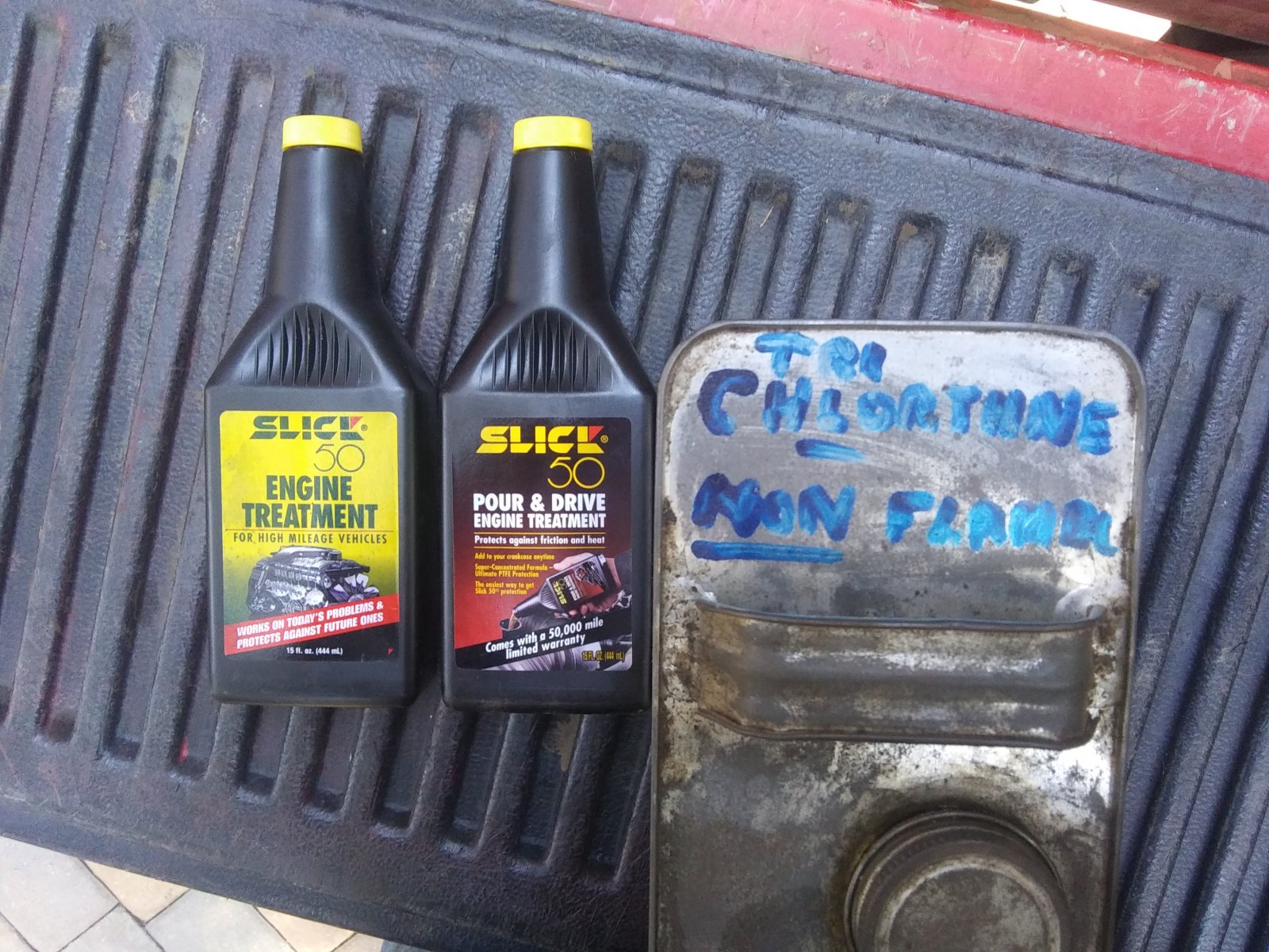

    Stopped by to help a friend with a clutch adjustment today, and was rewarded with a gallon of tricloroethane, some kind of solvent, he's a retired elevator mechanic. Anyone heard of this stuff? Is he trying to poison me? He also gave me some Slick 50, so maybe he trying to do me harm.;)

    Dry cleaning fluid?

    I believe that Trichloroethane was used as a solvent but either is being phased out, or has already been phased out, due to its ozone-depleting and cancer-causing properties. Must be some pretty old stuff ya got there. Be careful with it.

    Take the "Be careful" warning to heart that's some wicked **** if you breath in too many of the fumes. Years ago at work the used it for degreasing parts and the guy who was the regular degrease operator ended up with health problems. When he'd been off the job for a few months he started looking a lot better

    Thanks guys. I hope one big whiff won't hurt, 'cause that's the first thing I did. :oops:

    In the aviation world, we called it "trike". It's a degreaser, and yes, it's long gone, very effective, and causes cancer in California and everywhere else. I wouldn't be afraid to use it, because you won't have years of exposure to wreck your internal organs. But don't let the neighbor's kid go huffing it!

    Years ago I had a house that the well tested for that ****, the chemist who ****yzed the water told me the fact we drank it while finishing the house was not good, but the real danger was breathing it, ir steam from the shower, dishwasher etc. Bad stuff, found out later the adjacent property the owner had been burying metal machining s****
    from Pratt and Whitney. Had to install activated carbon filters on the water for the house.

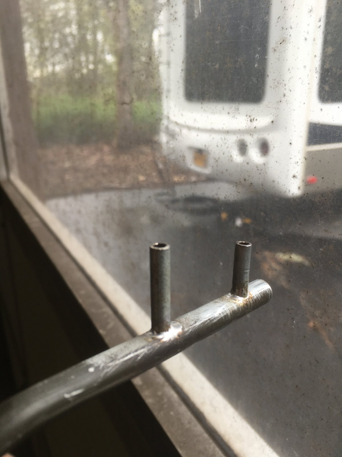

    Need more vacuum ports or want to hide them - No problem! I drilled holes in one steel tube and soldered the smaller steel tube pieces into them - done deal. The tubing was steel fuel and brake line. About 4000 miles so far, no leaks.
    First pic shows the prototype, second the real deal prior to tidying things up.
