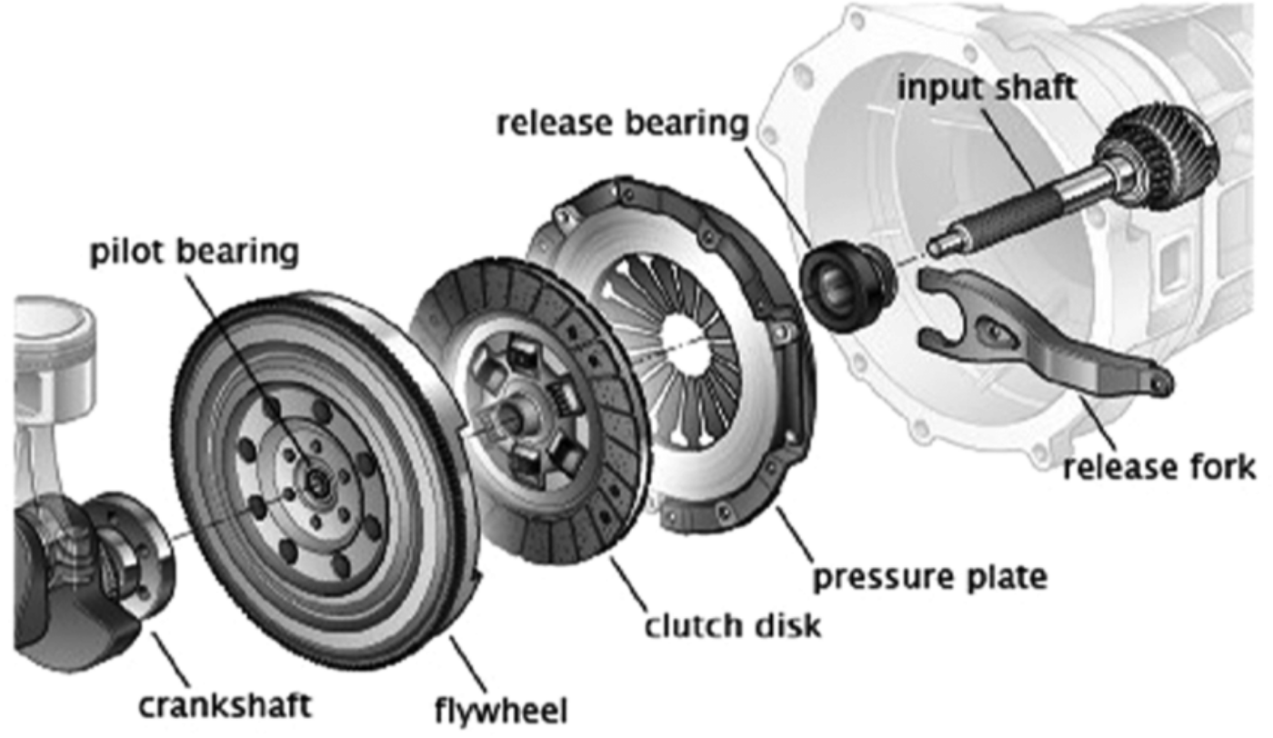

    This is a great thread. I have one to offer. I've never had the right clutch alignment tools for any of my clutch jobs. I used to use a couple of sockets, one to fit the pilot bearing and the other for the clutch disc splines. On the last three jobs I tried using a few strips of good paper masking tape on the edge of the disc and the pressure plate.
    I don't have any photos but the illustration should be enough to use as a visual. The disc and pressure plate are usually the same size. So if you place the disc on pressure plate exactly to line up the edges of both and then put a few strips of tape on their edges, it should line up perfectly. The tape is strong enough to hold the disc to the plate long enough to install the cover to the flywheel. The tape won't damage anything even if you leave the tape on them after installing the transmission. The first time you use the clutch, the tape will fly off away from the clutch. It has worked each time I put in a new clutch.
    No need for any special tools.

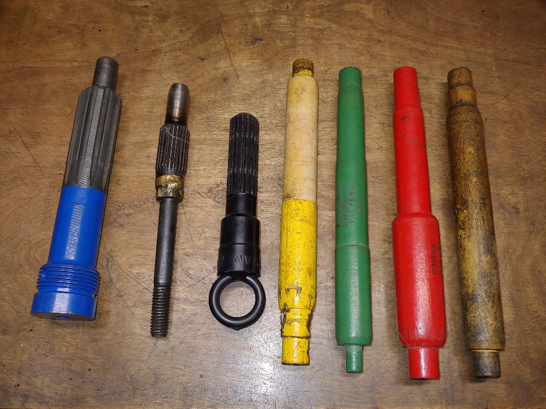

    An old input shaft always did the clutch alignment for me. Tighten the pressure bolts, install the bellhousing and pull the old input shaft. Then I would lay the transmission on my chest, lift it up and it usually slid right in. Of course I was much younger back then. Probably could not do that today.

    I didn't even know there was an alignment tool until I was in my 30s. I bought a clutch kit and there was one in it. It looked enough like an input shat that I figured out what it was.

  15. I can remember when those were wood... LOLOL. I never had much luck with those or the plastic ones either, I finally got a dead input shaft from a trans that I use now. Works much better...

    These wood ones are marked:
    Lyner Mfg.
    Chicago, Ill.
    Patent Pending
    I've had them since the early seventies.

    I’ve only gotten a clutch alignment tool once in a clutch kit. Not only did I get sent the wrong tool, the clutch was for the wrong car. I’ve never had any spare input shafts.
