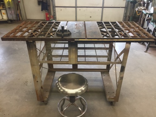

    I am finishing up a semi precision welding table. I used parts of two old table saws and half of a bread cart that I got for free from a friends restaurant. The throat plate reverses to bring up a welding jig used for clamping parts to weld. The miter gauge and rip fence can be used to help align parts at an angle. Clamping can be done through the webbing on the ends. An added feature is that the slag from welding is easy to remove from the cast iron top. I got the idea from a web video, then I made it my own. I have added a couple of other improvements since I took these photos. Cheap table made from junk.
    When I do not need it for welding, I can lay a old wood door on top and use it as a roll around workbench.

    ^ That's some clever repurposing, WZ! I like your "hold it right there!" jig too.

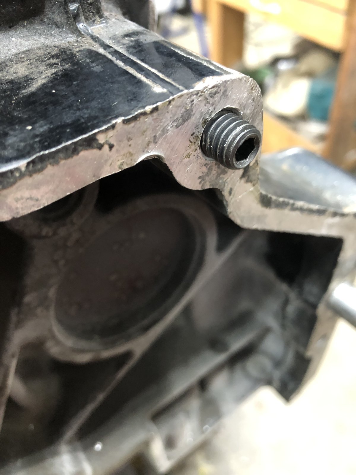

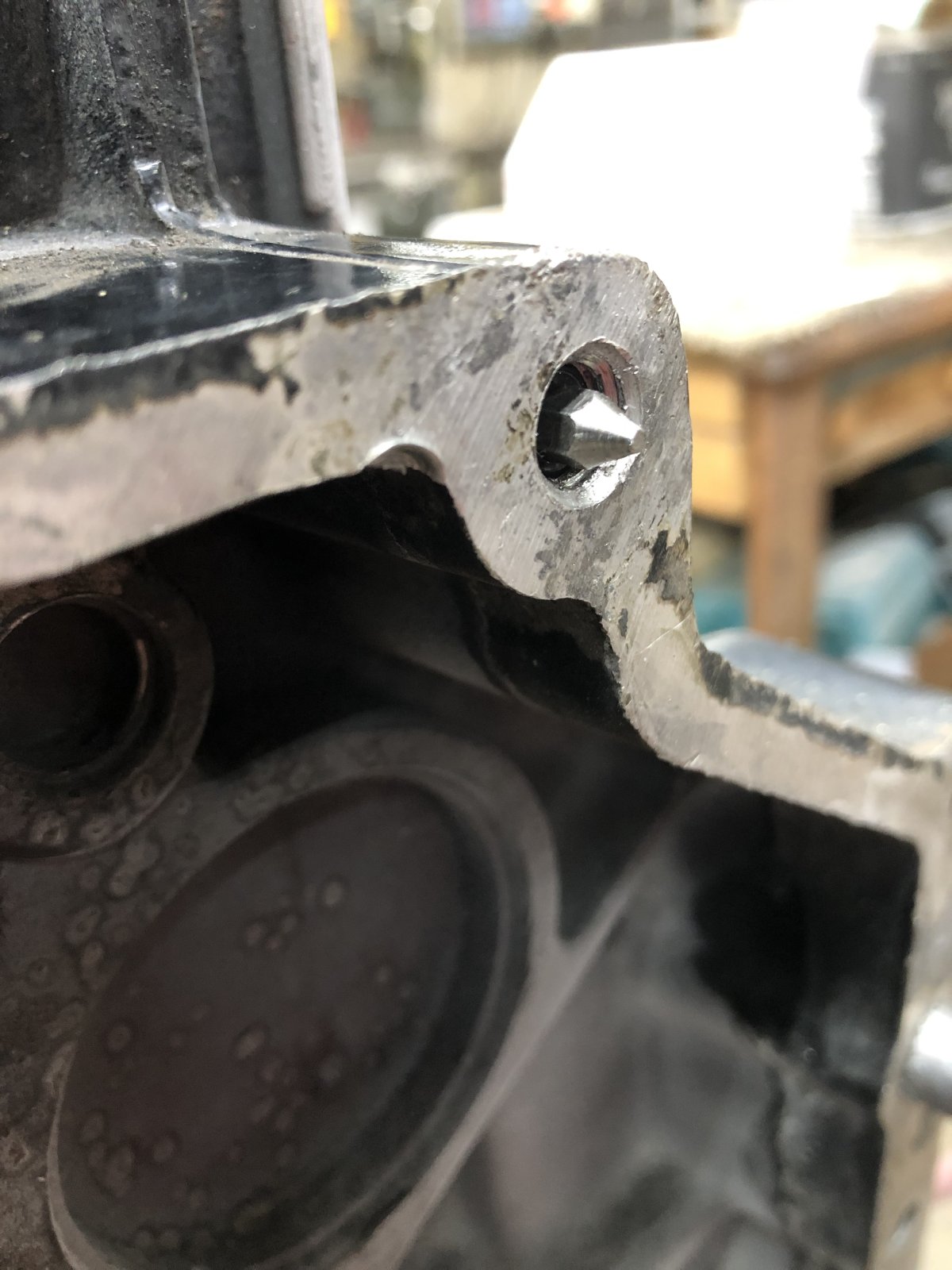

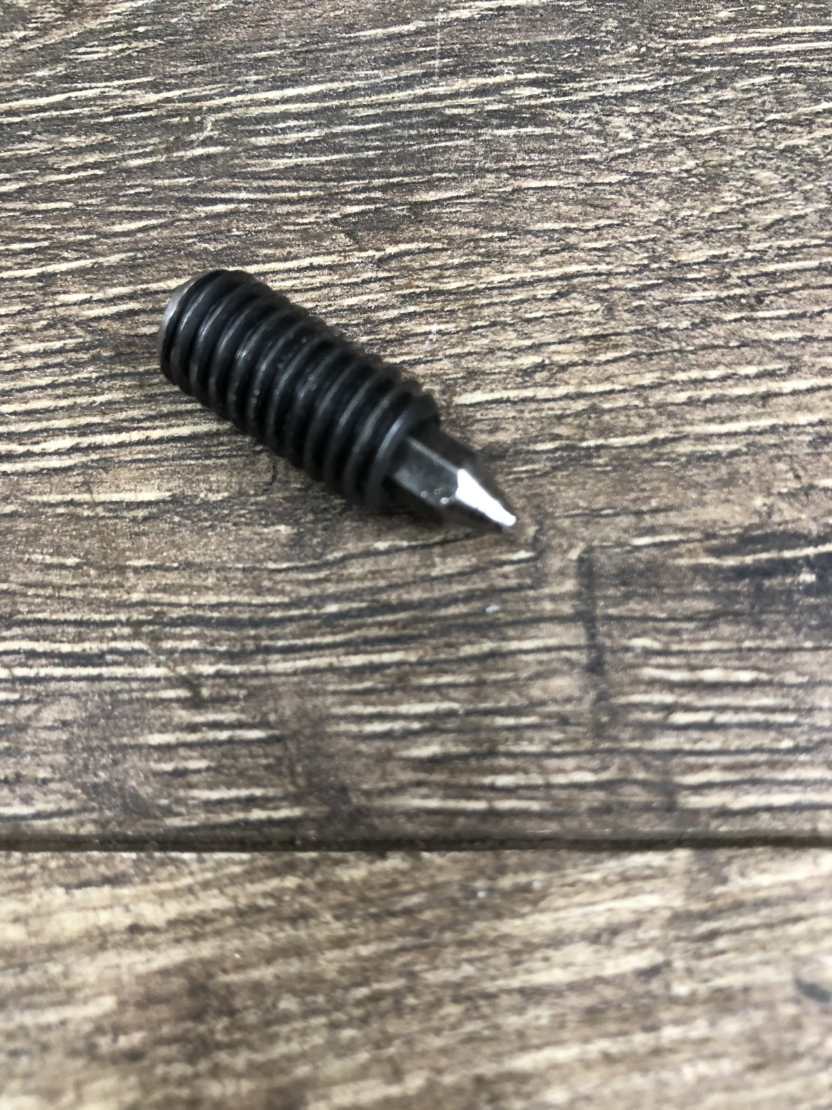

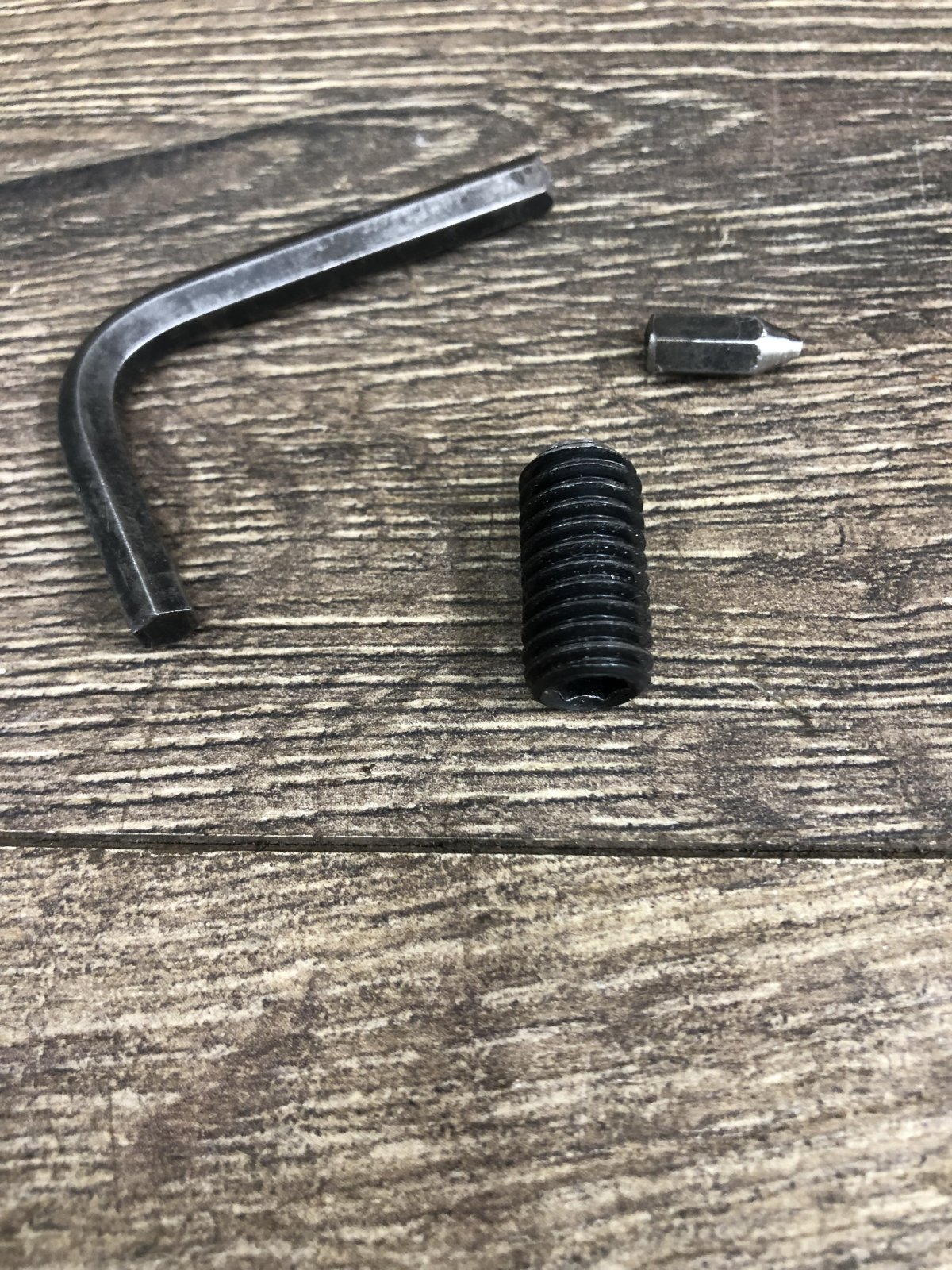

    Ever have to mark a tapped hole accurately from the blind side? I was making a motor plate and needed to reference a hole from the engine side where there was no bell housing bolt hole.
    This is what I came up with:
    3/8" set screw
    Corresponding Allen wrench
    Cut the end off the Allen wrench
    Sharpen to a point (could even be shaper than this)
    Set screw partially installed
    Pointed bit installed
    Then I installed the plate on the dowels and gave it a rap with a rubber mallet.
    Be sure to deburr the Allen punch so that it slides easily in ad out of the set screw. If it gets jammed it will take more than a bit of cussing to get it out!

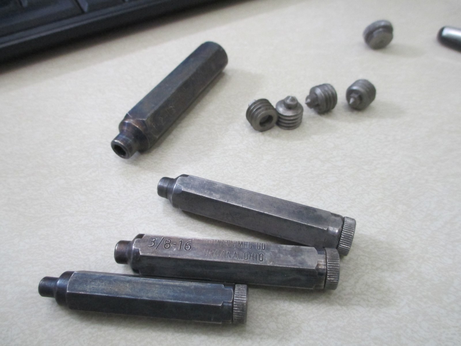

    Bruce, I have something similar, called transfer screws, in various sizes and threads. The screws are stored in the handle used to install them. IMG_0071.JPG IMG_0072.JPG

    I don't think those would have worked for this application. Am I right?

    Oh yes they would.
  14. GearheadsQCE
    Joined: Mar 23, 2011
    Posts: 3,670
    GearheadsQCE
    Alliance Vendor
    I guess I'm not understanding then.
    I needed to mark the location of a tapped blind hole on the blind side of the motor plate. So, the center punch had to be inside the tapped hole.
  15. Hollywood-East
    Joined: Mar 13, 2008
    Posts: 2,150
    Hollywood-East
    I think what Marty is saying...
    He would of had in his set, something that by hand could have been placed in said hole finger tight, Only the threaded part... backwards
    LWEL9226 and alanp561 like this.
  16. LWEL9226
    Joined: Jul 7, 2012
    Posts: 362
    LWEL9226
    from So. Oregon
    That is exactly the type of situation those are made for.....

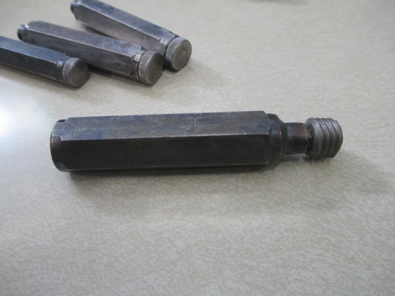

    OK Bruce, a picture is worth a thousand words. The hex tube that stores the screws has a female hex on the end, to serve as a driver. Screw them in to the proper depth, and presto. IMG_0073.JPG IMG_0074.JPG IMG_0077.JPG IMG_0079.JPG

    Things like transfer screw sets are not available universally worldwide, so the home made idea is very good. This could be replicated anywhere in the world as long as an allen grub screw is available in that thread. Great tip in my view. Have a like from me.
    I made some transfer screws by turning a bolt down but relied on pliers to get them in and out.

    Thanx Marty,
    I didn't get how the handle was used. I guess I won't be getting a patent on this one! :D

    These are all good tips. The commercial set would be nice to have and seem to be very affordable. Gearhead's idea is very handy if need now. It can be made with things that are in my shop without a trip to the nearest hardware store, a 24 mile round trip past my favorite bar twice. :eek:
    Gearhead's design could have the punch tip tack welded in the hex plug so it would stay in place and be used with a driver like Marty's set. Looking at Gearhead's pictures welding is probably not even needed. Handy tools. Thanks!
