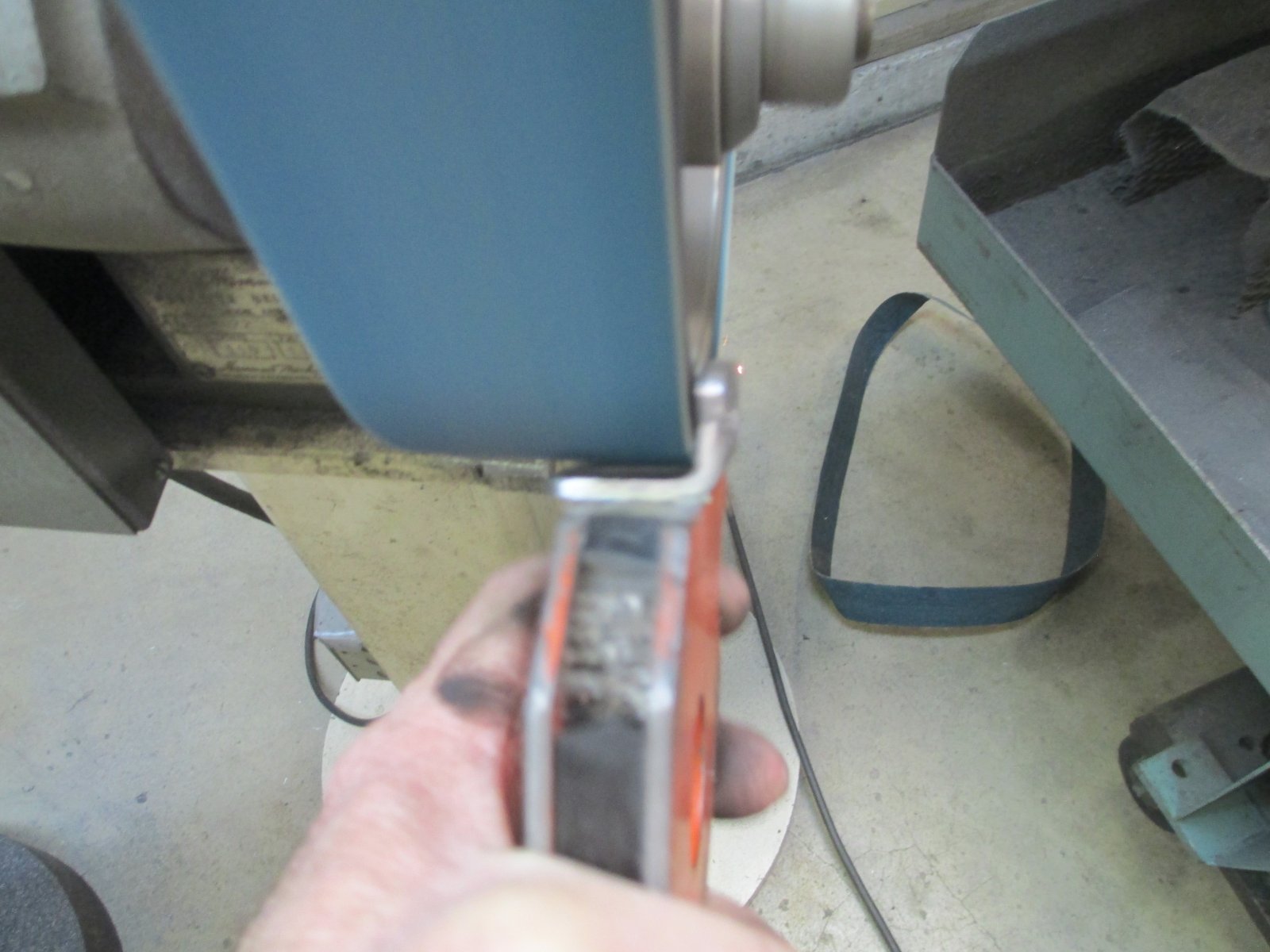

    This has probably been shown before, this is how I hang to small steel parts while belt sanding, using a mop disc and a wire wheel. A magnet work well. IMG_0106.JPG IMG_0107.JPG IMG_0108.JPG IMG_0109.JPG
  20. spanners
    Joined: Feb 24, 2009
    Posts: 2,197
    spanners
    I wish I'd of thought of that. I might have gloves with less ground fingertips. Thanks Marty.

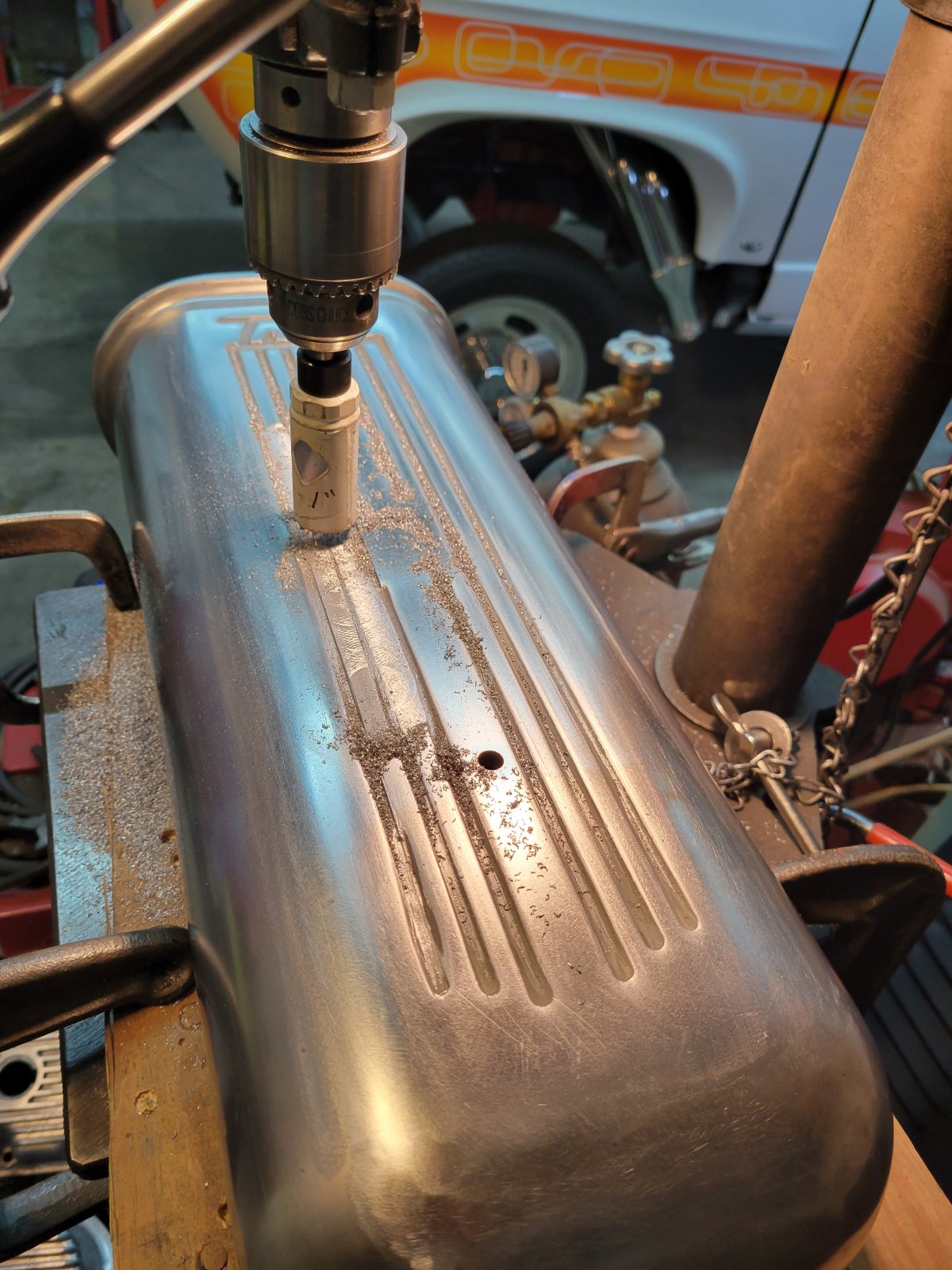

    Now this isn't for precision work .... unless you have a perfectly flat table, perfectly flat hole saw and a perfectly straight jig to run your piece through.
    But if you just need something milled for clearance then this is your hack, it's a little trick setting the depth but multiple light p***es usually works pretty good.
    X-cpe, brEad, R A Wrench and 18 others like this.
  29. That looks good.... Show us the finished part, please.
