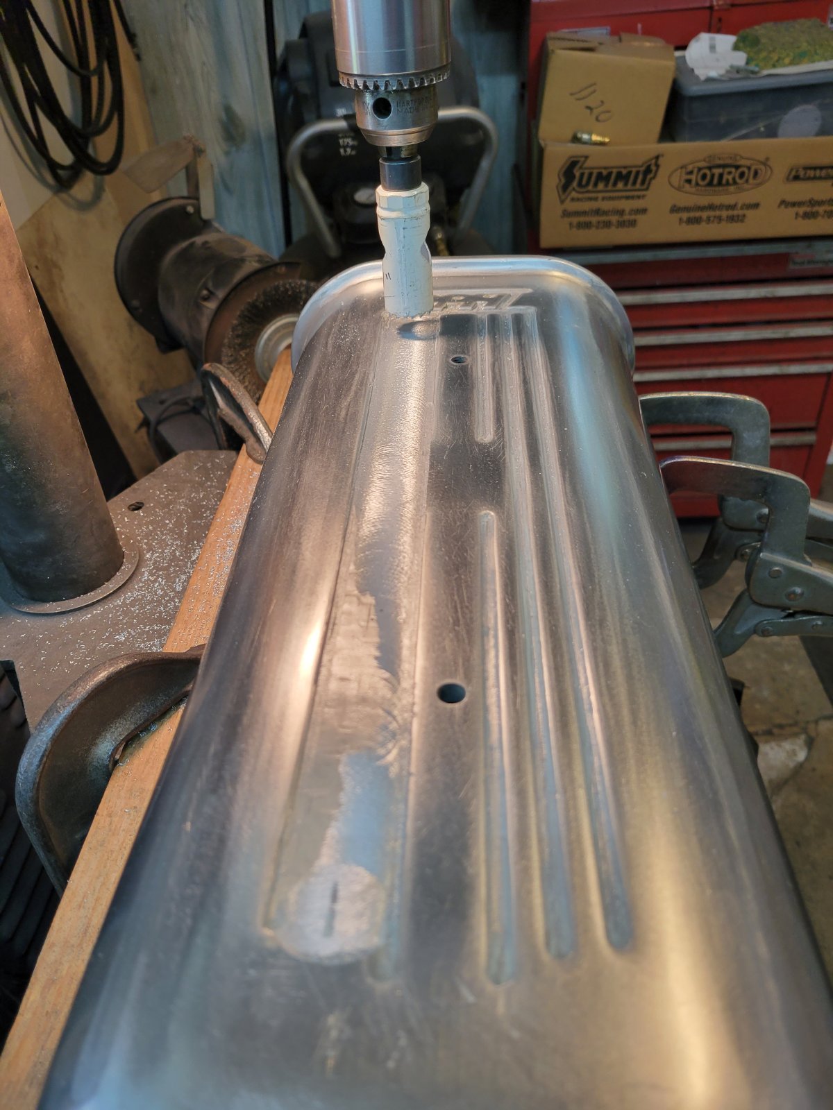

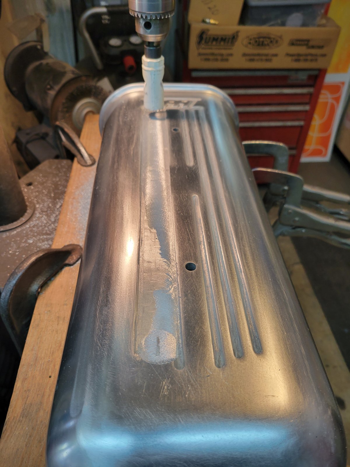

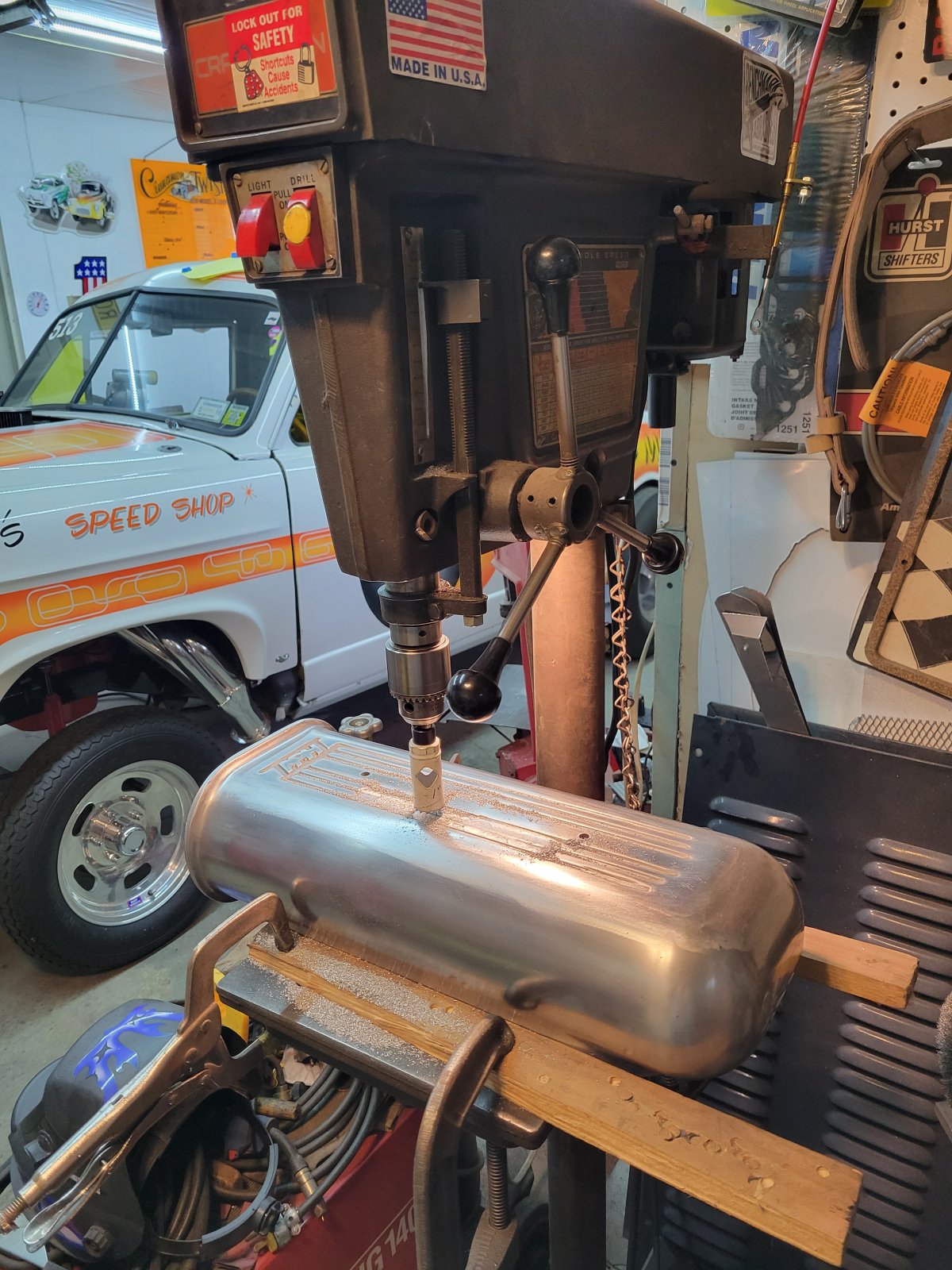

    That's all that I did for today, I'll work on it a little more tomorrow and see where I get.
    The scoop's width isn't the same front to rear, so it's tricky setting up the jig loose enough to slide the scoop back and forth without it getting sloppy or to tight and chewing metal where you don't want to.
    I'll do a couple updated photos though when I get one side done.

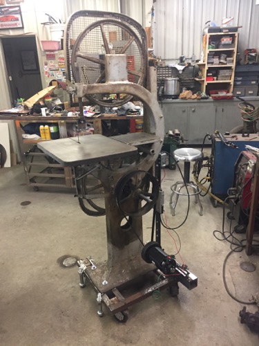

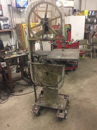

    I converted a band saw that is probably over a hundred years old to run off of a treadmill motor. 644EE1AF-AC55-487A-BA8F-A2CBA13837A8-resized.jpeg DAA34CCC-EA77-4F4C-8E88-6414F95C9155_1_102_o-resized.jpeg

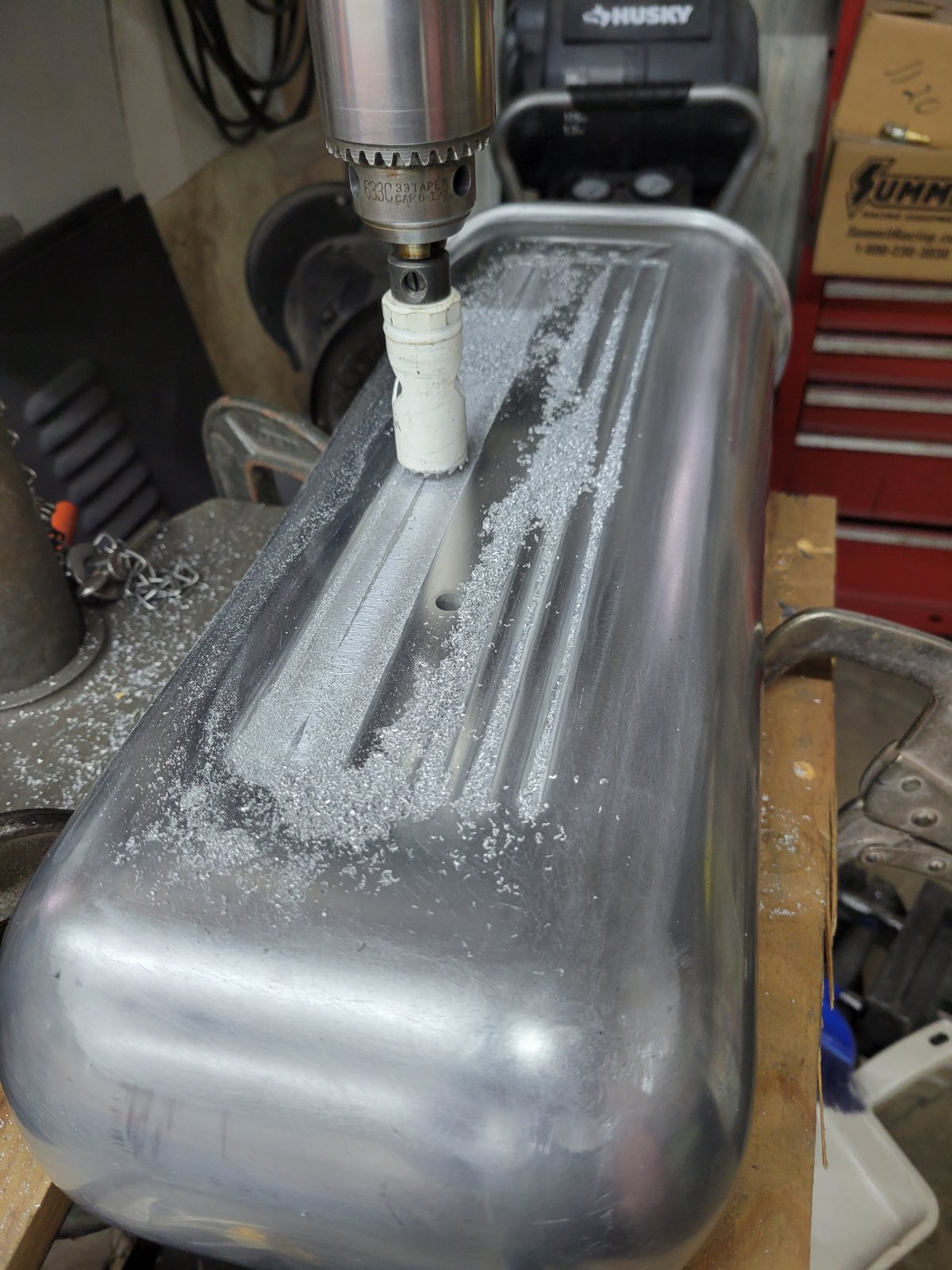

    A little more done, slowly getting there and yes there's a couple screw ups on my part but it's looking pretty good.
    The table needs to be bigger, it would be easy enough to build something out of wood but when have you seen an even piece of wood lately lol

  4. That does a surprisingly good job! Good thinking there, @swade41!

    Cool tip... would never have thought of using holesaws like that. I have holesaws and a drill press... queue footage of me destroying something because I can't slide the part straight across the table.
    The context is driving me nuts though... why are you milling the top of the scoop?

    There was a casting flaw or something in the fins
    I took a file to it to straighten the lines up but it still wasn't right so I decided to get rid of them all together, might even cut that section out and put yellow plexigl*** back in

  11. I did one to a bandsaw and used the control panel from the treadmill. Can’t do it well with all of them but snagging the right treadmill makes it easy. Everyone get a kick out of it.

    That's a neat idea. I had a pair of Edelbrock valve covers that some ***** drilled a hole for a PCV right in middle of the script. I wanted to add a Moon breather to salvage the covers, so I built a wood cage for the cover and used my router with a carbide burr to make a flat area; then I clamped the box to my drill press table and tilted it to 45 degrees and used the router bit in the press to cut the end of the fins at an angle. Worked out OK.

    Aaah.... thankyou. When you said the milling technique was good for clearance, I started wondering what you would need to clear up there. I had visions of some kind of barrel valve or hat injection. The real answer is a lot simpler.

    For the bandsaw conversion, I used a variable speed controller and rectifier bought on Amazon. I watched some YouTube videos from this guy, and I used information from his web site. variable.html

    I have a pair of M/T covers I need to cut the fins for some breathers and a router that came in an auction lot I bought, maybe I need to learn how to use it.

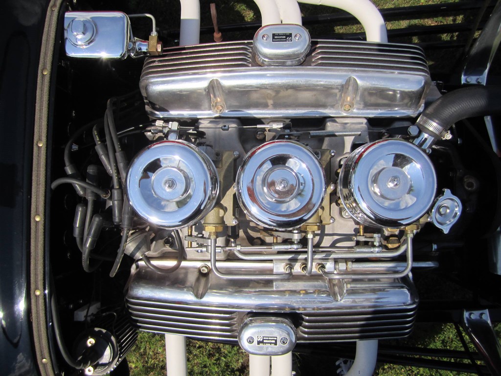

    I've had the scoop on my blower and tunnel ram engines, but yeah nothing crazy like mechanical injection stuff.
    Just removing some ugly is all

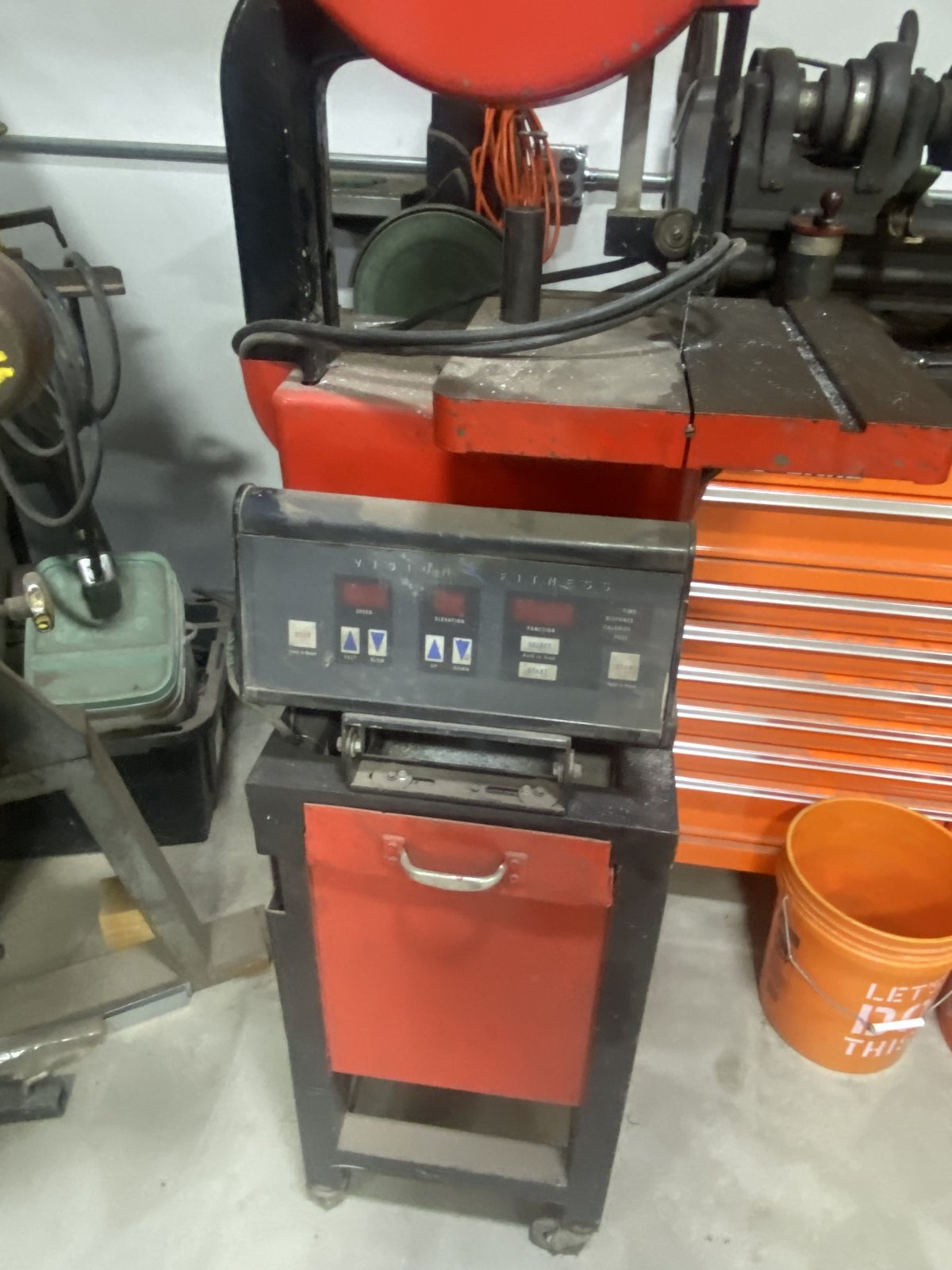

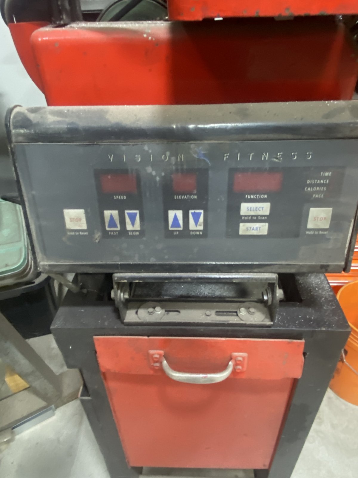

  19. Here’s my treadmill powered band saw.
    with treadmill control panel
    4562F83E-499F-446C-860A-53C951ACDCD7.jpeg 1845D85B-11EC-4D3C-B3F8-F0A56830720B.jpeg
    oil burner, brEad, slack and 8 others like this.
  20. b-body-bob
    Joined: Apr 23, 2011
    Posts: 714
    b-body-bob
    Now I'm sitting here wondering what would be a good use for the elevation mechanism.
    egads likes this.
  21. I couldn’think of one at the time either,
    so I just left it there.

    SAFETY POINT: As an old machinist who has seen what can happen when parts in a machine aren't secured to the table, I'd like to comment that I don't recommend trying to hand feed any part while cutting it with a powered cutting tool. All it takes is for the tool to grab slightly and the part will get damaged or ruined and you may get hurt. Seen plenty of parts that moved when clamped but not clamped tight enough......but if the tool bites in a little too much, things happen very quickly. A router with guides to control where it cuts could be used to remove fins gradually and would be safer. Just don't want to see anyone get hurt .:)
