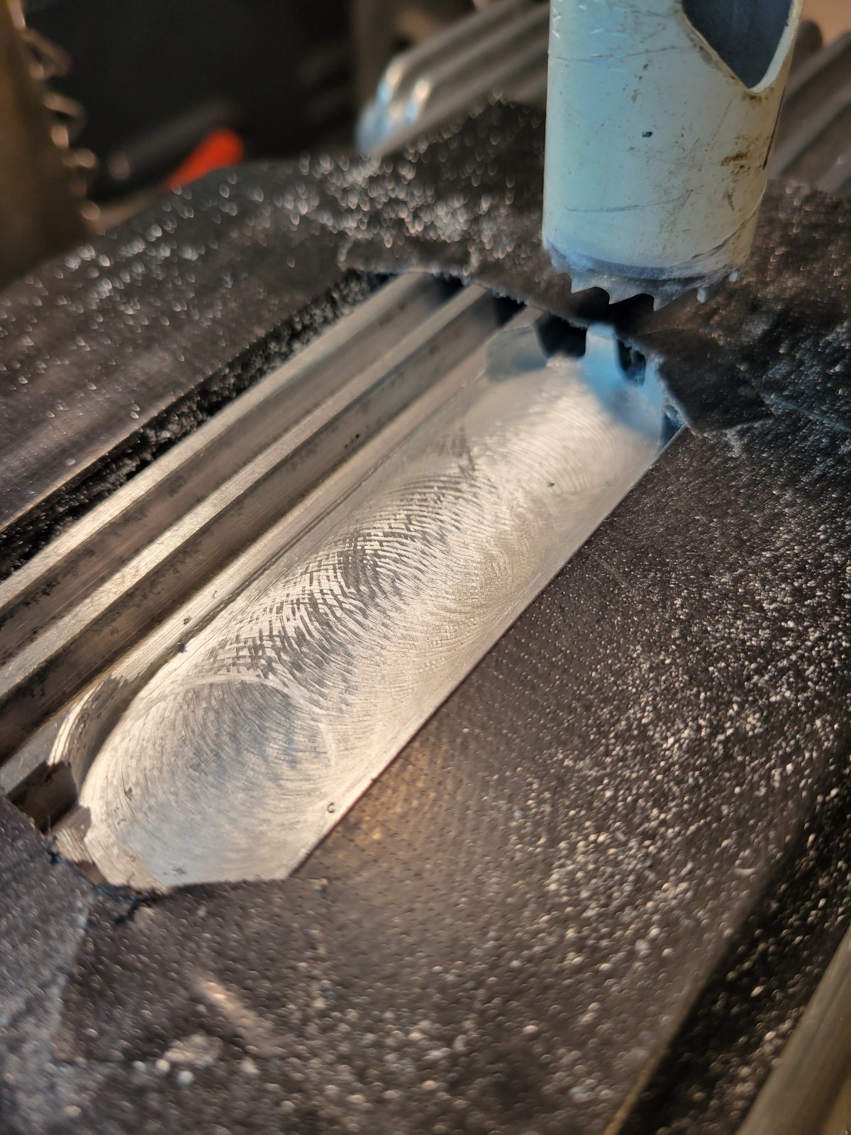

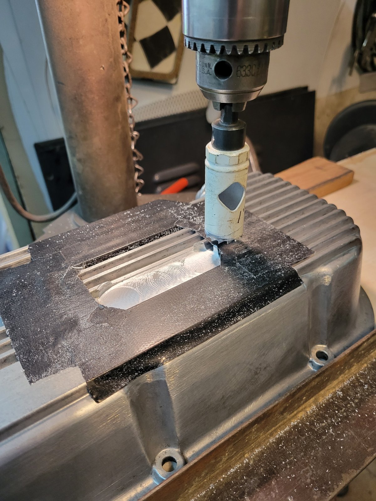

    Short video showing the light p***es I had mentioned in my original post

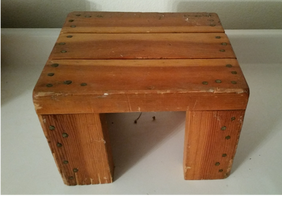

  23. jnaki
    Joined: Jan 1, 2015
    Posts: 11,382
    jnaki
    upload_2023-5-31_3-18-51.png Garage step stool, car seat height adjustment, toddler step to reach bathroom sink and won’t slip with rubber anti-slip pads on sturdy legs. And a 47 year old 2x4 step stool for top down (added height angle) photos in photo shoots as well as a indestructible seat for our son.
    Hello,
    54 years ago, we were taking photos and developing them in the dark room. I kept using a small step ladder and each time I got up near the top it was wobbly. The on site photo locations made it so I had to be on the ball and everything had to go step by step, ever so smoothly. So, I did not want to fall and make a big scene, so that small step ladder bit the dust. Then I used a heavy duty orange crate/milk crate with steel reinforced corners and supports for a step up angle. It was a stable platform to take a slightly higher angle than the normal ¾ rear/front photo that was popular in car photos.
    The photos with a different angle gave my photos a different look and hopefully it would make an impression on the editors as “something new” instead of the normal point and shoot array. When I showed the higher angle photos to the owners of the cars and motorcycles, they liked them and wanted a set for their own collection. Each hot rod family got their share of photos printed out for their albums.
    But, this new angle photography created another source of income if the owners wanted some for gifts and home displays. Custom frames from redwood/cedar slats, inset floating photos mounted within the frame, but looking like a floating photo away from all sides of the custom frame.
    Jnaki
    Jump up many years and another need popped up in our hectic family world. My wife had a low sporty car and it was a given that we would keep it forever. So, it was our project over the years. When our son was born and at the time car seats consisted of a GM factory model that was rated tops for safety in all cars, when strapped down correctly, not in just GM cars. The seat was made for rear facing locations and allowed the driver to see the sleeping or waking face of the baby/toddler, etc.
    There was a size limit and when it was too low in the front p***enger seat and the rear seat area, I made a 2x4 stool. At first, it was a stool just to raise the toddler safety seat higher, so he could see out of the windows. But, it was the only way to get the seat belts/shoulder harness to work correctly. Then it was convenience for us to make adjustments and to get him in/out without breaking our backs. Especially in the tight back seat area.
    As his toddler era was coming along, he used the stool as his kitchen nook dining area seat for messy ice cream in the hot summers and lunches at the kid's table. If it got dirty or had a series of drips, the polyurethane coating protected the wood and was an easy wipe off.
    Over the years, it stayed in the garage as a step stool to reach the taller cabinets. the older we got, the more stable a short ladder or platform was necessary. But, when our granddaughter was getting to the toddler stage, she needed a little help to get to the faucets to brush her teeth. So, up comes the old stool, totally cleaned off and still solid polyurethane coating protecting the wood. She can now, step up to any of the sinks to easily turn on/off, the faucets and brush her teeth.
    It also acted as a seat in the TV room to set things on for snacks and stand up toys that needed a flat, secure area. So, two generations of total family uses and still going strong for a couple of old folks to continue their protected pandemic lives. Step up and be counted…
    But, now with many garage clean outs to our credit over time, this solid 2x4 step stool is still functioning and is being put to good use by a couple of old folks out in the yard, when planting new bushes, flowers and trees. It is low enough to the ground, but high enough to work comfortably without back pain. Perfect height for working on replacement electrical wall plugs and detailed work on new baseboards, too. YRMV

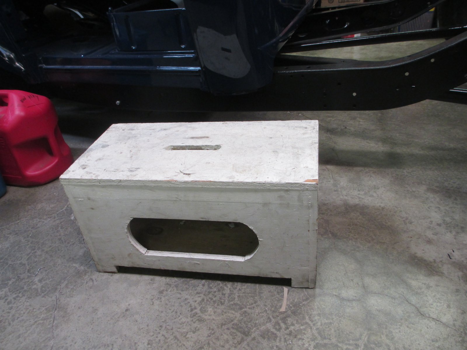

  24. Marty Strode
    Joined: Apr 28, 2011
    Posts: 9,690
    Marty Strode
    On the subject of step stools, a guy made me 2 of these. They are plywood, lightweight, and with a slot in the top to pick them up. Very handy, and a must for every g***er builder ! IMG_0154.JPG

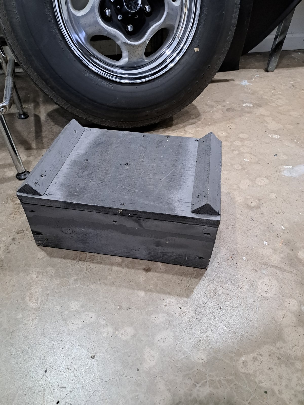

  27. chevy57dude
    Joined: Dec 10, 2007
    Posts: 9,673
    chevy57dude
    I made 4 of the step boxes. They can support the car, useful for checking pinion angle,etc.

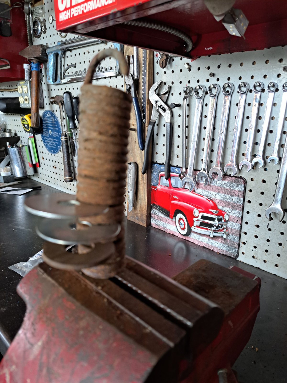

    On the subject of springs: 55 Chevy hood springs needed to be expanded for installation. Held in a vise, bent by hand to one side. Washers inserted. Bent the other way and more washers. The spring spread far enough to slip over the hooks. Slowly closed the hood and the washers dropped in my hand.

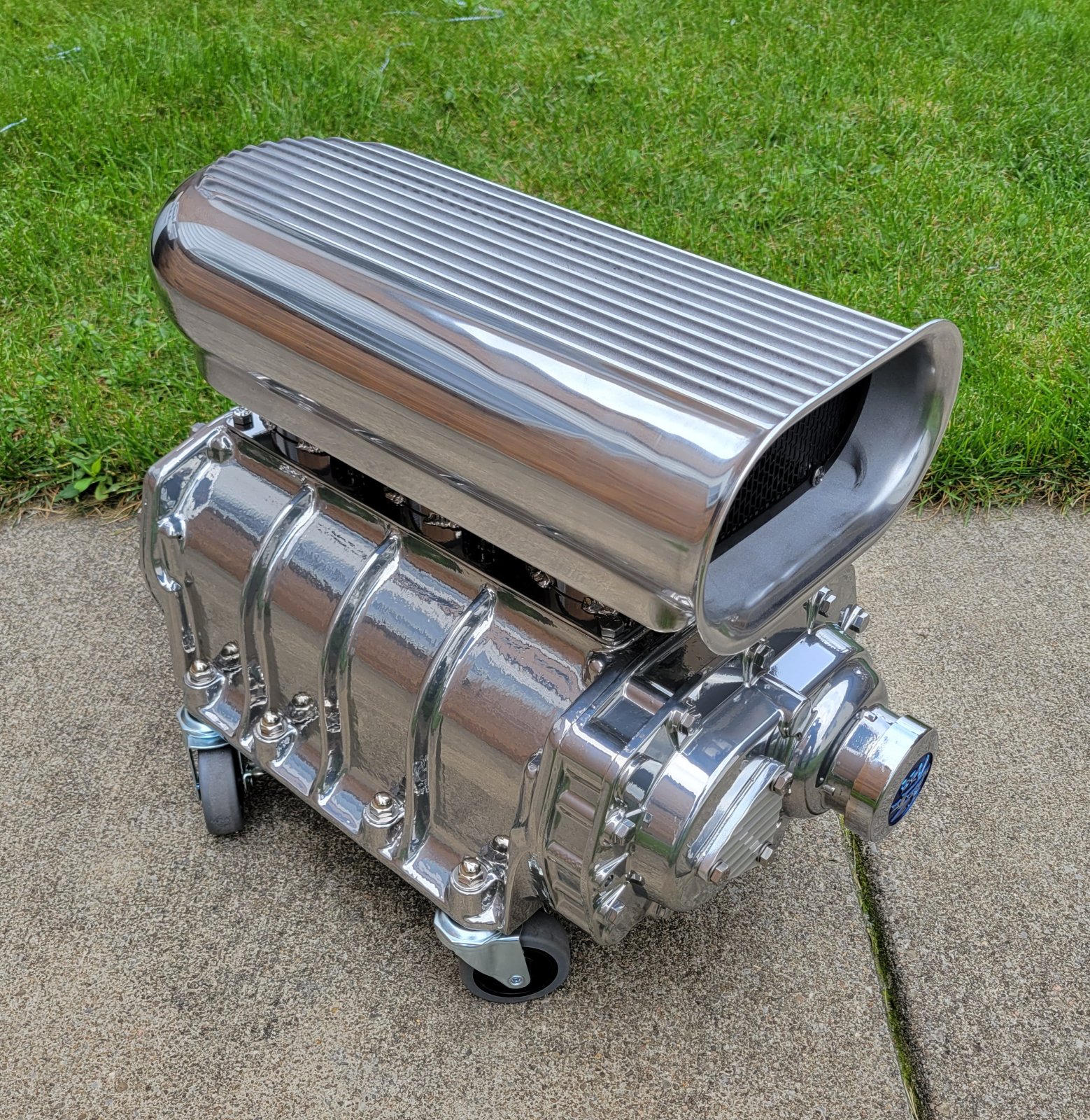

    swade41
    from Buffalo,NY
    I made this stool out of unused stuff laying around, works great to roll my 240 lb fat *** around, with back issues you just can't have enough places to sit and work.
    I don't think I'd use it to stand on though, even with the locks on the wheels
