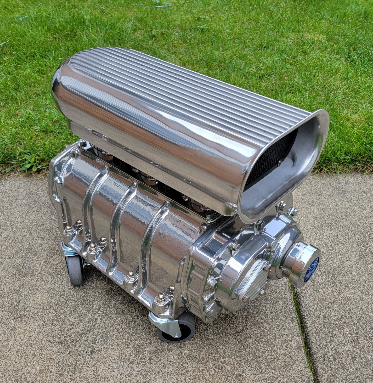

    ^Wheel center cap on the snout^:cool:.

    Imitation snout lol
    Cut up a different version for my gas cap

    Wow, what a nice build. My wife would probably like that sitting in the garage to be used for something. It looks like the right height for a circular roll around. It would add to our daily drivers to clean off the lower portions of the body and/or spiffy up the wheels/tires. No leaning and straining the lower back. It is a good thing the 671 build is on wheels. If the wheel locks work well, it might be a good short term stool for reaching high up in the taller cabinets. YRMV

    Yours is such a nice build and a good, useful, sit down item for working out in the garage. If the rotors are out, it would be lighter, but still would have a good rigid seat area and strength... Great job.

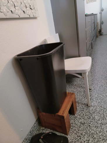

    The 47 years old step stool is sitting next to the next highest/oldest 50 year old simple wooden chair from our first kitchen. Now it is used as a top shelf level platform in the garage. It is also used outdoors in the garden, cutting trees, digging in new plants, offering support during painting/planting, all while sitting for a good grip and angle of work.
    Just the last two days of cloudy weather, my wife and I use those two old guys to help us remove and replant several areas of our front yard. It is a never ending process and it gives us time to think as we work. Plus, our backs thank us after we are finished and resting with a cold water drink. The 2x4 step stool is rigid and does not move. it is the perfect height to do wheel cleaning and anything at that level. It also allows me to reach up into the taller portions of the new garage cabinets for height without worry of falling off if it moves, which it never does...
    The two old guys sit quietly in the garage, until called upon to do some more work. They are and have been back savers and elevation increase support when we need it. When our granddaughter was staying with us during the toddler years, the wooden step helped her reach the sink for her daily necessities. It also provided a flat plateau area, covered with a towel, to act as a flat area for her little dolls to stand up to do their own thing on a normal bumpy tile/carpet floor surface…YRMV

    Yes totally gutted, someone was building a fake blower over a carburetor deal I think, the whole thing still has some heft to it but certainly not as much as the real thing.

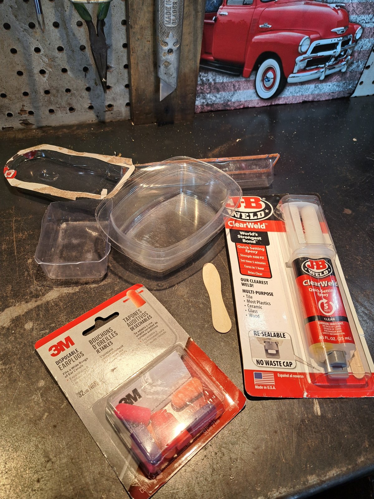

    Another low buck/no buck thing I do. Just about any small item you buy comes in a bubble style package. I save bubbles with a flat side for mixing small amounts of filler or epoxy. Disposable and easily replaced. 20230716_170842.jpg

    ^^^^^^If you know of a car lot that has gone broke or changed hands, the plastic license plates with the dealer's name make excellent mixing boards, too.

    And save used up gift cards/ expired credit cards to use as your mixer and spreader.

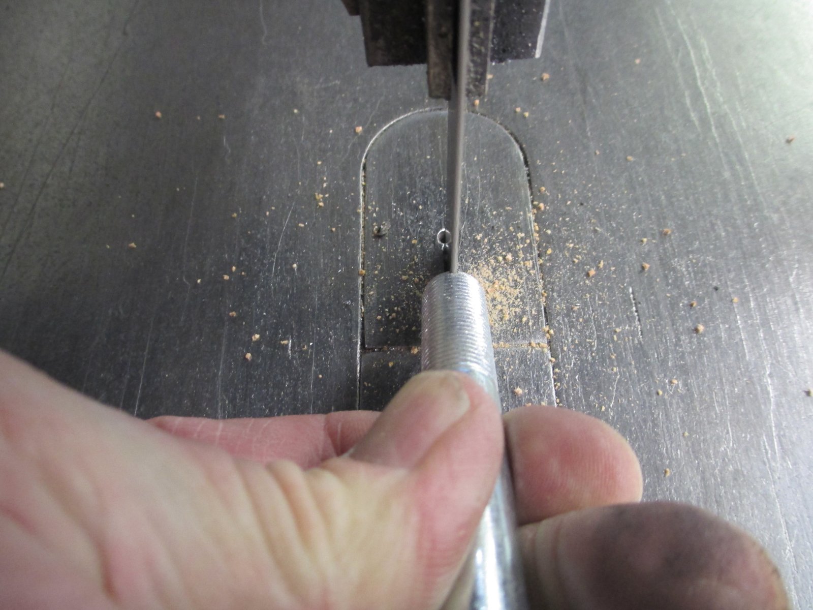

    When ***embling powder coated parts, and the bolt holes need more clearance, I cut some notches in the end of a bolt to serve as a reamer. IMG_8503.JPG IMG_8506.JPG

    Wonder if that would work on chrome?

    Hotel key cards work too!

    If you don't have thread chasers, that'll work!
