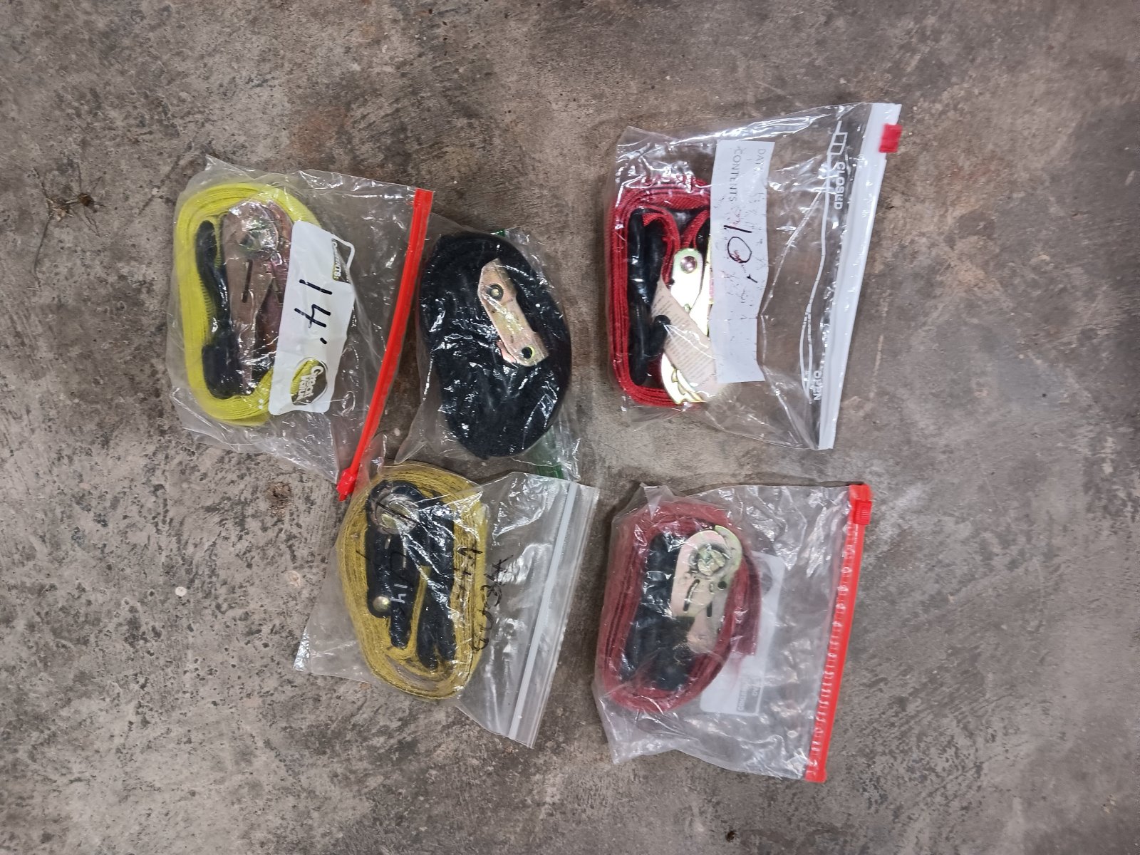

    We all use ratchet straps and have about a hundred ways to store them. Here's mine:
    The never get tangled up when in the baggies.
    Here are 4 ratchet straps and one motorcycle strap. I just grabbed these to snap a pic of. There is a milk crate about half full.
    You'll note that the length is shown on the baggie and/or the actual strap. That helps to know which one to grab.

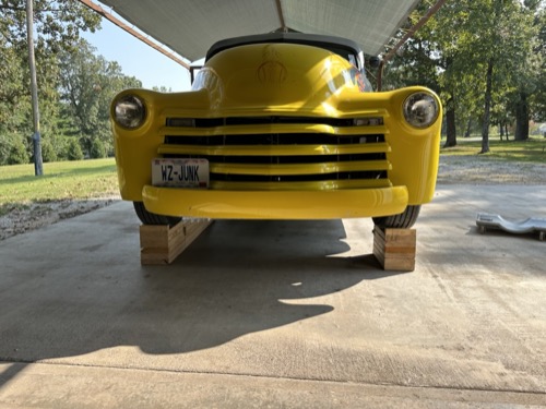

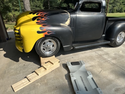

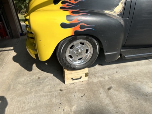

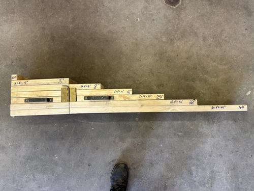

    I saw an idea for drive on ramps that work well for vehicles that are low to the ground. The commercial units rise at a steep angle and do not work well. I modified the you tube video idea to work for me. The feature that allows you to swing the ramp out of the way, or unpin it and remove it, makes it even more useful. I used two old door hinges and made removable pins to hold them together. I wrote the 2x8 dimensions for the ramp in the last photo. I will be using wheel chocks behind the rear wheels for safety.

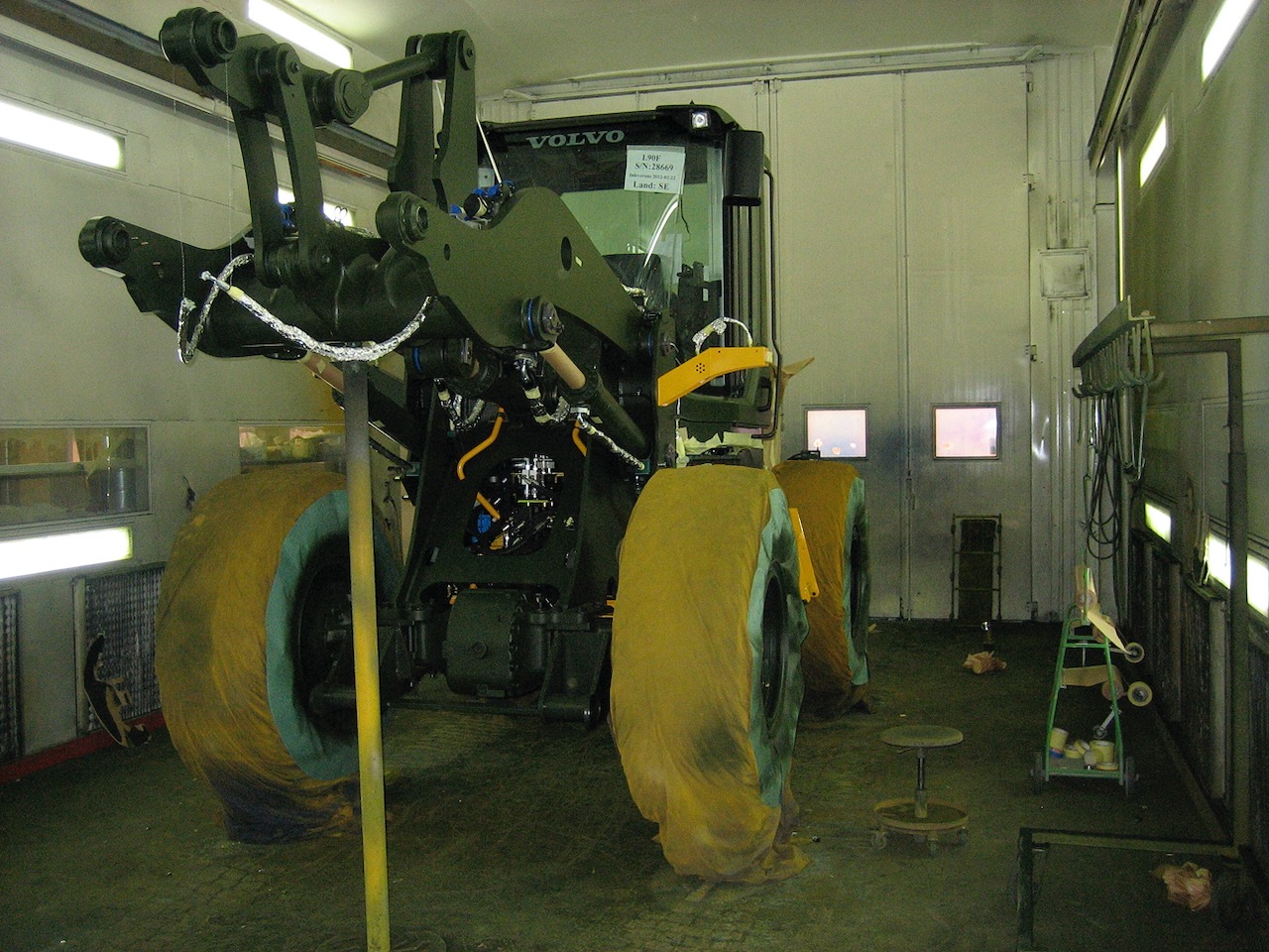

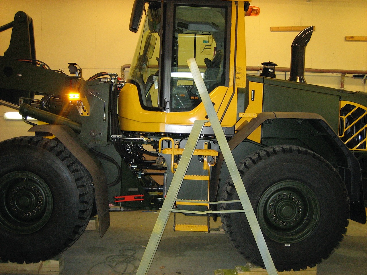

    @WZ JUNK. I used the 2x8 when I painted for the Swedish and American army.
    Sorry for the ****y pics,,

    The last set my dad built like that he mitered the cuts for the end of each board. Makes it easier to drive up.

    I've made the same ramps, with mitered ends and all, out of some left over 2x8-10-12 material (I forget which dimension, and they're out in the unlit shed right now, and I'm choosing to be lazy....). I like the hinge and handle idea, I'll definitely need to look into making those adjustments to mine.

    I thought about mitering the ends. I made a much smaller version of these years ago, with mitered ends. I used them to be able to raise a vehicle enough to get a floor jack underneath. They tended to slid sometimes when you started up the first incline. I thought the square end would let the tire load the ramp before in could slide. These do not slide but I do not know if that is what is making the difference. Probably it is the weight of the ramp.

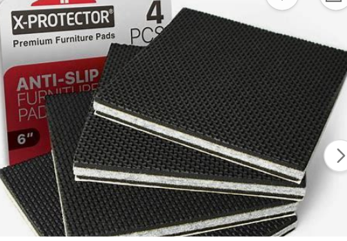

    How about some self-adhesive small non-skid rubber pads on the bottom of the ramps? Wouldn't take very big ones.

    I have a set of the plastic off-t******lf ramps for my daily drivers (actually work well for my low stuff too). They have rubber feet on four corners, but I find they still push particularly with heavier vehicles. If they're 4wd, that helps pull the vehicle onto the ramps.

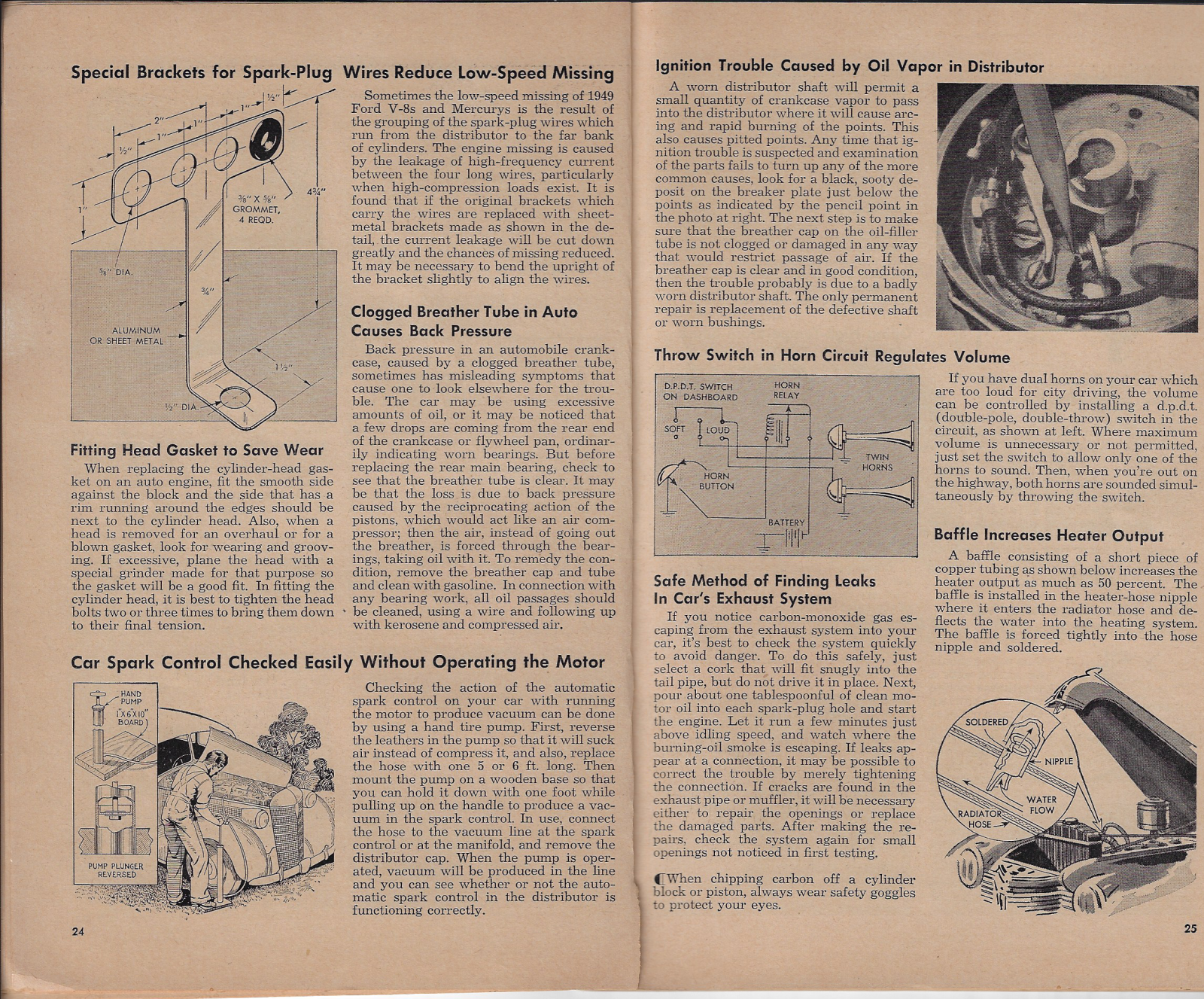

    From a Popular Mechanics 1951.
