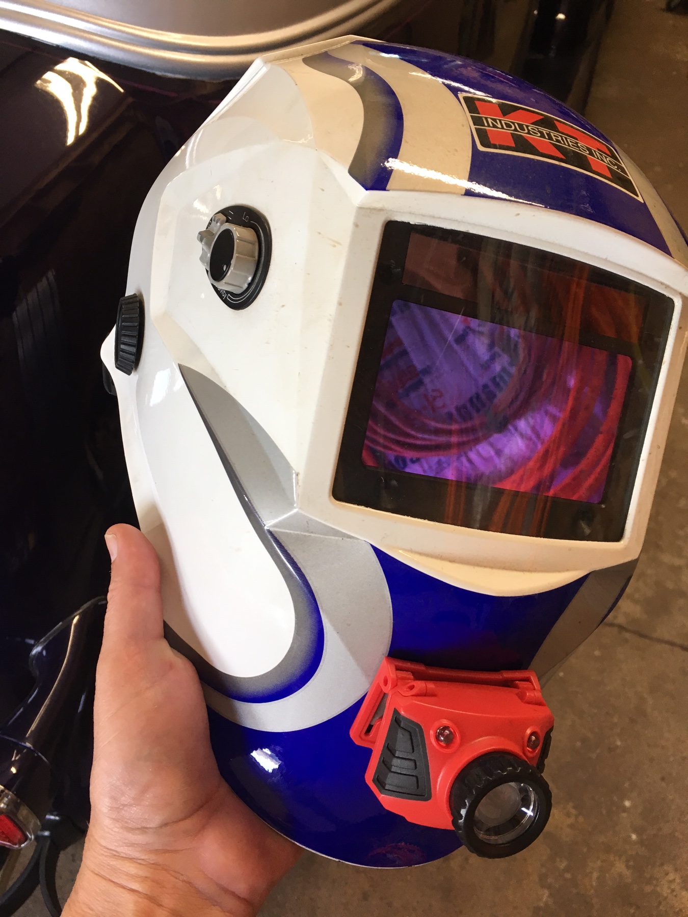

    3M exterior mounting tape and a cheap head lamp from Lowe’s

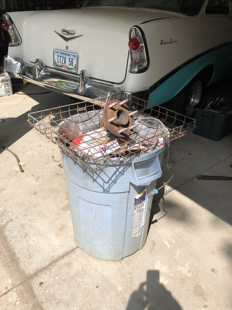

    To remove rust from small parts fill a container (don’t use aluminum) with white vinegar and place parts in the container. Stand back and watch the rust dissolve. Rinse and dry parts afterwards.

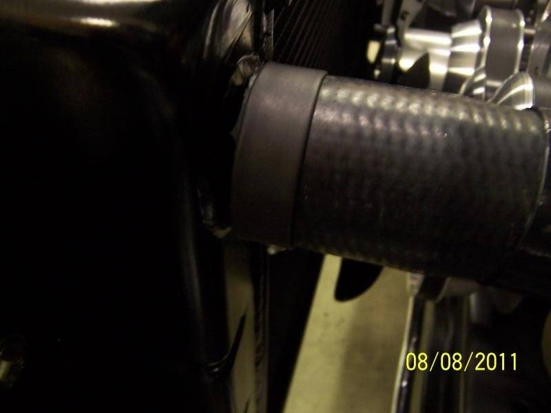

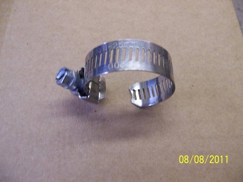

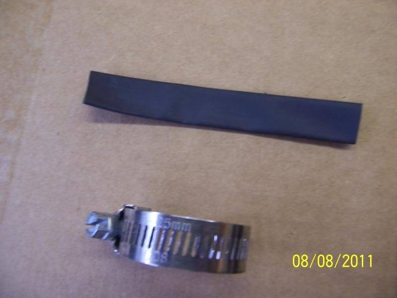

    Posted this one on other tips thread...
    Clean Up Ugly Hose Clamps In your Engine Bay. (Credit to Super Scamp 340)
    We all know hose clamps are ugly. So with some 1/2 inch heat shrink you can cover them.

  8. Just don't leave small parts too long. They may disappear.

    I really never thought of the stainless steel clamps as being ugly........but that is cool!

    I have used the cheap vinegar trick to clean up the crustiest F 1 hood hinges I had. they came out looking good and work great. For picking up metal shavings , chips, etc, I use old speaker magnets from s**** cars. Put one in a plastic bag & sweep it around the work area. I also use that trick in my alley after the area houses have been re-roofed, lots of stray nails.

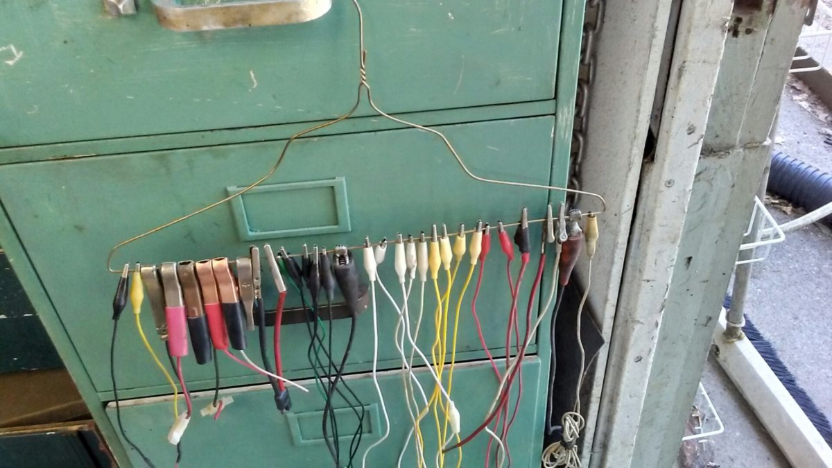

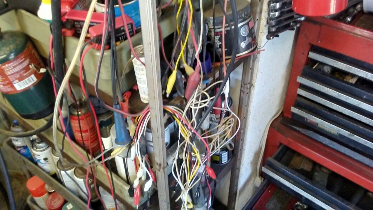

    Probably been done before, and done better, but it's better than what I had. Portable so I can bring it out to my heap.
    Before:
    0829191248_HDR_resized.jpg After: 0829191256_HDR_resized.jpg
