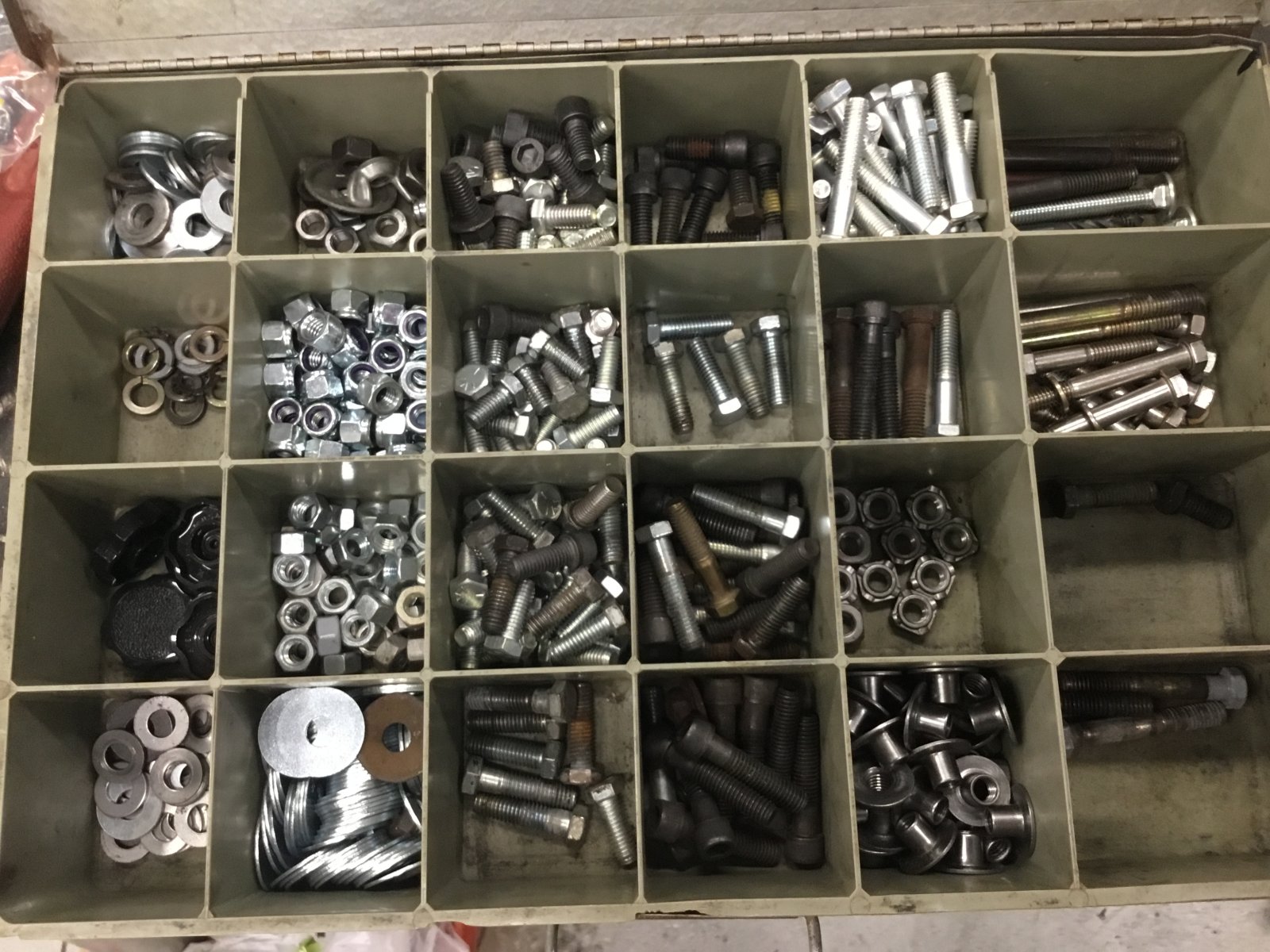

    Ok. Just caught found this thread. Great stuff in here. I have a couple to add. Here is how I store hardware. Easy, organized, and portable. Containers are about $15-$20 each. You can buy shelf units that hold them. I made my own and added it under my fab table IMG_0944.jpeg

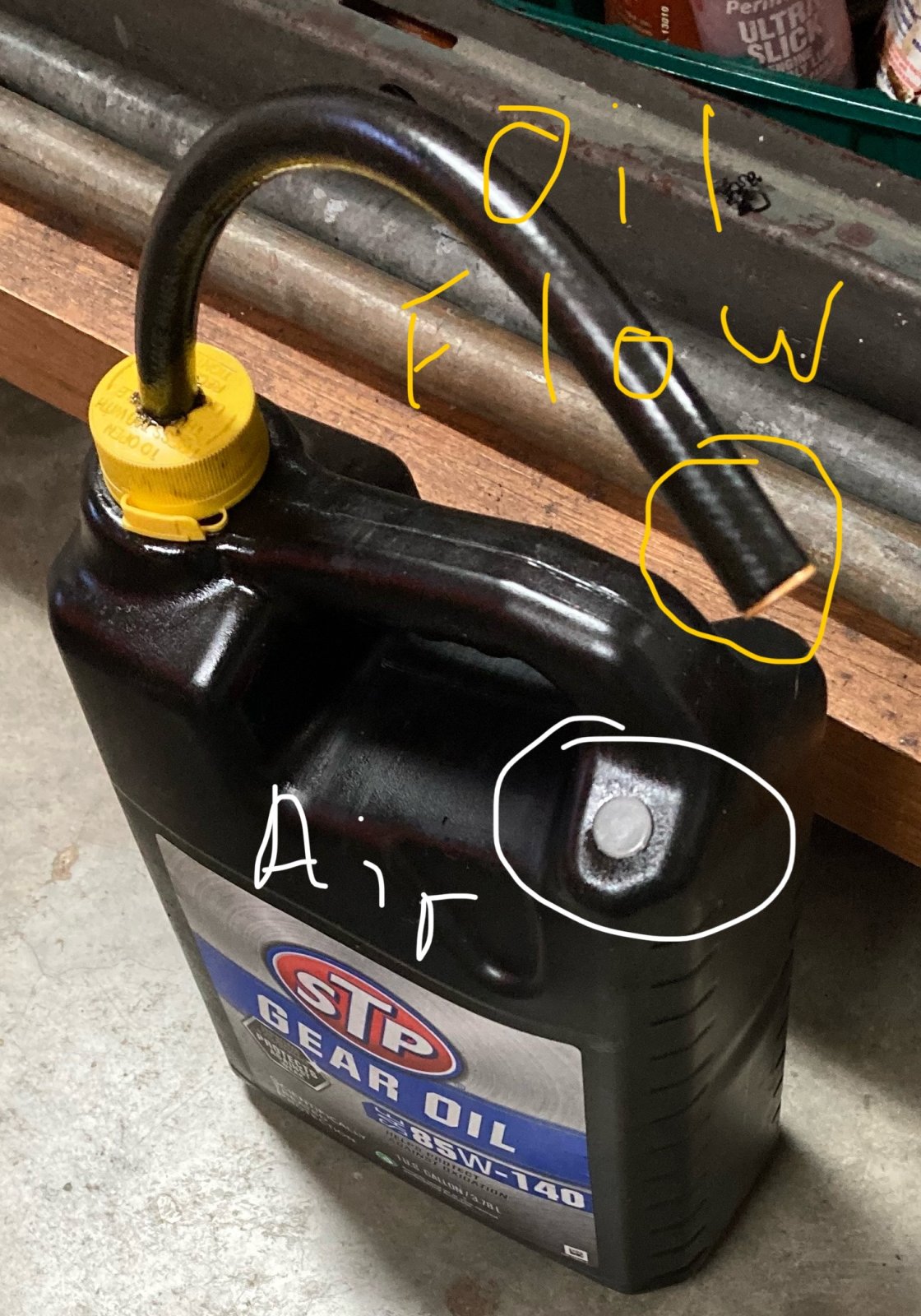

    Here’s a handy way to flow gear oil into a vertical transmission or differential fill hole. Drill a 1/2” hole in the cap and on the top where it wouldn’t be an issue if you had to use the container to pour. I used a 9/16” od rubber hose that sealed into the cap really well. The hose is sent to the bottom of the container, screw the top down tight and introduce air. Dial down your air pressure to 40 psi, hose in hole, give it some air slowly and Bob’s your uncle!
    A clear hose would be helpful to ***ure yourself that the flow is actually happening but either way it’s fill till it dribbles out for my applications.
    Note plugs that help prevent contaminants and spills, ready for future use.
