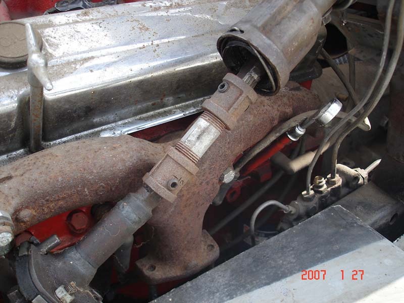

  2. That guy didn't even use Teflon tape!! What a maroon!

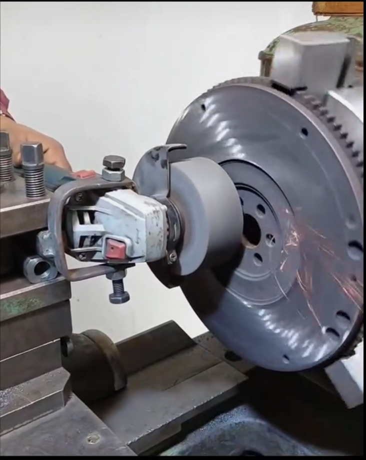

    Came out of an apartment that three of us were sharing one day to find one of the other guys tearing into his 394 powered '39 Oldsmobile sedan. The manifold was laying in the parking lot, and he was getting ready to pull the heads. I asked him what he was doing, and he said he was going to mill the heads. He didn't want any help, so I went to run some errands. When I got back, he had the heads upside down and was making slow passes across them with a 7-inch grinder. I just shook my head and went on.

    I talked to Warren Johnson several years ago as he was taking a DA to the flywheel in his Pro Stocker., running the starter to rotate it.
    I asked him if that was his Armstrong Blanchard grinder:D
    We both had a laugh about it.
    Not the same but similar!

    Oh ye of little faith. It could be done, might take a few tries. (heads) It is easier to deck the block with a belt sander.

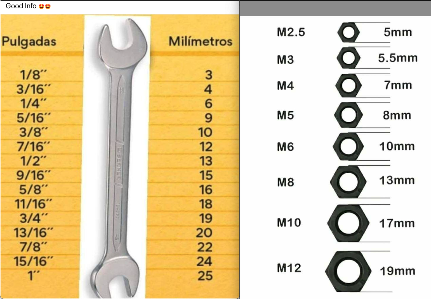

    I have both metric and imperial tools, as most metric and imperial don’t interchange.
    1” equals 25.4 mm, (not 25 mm) - the rest can be worked out from there.
    The figures posted are mostly inaccurate, ballpark figures at best…….
    hopefully others don’t put too much confidence in those.

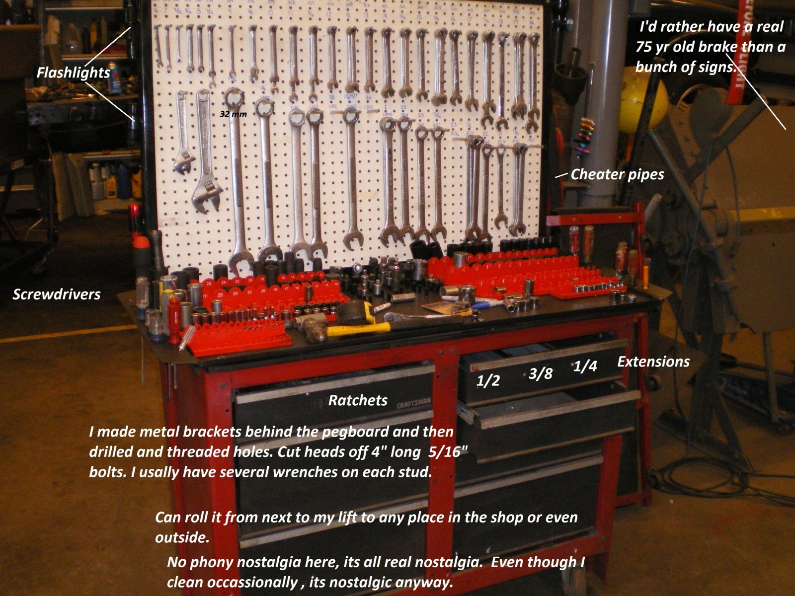

    Having newer cars that have a mixture of metric and American Standard bolts..............and me always having the wrong wrench, I got some pegboard and put it on an old/used/cheap Craftsman toolbox/workbench. I converted both of the wrench sizes to decimals and used a permanent marker to write the wrench size in both milimeters and Standard with the actual decimal size as well. Then I arranged the wrenches progressively from small to large. Now when I need the next size, I can hang the one I have and know exactly what wrench is slightly larger or smaller.....doesn't matter whether its Metric or Standard.
    I have a LOT of wrenches and I don't worry about brand names, just decent quality. This allows someone to hang multiple shaped wrenches of the same size...box, ratchet, offset, and shorties, which also gives you choice for the situation at hand. I buy cheap wrenches like Sears Companion and use them when I need to make a specialty wrench with my torch. Also, if you look at the cheap wrenches on the Tractor Supply "cheapie" table, they have thin jaws on them and work very well for changing small grinding tools in air tools. Bout $10 for a set, so $20 for both Metric and Standard.
