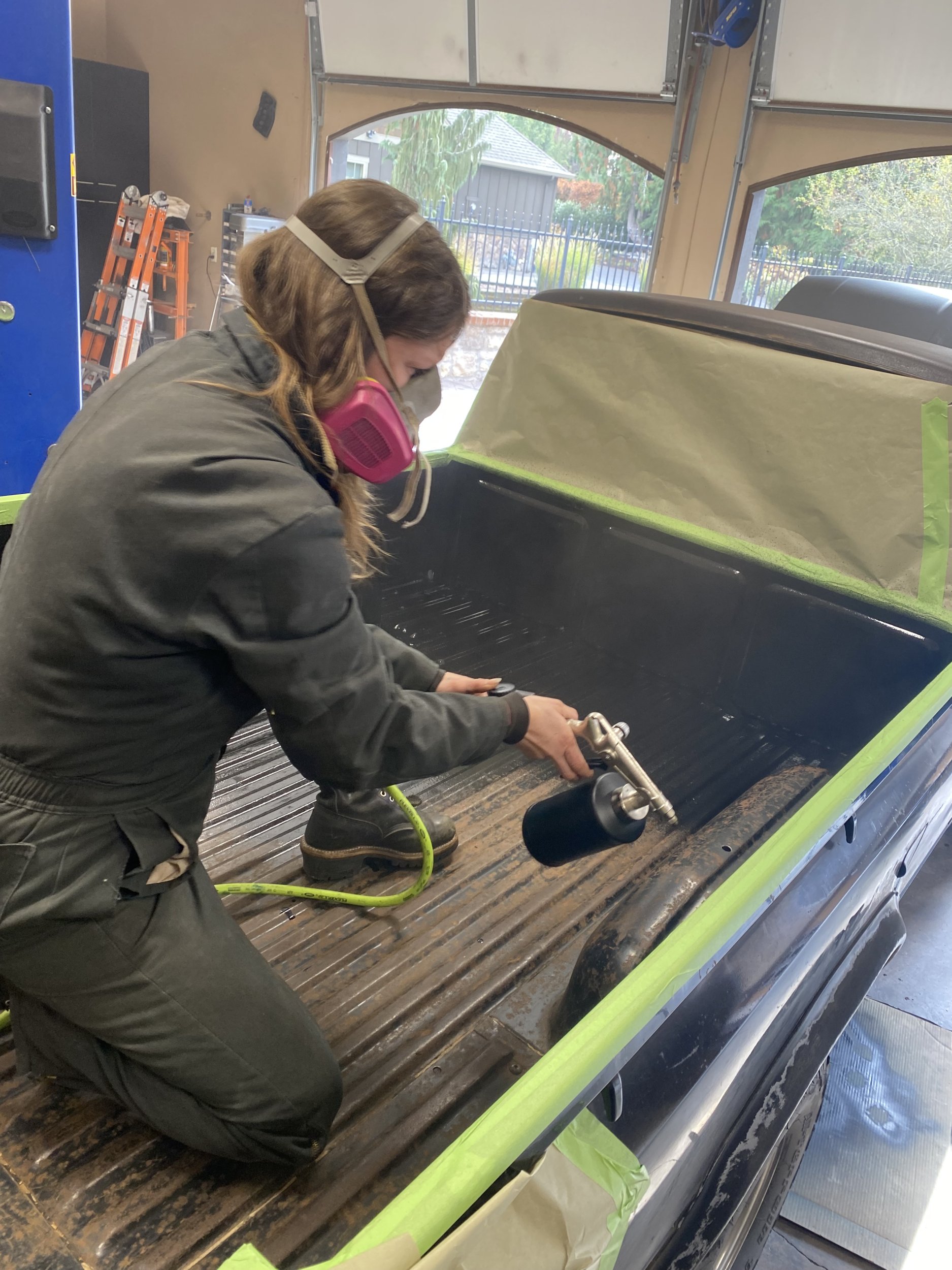

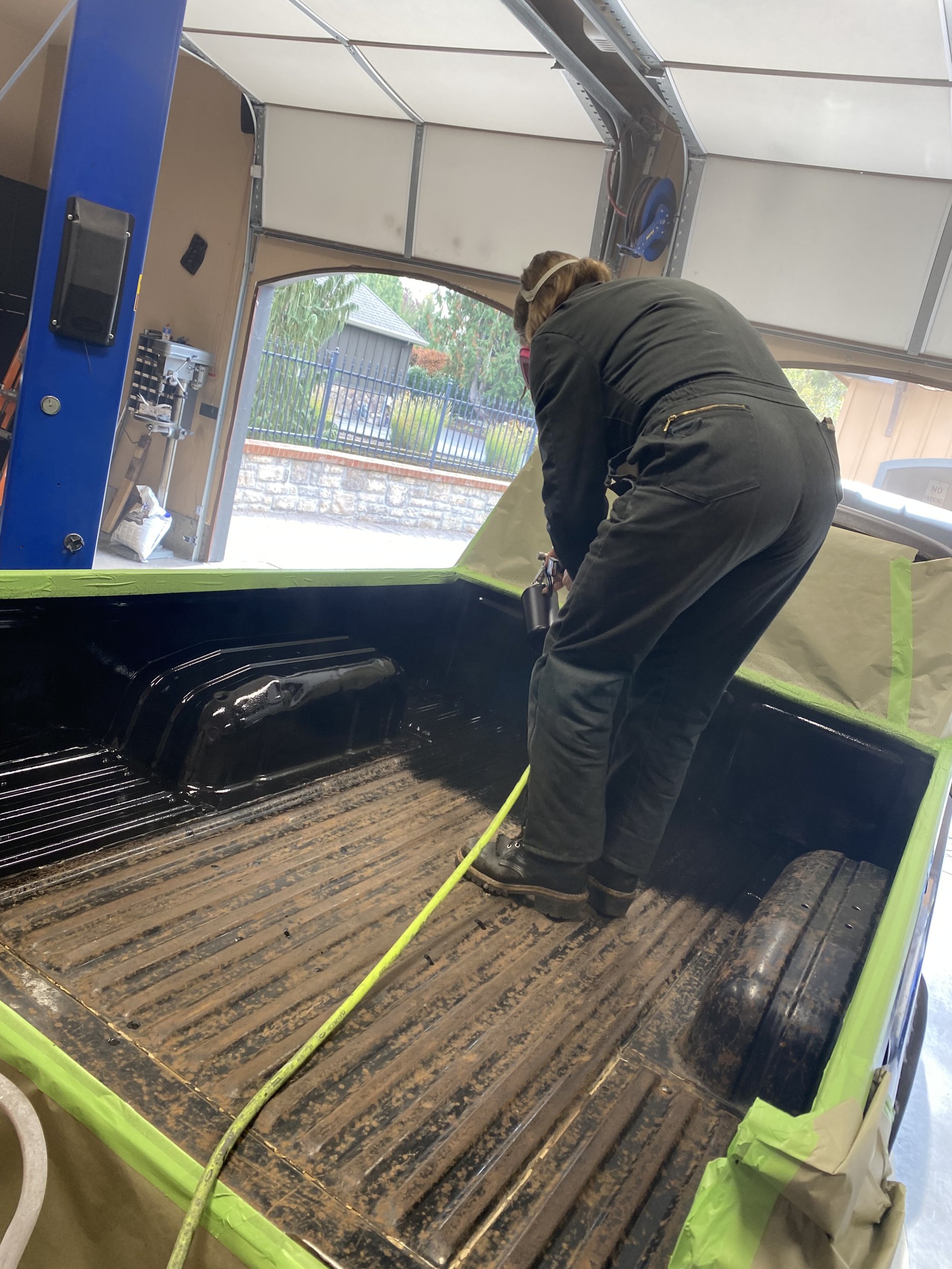

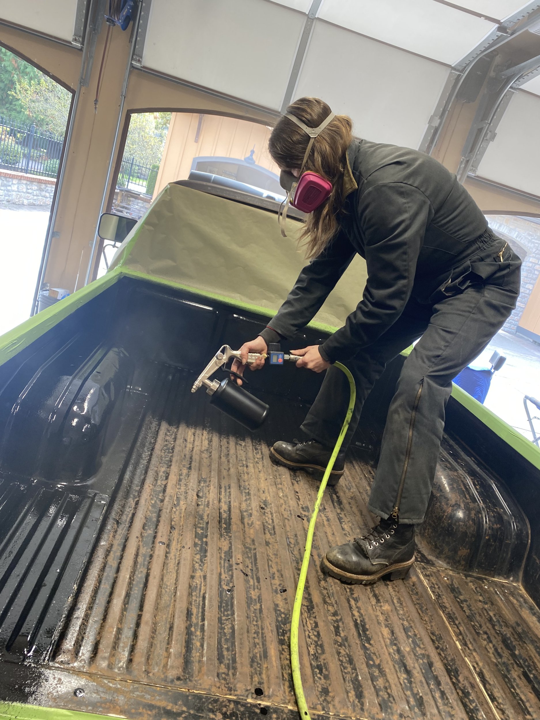

    Too old to be climbing in and out of a pick up bed but it needs a Por-15 bed liner? Make your daughter do it!

    looks as if she is doing great work

    I told her she will do the base coat when we paint it black next spring. Dad will handle the clear bit.

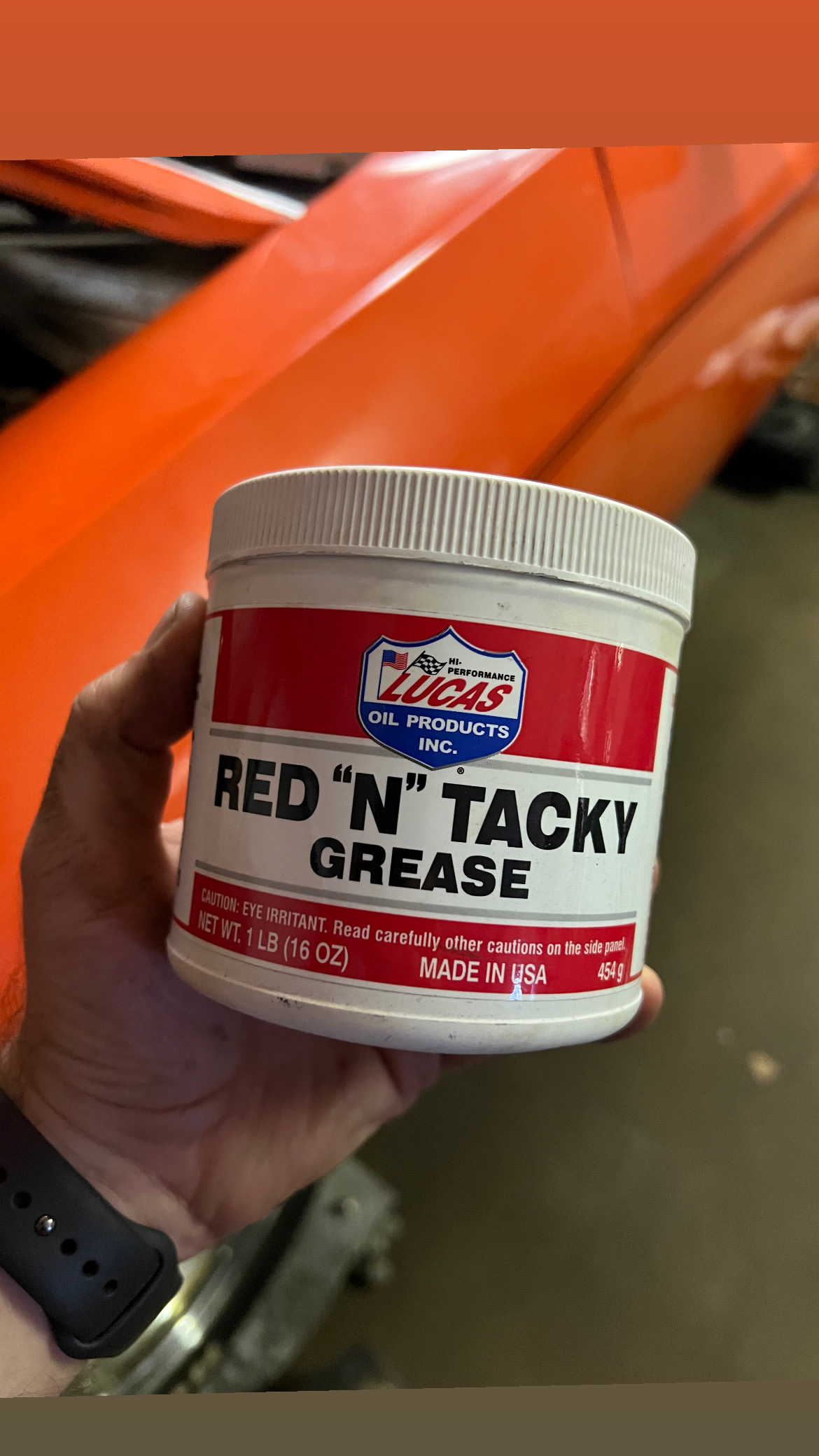

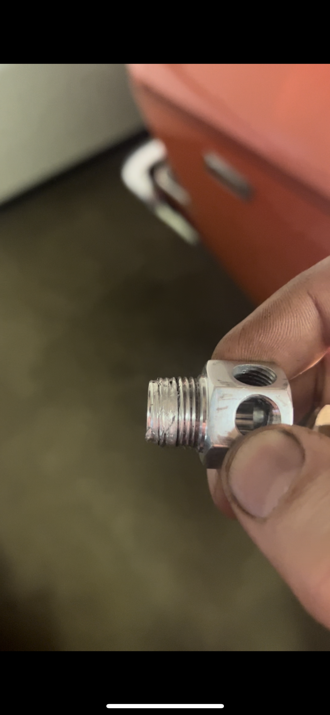

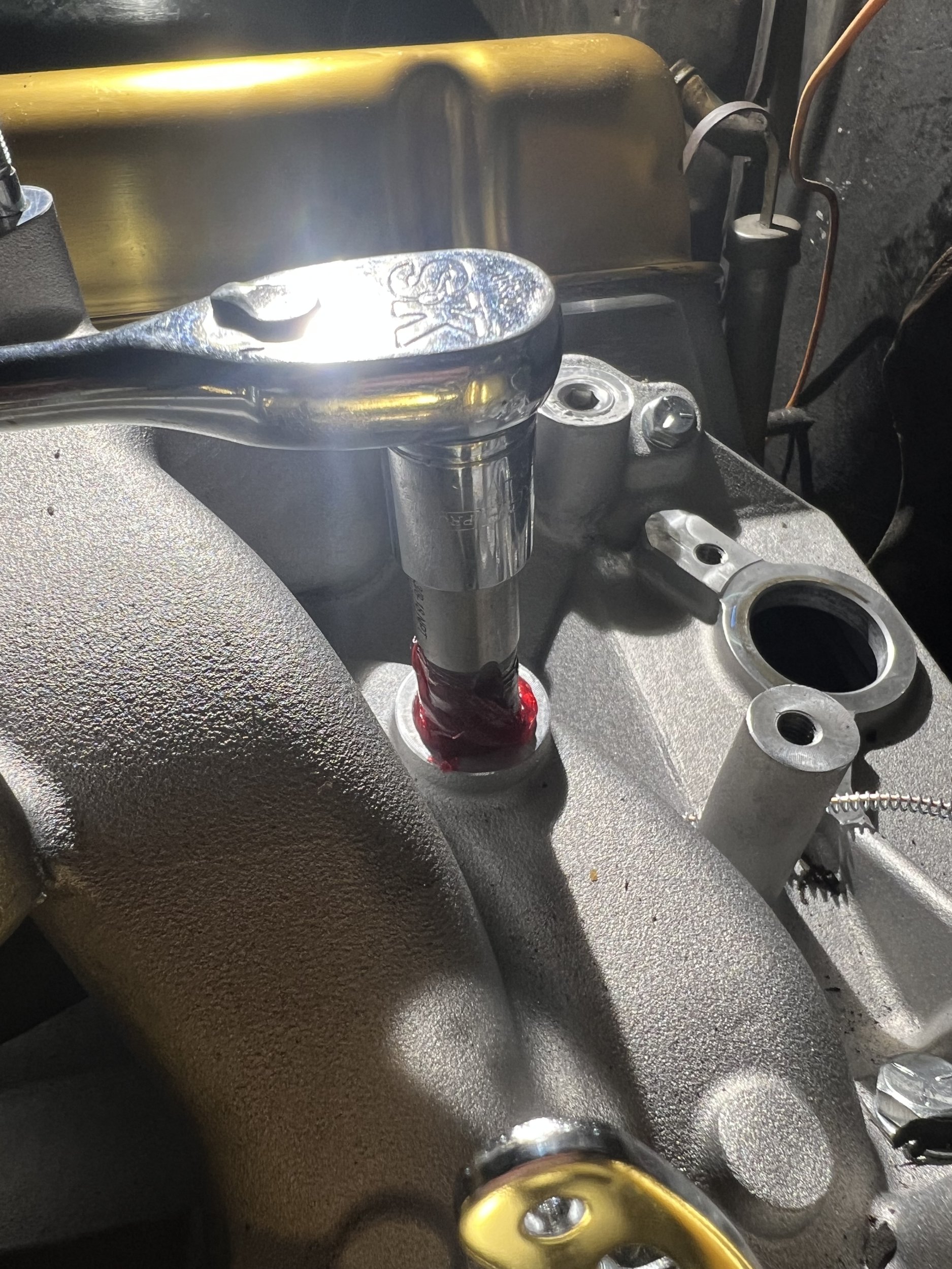

    I dont know if this is common knowledge, but i was surprised when some other people were surprised by it. A speedway vacuum port that was made of cheese, made a mess of some threads on a newly installed intake on an installed engine. I didnt want to have to pull the intake, so pipe tap, some real sticky grease and a 12point socket to hold the tap and non flexhead ratchet to make it a little rigid since my tap wrench that would fit a 3/8 npt tap wasnt going to fit in there. Coat the tap in grease, do a few turns, clean it off completely, coat it again, few more turns, and repeat. The chips get caught in the grease and nothing makes its way into the intake so i didnt have to remove it, regasket, reseal, etc. I've done it similar for spark plug holes, stuff at work, garage, and has saved alot of time and effort over the years. I used Lucas red n tacky because i already had it, but it works great for this scenario.
    *Sorry didnt realize how big the pictures were
