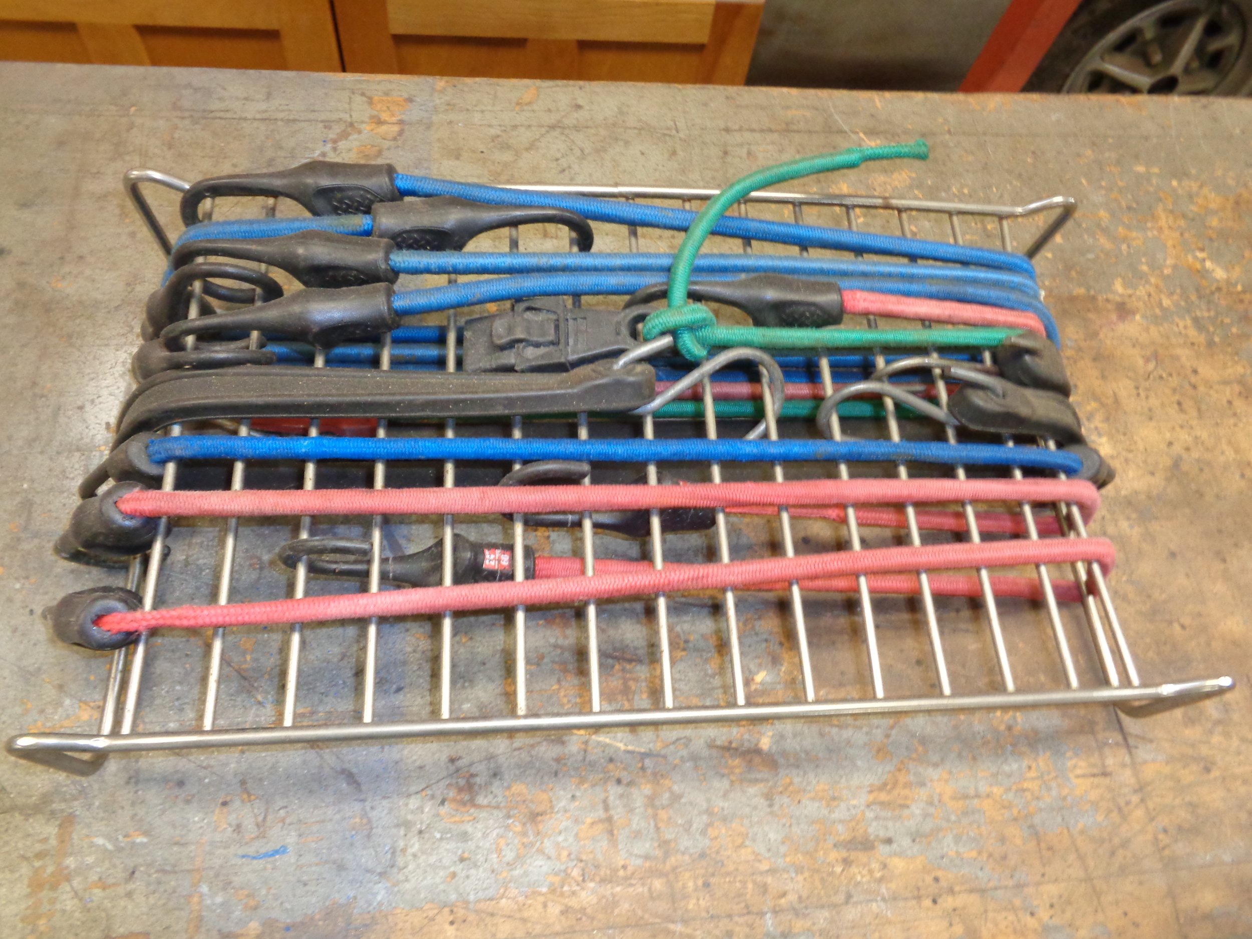

    Old piece of grill. Great for storing and transporting bungie cords.

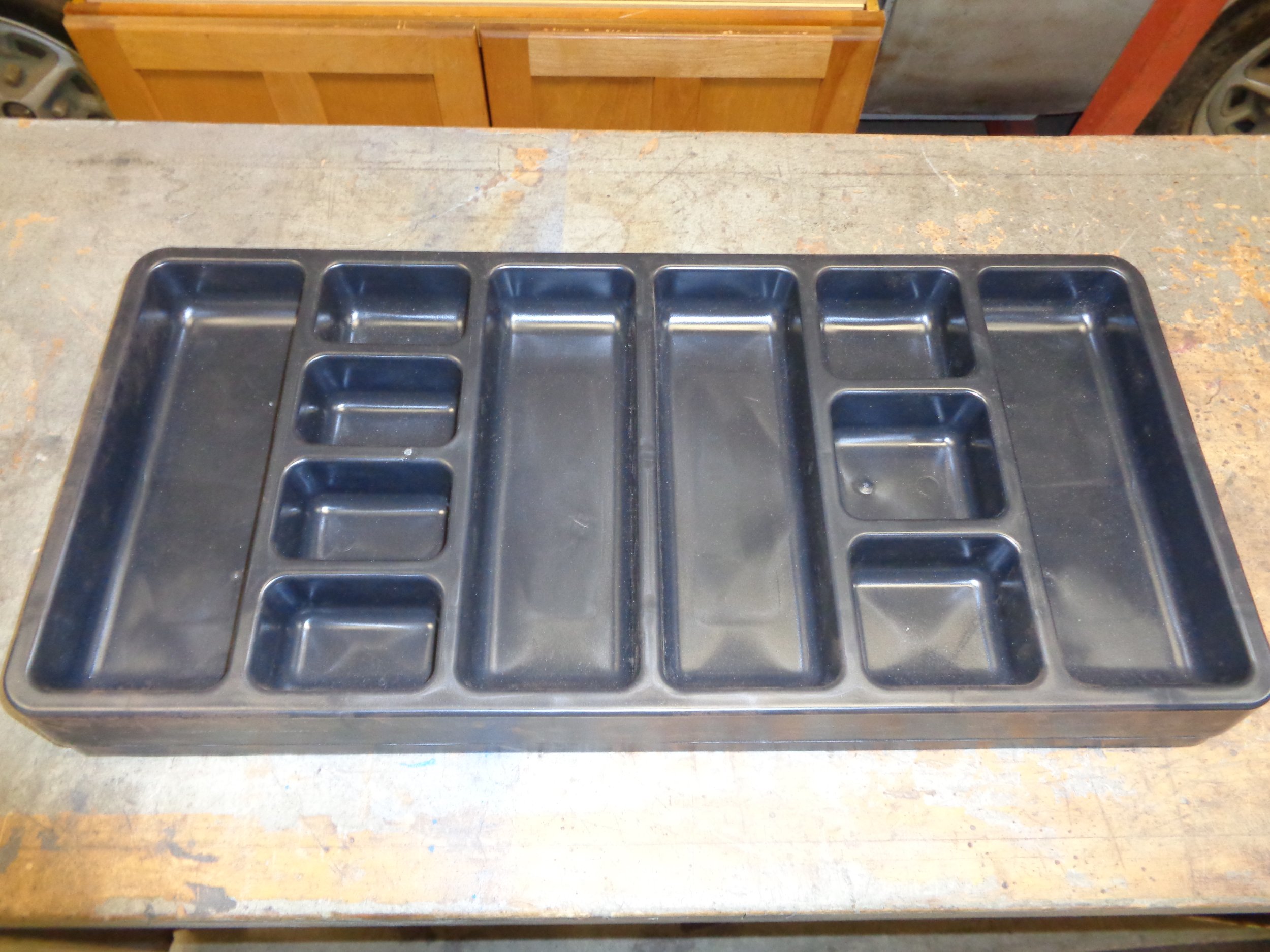

    Harbor Freight toolbox drawer organizers, $6.99. Use for parts organization on dis***embly. Got the idea from a traveling auto trans cl***.

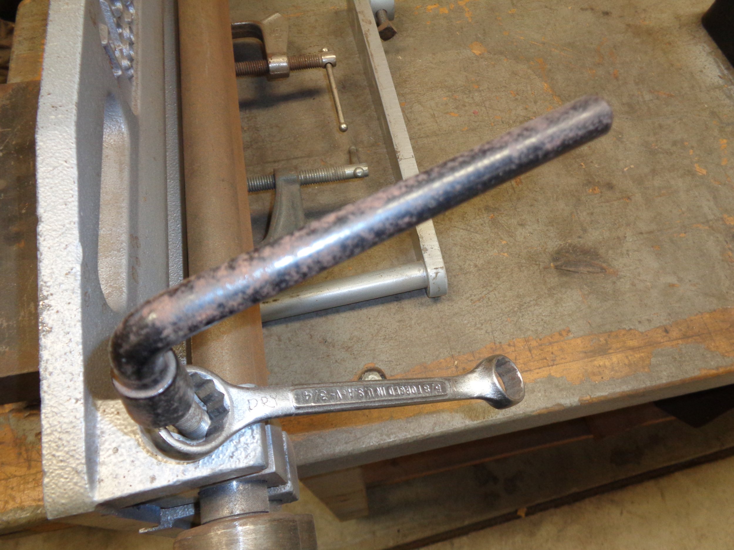

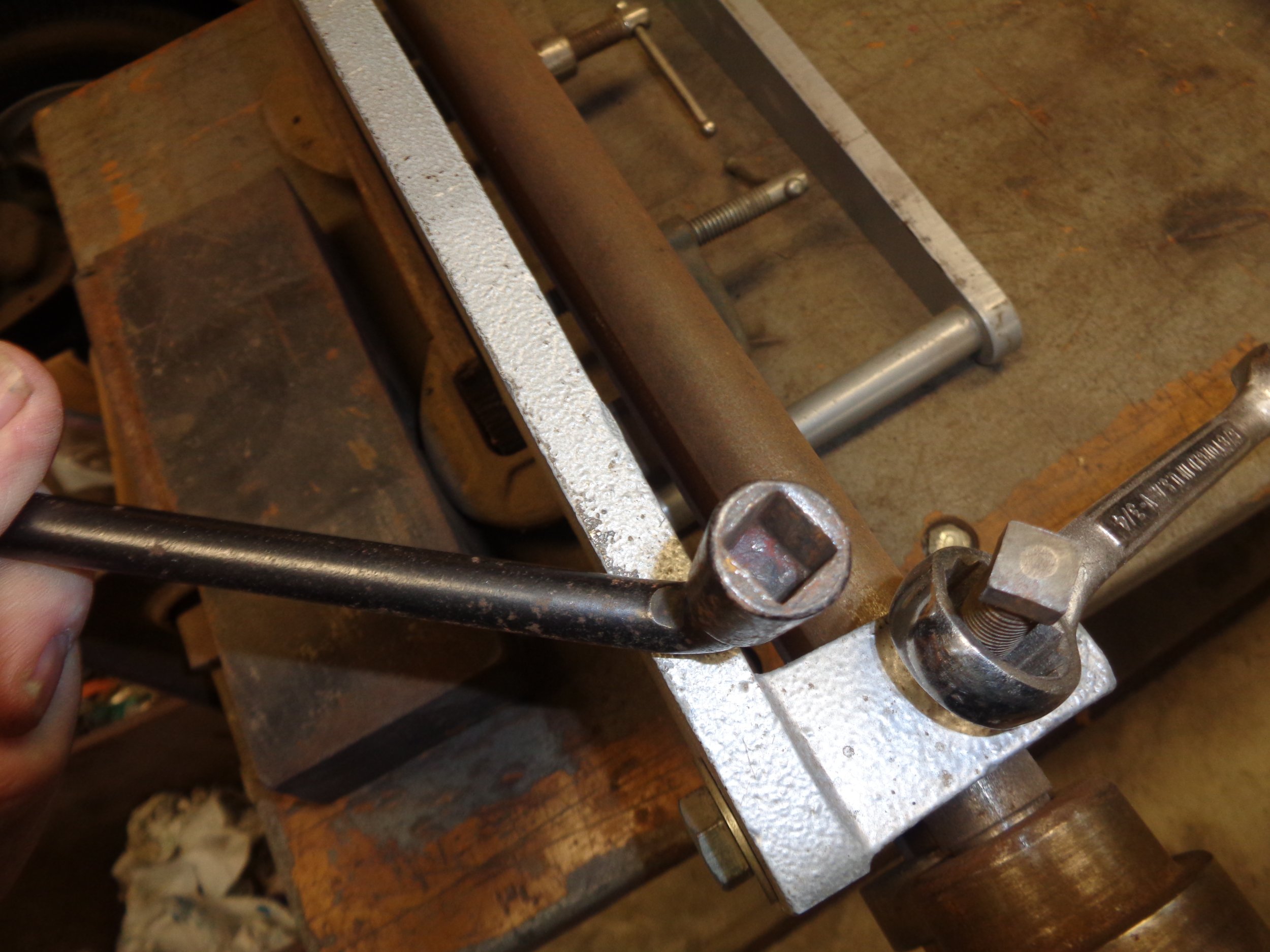

    3/8" square gas cylinder wrench from the welding store. Fits the bead roller.

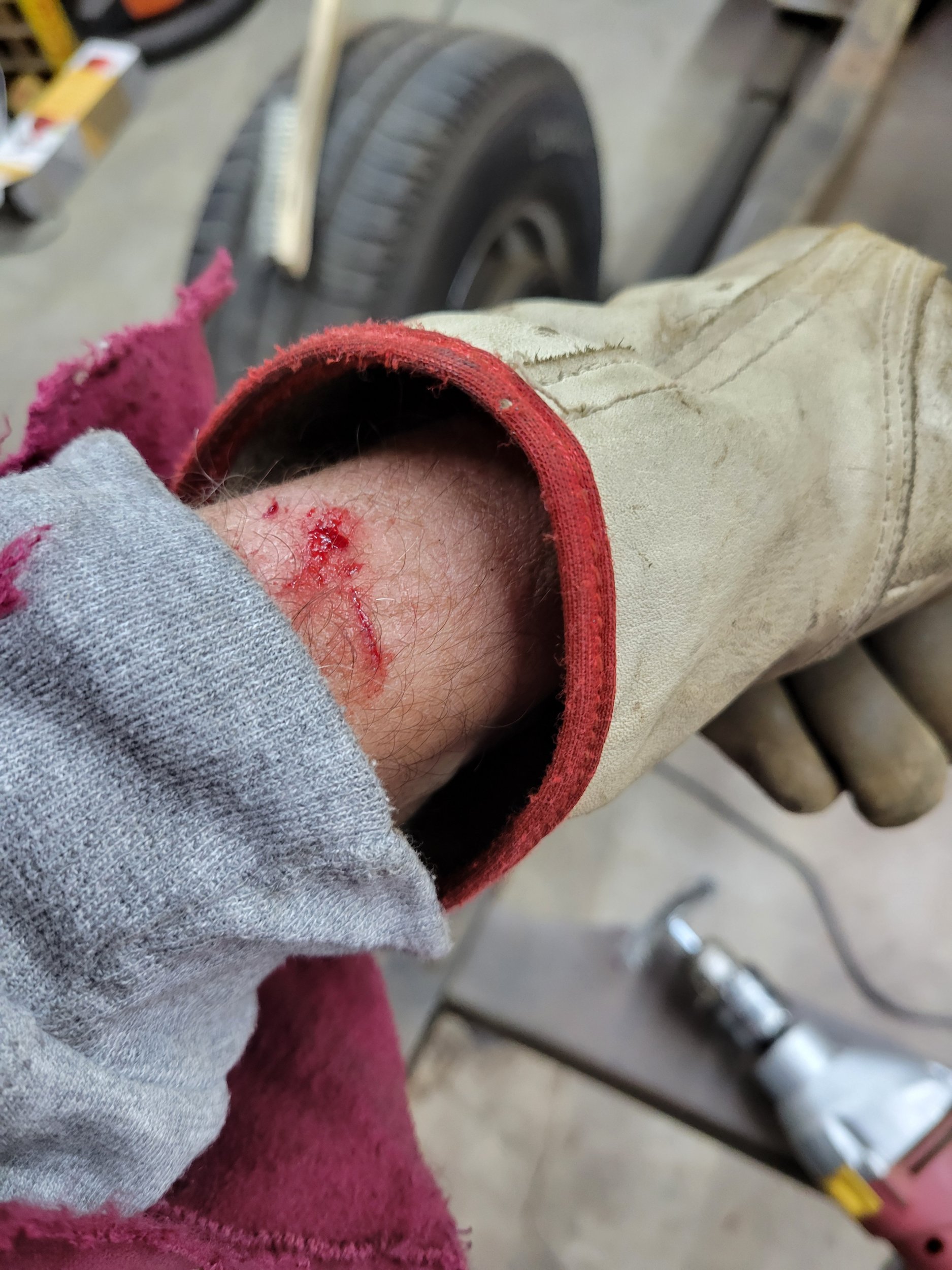

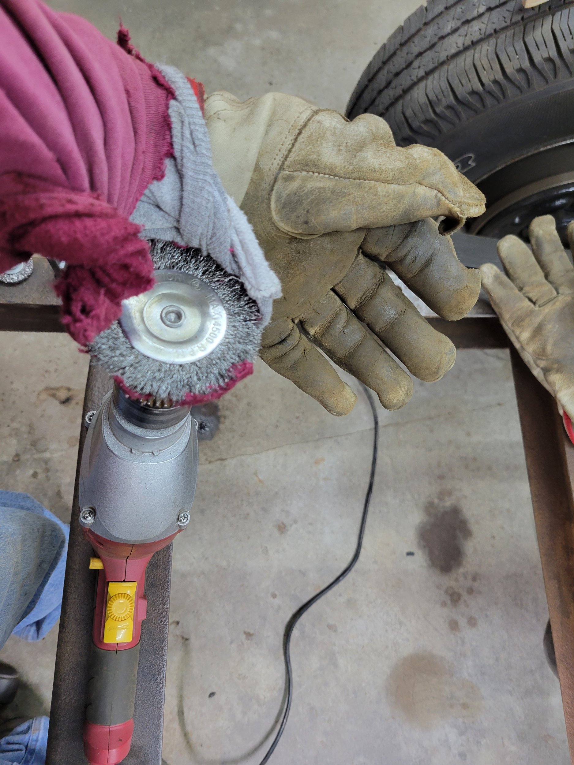

    My garage tip of the day is to make sure and feed your wire wheel a full diet of metal, ******* jumped up and bit me, must of been hungry.

    Wow hate to see this , glad that is all that happened . I was using a 9 in , Wildcat grinder years ago no guard , the wheel exploded . No damage to me , but my Buddy was , across the room , a piece of the wheel , stuck in his chest .

    Didn't take long to wind up and it wouldn't unwind when I put it in reverse lol

    I've got a "strawberry" on each leg from wire wheels on angle grinders. Both times I was wearing jeans and the jeans got torn without drawing blood from me. Also both times I was holding the workpiece with my left hand and the grinder in my right. Both times I told myself "don't do this." Both times my stupidity won out.

    One more thought to add to the wire wheel/grinder subject. After a 35 year career in welding on heavy equipment (earth movers), I have spent a large number of hours holding grinder handles.
    When using a grinding disc or wire wheel, only use the side of the disc or wheel that pulls the tool away from you. With clockwise rotation that would be the right side. If it's pulling away from you, you have complete control and it can't grab because you determine how much pressure is against the cutting surface of the disc.
    If you use the end of the disc it's pulling the tool to the left side. A handle on the right side will give you some amount of control if the disc grabs because the tool is pulling away from you. A handle on the left side (using the end of the disc) is almost useless because the tool pushes toward it and if it grabs at all, it sort of wraps into the material and the harder you push to keep it away from you the harder it grabs. This happens so fast that you lose control. Using the LEFT SIDE of the wheel will nearly always end in DISASTER.
    I have explained this to many apprentices over the years and almost every one of them was nodding their head and saying yep, while thinking to himself, "****, how damned smart do you have to be to operate a grinder, besides I'm big and tough I can hold on to it no matter what it does." If I watched them for just a minute or two they would almost invariably have the grinder try to jump out of their hands. Most of them would make a comment sometime later that maybe I knew a little bit about the subject.
    How OSHA let any company build grinders without a paddle switch is something I'll never figure out.
