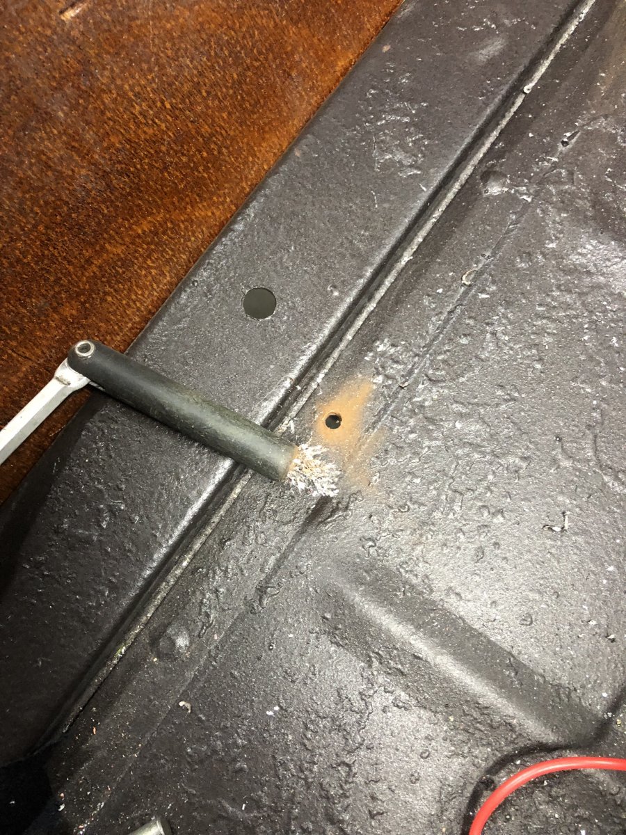

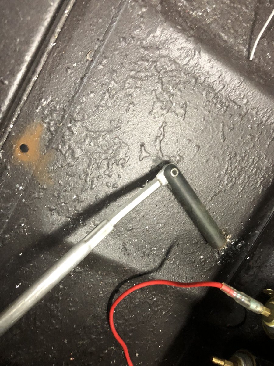

    When I'm drilling holes in panels inside the body I always have a telescopic stick magnet on the job,,I use it to pick up the metal swarf as I go,,,,saves if ending up in your knees if your kneeling in the car,and keeps it out of panel recesses etc,, IMG_6342.jpg

    Put a plastic bag over the magnet. When done picking up the metal shavings, just pull off the bag over a trash can and all the shavings fall in the can and the magnet is clean.

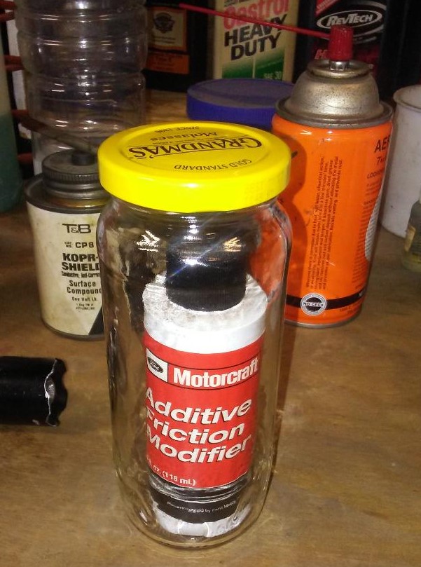

    Friction modifier has the most putrid smell of anything I can think of....well, almost anything;) It permeates right through the plastic container it comes in and will stink up anywhere and anything it's stored in. I keep mine inside a gl*** jar with a sealed lid....stank problem solved.
