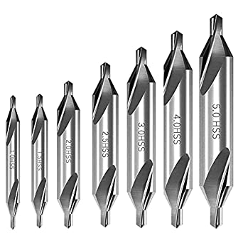

    While discussing drill presses; I've broken dozens of very small drill bits in my lifetime. Even with a good center punch on your workpiece it's easy to break a 1/8" or 1/16" bit. Since I started using center drill bits to start holes with I haven't broken a bit yet.

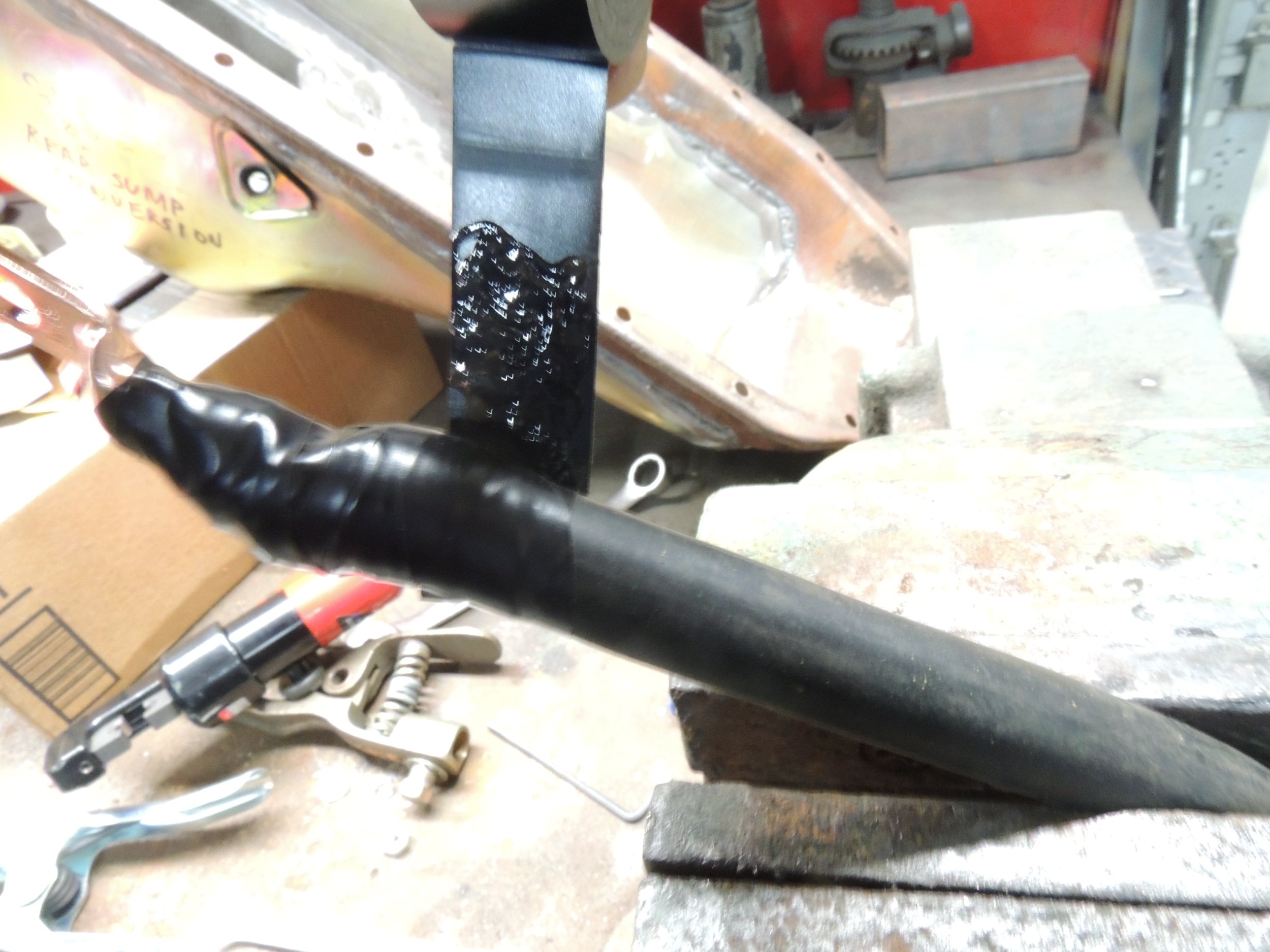

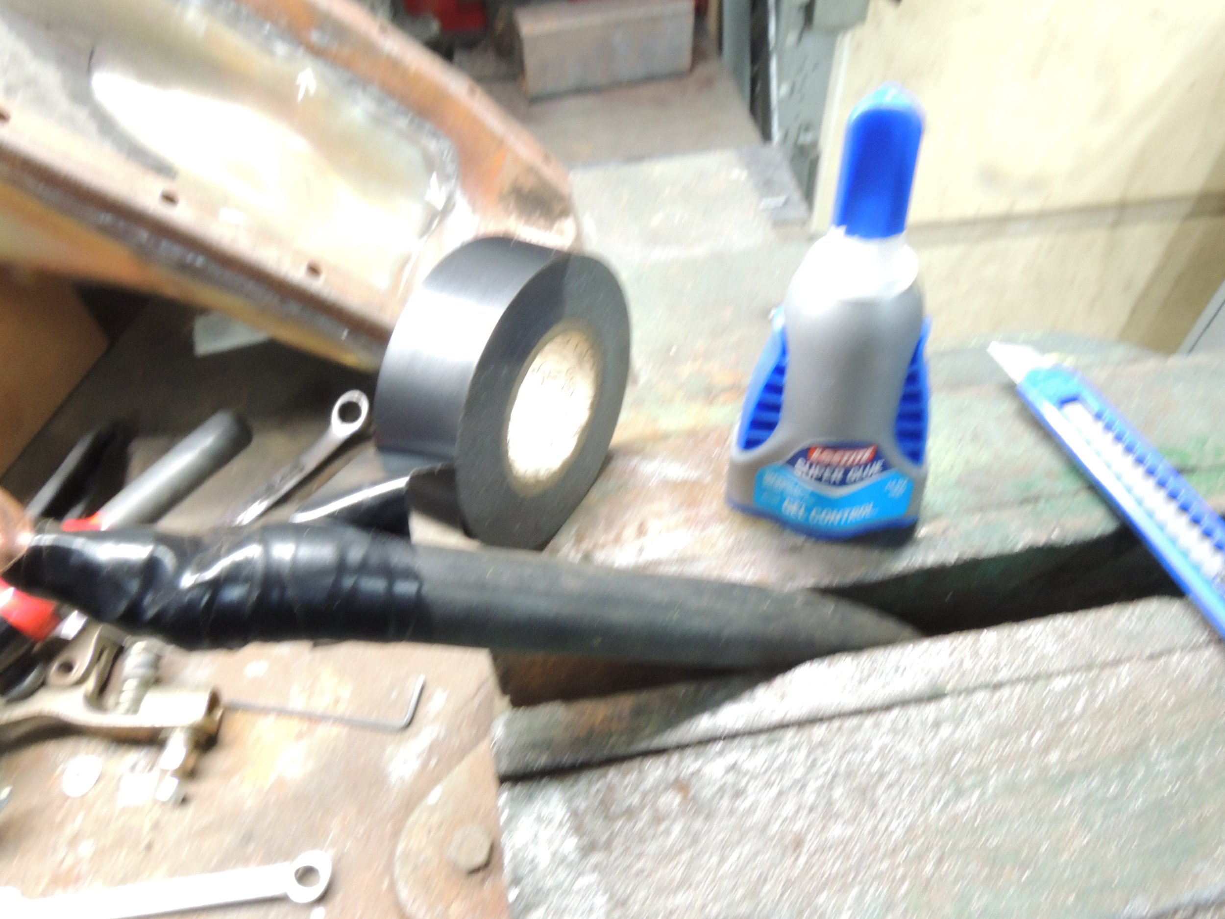

    Heres a little trick for using electrical tape. Seems as though half the time when wrapping the end of something with electrical tape, it wants to unravel or not stick that last little bit. Yep, not a problem with better tape, but I have a lifetime supply of the stuff that doesn't stick well. So I got out my Super Glue and put a little on that last inch or so while putting a new ground on my welder. Hopefully it will last a long time without the continual unwrapping flag on the end. Gluing Tape 1.JPG
    Now if I can just get my thumb and fore finger unstuck...............
