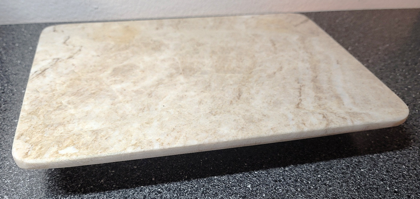

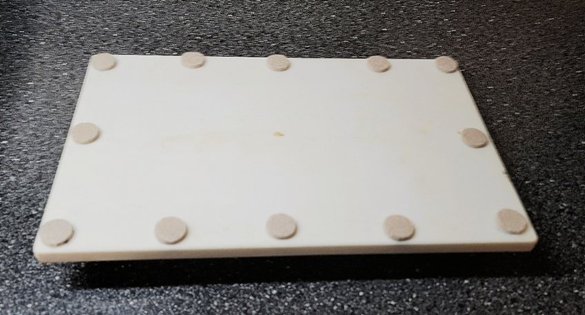

    upload_2025-1-3_3-5-25.png A long time garage counter top workspace protector...
    Hello,
    Before the Granite countertop explosion, we used a new surface material in 1985. Left over Corian countertop material cut and shaved to create a nice workspace for model building or modifications. Out in the garage, it was used as a sturdy base for all work, including drilling on a smooth, level surface.
    In the kitchen, the makeover was wide spread as a counter/bar on one end and the sink opening under the window and a short counter top on the far wall to the refrigerator. But, I noticed that the installers had some left over and I was able to secure it and make my small counter protector surface workspace.
    Today, it is still one of the first things I get out when I need to work on the new cabinet counter. It allows me to solder, drill, paint, cut using a jig saw, use a file and other uses, while protecting the actual counter top. A 40 year old kitchen counter surface remnant still in use. But, not for hammering...
    Jnaki

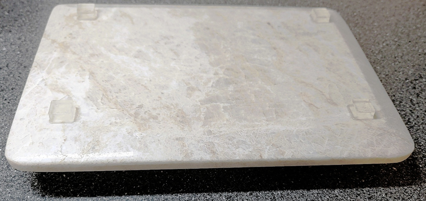

    After many years of getting a granite countertop in one of my wife’s kitchen remodels, that little piece was also used to act as a hot plate, a pipe cutting surface and a sturdy base when drilling materials. Now, that granite piece is out in the garden as a plant pot base. (No, no that kind of pot.)
    So, many years later, my wife was also into the latest remodel of the kitchen as she wanted it lighter and brighter. The new counter surface was a virtual non destructive natural counter top material similar to granite, as it is dug out from a mountain location. Quartzite is a sturdy mother nature’s “hard as rock” material that is dug out similar to the granite excavations.
    This time, the tile installation company specifically made us a rounded corner machined cut surfaces with a sturdy protector legs to use as a pot/counter protective plate. And for under heavy pots used on counters while the ingredients are transferred to other bowls/plates, etc. not that the new counter needs any protection, but as a gift, it was a nice thing.
    Rounded corners, thicker Quartzite material and sturdy protective feet makes for a sturdy countertop workspace/protector.
    Do not get Quartzite confused with Quartz, as that surface is man made and prone to lots of damage from kitchen mishaps and cracking/staining. So, why is it used in many kitchen remodels? It is less expensive and readily available in all sorts of patterns since it is man made in a factory. Not made in the ground by mother nature. There are so many choice of colors and patterns that makes that artificial surface popular.
    But, beware, one must take care of the heat from pots and pans on the surface, the hot coffee maker bottoms and anything resembling a product that gives off heat could damage the "Quartz" surface. Plus, it cracks and chips with ease from dropped tools, utensils and pots/pans.
    Note:

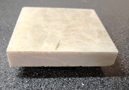

    upload_2025-1-3_3-11-41.png Here is a 6 x 6 inch sample given to us by a huge stone yard, near Disneyland, in a thicker Quartzite. With the sharp edges, it is dangerous. Now, if I want a smaller section for my current garage countertop work, I would have to smooth the corners and edges. It is so sharp, that I have to wear gloves, so as not to cut me when I handle the mini-slab of material. Currently, it sits in a drawer ready for any heavier duty action.
    It is 1 inch thick and heavy. It is in the preliminary stage for us. The sales guy was trying to sell us a thicker counter of Quartzite. The thicker version was more expensive and not needed. So, we still have the small 6 x 6 inch piece, which will be whittled away with rounded corners for another hot portable workspace for garage tools, later on... YRMV

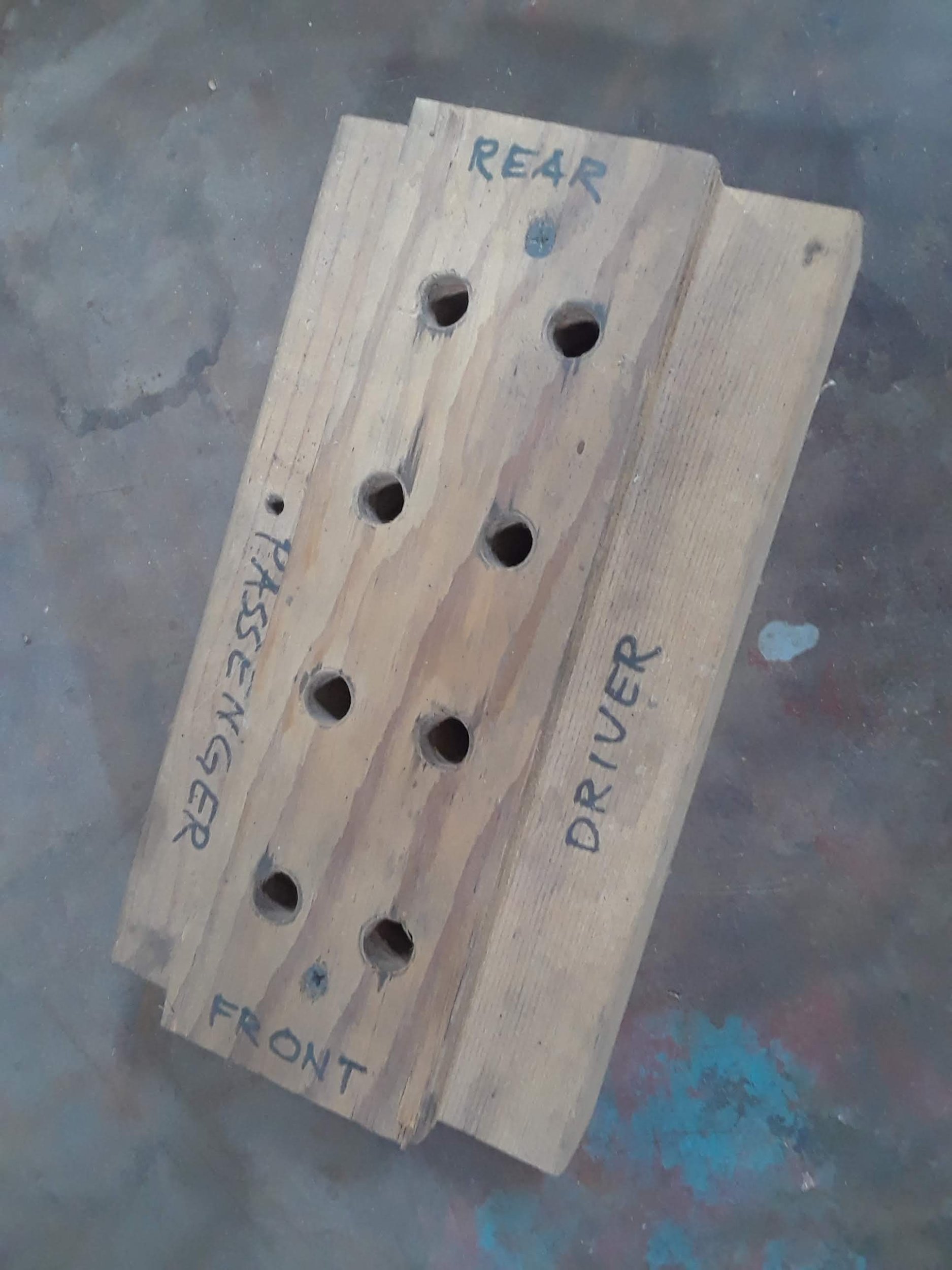

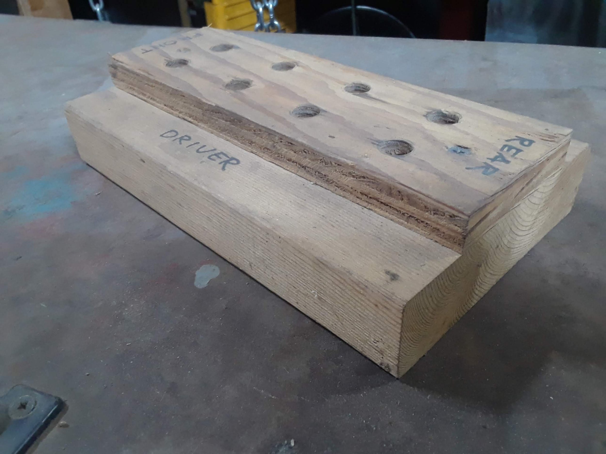

    I like the idea of writing on the actual plug. Here's what I use when removing plugs from an engine. I made this about 30 years ago. Sure is ugly but works well. That was back in the day when my handwriting was actually legible.

    I have something very similar. I use a piece of 2X4 or 2X6 depending. I do the same thing for lifters that I take out of an engine. I can write which cam went with the lifters on it and that way the lifters go back on the same lobe even if installed in a different engine. Drill the hole snug for the plugs or lifters and they won't easily fall out.
    alanp561, Sharpone and X-cpe like this.
  8. @snoc653 , me too. I have 2 for different diameter lifters. Snug fit keeps them in place.
    Sharpone likes this.

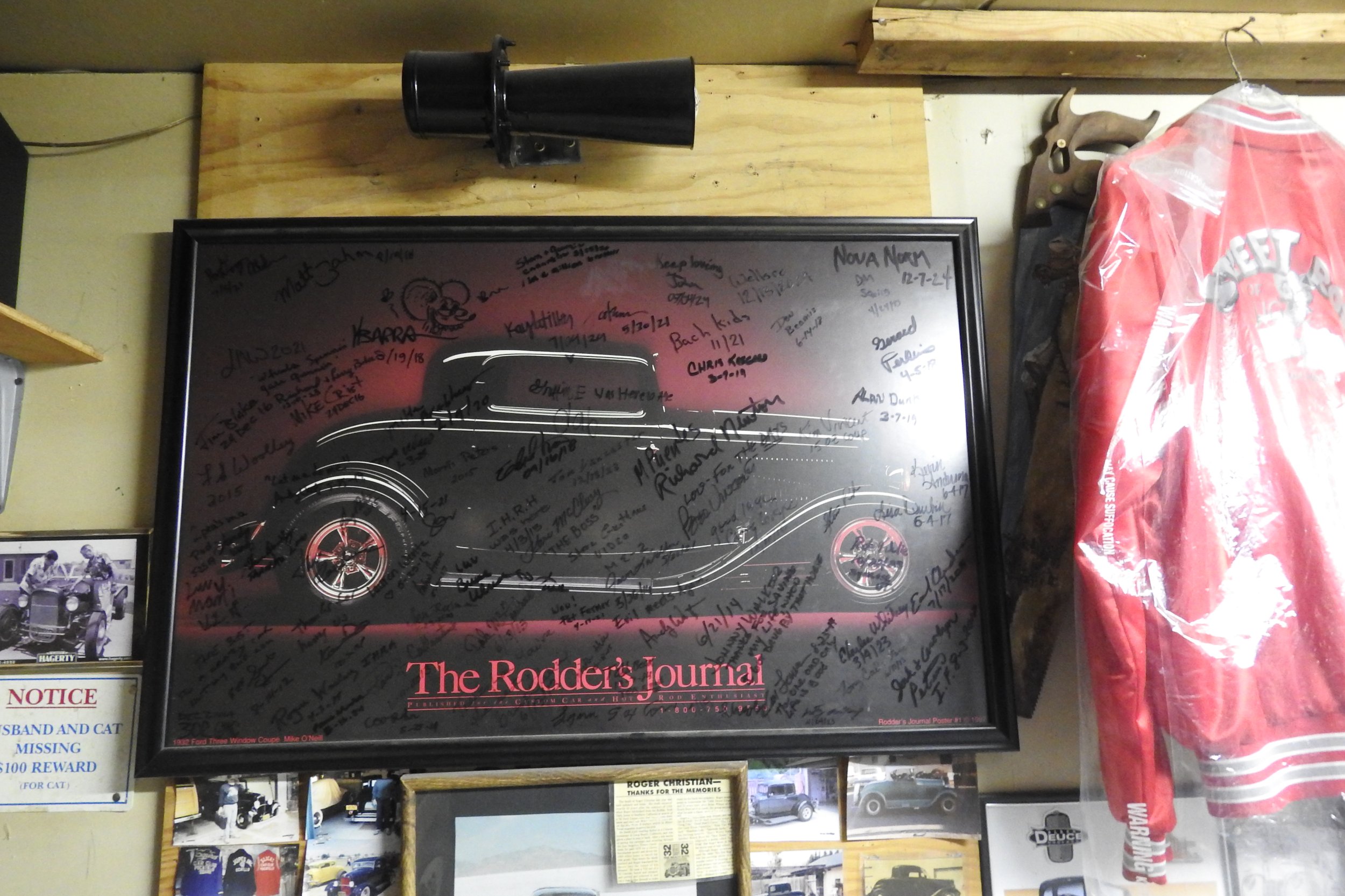

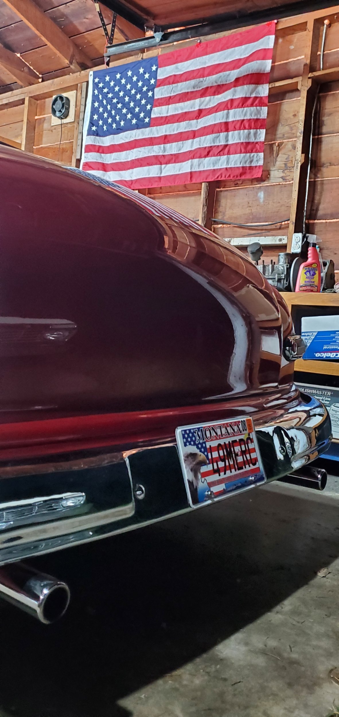

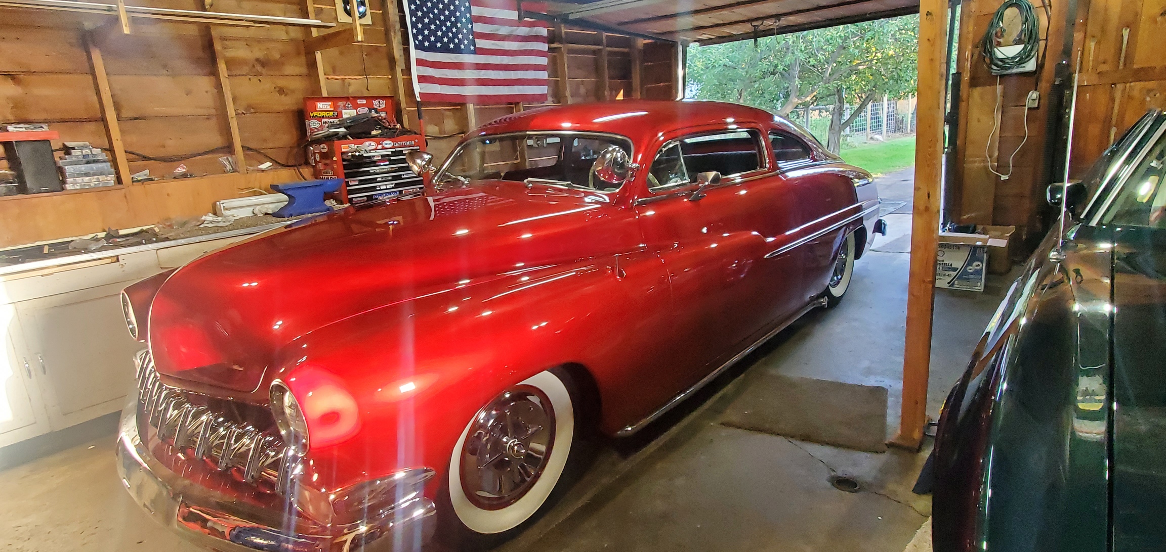

    Same here, and they're handy for a lot of things. Used them to hang Old Glory in the garage after I inquired to a Korean War Veteran how to properly go about it without disrespected the flag by doing it improperly...He told me to paint them matching red so they don't stick out first.

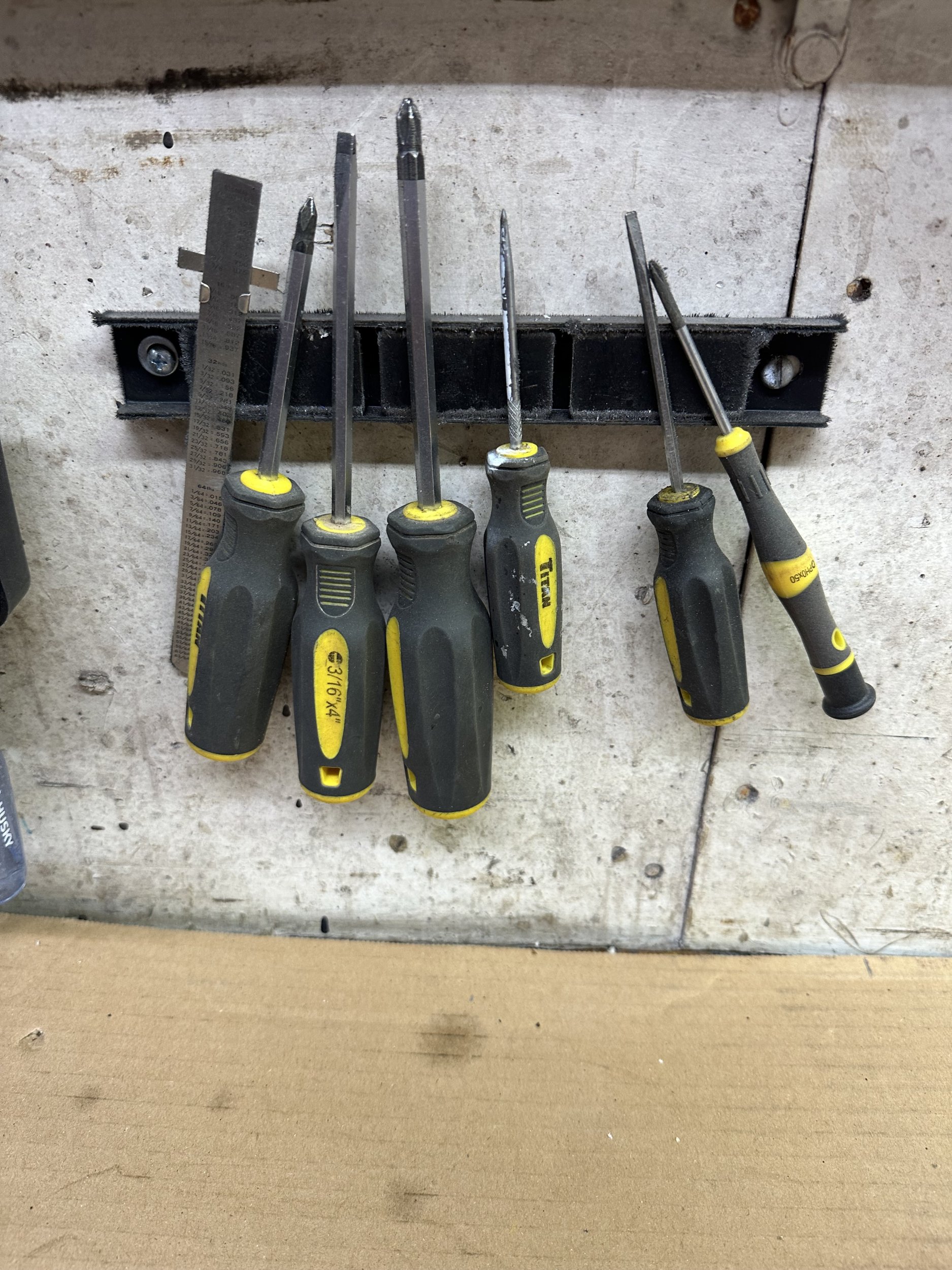

    I use one of those magnetic license plate holders that the dealers use for dealer plates, IMG_2952.jpeg for the screwdrivers that I use the most on my bench.

    Excellent. I highly recommend these for everyone on here. Counting all of them on various benches I have 7 of those 18" magnetic strips that HF sells. No matter what bench or tool you're using for a particular task you can keep many tools handy without cluttering up the bench top.

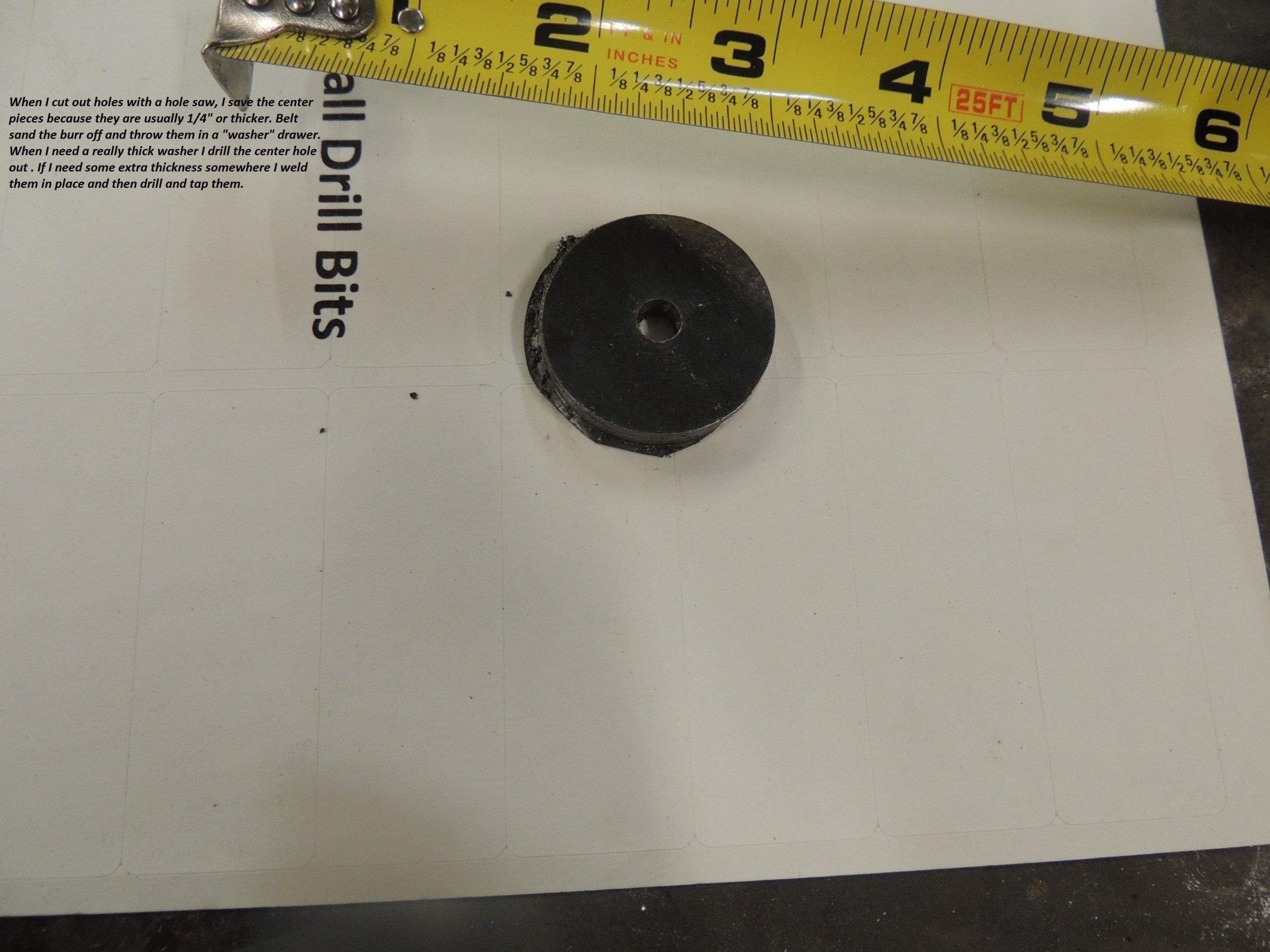

    Hole Saw washers............
    I found that when I use different hole saws on thicker metal, the cut out washer that results often come in handy when you want to back a plate or whatever so you can tap a hole. I weld them where I need them and tap them to size. Doesn't cost anything to throw them in the drawer with the other washers.
  28. ^^^^^^ Exactly. A couple of thick ones can be threaded for seat belt anchors, too, especially the ones cut from frame steel. Thin ones cut from engine-turned stainless steel will become bezels for my light and ignition switches.

    Thick, thin, large or small, I keep them all.
