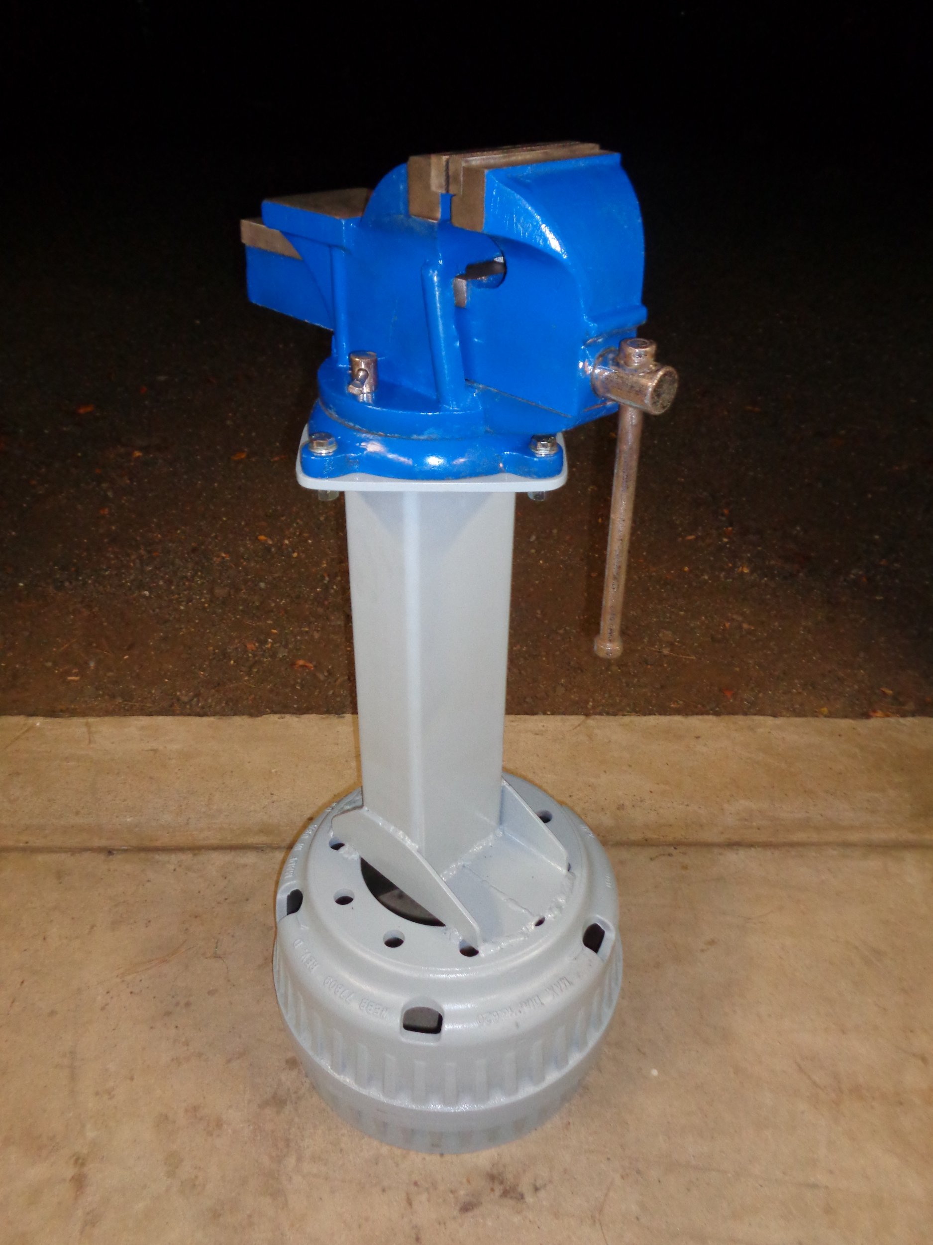

    My go anywhere vice. 110 lb. school bus drum and a 75 lb., 6" vice. Of course once I built the stand I had to clean and paint the vice. Found Bondo covering the genuine Chinesium under the old paint. Tip it and roll it to where you need it. Stays put once you place it. On dirt or gravel you need a couple of pieces OSB or plywood to keep it from digging in.

    do you know the old trick of putting a stub shaft steering wheel in the vise and 'drive it' around?

    I've never heard of that. Do you have a pic you can post? My vises are all permanently mounted on benches so will never need to do this, but my curiosity meter is pegged.

    Never heard of that. Not sure I would trust that much weight to the power of a vice clamping a steering shaft. I just run the vice all the way in and grab the vice. That way I have direct control when tipping and rolling it.

    That was meant as a joke guys.

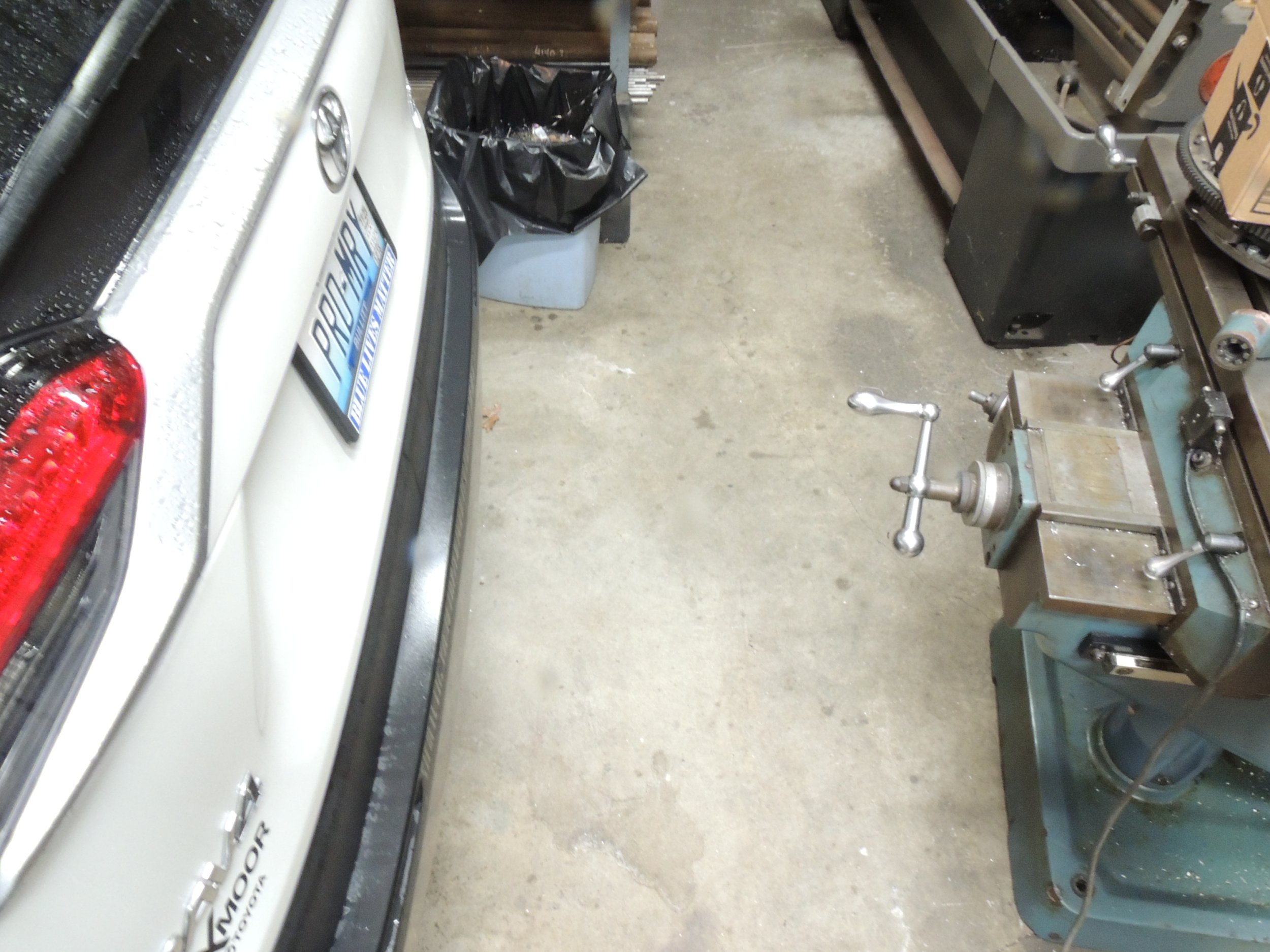

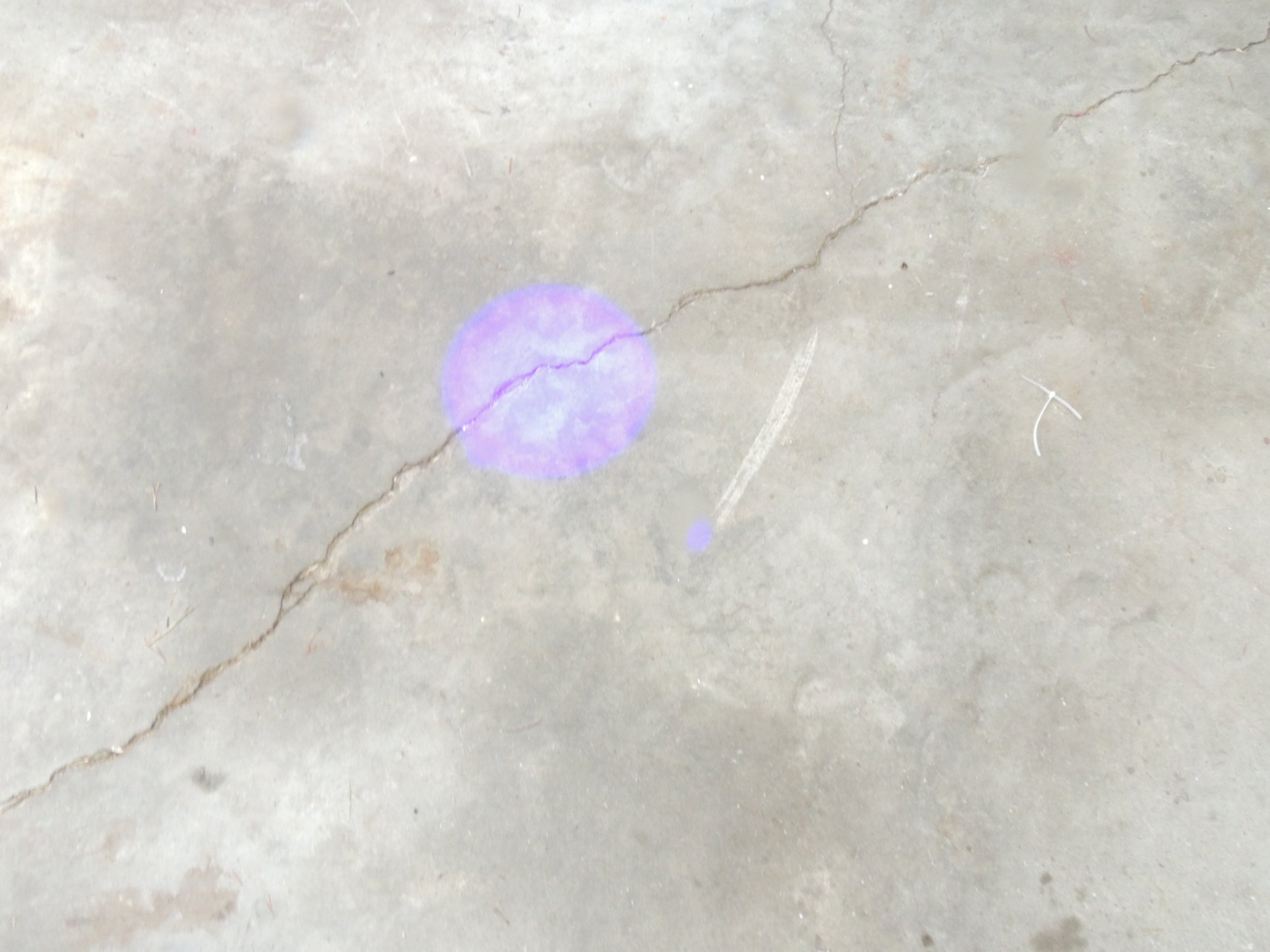

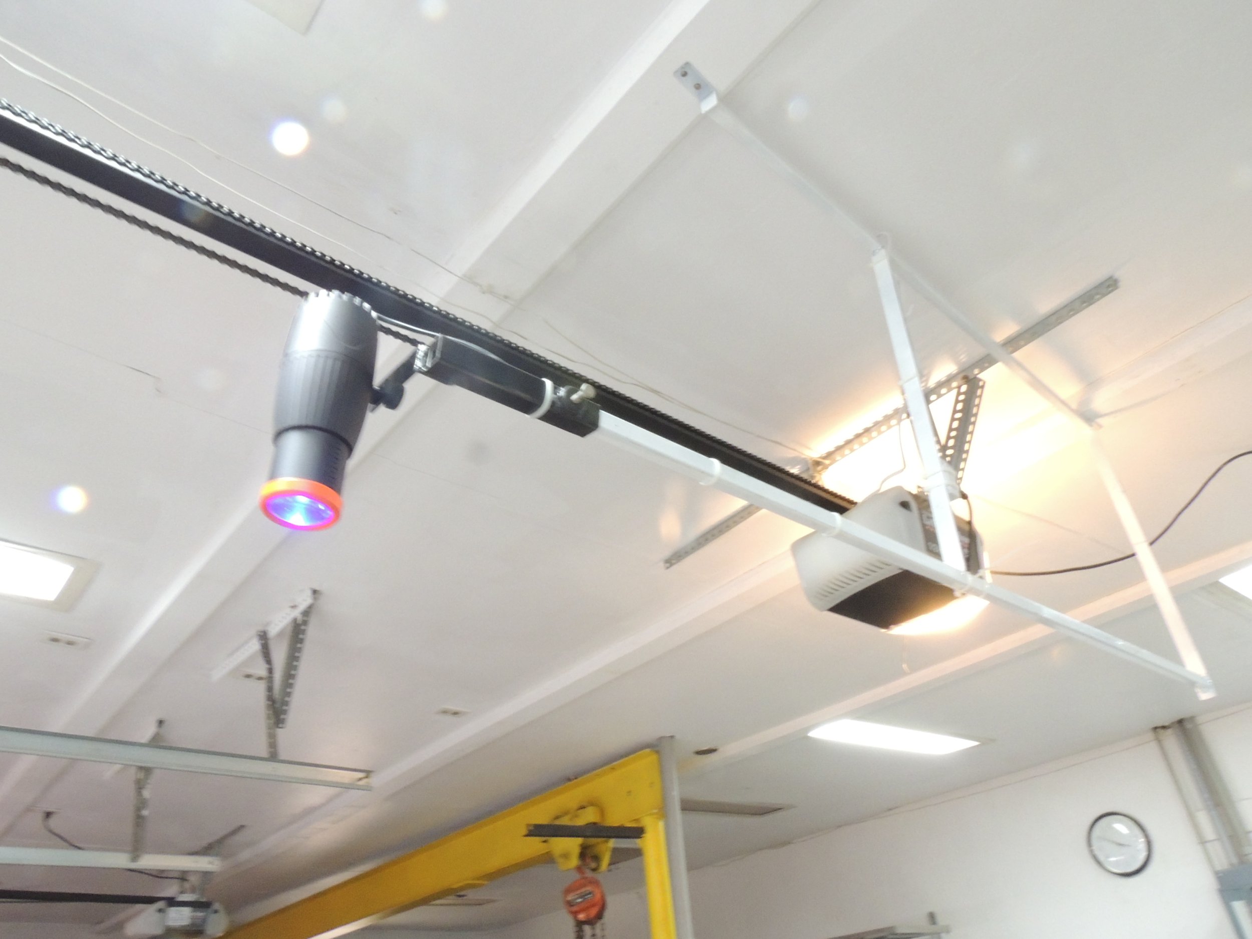

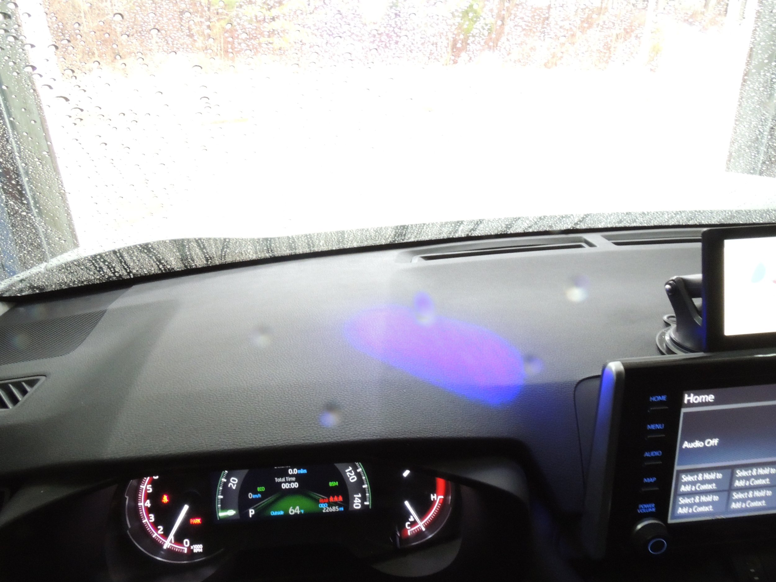

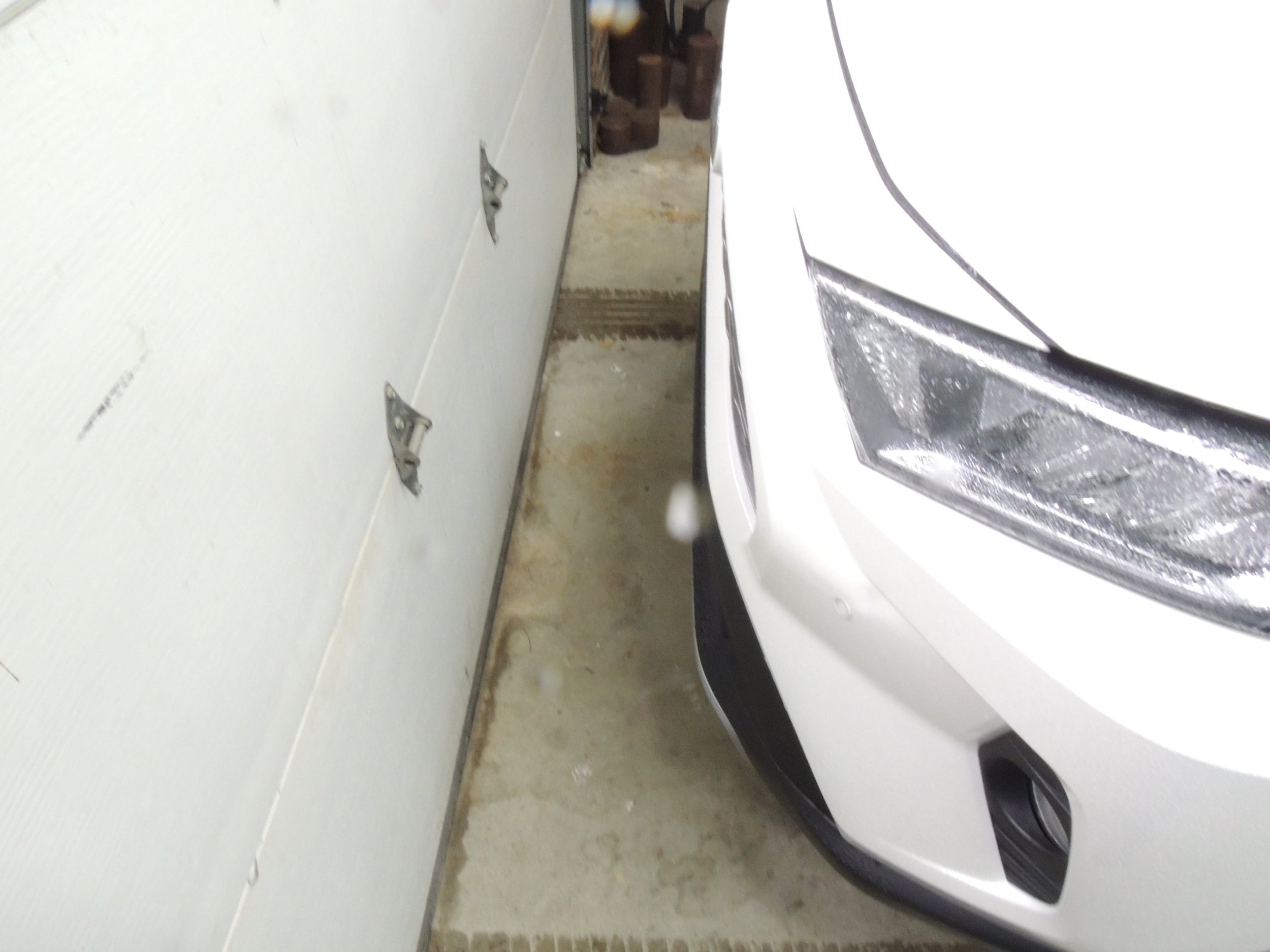

    The Blue Tennis Ball.................
    Years ago my mother got her drivers license rather late in life and was not a very good driver. I put a tennis ball in her garage that dangled from a rafter so that when she pulled into the garage she could keep going till her windshield bumped against it.
    Fast forward 40 years or so..........
    I have a milling machine in our attached garage and its near the rear wall right behind where my wife (and I) park her SUV. It's still in perfect shape and we want to keep it that way. The milling machine cuts down on the available space for parking the SUV. To compound the problem, we always back into parking spaces and that includes the garage.
    A tennis ball can't be used because the SUV has roof racks which could snare the ball ....so that didn't appear to be feasible.......plus I just didn't like the idea of doing that.
    So with a little thought and a little effort, I purchased a party light ($20) like the ones that shine on mirrored balls they have hanging from the ceiling in bars (so I'm told :D). Then I made a bracket to mount it below the open garage door but a couple feet above the SUV's roof. Plugged it into one of the garage door openers lightbulb plugs. Used the remote to turn it on and select a color............BLUE in my selection.
    Now when we back the SUV or any other car into the garage on that side, the garage door lift also turns the light on when I push the remote opener. The light shines straight down and as the vehicle backs in, the blue "tennis ball" appears thru the windshield and makes a ball shape on the dash.
    Perfect Parking every time. When the door opener light goes off, so does the blue tennis ball light.
    So if anyone is a little crowded for space when parking their expensive (or not) Hot Rod or Custom Car, this pretty well eliminates having to get out of the car and see if you got it right.
    Perfect Parking every :)time so far............

    o_OThat is absolutely BRILLIANT!

    @ekimneirbo that's a great idea. My dad set up a 4x4 for my mom and him to back into the dark hole garage. Just ease back into it. Too heavy to get bumped, blocked the wheels just right.

    I thought about a bar or angle on the floor, but was afraid I would trip over it when I was distracted by whatever I might be working on when the car wasn't there. I tripped over something last year while watering some new plants (in the dark) before going to bed. Spent the whole summer in misery going to the immediate care and then a chiropractor for a couple months, even bought one of those inversion machines, and an ***ortment of medications and vibrating and electric stimulation machine. (muscle stimulation guys...) Nothing helped sufficiently but after I tried the inversion machine things began to improve. I don't know if that helped, but nothing seemed to cure me before then. Thought I was going to have to get surgery or give up doing anything. Never had a back problem like that before.
    So, I try not to do anything that may cause me to stumble.....ever again! :)
