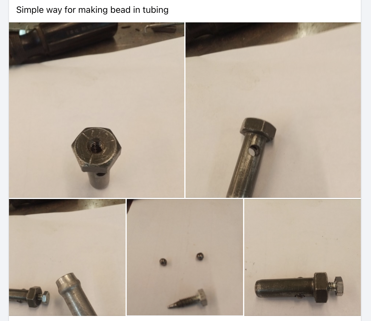

    Saw this on Facebook and had to share. Screenshot 2025-02-22 at 6.50.40 AM.png

  6. @BJR That would work great when trying to repair a line while still on vehicle. Which happens often enough here in rust area. Thanks for posting.

    Yeah, I had a trans cooler line that someone before me cut. It would pop off hoses. I had to use a flaring tool to deform the end enough to provide a bulge, but that is neato!
  9. @RodStRace , that's what I usually do, is start a double flare to get a bubble, and its' good. But, often when it's still in the car, you don't have room to get a flaring bar and tool in there. I like this, need to look for some small balls!

    This is a great tool , question what holds the ball from being lost in the tube ? Just be careful. It create a real issue unless I’m missing the good parts

    Would BB's work ?

  17. I'm thinking that they would have to be 1/2 the diameter of whatever bolt/mandrel you are using for the tubing. That way the 2 of them would recess back in to the hole, and only come out to form bead, when you screw in the top push bolt. The snugger the fit, the less likely they would have the clearance to slip out of tool.

    Amazon has balls. I just searched 1/16th ball bearing and got 166 results.
    Sharpone and Algoma56 like this.
  20. Just looked myself, there are even vendors that sell ***orted size packs, so one could make for all different size tubes.
    Sharpone likes this.

    The ball-bearing type flaring tools are available commercially:
    Proflow Tube Beading Tool For 1/2in. Tube PFEBEAD12 | eBay
    I tried one a few years back, and it came apart pretty quickly. Could be that the steel used for the bolts was soft, and wore around the forming balls. Mebbe flared 2 tubes before it would no longer retain the forming balls tight enough.
    I would love one of the Parker aviation beading tools, but they are as rare as rocking horse poo. I finally ponied up for a pair of Graham beading tools. Same design as the Parker, but only had to sell one kidney instead of two.
