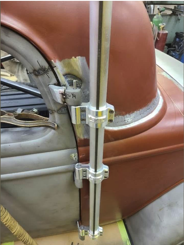

    From the web,,,,,

    Its a nicely made tool but I looked it up on their website and I think it was kinda expensive. I'm thinking a correct size round steel rod should slip thru all 3 hinges when they are in alignment. If some one wants an actual tool, put the round rod next to a pipe and lay some flat metal spacers between the rod and the pipe. Weld them slowly to prevent warping and after it cools, cut the rod and remove the extra metal. Check the price before you decide. :)
