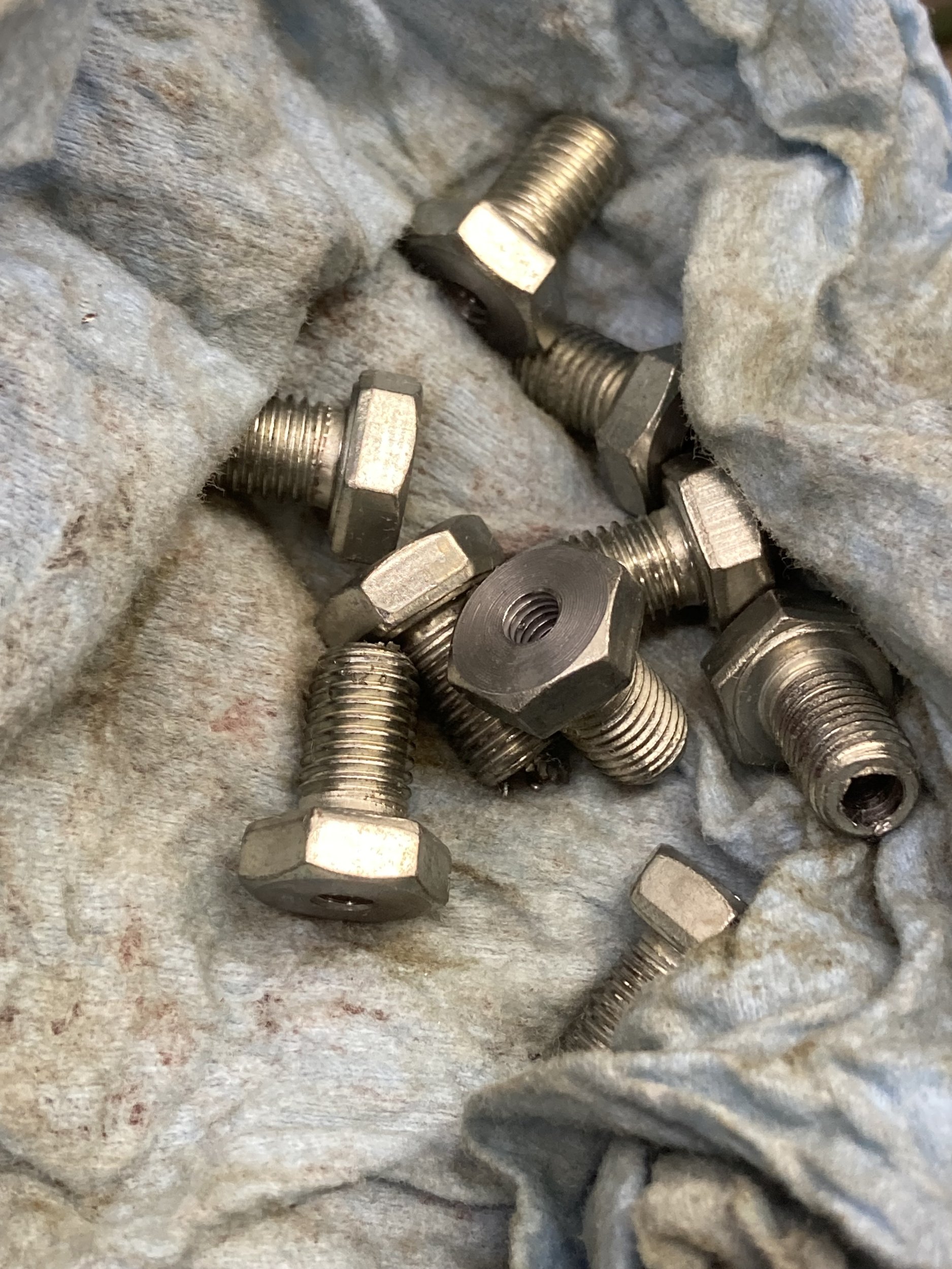

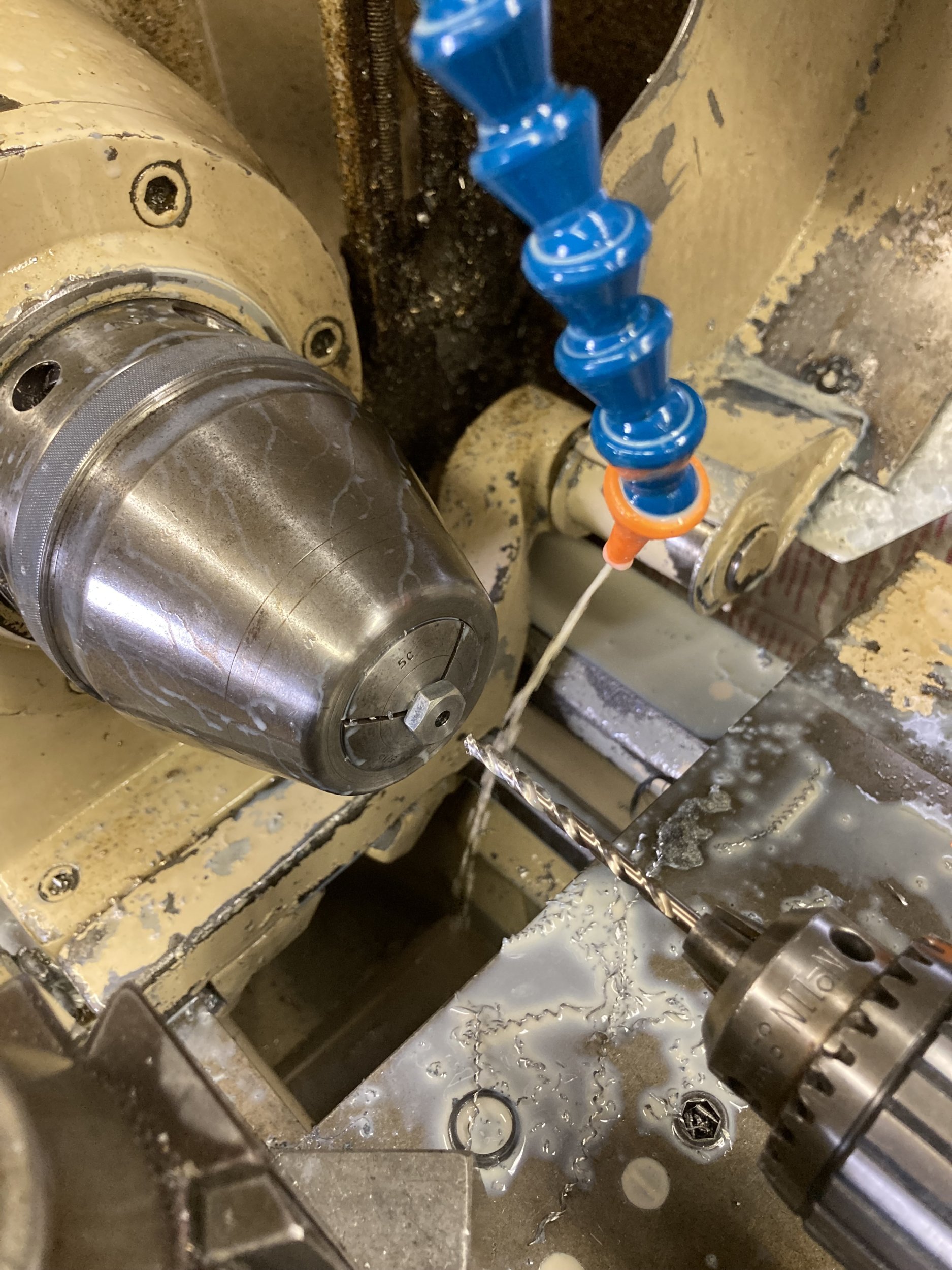

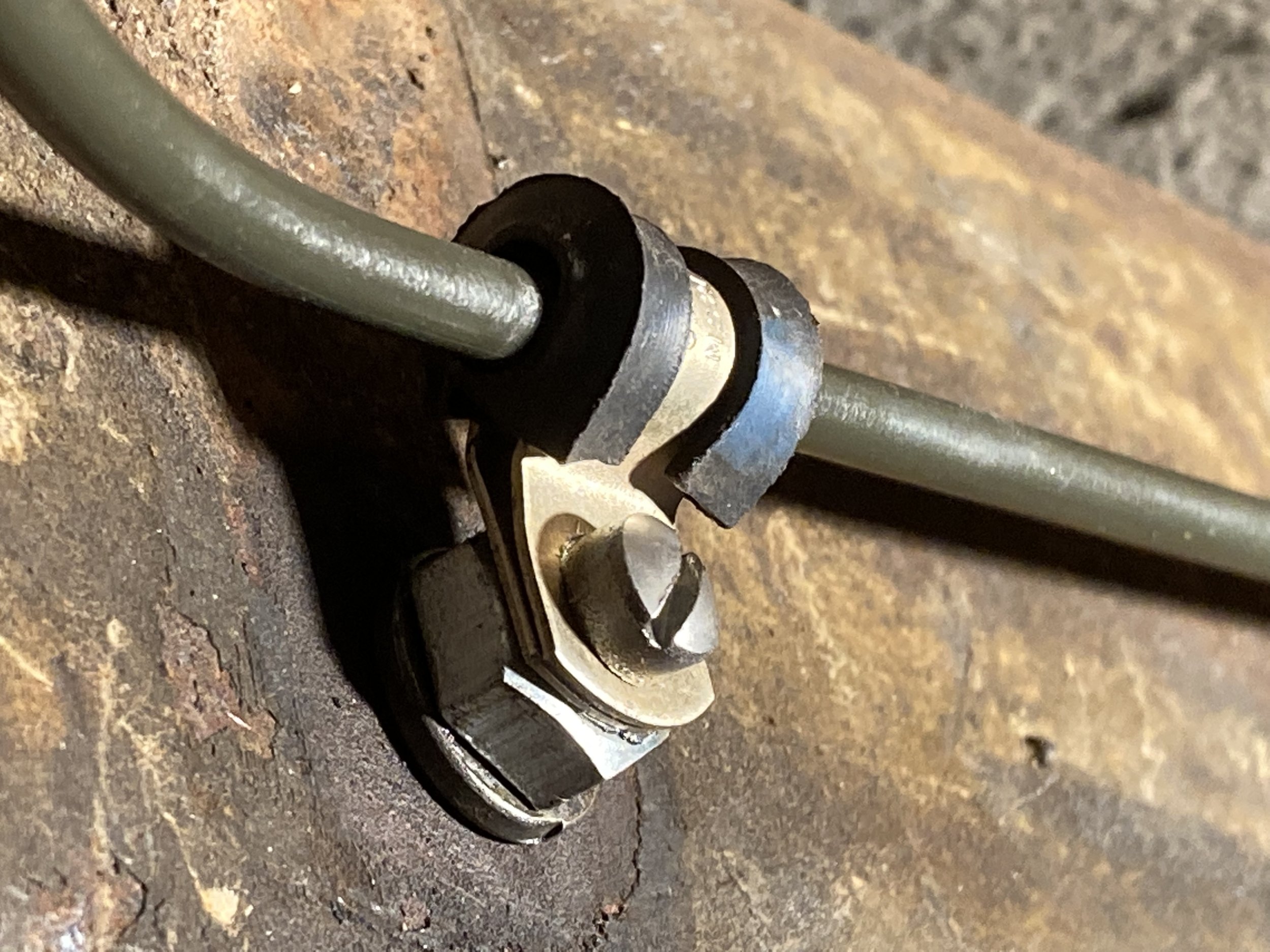

    I shared this little tidbit in another thread and it was well received so I’ll post it again here. Was running new brake & fuel lines on my 59 Rancho and was looking for a way to secure the line, away from the frame, as to prevent chafing. Here’s what I came up with;
    The frame already has a bunch of random holes in it from the factory. I utilize as many of those holes as I found along the route where the lines were run. I only had to drill two or three new holes for the whole job. Simply thread the hole for whatever bolt will fit. I grabbed a handful of short fine thread bolts and ran them on the lathe. Simply machine the head flat, then drill & tap for a size small enough not to compromise the bolt and big enough to grab the adel clamp. I used 5/16” bolts and 10/32 screws. Works like a charm.

    That's pretty dadgummed (credit 3wLarry) cool.

    Great idea! I’ll plaigerize it, but with a twist. Socket head cap screws.

    Yes please do! I went with the Fillister head for a more traditional appeal

    I understand what you were thinking but it seems to be a lot of extra monkey work. When we built my cpe I just used Adel clamps alone screwed to the frame. Been on the road since 97 and 100K+ mi without any problems

    I guess part of my motivation for doing this is to use as many existing holes as possible to avoid drilling new ones. That’s just me. I’m wired that way.
    With that being said, the existing holes are too big to accommodate a screw that would typically be used to hold an adel clamp.
