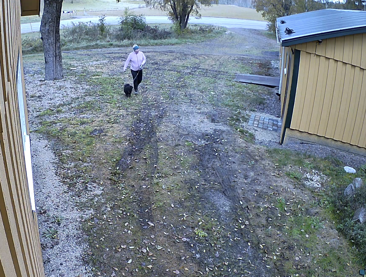

    ^^^^^ Installed 3 of these,,,,,^^^^^
    So now my phone tells me when something is getting close to my doors.

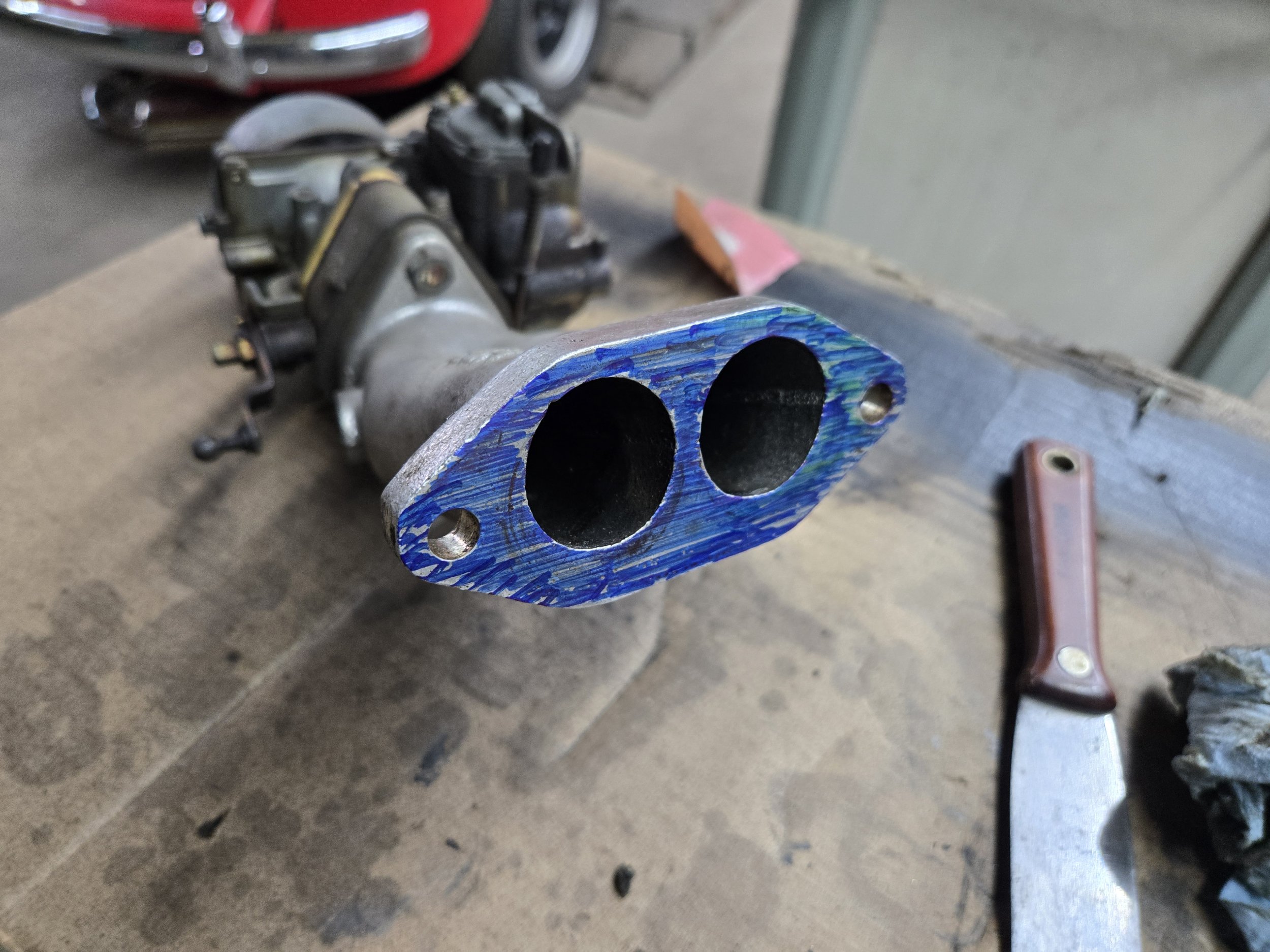

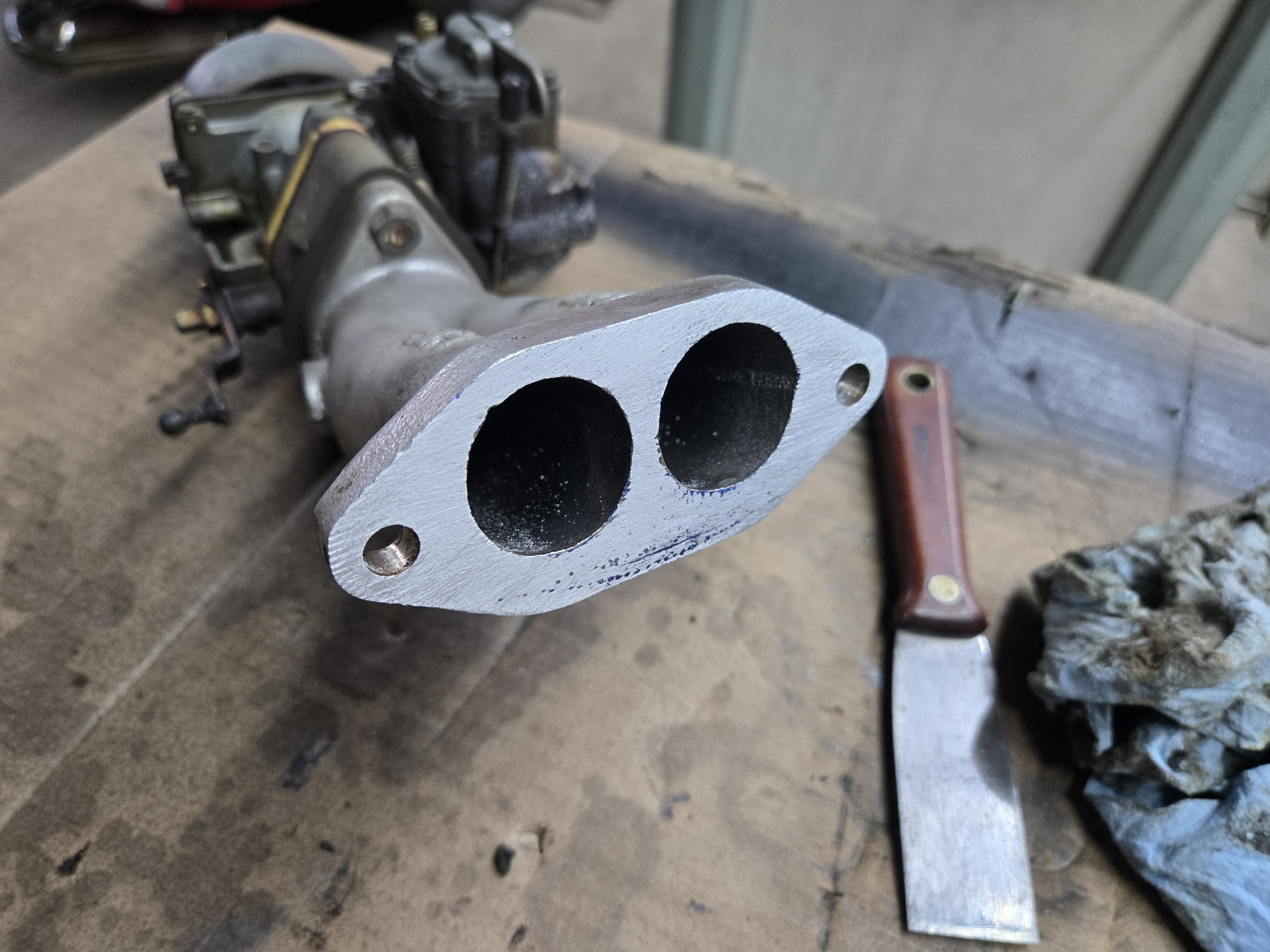

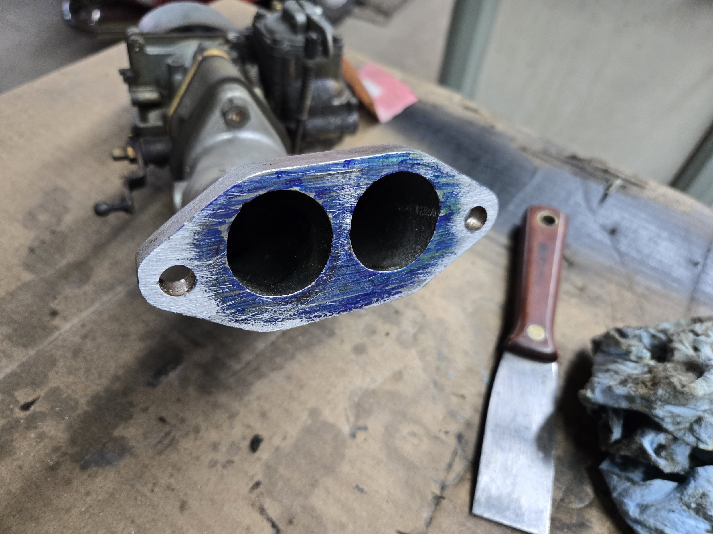

    Sure this has been posted..
    Just putting an OT together an was reading the lack of sealing..
    This applies to basically anything with mounting, Mostly two holes, But once You know, You'll figure out how/where to use..
    Some people never think of it.
    Just think thermostat housing leaks..
    I already knew this as cast piece was Wack, I sharpied it for demo..
    First shot was almost a dozen p***es with a good sized file, kept going till close enough for the girl's I hang out with..
    Took a piece of 150 board paper an dressed the file marks out, 100% Sealing surface.
