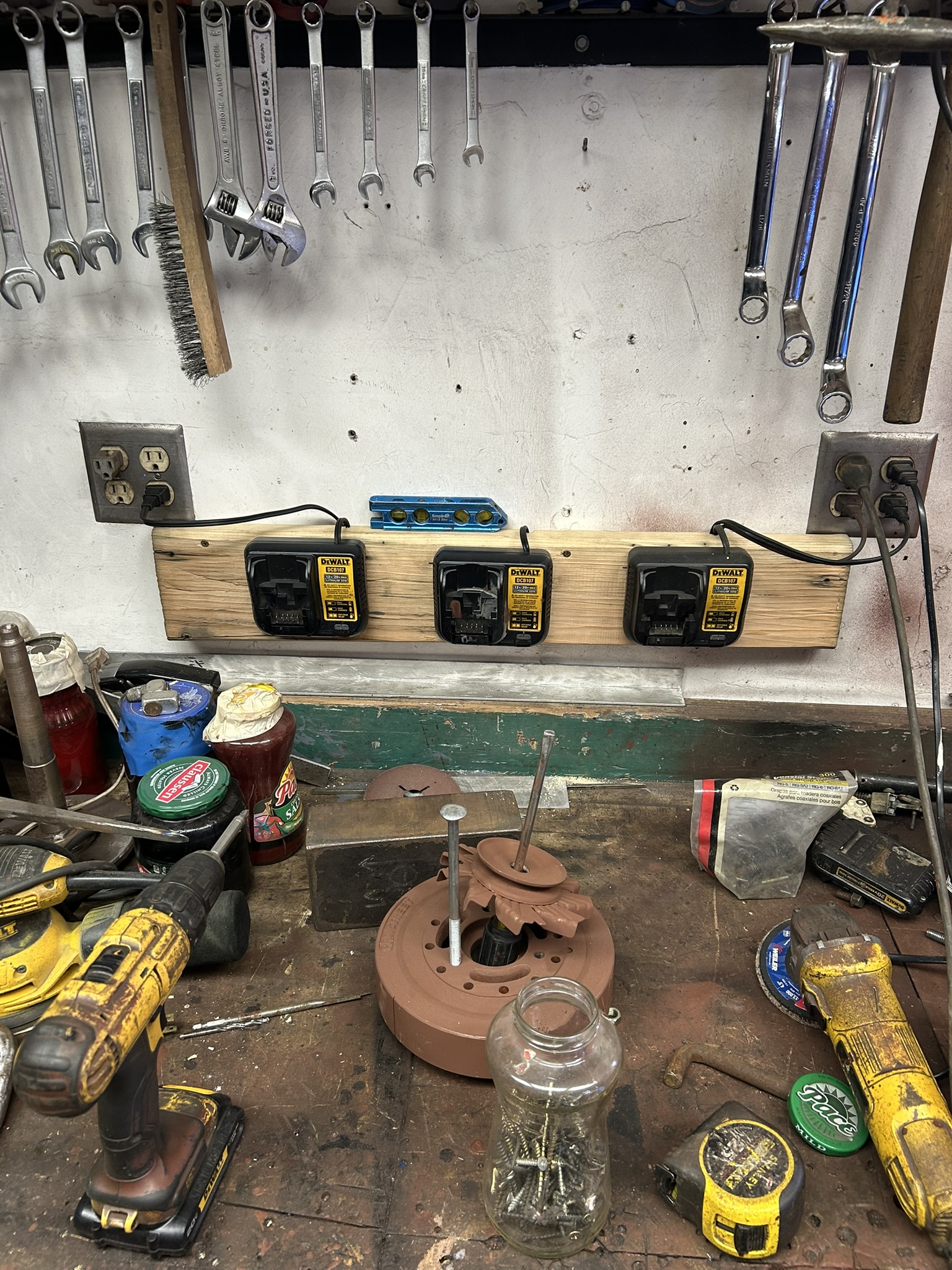

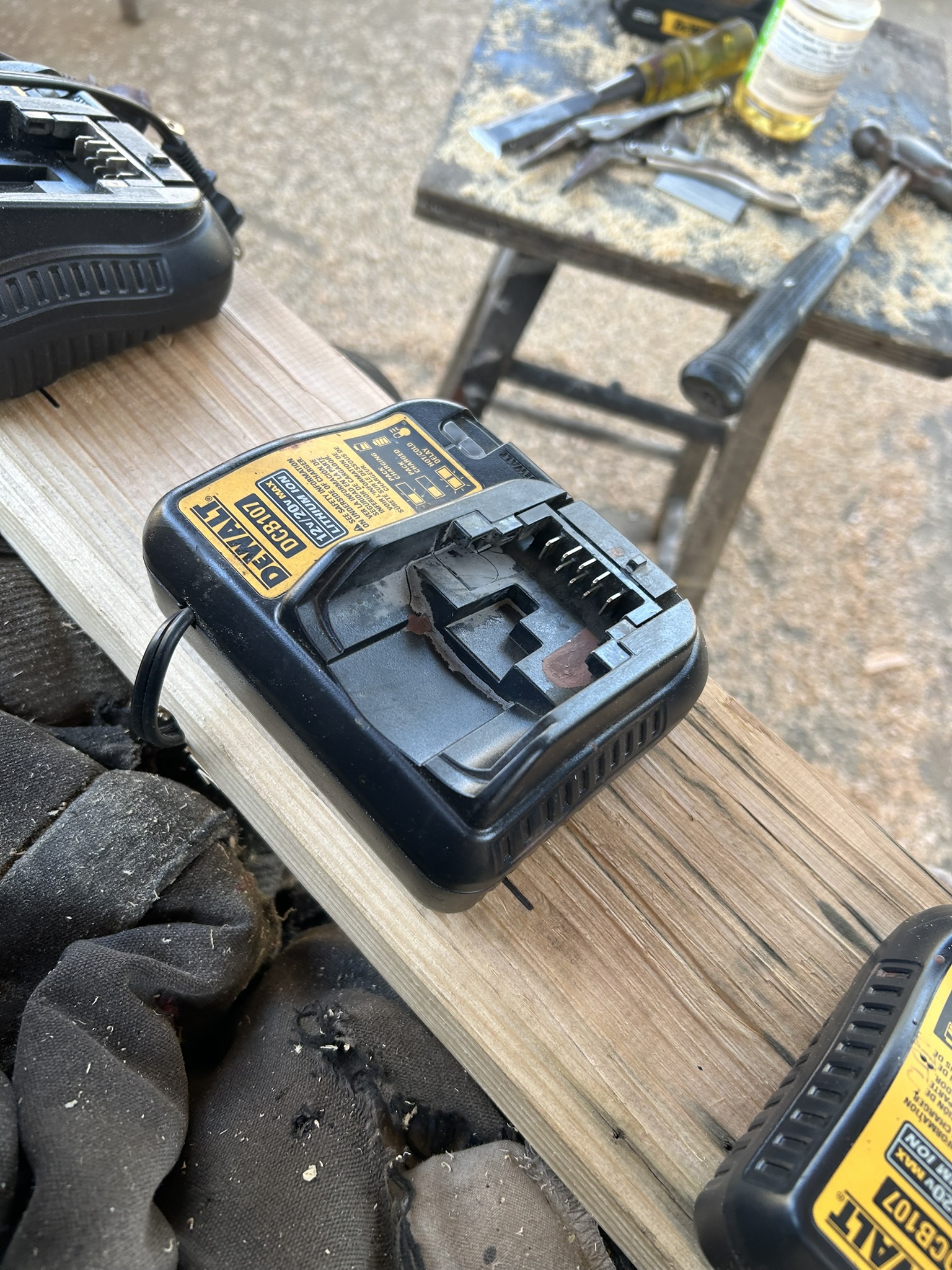

    Fffnn electric cords. I finally had enough of these Fffnn electric cobwebs all over my work bench. Dugout a dried up 2x6, run over it with the power planer. Then carved out the back. D82797EB-DED7-4FD7-828D-F5069439D34D.jpeg 6C80D6BD-1A9E-44C5-8510-0D8DE081E6F1.jpeg 6CFF5466-5FDB-435A-B7BB-8B47EB5A93AA.jpeg 95A56F3C-D890-4B4A-960B-7DA0EA4A42DB.jpeg

    They can also function like a coil. I hate excess cords & hoses in the shop.

  4. Thats a 2-wire cord, so current going both ways, it won't create an electromagnet or coil, but it will get hot being wound up and recessed into the wood.

    Likely not enough load to heat much.
    Rated draw on my identical DCB107 charger is 0.5 amps.
    According to the National Electrical Code (NEC), 18 AWG copper wire has an ampacity of 7 amps. However, the overcurrent protection for 18 AWG copper conductors should not exceed 5.6 amps for continuous loads. This means the maximum allowable current a fuse or circuit breaker protecting 18 AWG wire can be is 5.6 amps.
    Some of you guys act like old women working in a Civil Service office. So sour after 20 years and so bored that you can find nothing to do but pick at each other and look for ways to feel superior and important. Personally, I think @Onemansjunk came up with a good and elegant solution to a problem that bothered him and executed it at very minimal cost. Isn't that what this forum is based on?

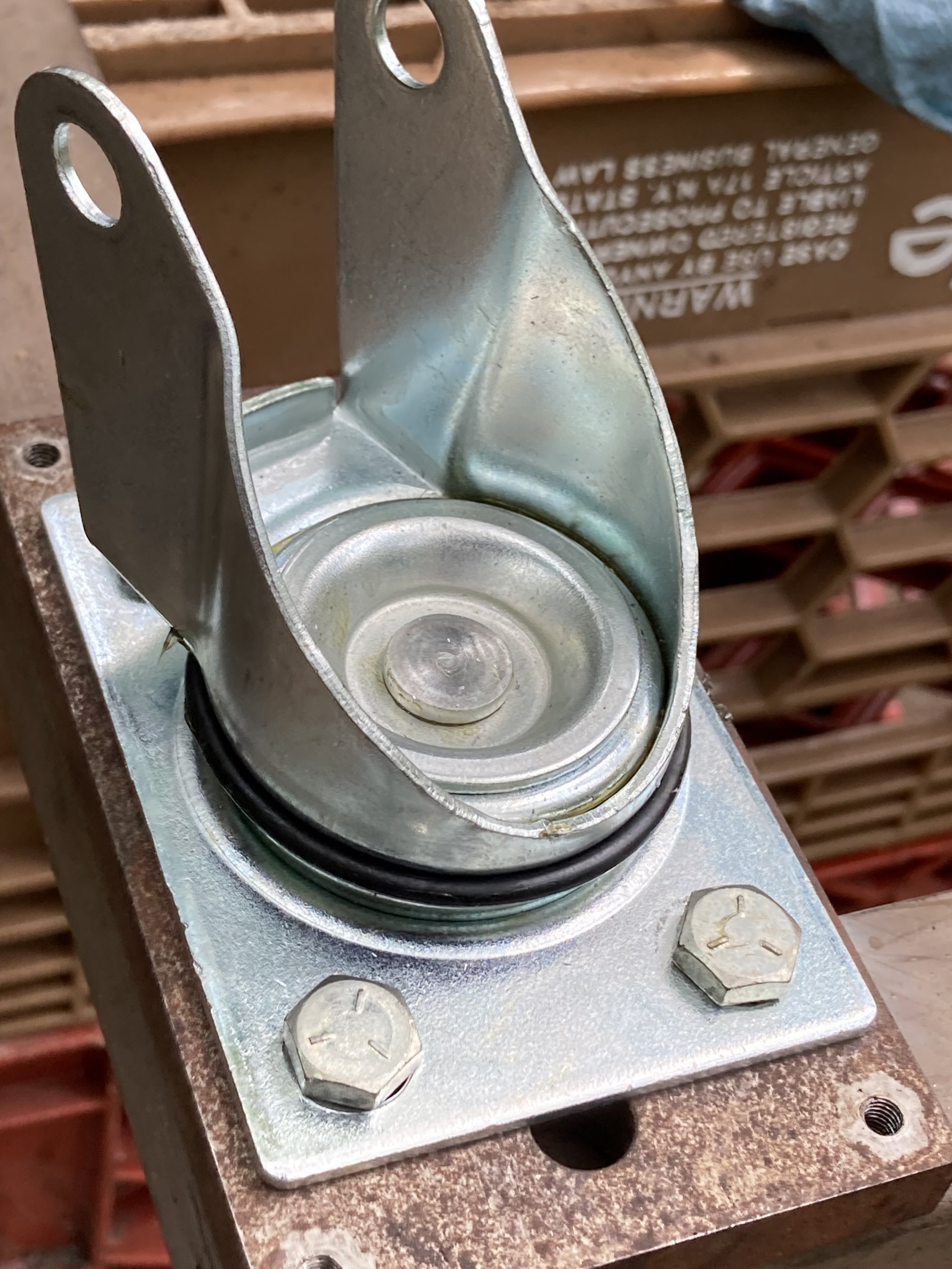

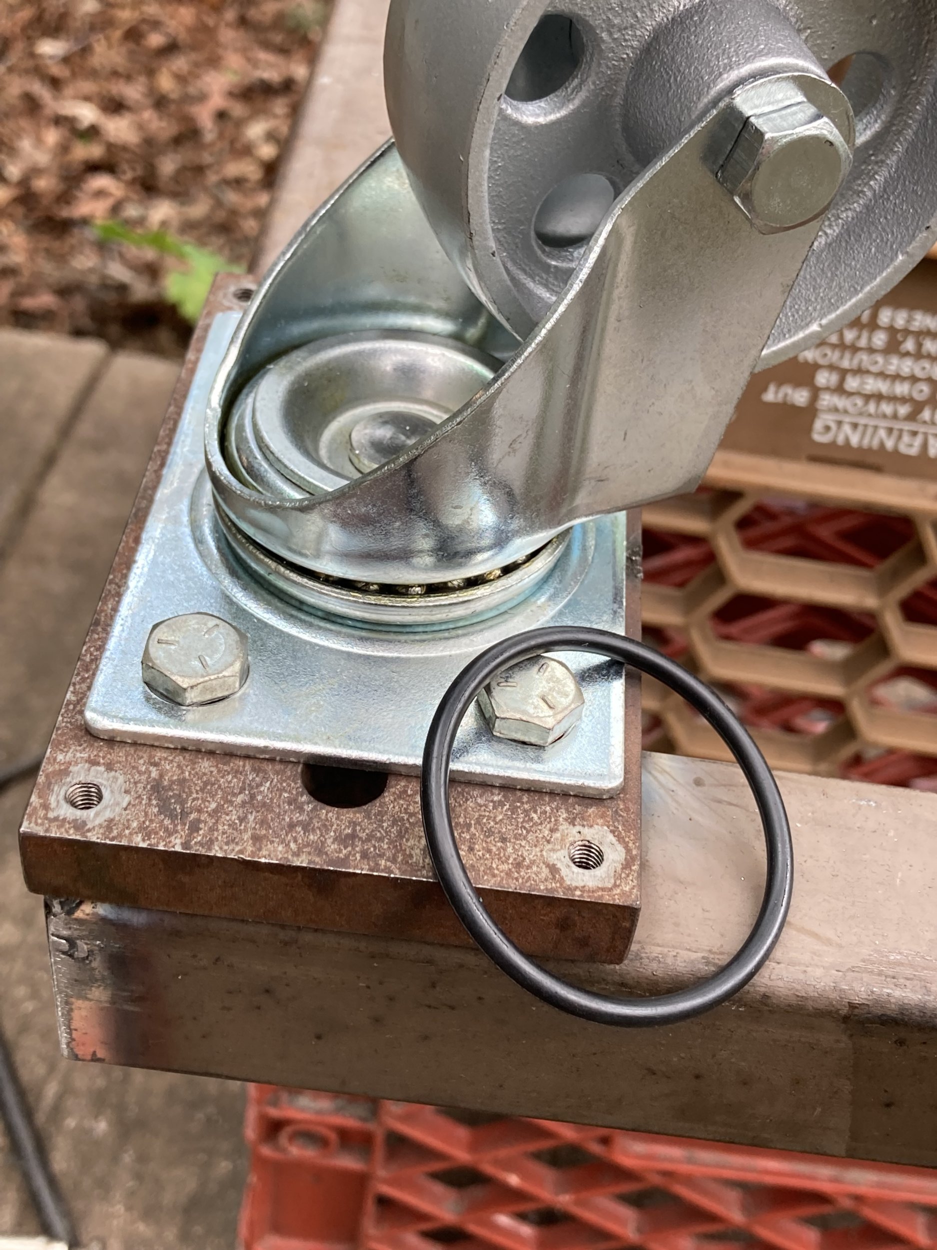

    Here’s a tip for to increase the longevity and function of those generic casters from all the big box stores (aside from lubricating the axles).
    Squirt some grease in the swivel bearings and wrap it with an o-ring.
    It may not swivel as easily at first but it won’t fill up with dust, preserving the action for miles of smiles.
