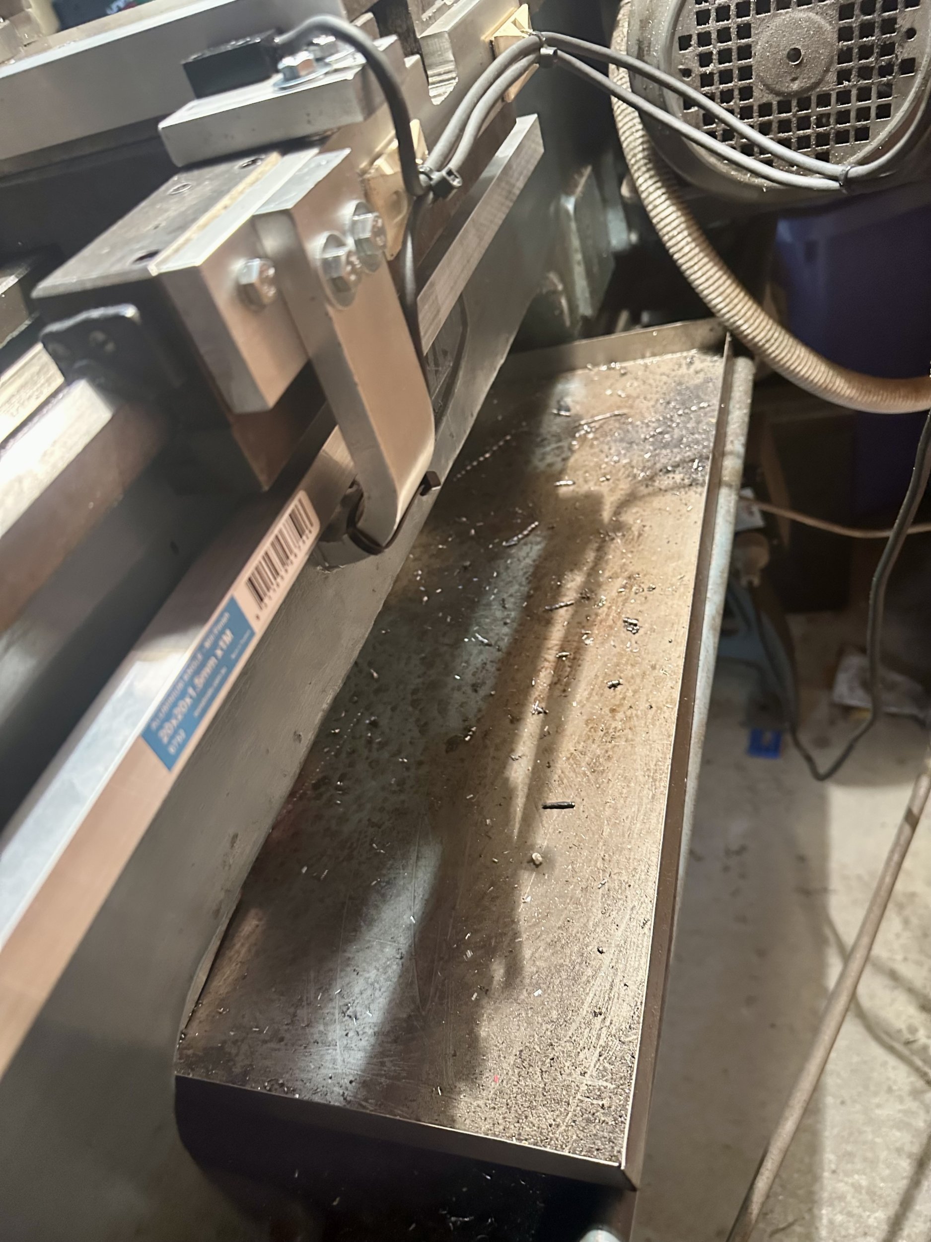

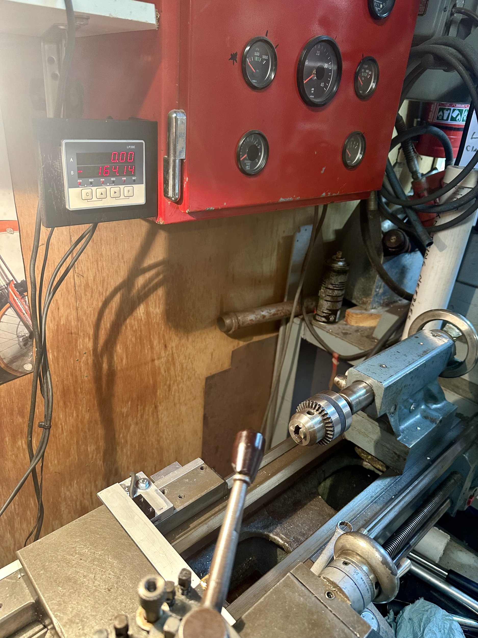

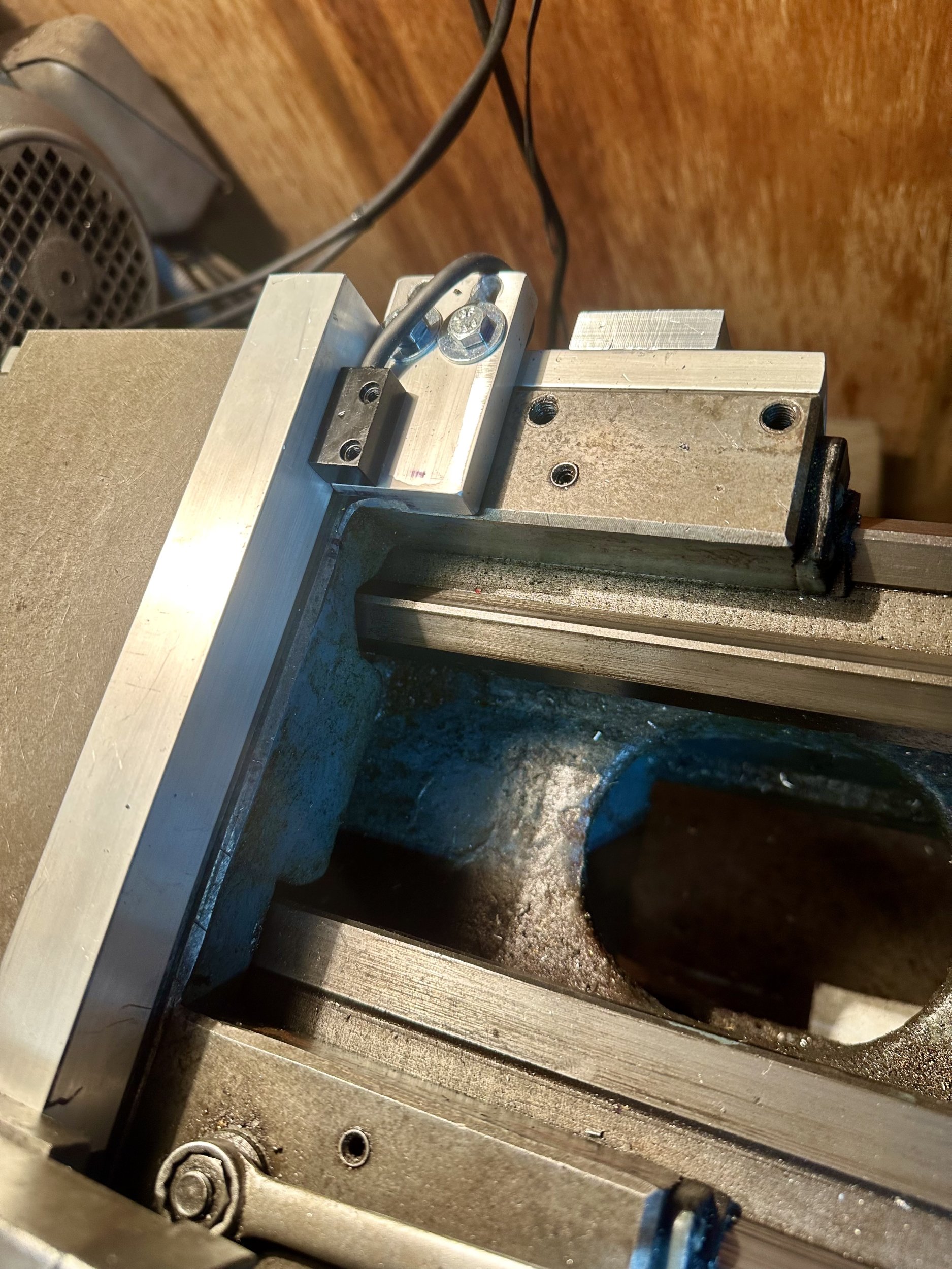

    I installed an AliExpress Magnetic scale dro on my old lathe, some small aluminium angle, some bits from my s**** bin, an old 12v plug pack. Works fine all for under $100 AUD ($60 USD)

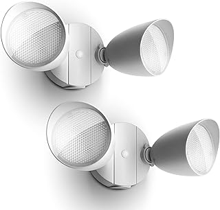

    A similar idea and easy to do.........I wired a light just above (2 feet) my compressor in my main shop. When the compressor is on I tapped off one of the 220 wires (110) and used one of those outside lights.
    I put a red bulb in it. So when its on, the red lightbulb is on. Later I built two smaller buildings further back in the yard, and each has its own compressor. One for painting and one for sand blasting. I wired them basically the same way, but mounted the lights outside the building.....again using red bulbs. If I leave a compressor on, you can see it from the house. I used those small outside lights where they have a round tube shape to protect the light. They are cheap too.
    61W2XraplaL._AC_UL320_.jpg What I used kind of resembles using just one of the lights in the picture, but the outer light protector was just plain round.

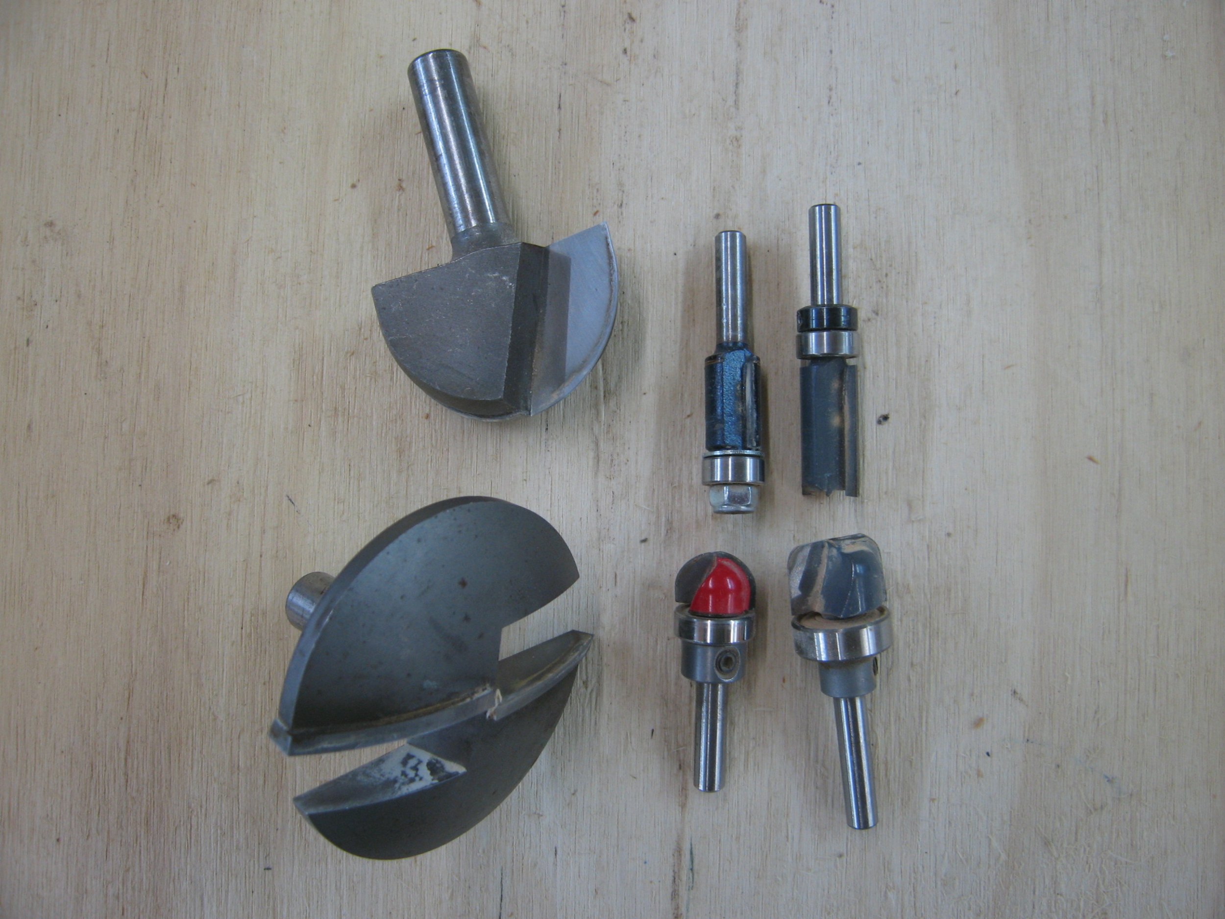

    The jig in the video looks a little Rube Goldberg-ish to me. Back in my boatbuilding days we used to build a part like the one in the drawing. A table saw with a straight edge clamped to the table works just fine. The size of that tube is only limited by the size of your saw blade, and can be any length you want. For smaller coves, which I would think would be more common in cars, a router would make more sense. Router bits with guide bearings can be had in many shapes and sizes. A bearing with the right OD and ID can be added to a bit with a shape you want. A bit without a bearing can be used by running the router base against a straight edge or pattern, or in a router table. Many possibilities. The smaller bits pictured here are 1/2" OD, the larger half round bit is 2" dia and the bigger one is 2-3/4".

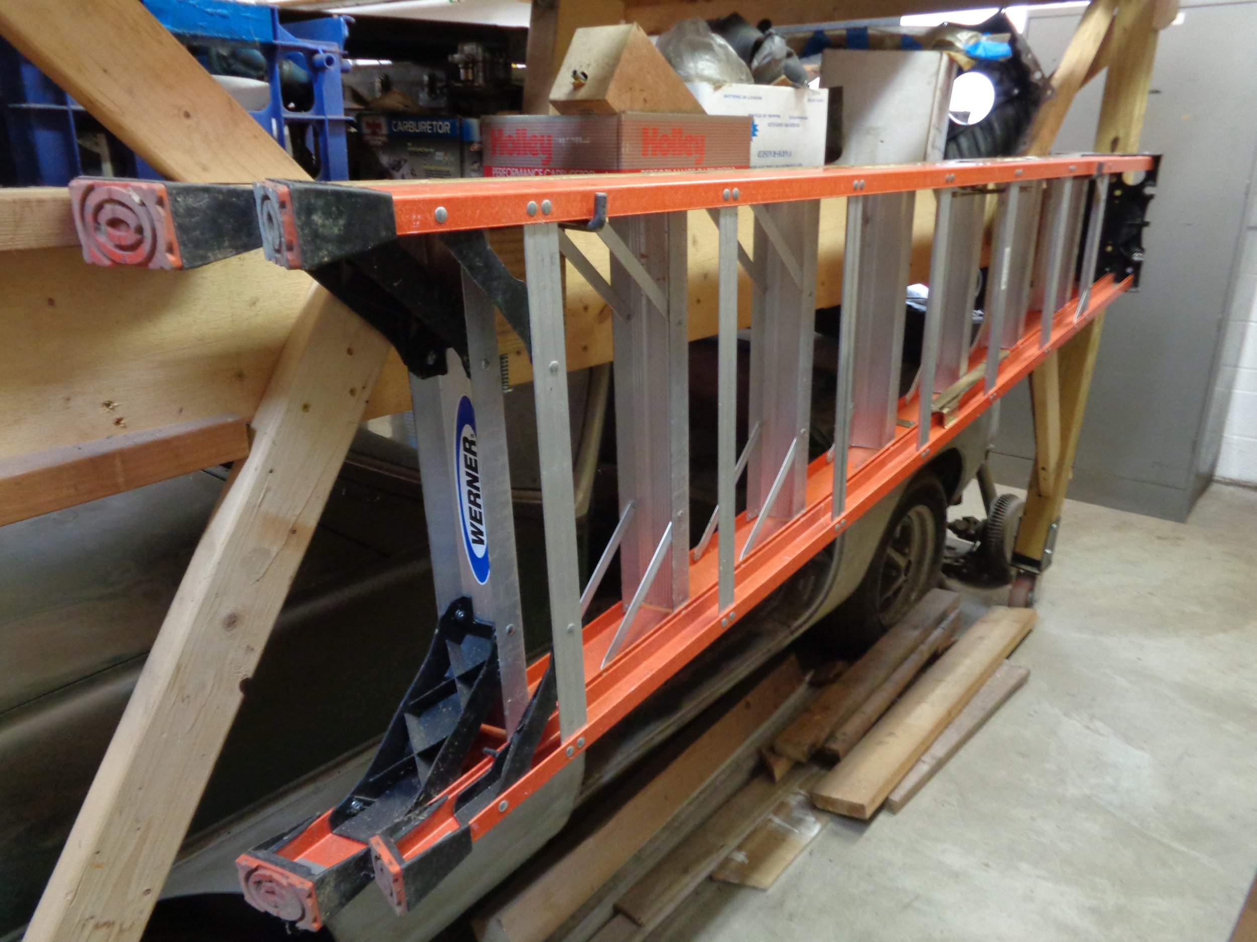

    Folding arms for a horizontal ladder rack on the side of my shelf on wheels.
    Jeff Norwell, Robdski, fauj and 9 others like this.
  26. GuyW
    Joined: Feb 23, 2007
    Posts: 833
    GuyW
    the above ladder storage device looks su****iously like a bicycle kick stand.....

    No, just a piece of 1/2" rod, a vice, heat and a BFH.
