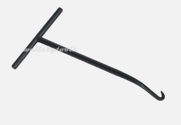

    One of these has always been the easiest for me.

    About the price of a medium pizza here.
    https://www.amazon.com/dp/B00BR1BV8Q/?tag=atomicindus08-20
    Slightly different, but pretty close to what I paid for K-D brand 50 years ago. Stop chasing springs all around your shop or driveway for a half hour per corner and buy the tool. 4 seconds or less per spring and works every time.

  6. RodStRace
    Joined: Dec 7, 2007
    Posts: 8,579
    RodStRace
    Yep, I don't have the big pliers. Just a bar that has the kink on it and the round end with a tab to pop them off. No fuss. The pliers have those on the ends of the handles and cost 12 bucks on average.
