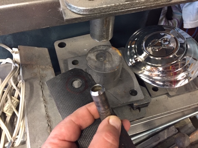

    A rather obvious method to add holes in thick rubber or webbing. Take a piece of tubing and grind a sharp edge on it and use your press to punch it out. A heavy duty vise will also work.

    Hammer on a piece of wood will work good too. I actually have a set of those, my Dad gave me. He called them “ hole cutters” .

    When I've had to cut a hole like this and I couldn't back the piece up with wood/metal I chucked the hole cutter up in the drill and spun it just like a hole saw. Works great.

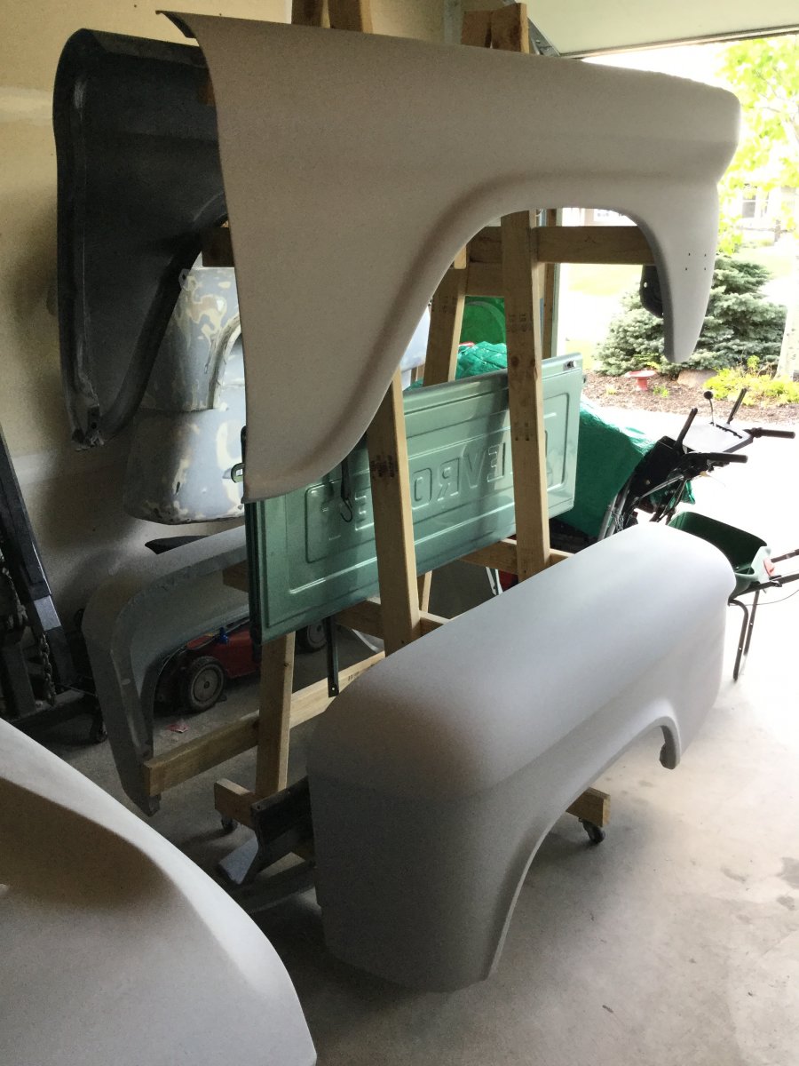

    This simple A frame rack kept the body parts from being damaged and also saved valuable space in the garage. Next time I will use larger diameter swivel casters on all 4 corners

    I also have a lead block about 6" round and 3/4" thick that I use for a dolly when I'm punching holes,,
    After punching heaps of holes on both sides, I drop it in to a tin an melt it down an start again with a good flat block,

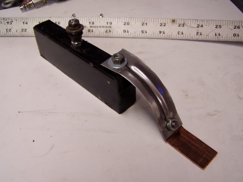

    When welding up holes, I use a copper backer held by a magnet to prevent blowing a bigger hole.. Cheap magnet from harbor freight, s**** stainless and flattened copper pipe. mag4.jpg mag6.jpg

    Nice!!!
  30. I use the copper bar and I use magnets to position pieces, but never thought of attaching a magnet to the copper bar. Duh!
    I'm going to be on this tip like a spider on a fly.
