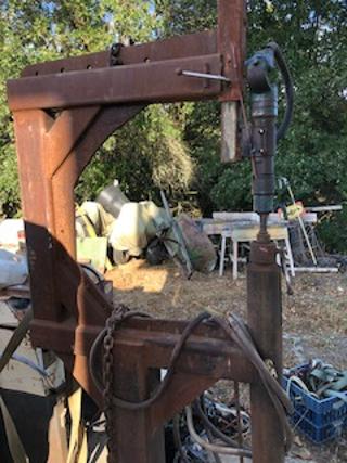

    Now that is unique. Looks like it would be easy to duplicate. Hearing protection and finger protection…

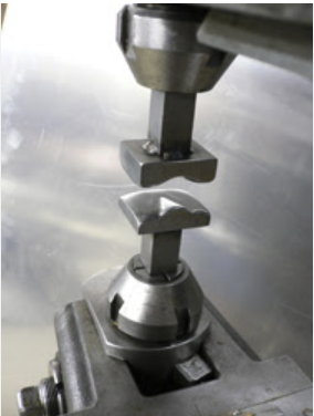

    I like it,,thinking of doing that myself .Poor man`s Pullmax.

    the one of mine in that not very good pic above thinks NOTHING of 16 ga.!

    That’s the one Karl Fischer of Japhands offers up. Knowing his work it must be a great tool! I believe he has plans on his website...
  7. rockable
    Joined: Dec 21, 2009
    Posts: 5,052
    rockable
    I've seen the videos. It appears to work pretty well, just slower than a pullmax. Karl is pretty inventive!
