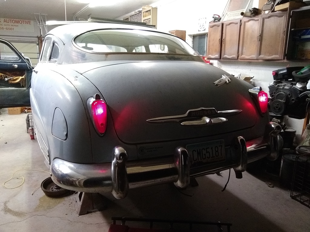

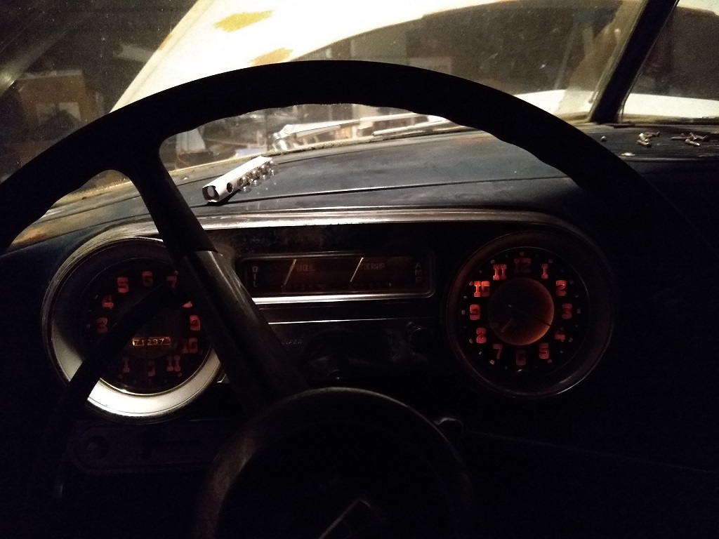

    I decided to use the existing wiring for now, and see how it does. I added a fuse link to the main feed wire. I got the ignition system, starter, dash lights, headlights, tail lights, heater blower, and idiot lights all working. So I can sit inside and start it up, and it charges the battery, and has oil pressure. Pretty cool.
    I hope it doesn't burn up!

    That dash looks so nice lit up. My Dad had two big Hudsons when I was a little kid, brings back good memories.
